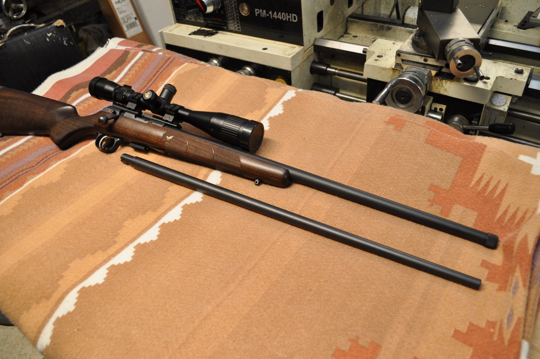

I customized my 457 American by doing a Shilen select match ratchet rifled bbl for it - is this sort of thing what you're talking about?

My American's factory bbl was a bit of a lemon - consistently shot 2 MOA 'groups' at 50yds with a variety of proven good lots of SK & Lapua ammo. I didn't want to screw around with making a warranty claim on it, so just ordered in the Shilen and replaced the factory bbl with that. The Varmint MTR OTOH, has shot pretty darned well from the beginning. It shot good enough with the factory bbl to use as a trainer or to compete in NRL22 matches. However, it wasn't as consistent as the custom bbls on my 40XB repeater and V-22s, so I've replaced the factory MTR bbl with another Shilen. Planning to do an extended comparison of these two Shilens to the Bartlein, Kriegers & Lilja bbls on my other repeaters over the summer months. I bought the Shilens because of their reputation in the .22RF BR world, and because they were available quickly. Time will tell how well they shoot compared to the cut-rifled Bartlein & Kriegers.

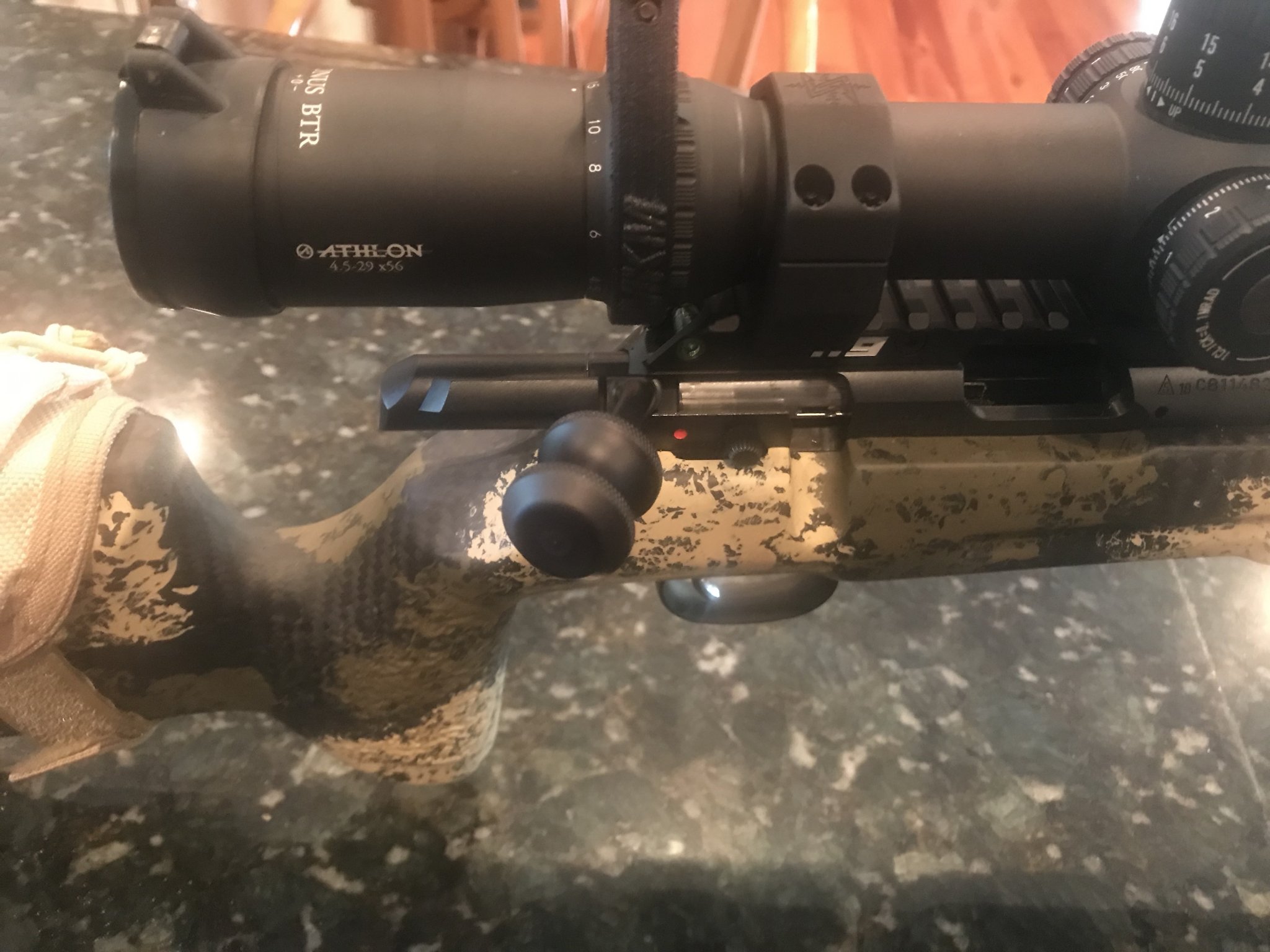

My 419 rail came loose somehow when I went to test Norma, Eley and Wolf. Of course the bolts are metric and I didn't have it in my tool bag at the range. I torqued them a little tighter and will go back to the range when i can to further test the rifle.
I changed the bolt knob after the first trip because the stock knob is too small for how hard the bolt close effort is. I was a little surprised how hard it was. Does everyone else notice this too?
I made a bolt knob for my MTR that's fairly close in size to the 419 knob, and have been pretty pleased with how much easier it is t run the bolt on my rifle. I did put some NECO Moly Slide grease on the cocking ramp and thought that helped a little, on both the MTR & American. I kinda hated to put a big knob on the American's bolt handle, so have left the round knob on it for appearance sake.

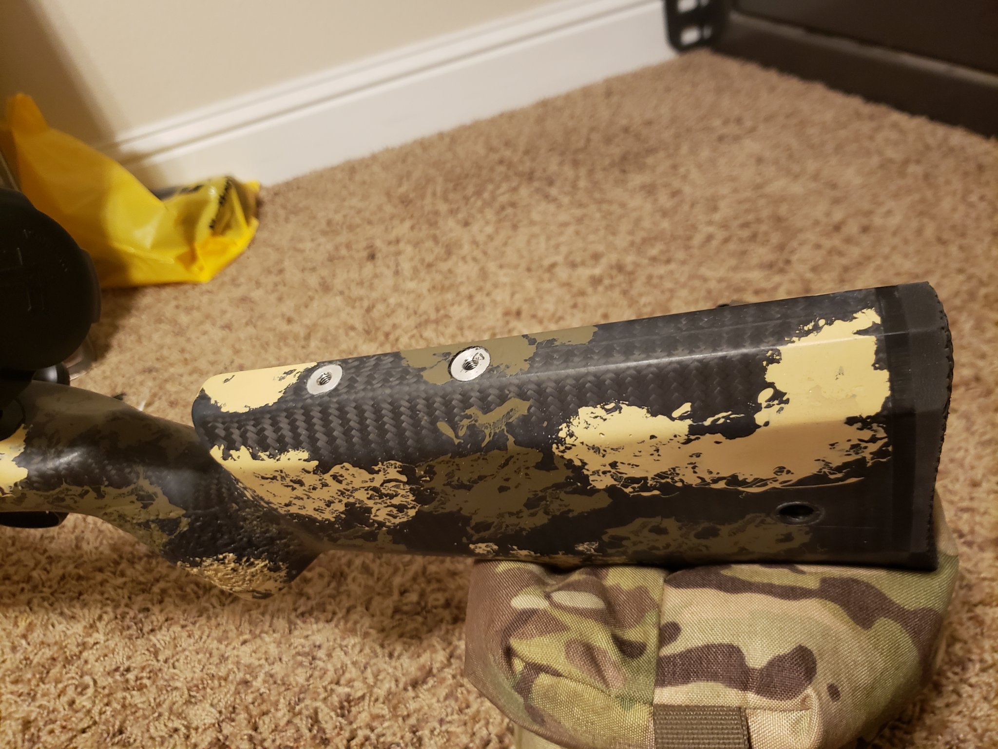

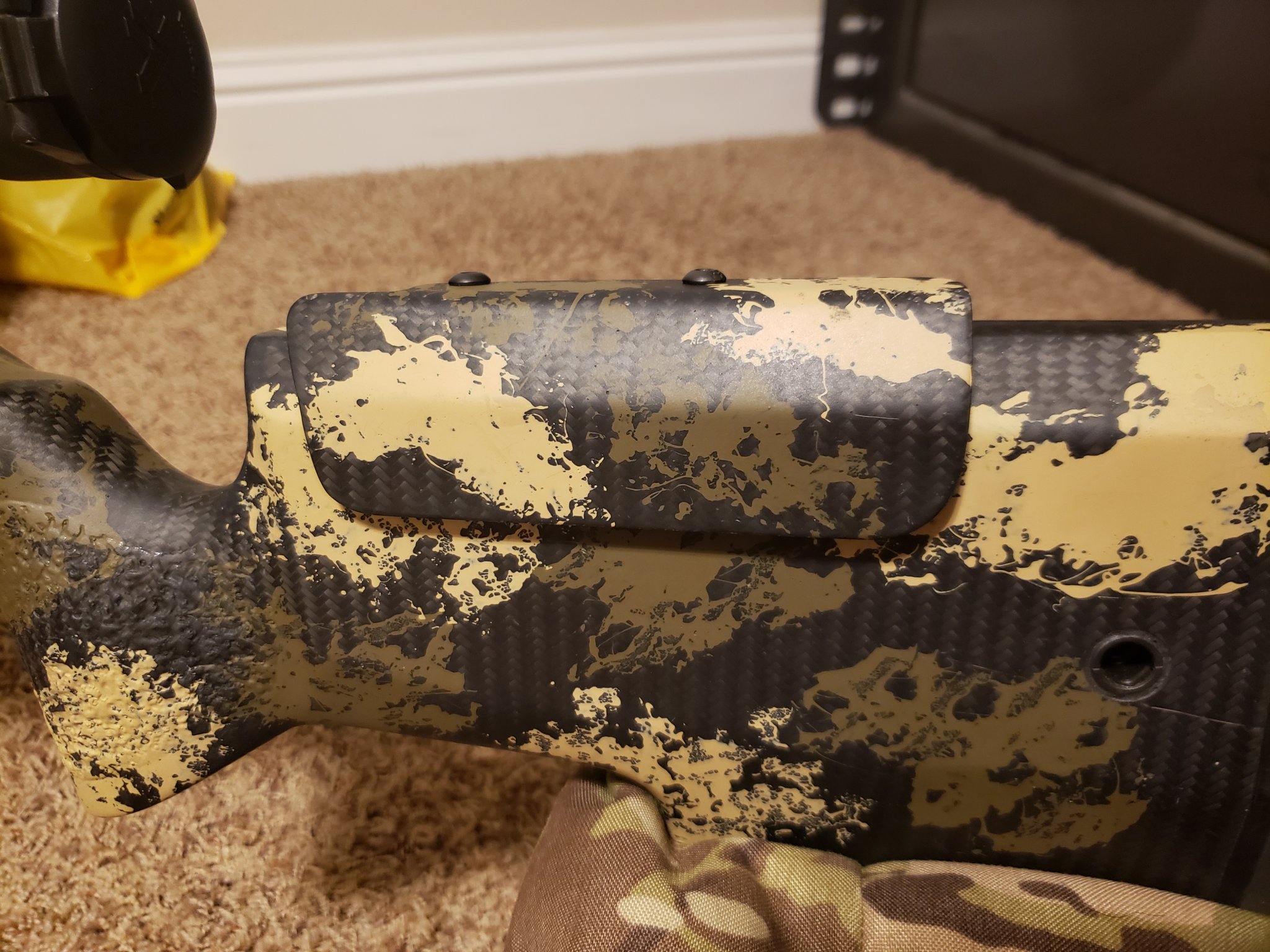

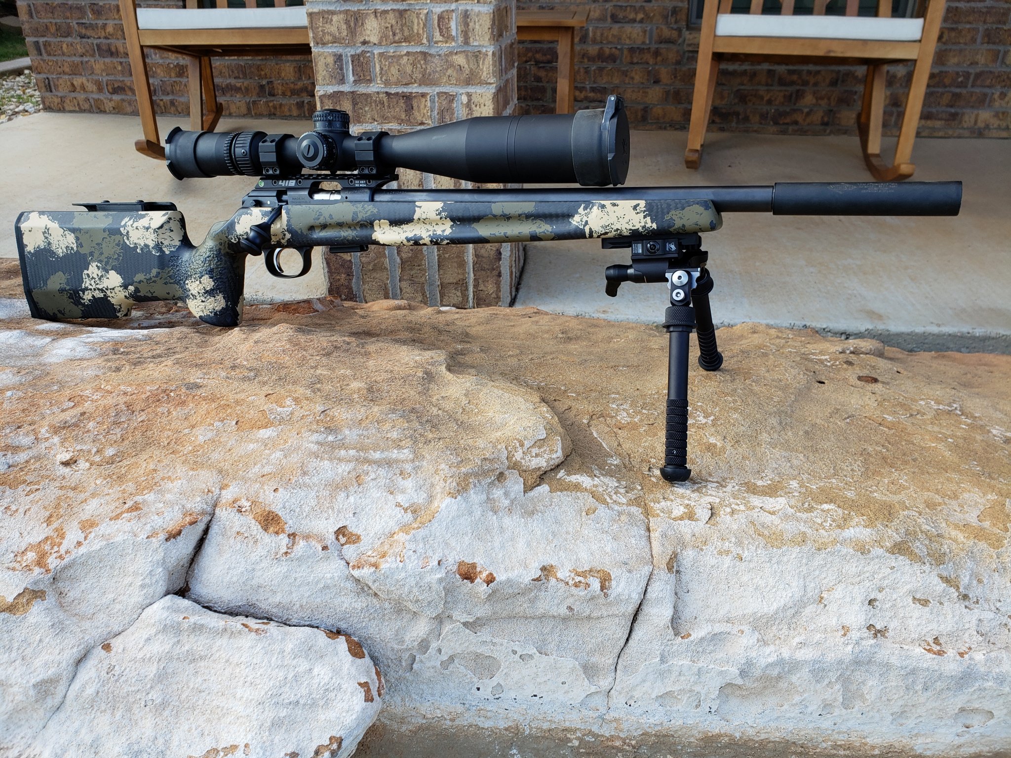

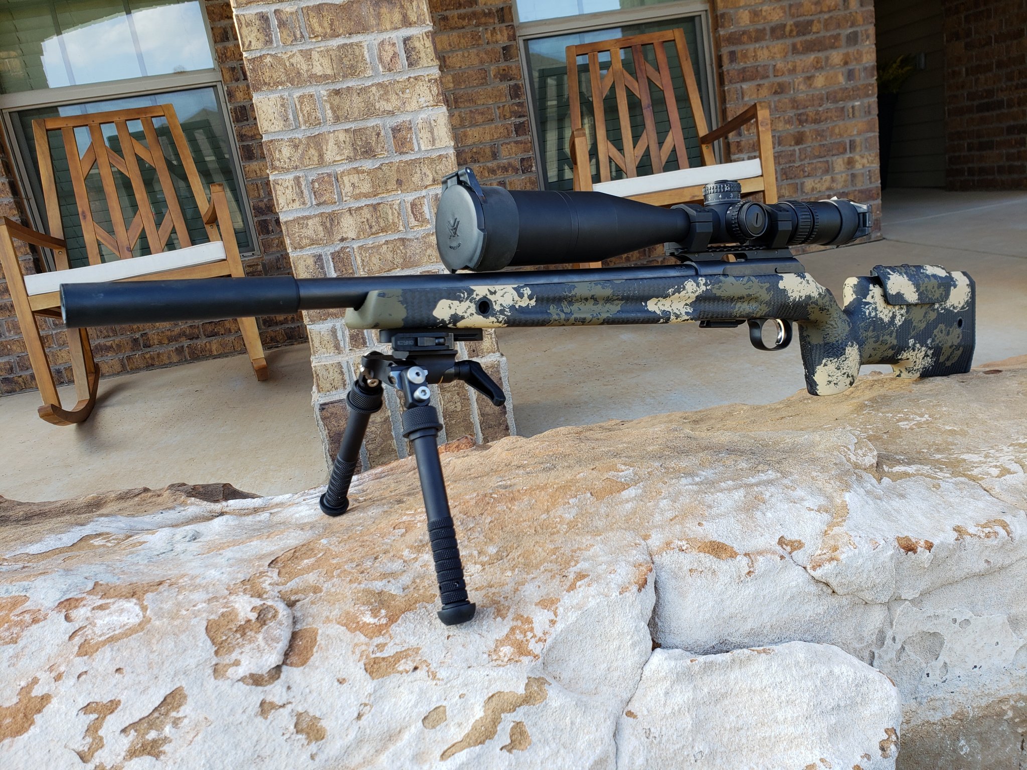

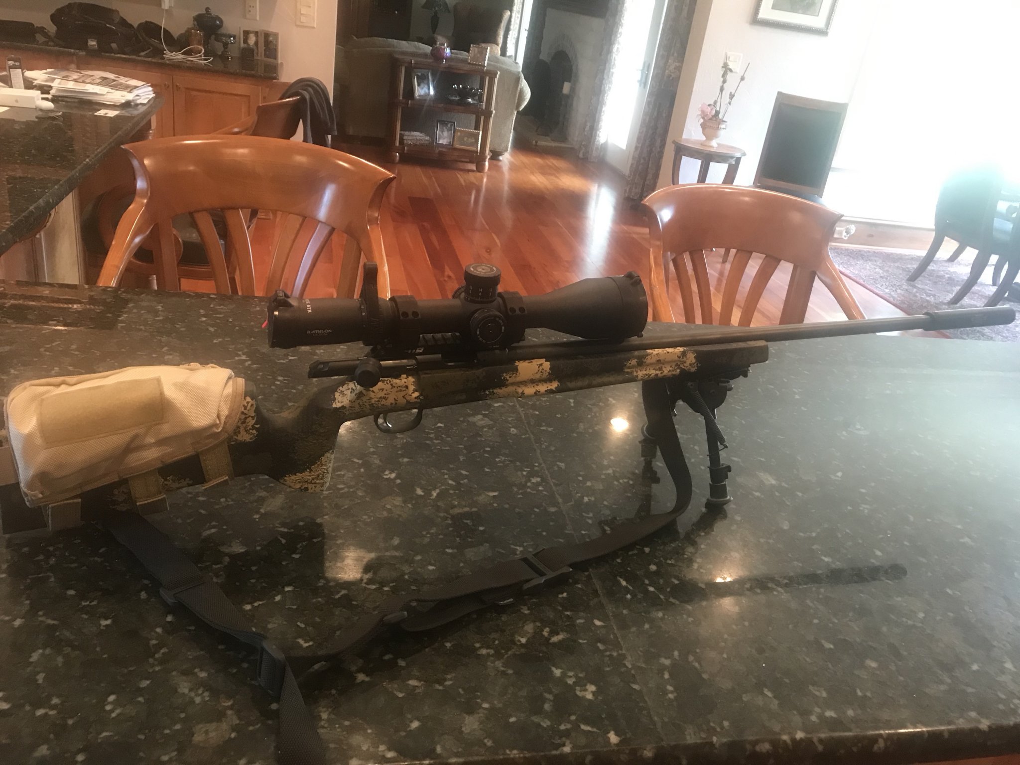

Finally got her finished. Going to test in the AM.
Vortex Razor AMG
Seekins low rings
Area 419 scope rail
Area 419 bolt knob
Area 419 magwell, mag release, and block.
Custom cut full length grade 10.9 action screws.
Reshaped and polished striker
Polished bolt
Manners Lightweight cheek piece
Atlas rail / Atlas CAL.
The trigger is breaking at a crisp 18oz with absolutely no creep or overtravel.
7087528
7087531
Looks great. Details on cheek riser?
It's the lightweight cheek that Manners offers on their compact stocks. Pretty straight forward install, if you're comfortable drilling 2 1/2" holes in a brand new CF Manners. It comes with 2 1/8" spacers and 1 1/4" spacer for a max height of 1/2". I have the 1/4" in it and its perfect.
I was contemplating having StockDoc do a full Loggerhead job, but I HATE sending stuff out for work. After speaking with Jim at Manners, I went with this option and did the install myself with a drill and a little MarineTex. I am in no way disappointed. It looked like it might have too much flex in the pictures online, but it is solid as a rock.

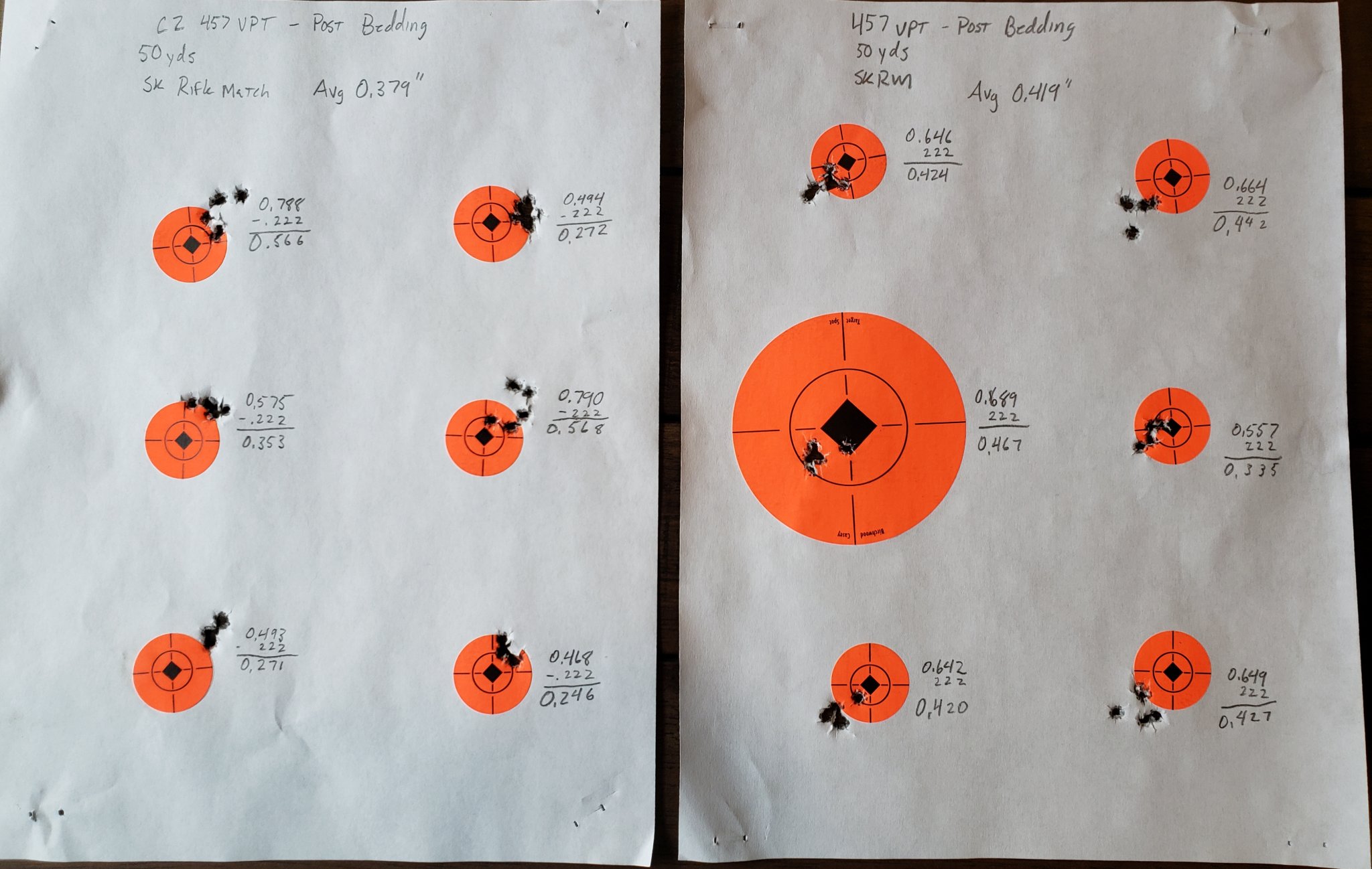

It has been shooting 0.5-0.6 @50yds and 1.25-1.5" @100yds average with SK Rifle Match. I was hoping for better, so I bedded it with marinetex. We'll see today if it helps anything. I have some groups posted in the 6x5 thread.
For any of you guys who've got a Precision Trainer and want better accuracy, I've got a 457 Varmint MTR (with the match chamber) take-off bbl after replacing mine with a Shilen select match ratchet rifled blank. I kept a loose track of how many rounds I fired through it, and it's under 500rds. I haven't threaded it, and it's still the stock 20.5" length. If there's any interest in something like this, and someone wanted it threaded, I can certainly dial it in and thread the muzzle. Not at all interested in cutting it back from the 20.5" length though.
Just fishing to see if there's enough interest in it to make it worthwhile to take the time to list it in the classifieds, and to give the 457 owners here a heads-up.
Bedding made a huge difference. shooting pretty consistently in the .3s and .4s after bedding.

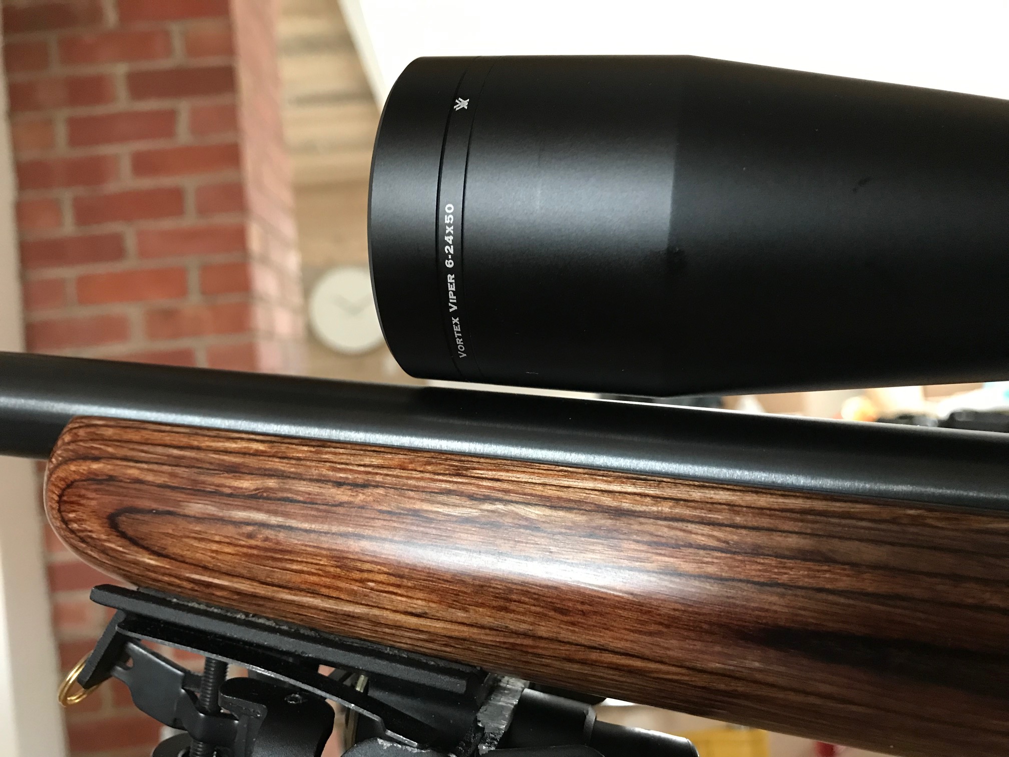

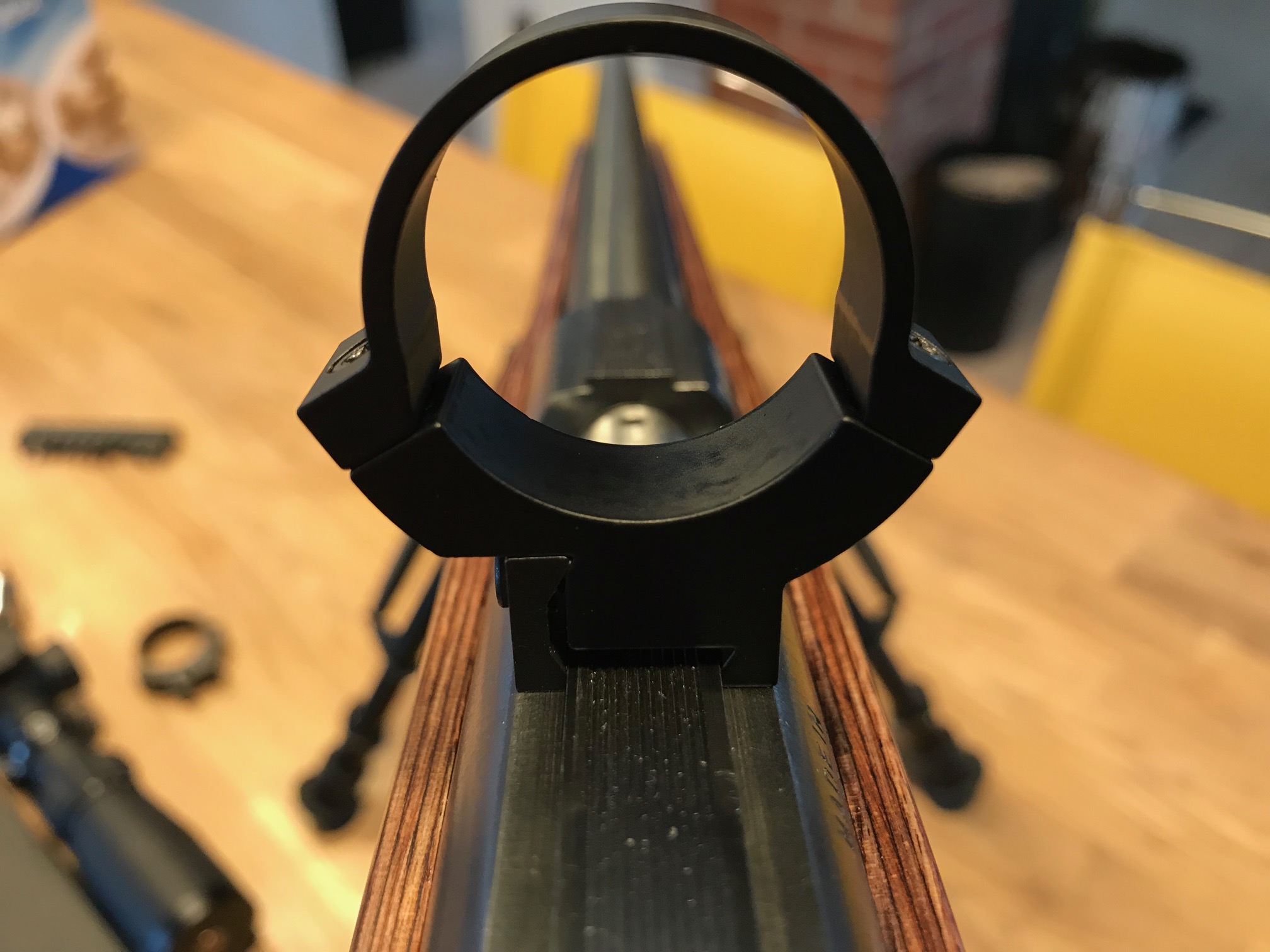

2. Vortex Viper HST 6-24x50mm 30mm tube + Warne rimfire 30mm rings, medium height (0.990''). Product code # 731M
The 50mm objective bell diameter is 2.26'' and almost touching the barrel with 0.045'' of clearance. Same thing with the bolt handle. The eye piece diameter is 1.745'' on the widest (zoom ring). This set up is 0.130'' higher than the previous one… so not exactly the perfect eye alignment with the scope… but this is the lowest I could put my Vortex on.
3. As you probably noticed, the bolt body of the new 457 slides in the receiver differently than the 455. As I saw on the previous pics that some posted here, we have to be carefull not going too wide with the ring clamps. Some rings won't prevent the bolt to slide properly. The width of the clamps of the 2 sets of rings I proposed here are pretty slim. I'm almost sure the new 457 bolt body/handle will clear these rings.

This bodes well for me, I have a 457 Pro Varmit Pro SR coming, and the dovetail/ring height setup was new to me. I looked at the BScar rail hoping to use one of my many pic ring sets, but they were out of stock. So I grabbed a set of Warne 732M (highs) since they spec'd 50-56 fit. I have the rings now, they look really low compared to Pict rings lol. But from the looks or your setup with 731M's they should work fine with my 6-24x50. I may grab a set of 731M's to try as well depending on how cheek weld turns out, actually since they worked for you.
You will see if the fit is too high for you... If you have a caliper, you could measure the clearance of your set-up (between the objective and the barrel) and if you measure 0.125" or more, the lower rings (731M) will fit 100% sure!
Nice, thanks - I will measure after I install the High's and go from there (y)
.071 with a Butler Creek. BC's are typically 2mm so if I did away with it that would jump me up to .149-ish which would work with M's. I'll wait and see how cheek weld looks. Right off the bat the stock seems short-ish, but that may be b/c I am used to running a PRS on a RPR 6.5.

No question that bbl swapping on CZ 455s & 457s is easy - and if CZ starts selling MTR bbls as they do stainless American & Varmint bbls, buying direct from CZ isn't expensive. The big question in my mind is, if you weren't happy with the original bbl's accuracy, how do you know you're going to do any better with a factory replacement bbl? Best bet would be to go with an aftermarket semi-custom or have a gunsmith fit up a custom. Get the desired results the first time around, and you're gtg. If you hit a snag, then the question of going with a V-22 in the first place is even more valid.
ETA - I machined & chambered a Shilen ratchet rifled .851" straight blank for my MTR; did some shooting with it today at 50yds, even though it was pretty windy. It appears that the Shilen is enough of an improvement over the factory bbl to be worth the cost & effort, and that's saying quite a bit, since the factory MTR bbl was no slouch in the first place. If I didn't like the CZ457 Varmint MTR so much, I'd have just sold it and stuck with shooting my 40XB & V-22 repeaters. I saw improving the MTR as a challange, one made worthwhile by the quality of the new 457 action, trigger, and stock. Only more trigger time with it at 100-200+yds on a day with decent conditions will confirm the impression it made on me today.

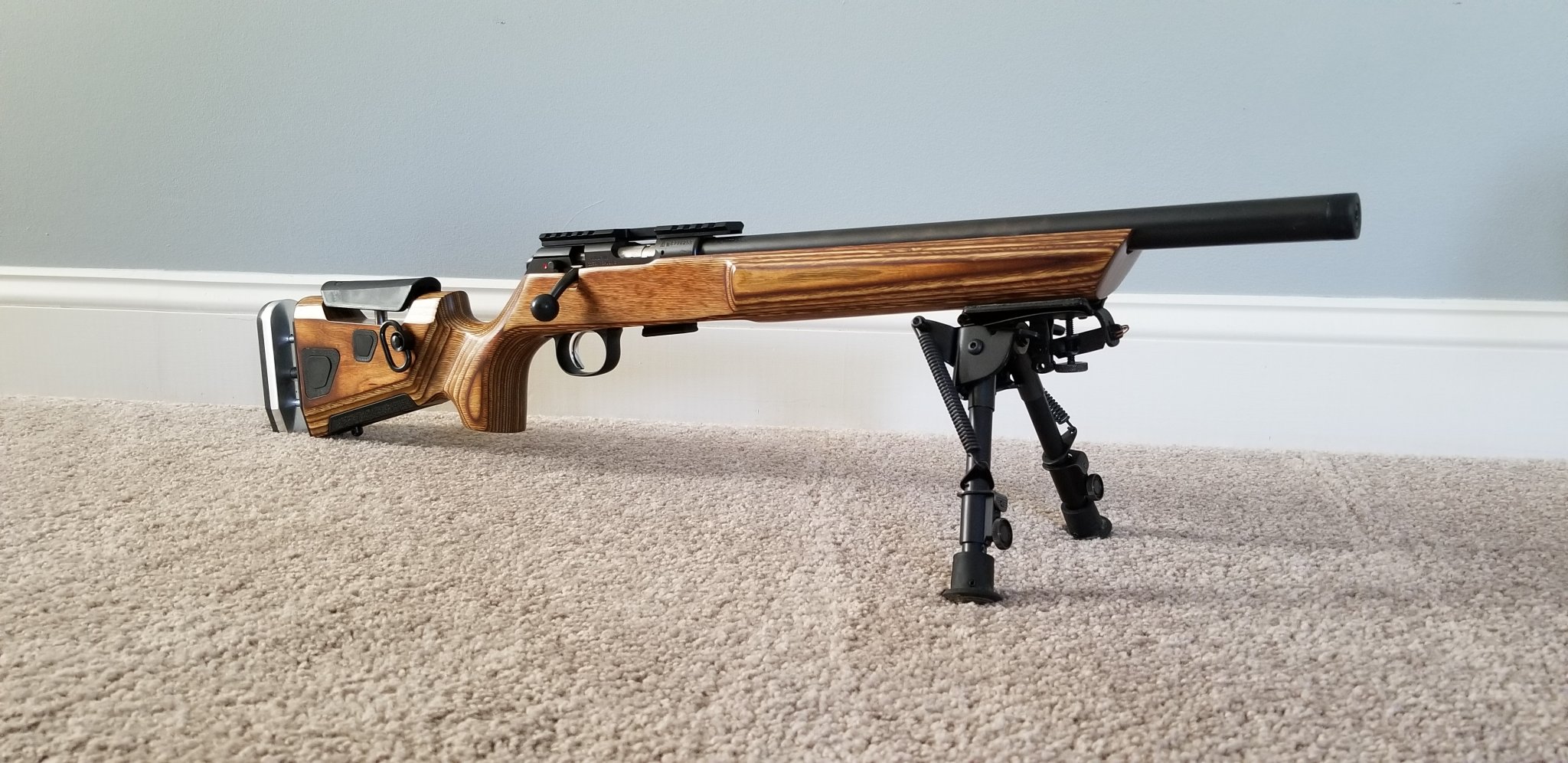

Picked up the 16.5" varmint in the Boyd's At-One stock. I like the stock more than I though i would. I installed a scope base from Triggers by SCAR (great quality), just need to mount a scope and run an accuracy test.View attachment 7099619
Wow, that's a very nice looking rifle. My MTR really likes SK Rifle Match. Is that Scar's elevated 25 moa base?
Reactions: Raptor005
The BScar rail in the photo looks like Bill's standard height rail, although I haven't seen a photo of the elevated one on a rifle yet. The 25 MOA BScar rails I have on my 457 American & varmint MTR look pretty much the same height as the one on Raptor's AT-One. Hope she shoots lights-out for ya Raptor...
Yep, it's the 25 MOA extended rail, standard height (vs extra height).
