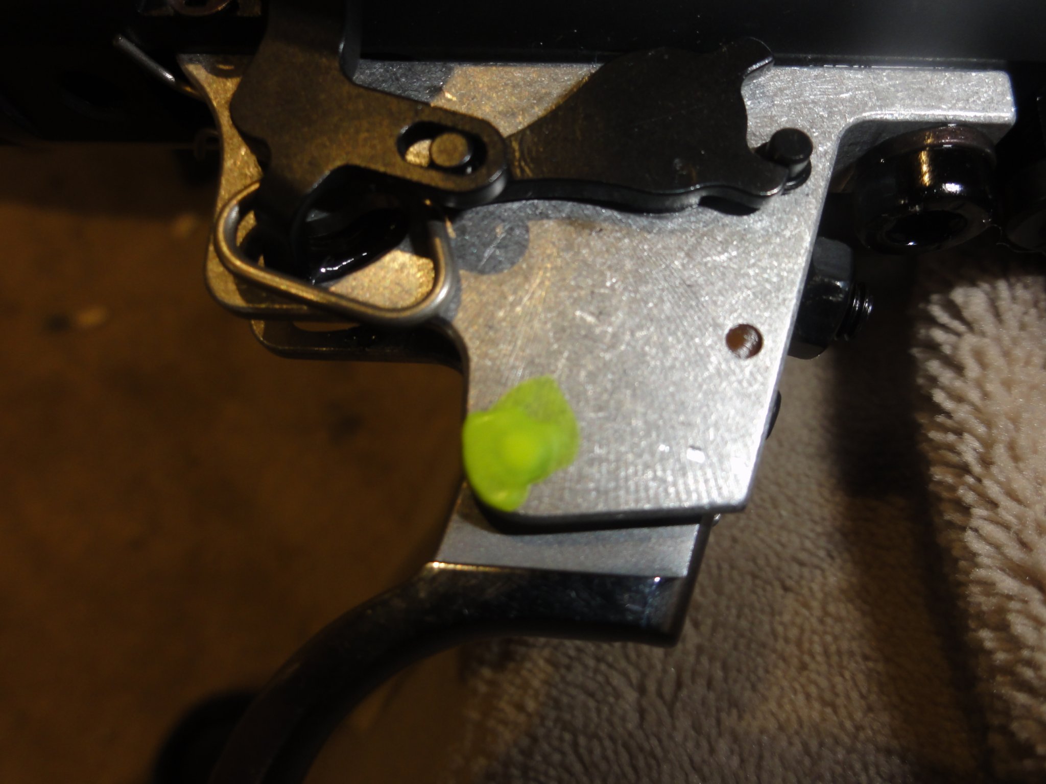

A YoDave spring kit will help the trigger get to 9 oz. See above from Airgun Shawn. Do you know the thread size from

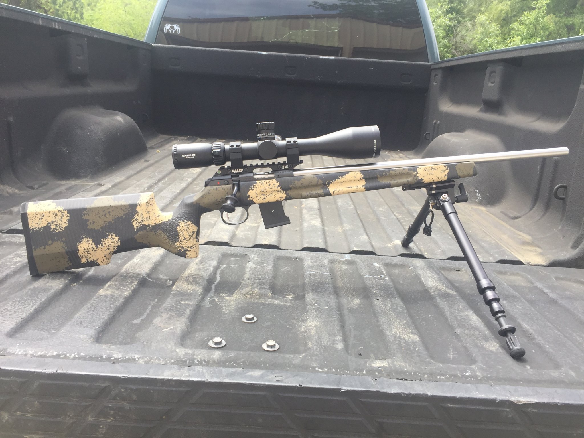

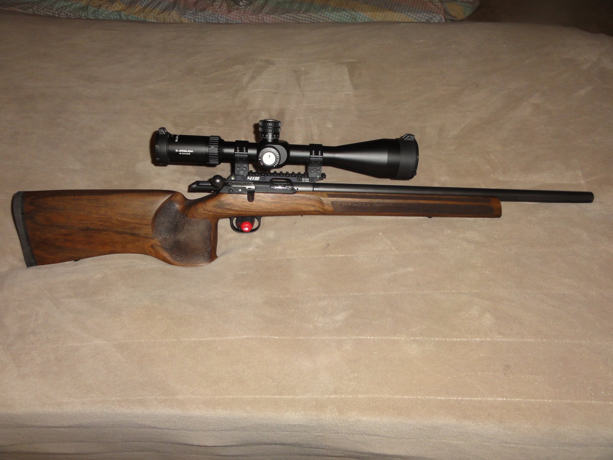

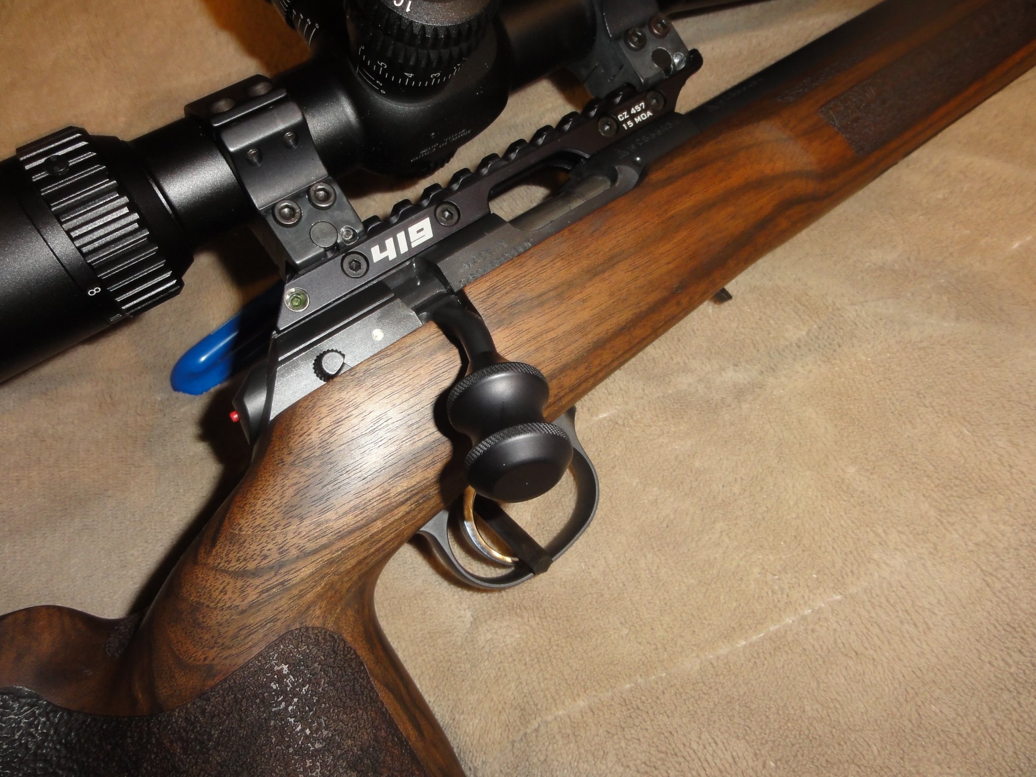

457 VPT with DIP internals and A419 rail and handle. The scope is a loaner from another gun until the AMG comes in later this month. I really want the scope to be lower so I don't have to add a cheek riser. The Area 419 rail for the 457 has no recoil lug or cross bar in it, time will tell how well it does clamped to the dovetail with nothing mechanically holding it in place. I may just drill and tap this thing later, I am not a fan of bases with grub screws. I got the trigger down to 18oz without any creep, over travel, or slam fires. It's a pretty nice trigger. Very similar to setting up an old 3 screw Remington. I hope to get the atlas rail installed and get out an shoot it tomorrow.
7077660
I took it out to the range this morning, and so far I am not impressed. I shot 100 rounds of CCI SV at 50 and 100yds and it did about 1" at 50yds and 2.5-3" @100yds avg. There were a few acceptable groups, but they weren't the norm and weren't repeatable. Granted this was the first 100 rounds through the gun. I spent the rest of the day shooting 325rds of Federal Automatch and another 200 CCISV at rocks in hopes of smoothing the bore up a little, I have heard these guns may need 4-500 rounds to start shooting to their potential.

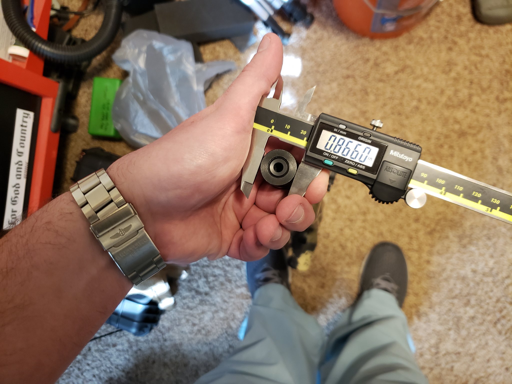

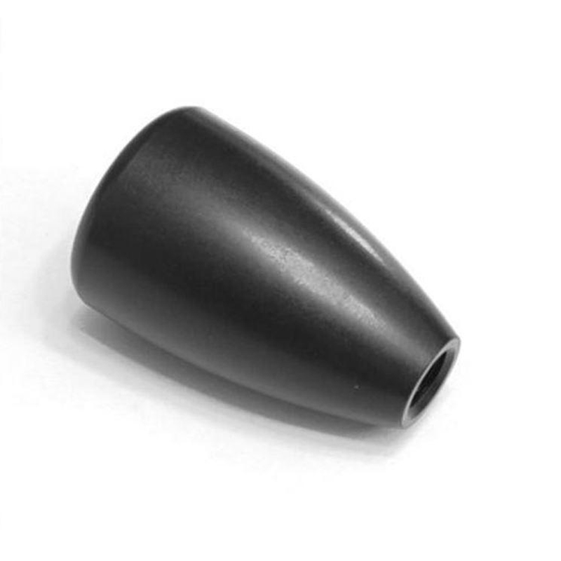

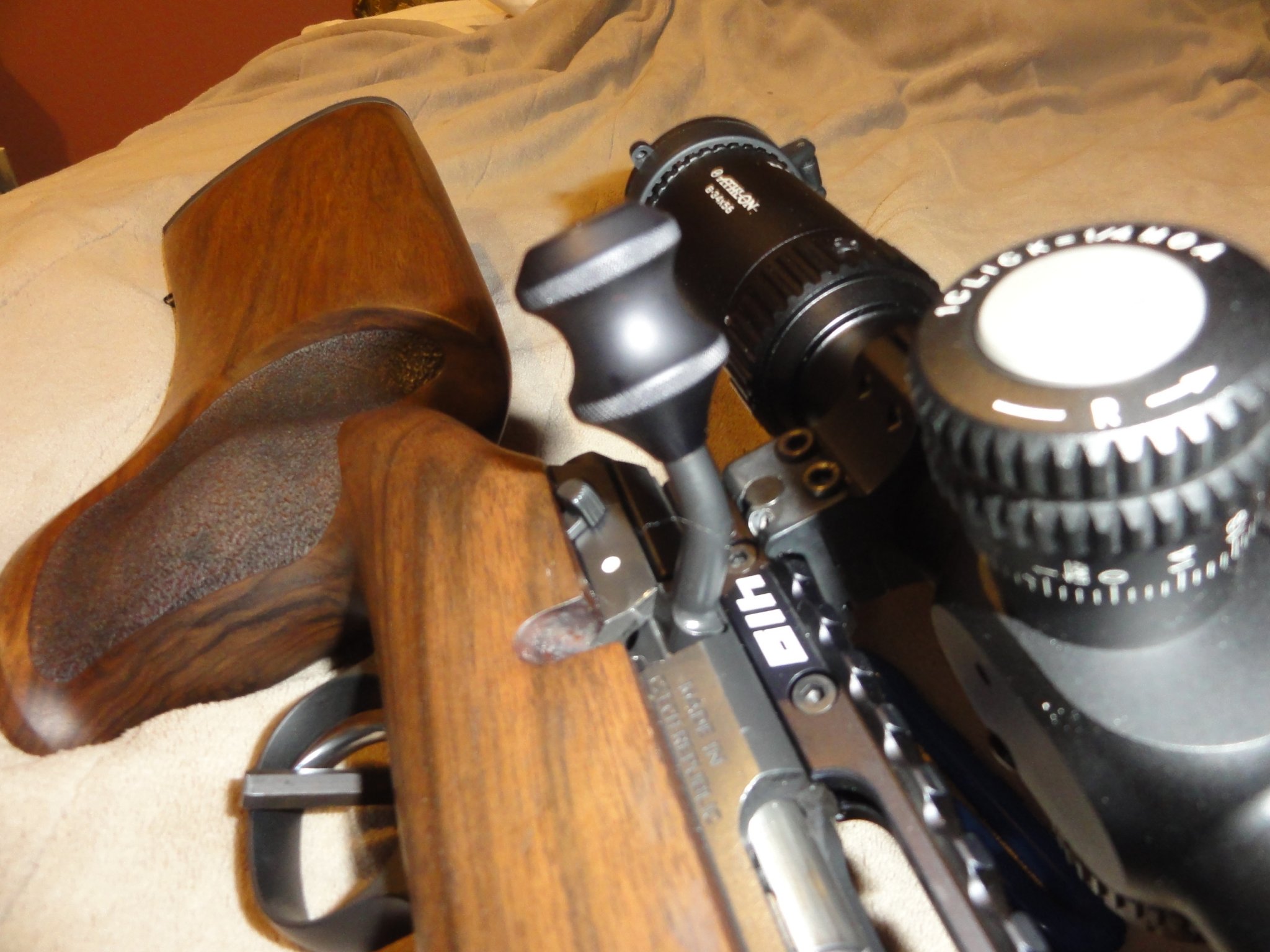

I'm getting a AREA 419 bolt knob for my CZ because I would like a something more substantial to grab onto.
The knob below is not what Im getting from 419 but if anybody knows where to get one like this, please let me know. It
needs to have 6mm threads. EDIT: Worse case I can get a threaded bushing of M10 and it has a M6 internal thread. From McMaster Carr.

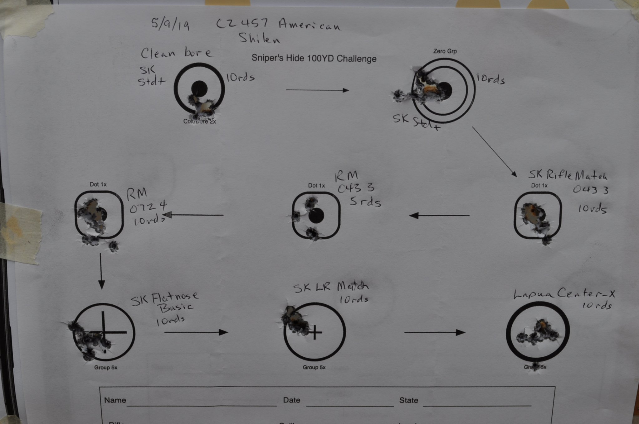

Went back out and shot again today, the gun did a little better, still not over the moon about it, but it was windy out there. I shot 5x5 round groups with each ammunition at 50yds, then a 25 round group at 100yds. All Velocity data is per LabRadar.
Eley Target
Avg 1123fps
ES 45
SD 12.3
50yd group avg 0.586"
100yd 25rd group 1.577"
Eley Club
Avg 1108fps
ES 40
SD 11.4
50yd group avg 0.529"
100yd 25rd group 1.765"
Norma Match
Avg 1071fps
ES 57
SD 13.4
50yd group avg 0.608"
100yd 25rd group 2.203"
Federal GMM
Avg 1101fps
ES 44
SD 13.4
50yd group avg 0.512"
100yd 25rd group 2.631"
CCI SV
Avg 1085fps
ES 62
SD 13
50yd group avg 0.606"
100yd 25rd group 2.839"
I just ordered a brick of SK Rifle Match and Lapua Center X to try out, maybe it will like one of them better. I cant wait until my AMG ships from Scott at Liberty Optics, this Viper PST is a POS.

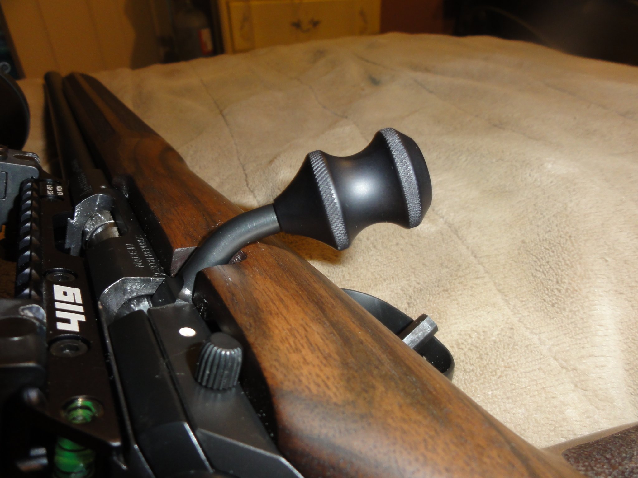

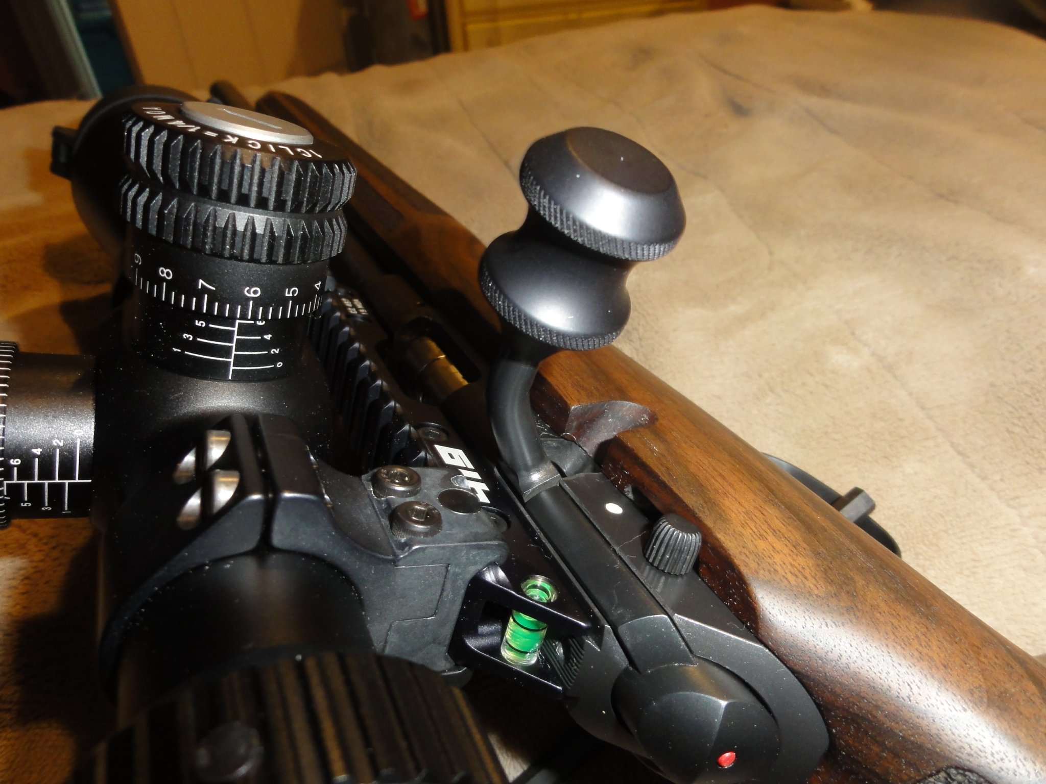

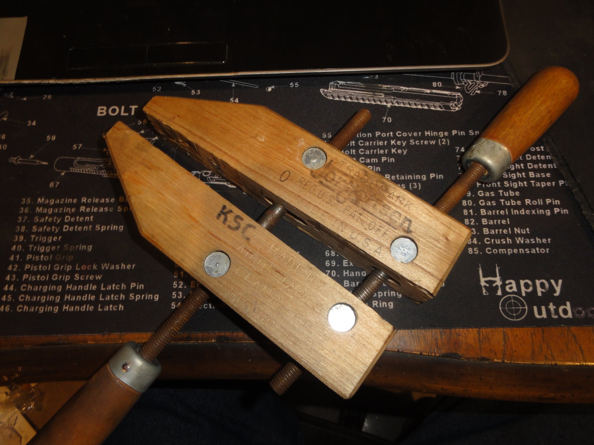

An FYI to you CZ 457 MTR owners ..... for those of you using the factory round ball, please don't. Get an AREA 419 bolt knob for your gun. I'm fairly certain that you will really enjoy the new knob. I did not think that I would care for it, but I was wrong !! It feels and works really well. You will need some heat to get the factory knob off and I used some parallel clamps made of wood to grip the ball. I let the heat soak into the bolt just enough so that it was hotter than I wanted to touch. I did not think that I would like the shape and I don't like knurling on a bolt knob. The knurling is just deep enough to aid in the cycling of the bolt. Well, as form follows function, this thing makes for a great addition to your MTR.
My option to wood clamps would be a thick piece of leather around the ball like a leather belt and some vice grips.
I like the 419 rail as well but.... you really cant view the level while your shooting. I found it to only be of use while mounting the scope.

+1 on the Area 419 knob. I just grabbed the ball with channel locks and spun it off, no heat needed for mine.
I'm just the guy that has to go backwards if I need to.... lol I'm glad you feel the same way. That little ball was bordering on unpleasant.
I also took the balls off my Annie's and replaced them with DIP knobs. What a difference one small change can make.

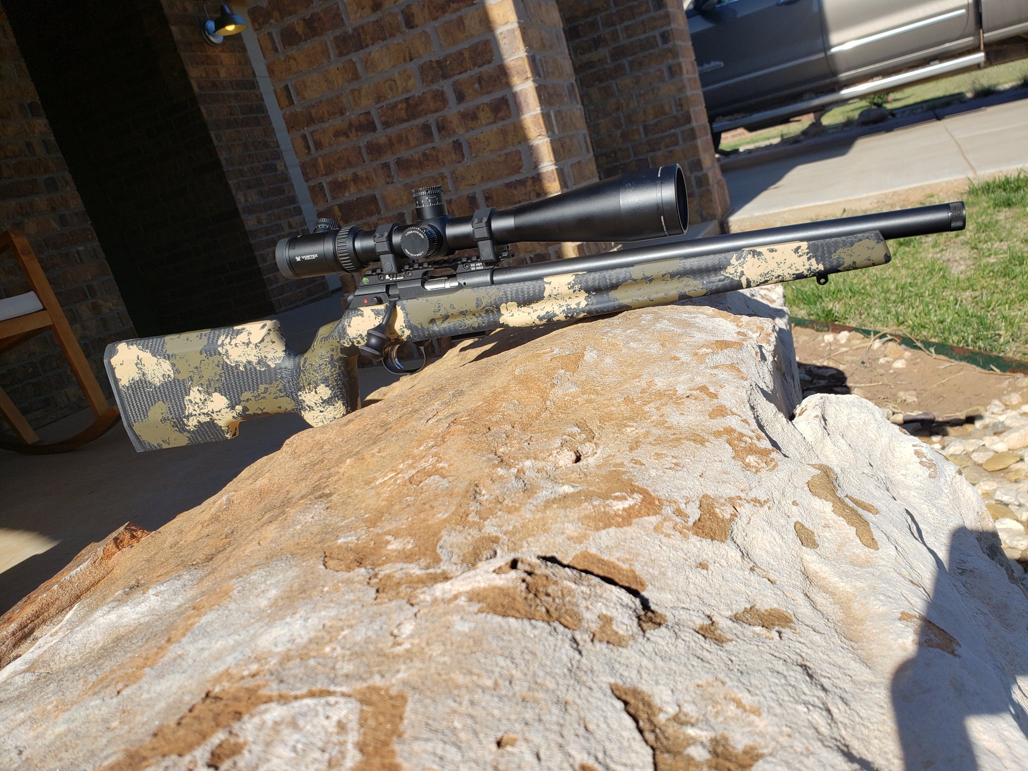

I just picked up a 457 MTR. Waiting for my Area 419 mount and scope from CS Tactical. Super excited to get into rimfire. Never had one before. I will start with 22LR but for some reason 17HMR is calling out to me. Will pick up a Lilja 17HMR ASAP.
Should I consider bedding the current wood stock (which I love the feel of) or should I pick up an MDT, KRG, MPA, or McRee chassis? If I choose the bedding route, what CZ 455 gunsmith do you recommend? DJ Dillion from RFC is no longer doing builds/accurizing.
Thanks!
Thanks!
This MTR is near stock and that is the way I would start off. I have not shot in many years and then it was air rifles. Your factory trigger should go down below a pound and feel very crisp. This is 30shots at fifty yards and the missed ones were me.
If you didn't get the 419 bolt knob, please do. It changes the feel tremendously. I also have two 1416 Annies and they shoot no better than this CZ. It is quickly becoming one of my favorite rifles.

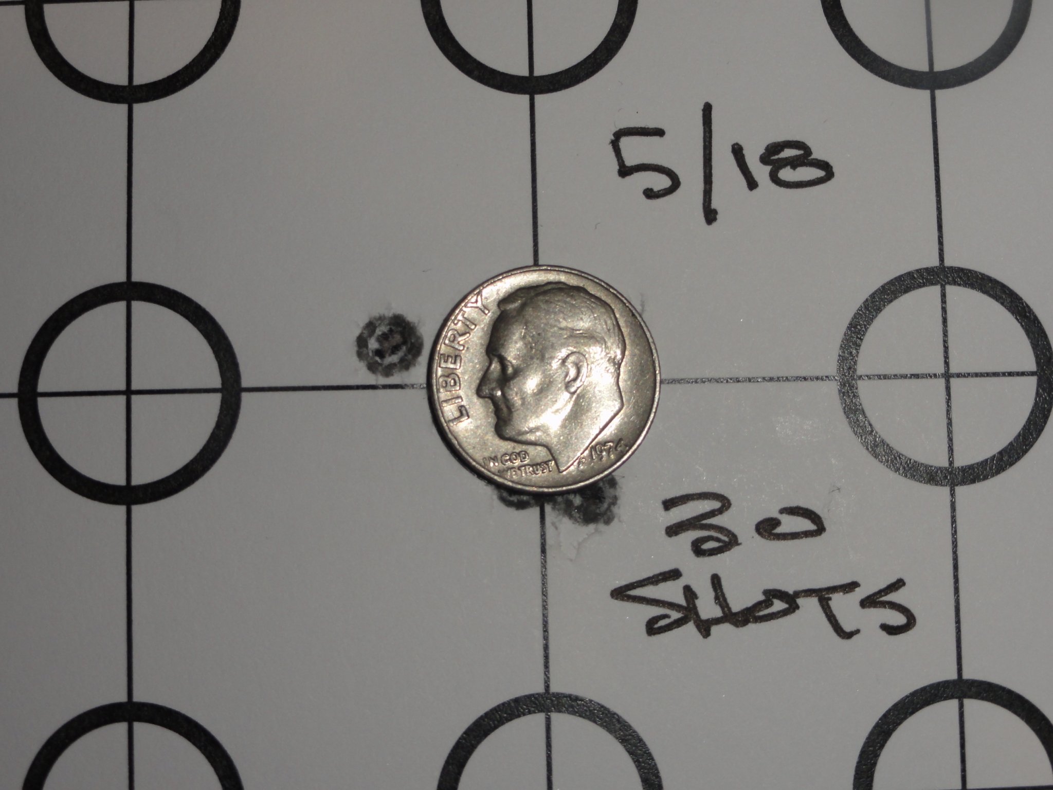

Ahhhh shit.My 455 American out shoots my 457 varmint.At least with ammo tested so far My Annie makes either mentioned look like a POS.
May I suggest SK red or Yellow .... they have shot the best for me thus far beating out ammo that cost 18.00 for a box of 50

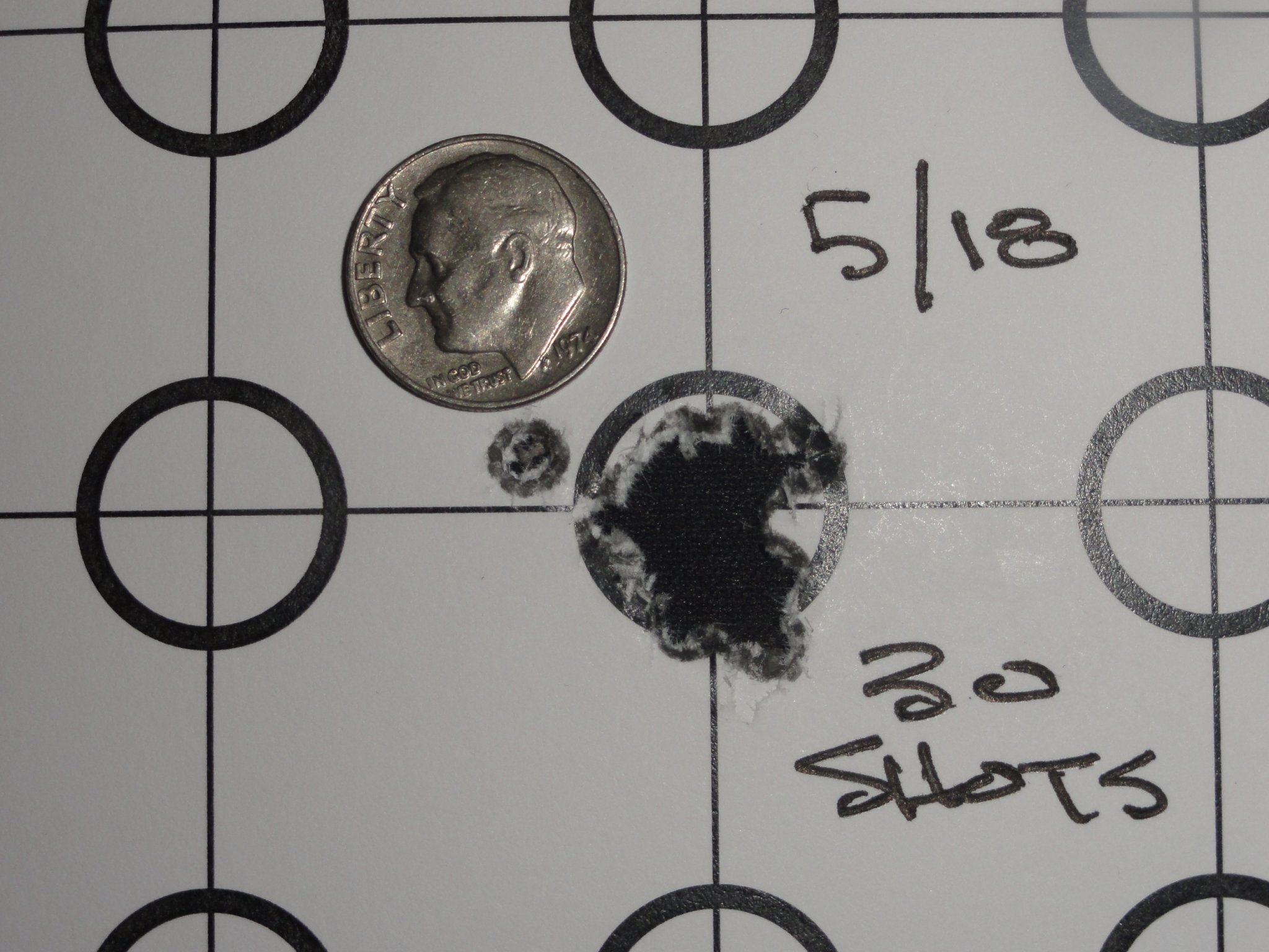

30 shots at 50 yards.
Your reading the max measurement. Not center to center.
It appears that all of those squares are CTC, they run right through the middle of the outermost bullet holes. My target software measures them the same way. What software is this? What is ATC?
Ctc and thos groups are literally the first rounds through the barrel. Not even broken in yet...
I have another new product I'm going to review here very shortly for the 455/457....stay tuned
I hear ya, but if that barrel is going to hold 0.5MOA with CCI SV, I need one.

You are going to be sooo happy that you got the 419 knob. I used some heat and wood clamp to remove mine. A YoDave spring kit got my trigger down to 9 oz. 30 shots at 50 yds. with SK standard plus. The worst flier was like my 4th shot and it was me not a cold bore.

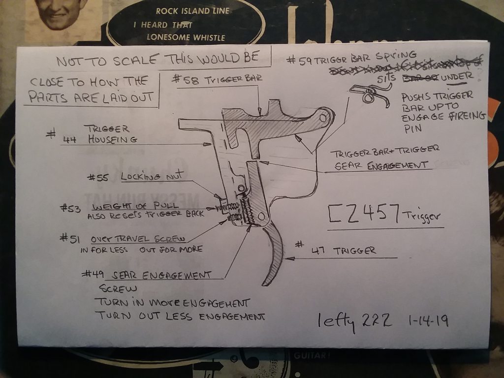

fully appreciate the 419 bolt knob. Lefty222 knows he has #49 backwards. I got my stock trigger down to 15 oz.
