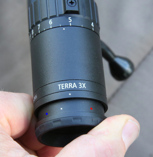

If the scope doesnt have it, put a little dot on top of the scopes objective. Then put a dot on the focus ring where its right for you. Put a dot where its right for him. Makes it easy to go back to a prior setting when sharing rifles.
Like maybe the red dot its for you and the blue dot for your dad. Quick reference.
