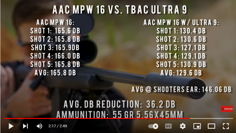

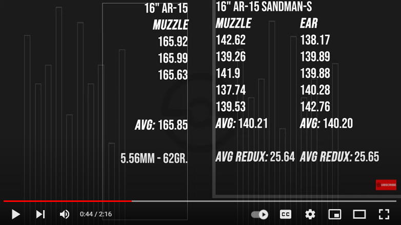

Using these two videos to compare my Ultra 9 to the Sandman. It's showing the Ultra 9 to be louder than the sandman at the shooters ear (146.06db vs 140.20) - somethings not right.
I'd imagine my ultra 9 to be very pleasant to shoot on 5.56, but what do I know?

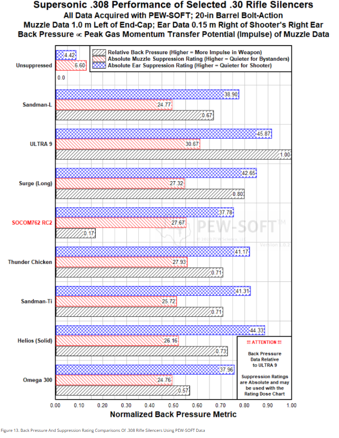

If that pressure stays in the can/barrel for long it'll come out the ejection port of your AR when the bolt cycles back. On a bolt gun thus isn't a problem.
That makes sense. Wish there was a place to go and just try these damn things.
So this chart is comparing the tactical cans to the Ultra 9 in 308. First question - how does this translate to a 5.56? It says that it's for a 20" bolt gun, so throw it in the trash when it comes to semi auto 5.56? It seems to show the socom beating the sandman in almost every category.
Not sure why he averaged in the numbers that weren’t suppressed to show the avg for both suppressed and unsuppressed
It says Avg for the TBAC is 129.6 vs 140.2 sandman S at the ear. Significantly quieter as expected
I was under the impression that the listing of shot 1 thru 5 isn't at the ear and thus a different volume. *pulls more hair out*
