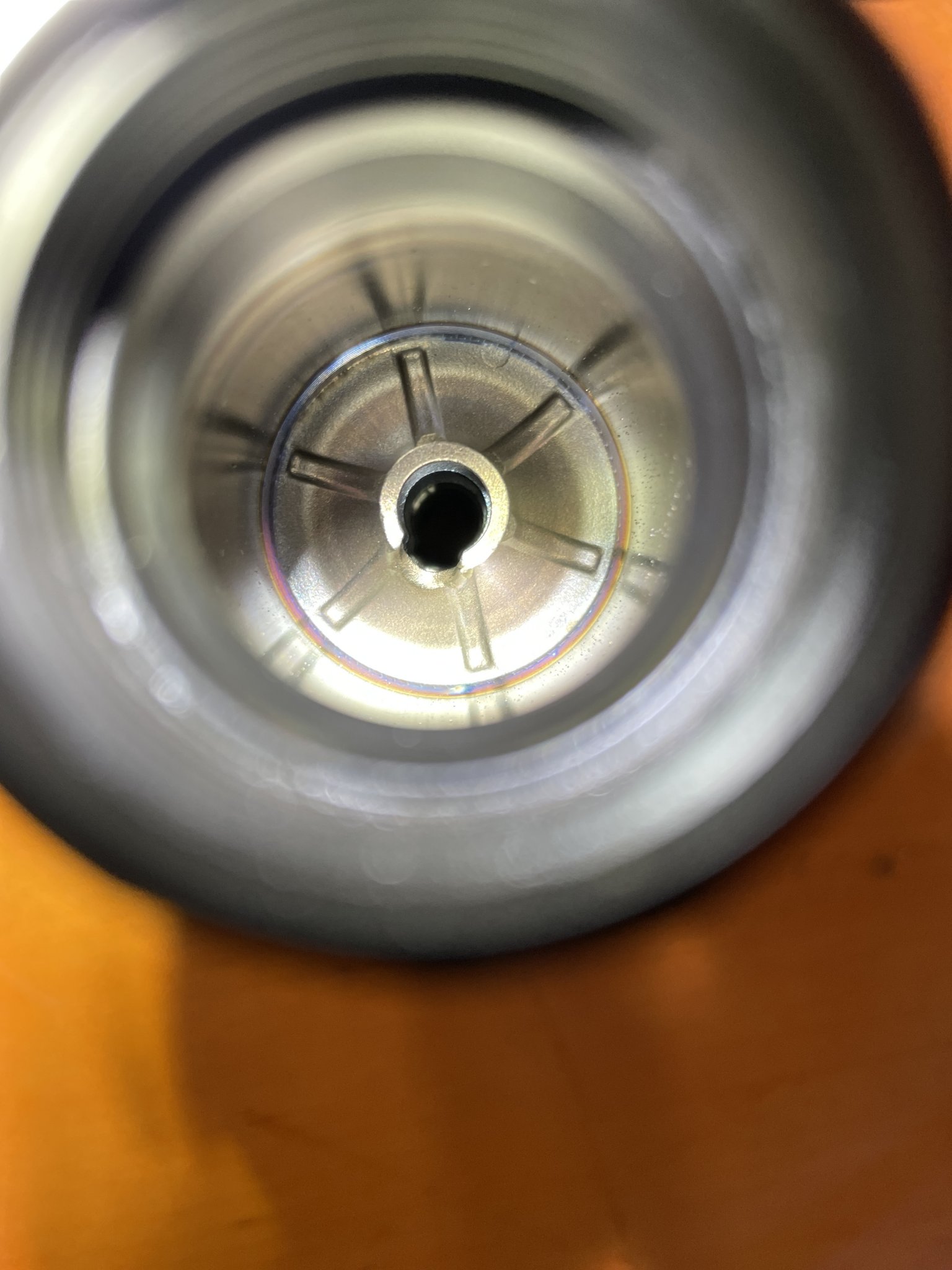

My Sierra 5 is back in hand. The rear baffle looks slightly different from the old, likely a tweaked design. Looks brand new and the weld on the rear baffle is clean. I couldn't get the Xeno mount adapter off as I think they use thread locker on it. Weighed in at 13.8 ounces with the Xeno, which is a bit heavier than I remembered it being. With the muzzle device, it's over 16oz so she's short and chunky. It'll be a bit before I can test it against the Flow 762 as Huxwrx still hasn't released their HUB mount yet.

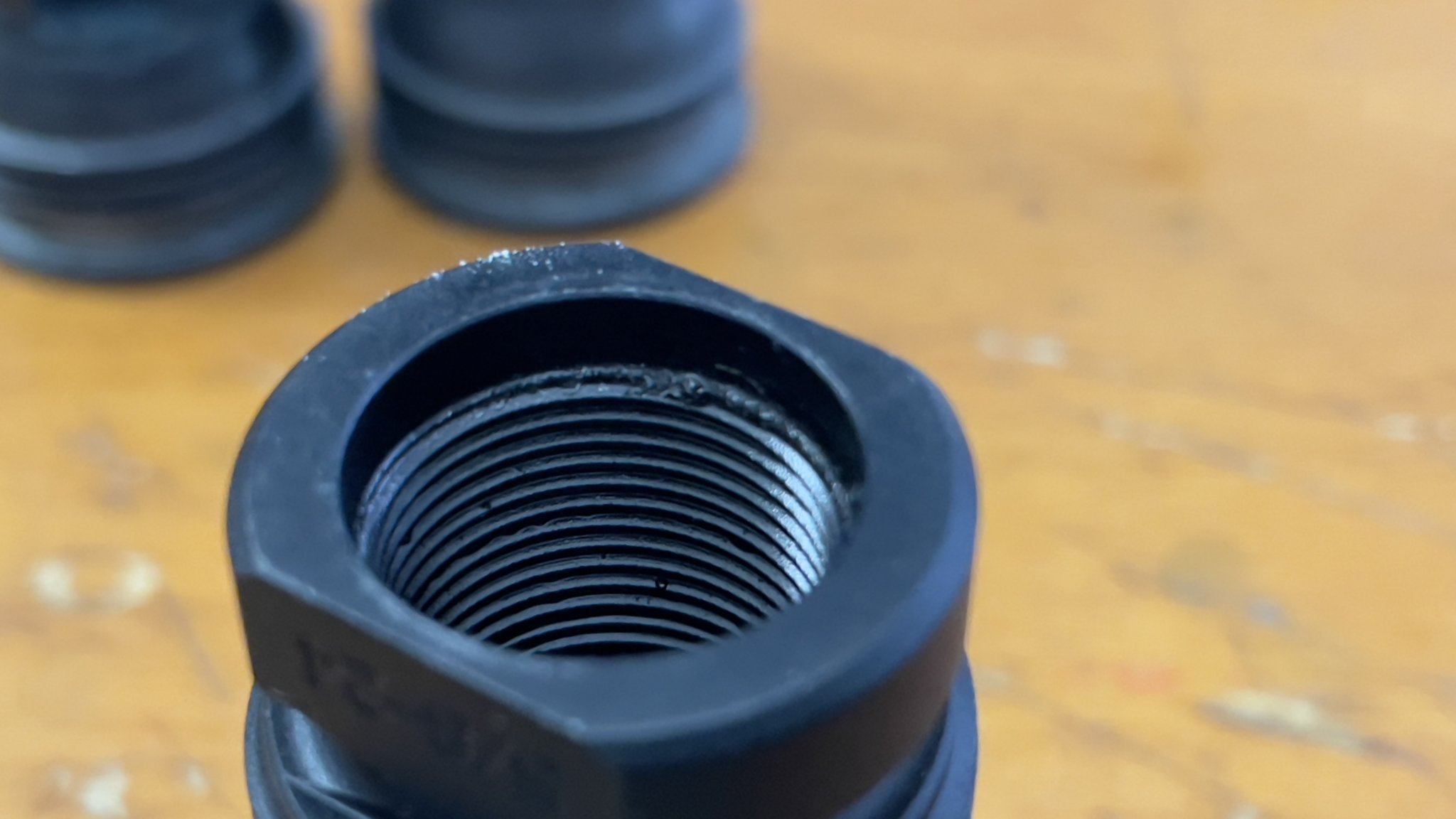

And I spoke too soon. My initial purchase was the Sierra 5, Xeno adapter and two 223 Xeno muzzle devices, one in 1/2x28 and one in 5/8x24. The larger one is for a custom X-Caliber barrel I had made and decided to go with the larger threading.
I mounted up the 1/2x28 yesterday and checked for alignment. It isn't spot-on perfect but it's shootable. Today I installed the 5/8x24 flash hider on the X-Caliber and sure enough, it was off. Enough that I can't shoot it. When I first tried to install it, I got maybe a thread or two in and it just stopped. Yes, I cleaned the threads prior. I pulled it off and tried two other muzzle devices, one from Sig and one from Huxwrx. Both glided right on, no resistance.
I checked the muzzle device and it was labeled 5/8x24. Tried again and was able to get it on with a bit more muscle (not overly so) and screw it all the way on. Definitely not like butter. I tightened it down, installed the Sierra 5 and then slid the alignment rod down. It's clearly skewed to one side by a good bit. The rod isn't touching the flash hider prong on the end cap but it's damn close.
I pulled the muzzle device off and the first two threads are no longer black, they're now silver. I've already sent an email into Dead Air to see if they'll exchange it.
For shits and giggles, I re-installed the Huxwrx muzzle device and checked alignment. It's spot-on dead center with the suppressor. Two of them in fact. I own probably $1K in Hux muzzle devices only and none of them have ever exhibited alignment errors.

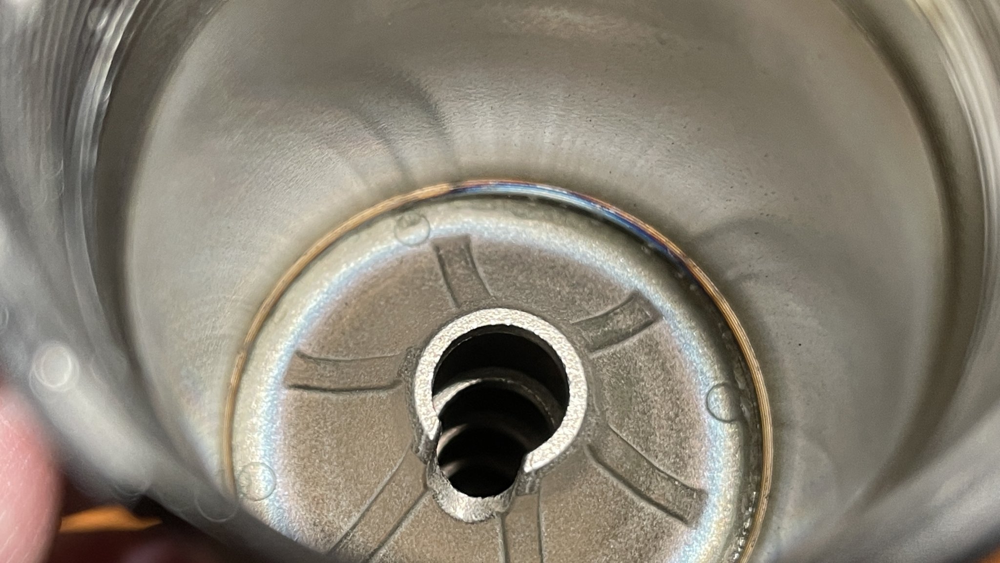

Here are a few pics, old and new baffles. I couldn't get the Xeno adapter off to gain the same perspective.
OLD
NEW below
Looks like DA revised the baffles. So much for the white knights claiming KGM was at fault.

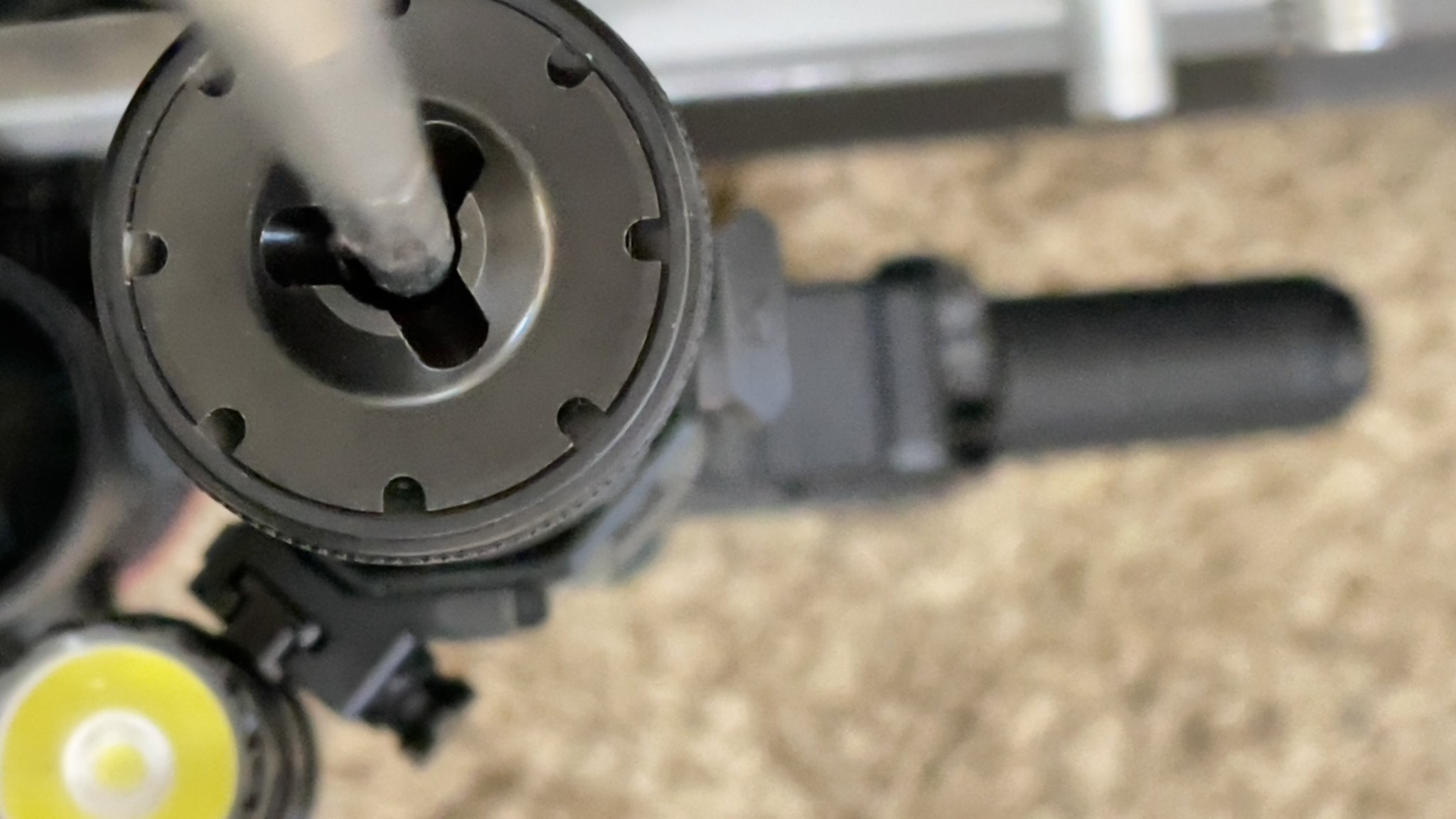

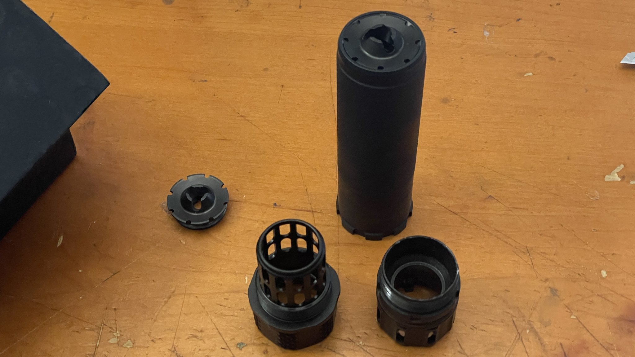

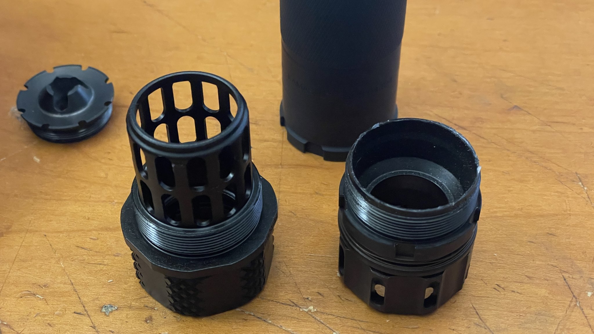

Latest with my Sierra 5, had to send it back to DA as the rear mount (Xeno) would not come off, even with an impact gun and copious amounts of heat. My strap wrench marred the finish but didn't really care and I literally bent the shit out of the included wrenches trying to get it off.
Sent it back the end of February and received it today. They actually refinished the can, looks brand new, but threw a Keymo mount on the end, LOL. They also put a new flash hider cap on the front and included the old one for some reason. I hadn't tried, nor intended, to remove and replace the front cap even though I did order a cap wrench just to have. Luckily the rear mount came right off this time and I swapped in my Huxwrx QD HUB mount. Wasn't 100% sure it'd work but it's perfect. It's a few grams heavier than the DA Keymo mount but it's more important I can keep my muzzle devices consistent. Wrenches didn't get replaced, I still have a wavy-ass set of wrenches but it is what it is.
Let's hope this is the last time I have to deal with issues.
Reactions: kthomas and FuhQ

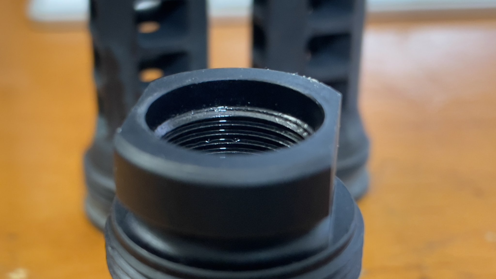

They left all three of my Ti’s full of blast media, found it after the first couple shots when I set my rifle in the rack and completely coated the inside of my barrel and action. Had to tear it completely apart including removing the barrel and trigger to get all of it out.
I spent hours and multiple cleanings trying to get it removed from the cans and still kept getting some in the action for a while after shots knocked more loose. Took several range trips and cleanings to finally stop getting the media in my actions.
As I’ve said before Fuck KGM.
