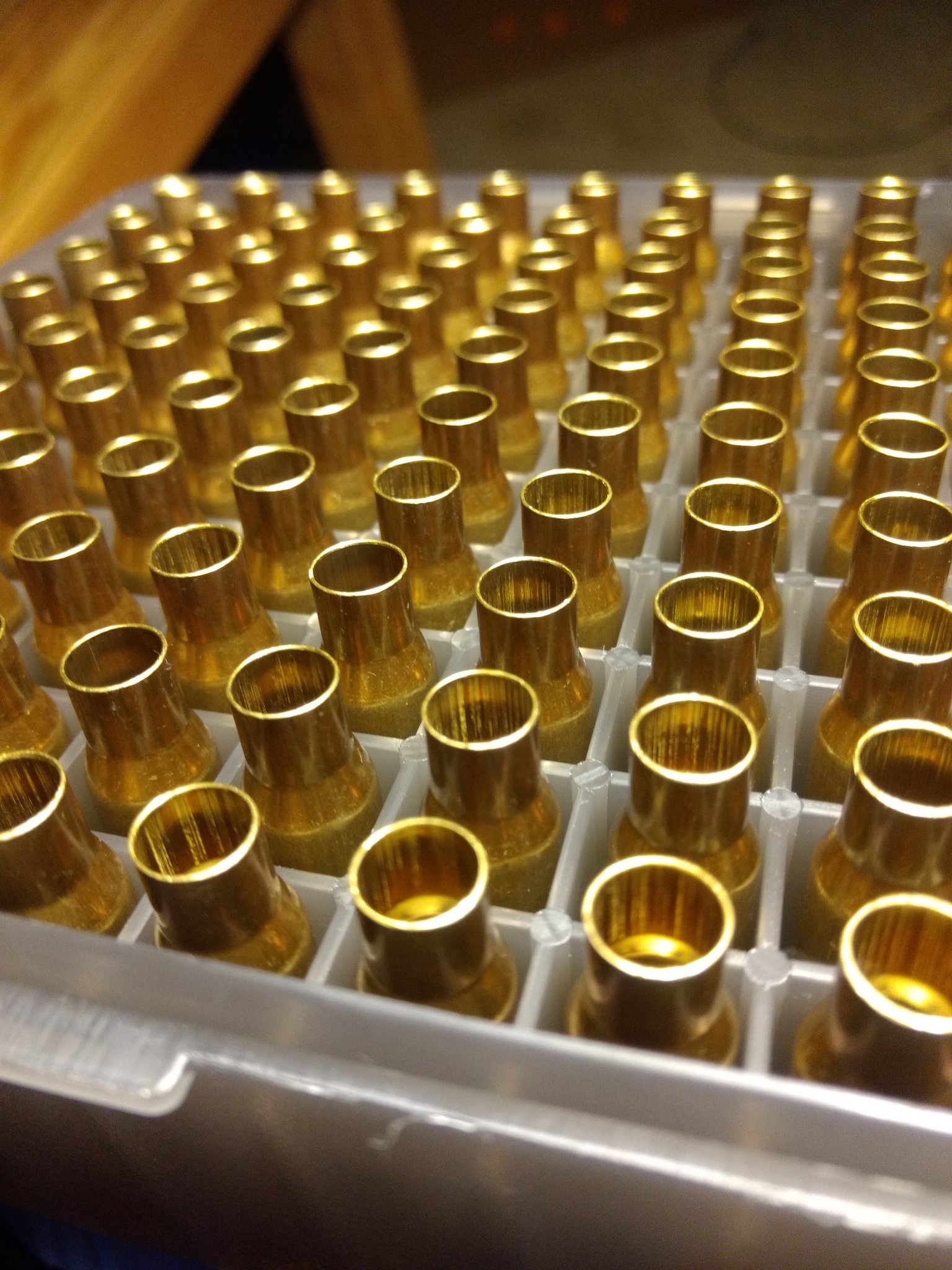

Hello all. Finally purchased some new 308 lapua brass and a Sinclair Mandrel die body. Thought it would be a good idea to finally try out the Neck Turning Mandrel with straightening out some dinged Lapua cases (dinged from shipping)
after I lubed the Mandrel with imperial sizing wax I noticed the cases were a little stiff going in and out of the die body. Low and behold I was creating some very apparent scratches on the inside of the necks!! Not sure if it was lack of lube, or maybe a ruff mandrel. But the main question is how bad is scratching the inside neck?? I would absolutely hate to ruin virgin Lapua smh.

It's hard to tell from the pictures but are they actually scratched or gouged or is it just from contact with the arbor creating the shiny linear lines ?
Use a tooth pick and feel around in a few to verify if you haven't allready.
I use the Tin coated 21st century mandrels and arbors and have never noticed anything like that before.

I did run a cotton swab around the insides and some seemed rougher than others, but mostly all cases would "grab" the cotton. I'm not sure if the cases are scrap now or if I should load and forget about it? Possibly firing them would do some good or make the loads shoot like shit.
If the scratches aren't extreme I wouldn't worry to much about it, if it really bugs you you could wrap a bore brush with some 0000 steel wool and polish them up a little chucked in a cordless drill.

The mandrel doesn't look bad? It does have some brass markings on it tho.
Sounds like you have a uncoated stainless one and it wasn't lubed very well.
I've never used Imperial wax but I hear it's pretty good stuff, been using the LEE sizing paste in the tubes for 25 years and never had any issues so never changed.
I use it for everything from sizing to expanding and turning necks with great effect and it won't contaminate powder or primers either.
This is one reason why the Sinclair carbide mandrels are better. They’re WAY more forgiving on lube.
I doubt those are scrap, clean your mandrel up, neck size those down, and run them through the mandrel again but make sure you live the inside of every neck with a q tip. Skip the wax and use a thinner lube that's easier to spread.
Reactions: Cookieman8
Just went through the same thing I polished the stainless mandrel and it helped but ultimately ordered the 21st century TIN coated mandrels which as someone said made it much more forgiving and the brass dosent stick to the mandrel which caused those gauges for me I wish I took a pic but I had small dots of brass stick to the stainless mandrel around the circumfrence no matter how much imperial wax or one shot I used

My mandrel has brass on it as well, and possibly the carbide mandrels from Sinclair would work better?
I went through the same thing using a lubed and polished mandrel. Though the marks weren't as bad but made me notice them. They shot just fine
The carbide mandrels do work well.
You'll need to remove all brass from your steel mandrel before using again or it will keep galling the necks.

I tumble virgin brass with nu finish cut with mineral spirits.
Gets a coat of polish in the neck.
I dip to the shoulder in dry lube tap out excess and they do not gaul like that.
I think virgin brass and wet tumble / sonic cleaned are too dry no lubricity.

Would you guys recommend stepping up to a Sinclair Carbide mandrel for future use? Or possibly getting the 21 St century TiN arbours? (I believe those are .002 under neck diam.)
I have a full set of sizing and turning Sinclair carbide mandrels for all the calibers I shoot. They’re phenomenal and have become a critical part of my process.
I’ve only ever head VERY good things about the 21st century mandrels, I’m sure you will be fine either way.
The increased hardness and inherent lubricity of either will be vastly superior to the stainless ones.
My regular stainless mandrels work just as well as my 21st tin do. They just need lube inside the neck. Even carbide will do better with lube inthe neck. Theres no getting away from needing lube.
Yes. I have carbide and I lube them generously. Even carbide, as you say, will gall the piss out of a case neck if your brass is perfectly clean(wet tumble/new)
