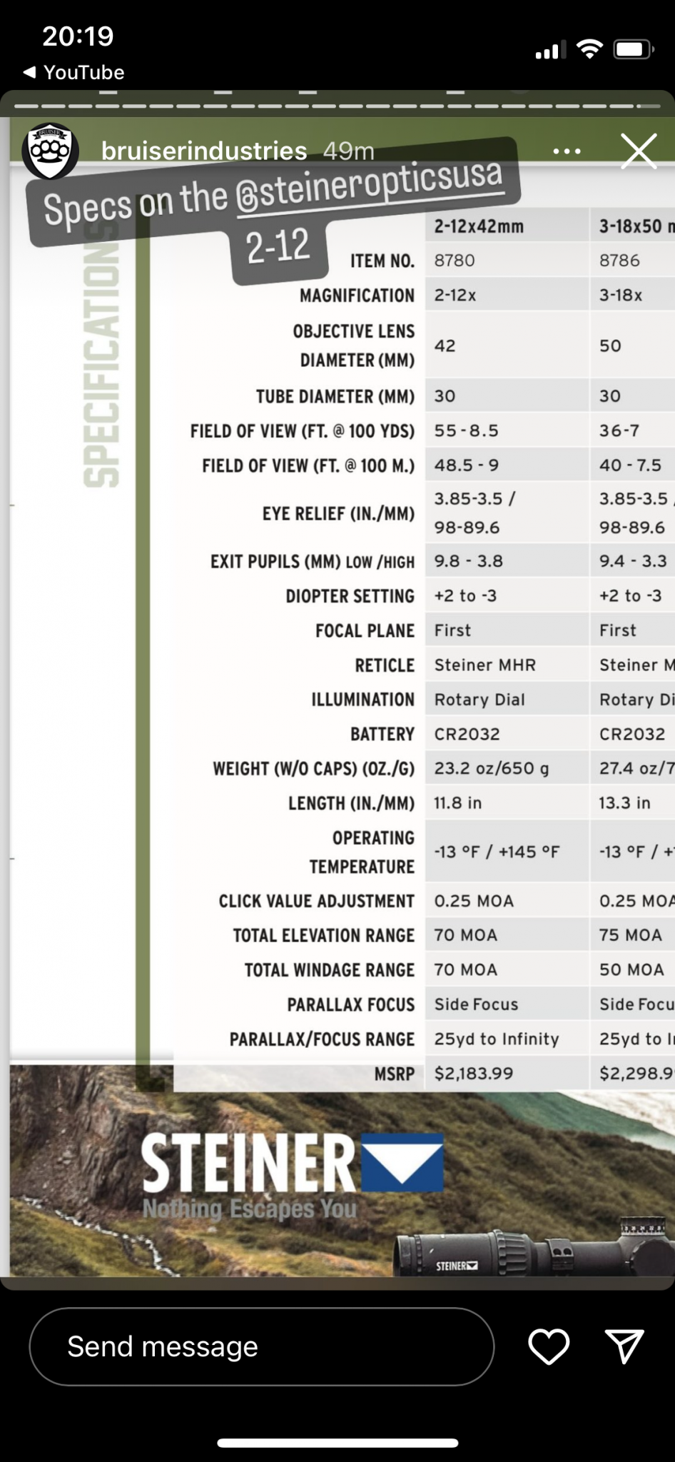

For the optical system Steiner uses, it should be right around 9.2ft at 100 yards on 12x. That makes for an apparent FOV of right around 21degrees. Once I get my hands on it, I'll measure what it is exactly, but these numbers should be in the ballpark.
ILya
My guy in Greeley is pretty sure that's a typo. He didn't have to correct figures off the top of his head, but he said there shouldn't be much deviation from T6Xi figures.
I think Ilya's numbers on FOV are going to be closer to accurate.
Thank you Bird, I was hoping that might be the case, sure would be nice if we had official numbers. I am looking forward to the new Mil/Mil H6Xi so hopefully they can bring that to market soon...

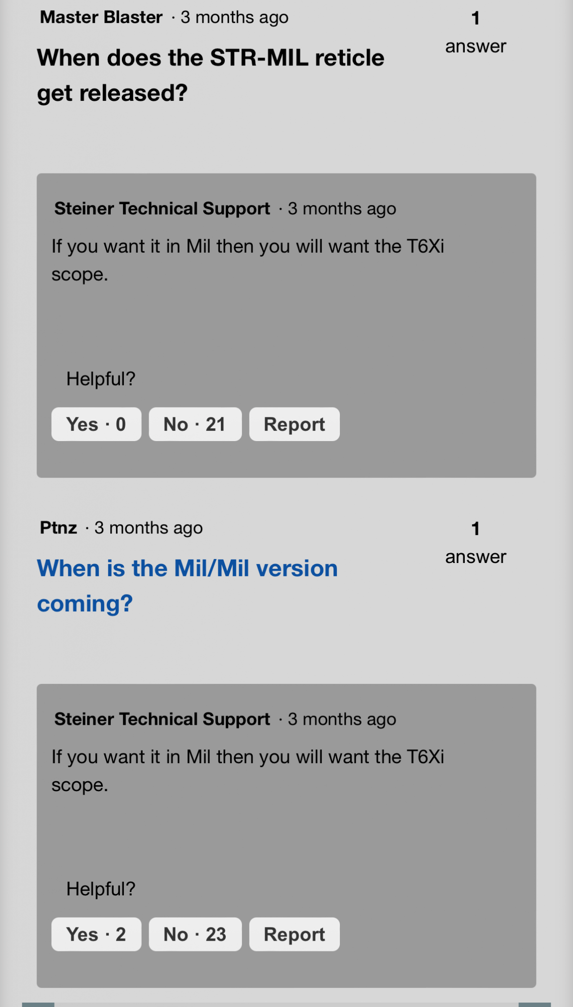

Here’s what is posted by Steiner every time someone asks about a mil version:
Did they not get the memo yet?

The videos say April-May….really want to read a review or see a video. I’m tempted to order the moa hunter reticle version…as this scope seems to be the exact glass I am looking for for my mini fix.

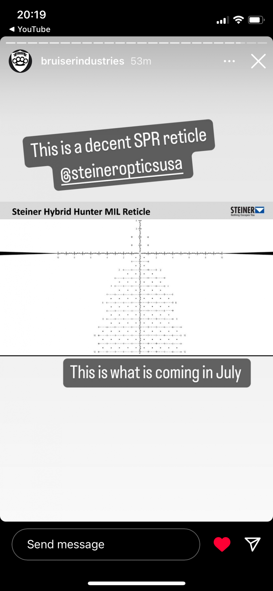

I agree that this is a ridiculous reticle for a 2-12x scope. The possible saving grace is that it looks like it still may retain the heavy pointed stadia that will act like a duplex at low power and light.
I guess it remains to be seen.

Personally I’d much prefer the same hunter reticle as the MOA version, but in mils.
And while it is much too late for this version, I’d like to see the 2.0 mil hashes to be visually more noticeable on both sides and bottom. As a low power and light focal attractor.

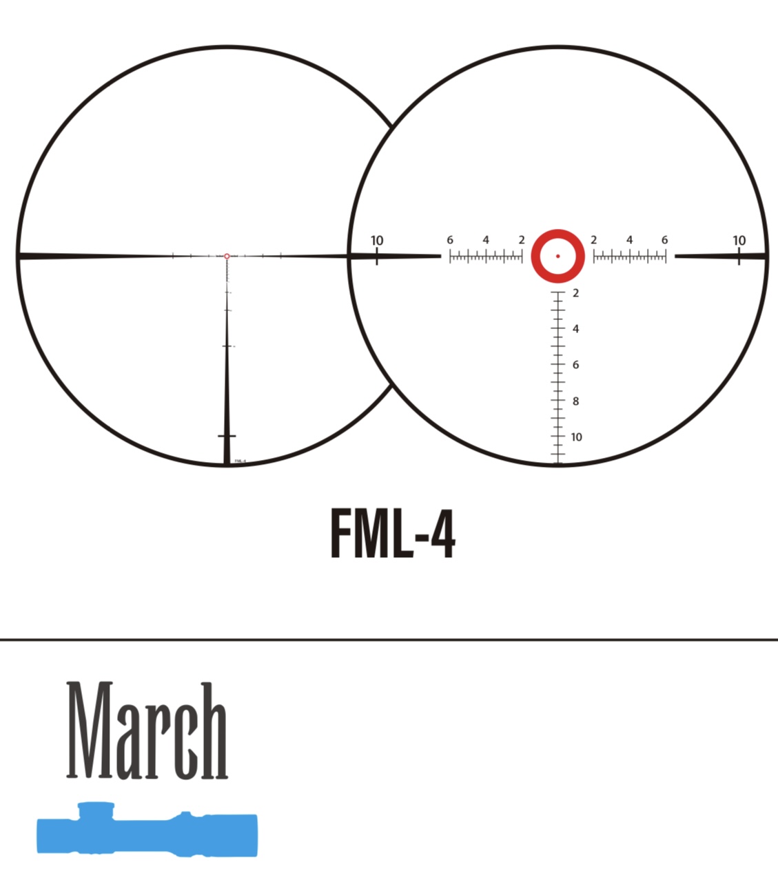

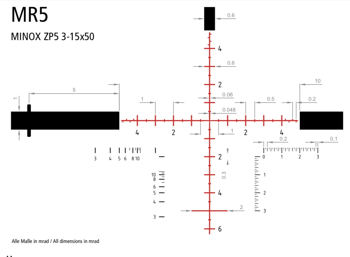

Marry elements from March & Minox and it’d be ideal.
Tapered stadia (draws eye to center), only go 2-3 mil up on vertical stadia, carry thin part of stadia down 10mil on vertical and 5mil L/R, donut (but thinner and at 2mil radius), stadia thickness 1.0mil at fastest part so easy to see when zoomed out, could live with either 0.2 or 0.5mil markings.
