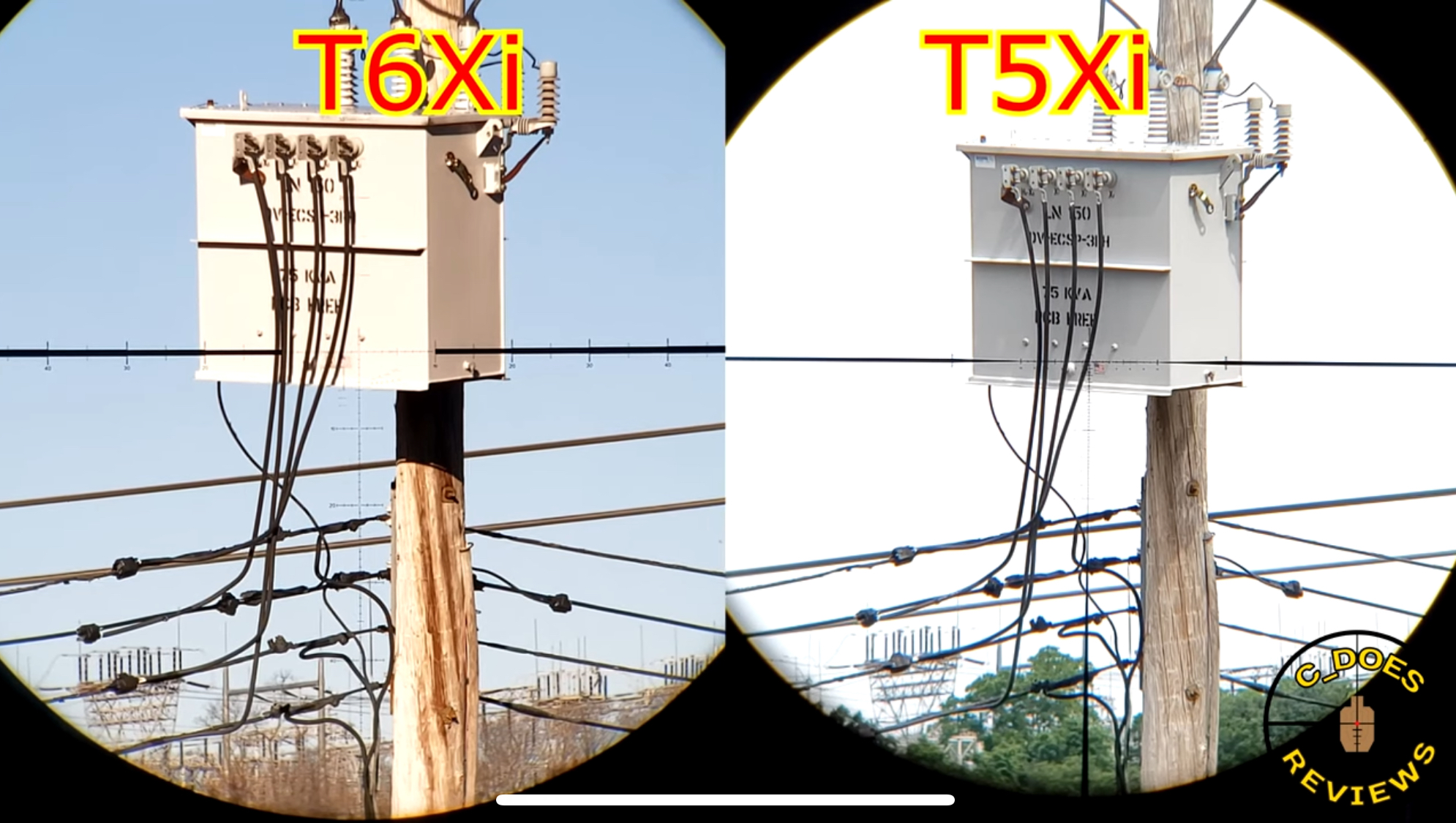

C_Does just did a video of the T6xi 3-18 (MSR reticle) and had a comparison with the T5xi 3-15 (SCR reticle) The SCR in the T5 has similar tapered posts as seen above. Got a screenshot of both at 3x. Maybe this will give some ideas as to how it may look. I never recall any issue picking up the SCR reticle in my former T5xi 3-15.
Obviously we should all wait an actual review for the H6 and its reticle before jumping to any conclusions.
This image does a great job of showing how manufactures aren't making reticles that are actually fit for purpose.
Both reticles here are too fine, I can see why they would be this thickness for a 5-30,6-36 type scope, but a 3-18 will never have the issue of these reticles being too thick on 18x.
The comes the real kicker, even if you wanted those centre crosses being that fine, what are the thick outer stadia so far from the centre?
Again for a 6-36 or even a 3-18, you might want 10mil of wind holds, but for a reticle going in a 2-12 that you expect to be able to use the 2x without needing illumination, then bring the outer stadia into 4-6mil.
I know you can use thin reticles on lower magnification, but a thicker, easier to see reticle is faster to pick up under all circumstances, and will always be easier to use in low light. A reticle that has been designed, or even just sized for use in a 5-30 isn't going to optimized for a 3-18 or even worse a 2-12.
I think the 10mil thing is for the aesthetics. Personally, heavier lines ending at 5mil from center, and 10mil low would work better in a 2-12ish.
But I’m not the one being paid to design a reticle. I’d do it for free if asked, just give me one of the production models.

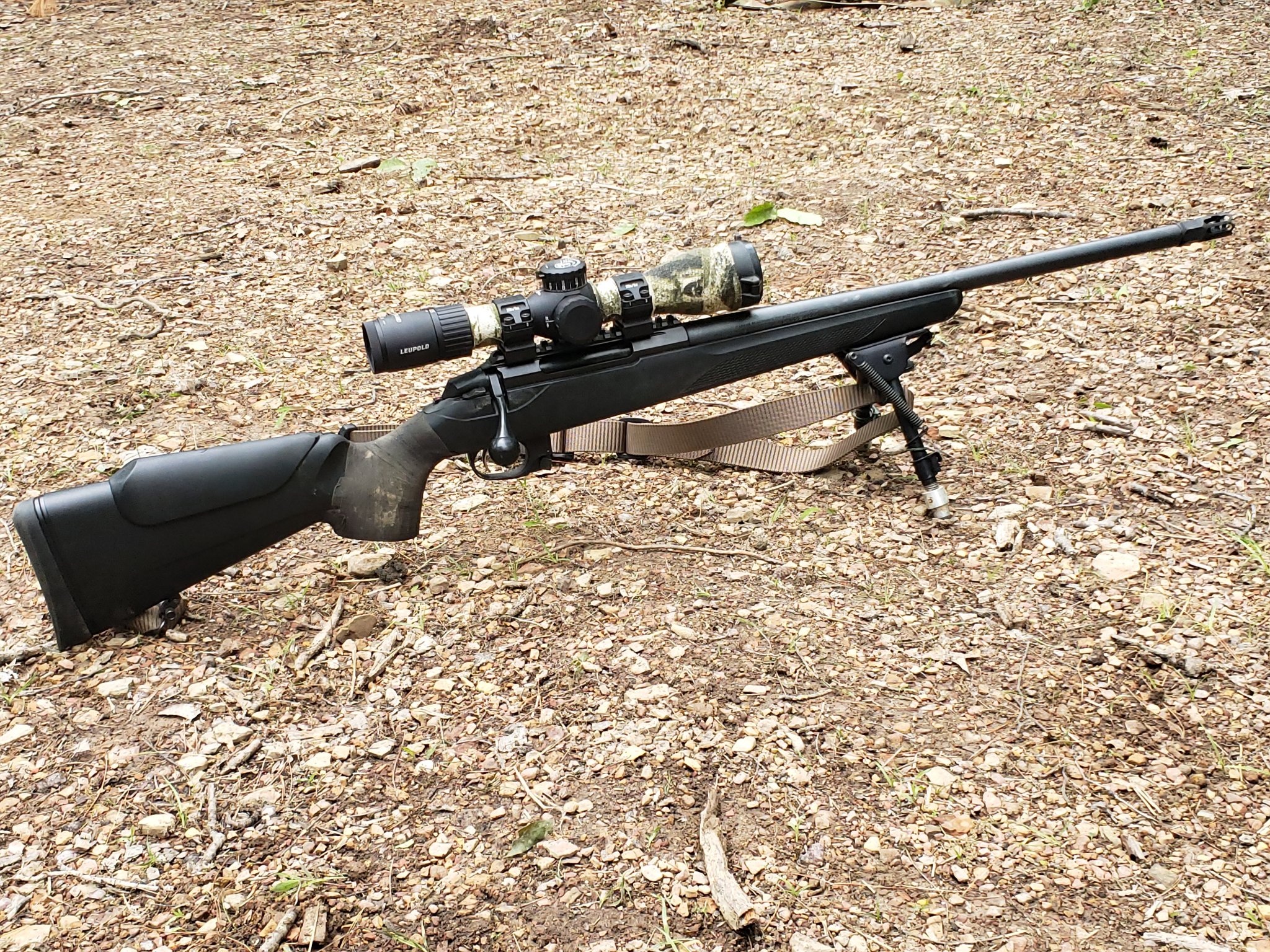

You may be in luck with the Mk4HD 2.5-10x42. I just ran it on my Tikka CTR at Woodland Brutality and am extremely satisfied with its performance.
Thanks I’ve been considering the MK4HD, so glad to hear you liked it. The fixed parallax at 150 yds did not present problems?

Mine will be getting a workout this weekend on my beater Savage 223. I really should get one for one of my 20” ARs also.
