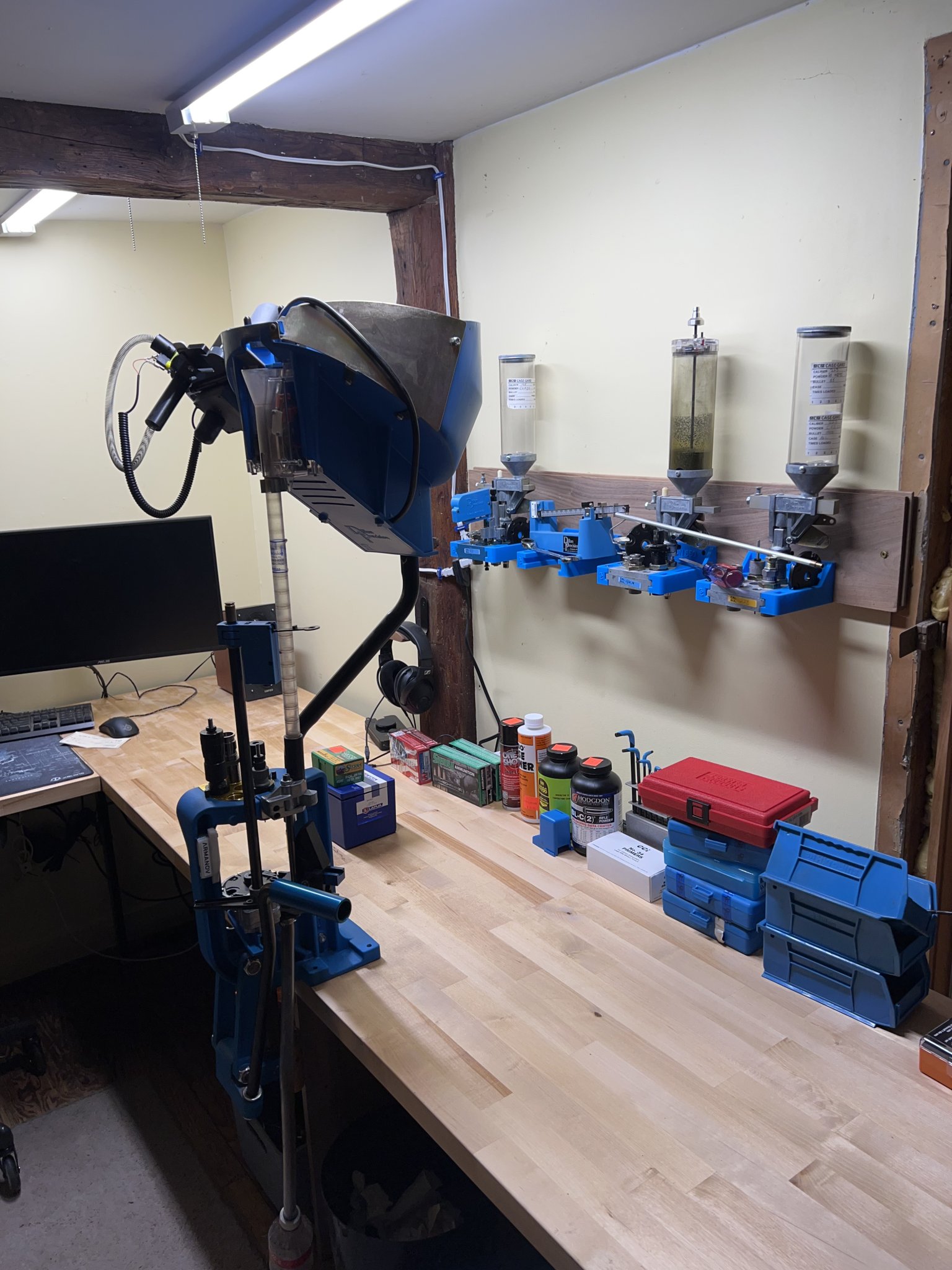

For those who use a Mr. Bulletfeeder, this is a nice piece of kit. Greatly increases your range of attachments, though it is probably more suited for a moving toolhead press like a 1050 as the moving shellplate presses don't offer the same complications of varying tensions on the bullet delivery spring. Anyway, I have one of my extra Mr. Bulletfeeders on one and then a pipe on a flange on a 2x4, which I can clamp down to a workbench if I want to attach MBF to something like the Lee App press, or to lend it to a friend who might need it for something.
I ended up picking up the 650, been trying to get everything together and set up to start reloading. Picked up some forster .308 sizing and seating dies, lapua brass, some smk 168s, a few different powders, cci no.34 primers, and a conversion kit to get another head setup for doing 308.
Looking at buying an area 419 funnel kit, and i need to figure out a a scale setup, then i should be ready to go.
Thanks for all the help.

Was just looking into them and I’d probably do the 4”.
