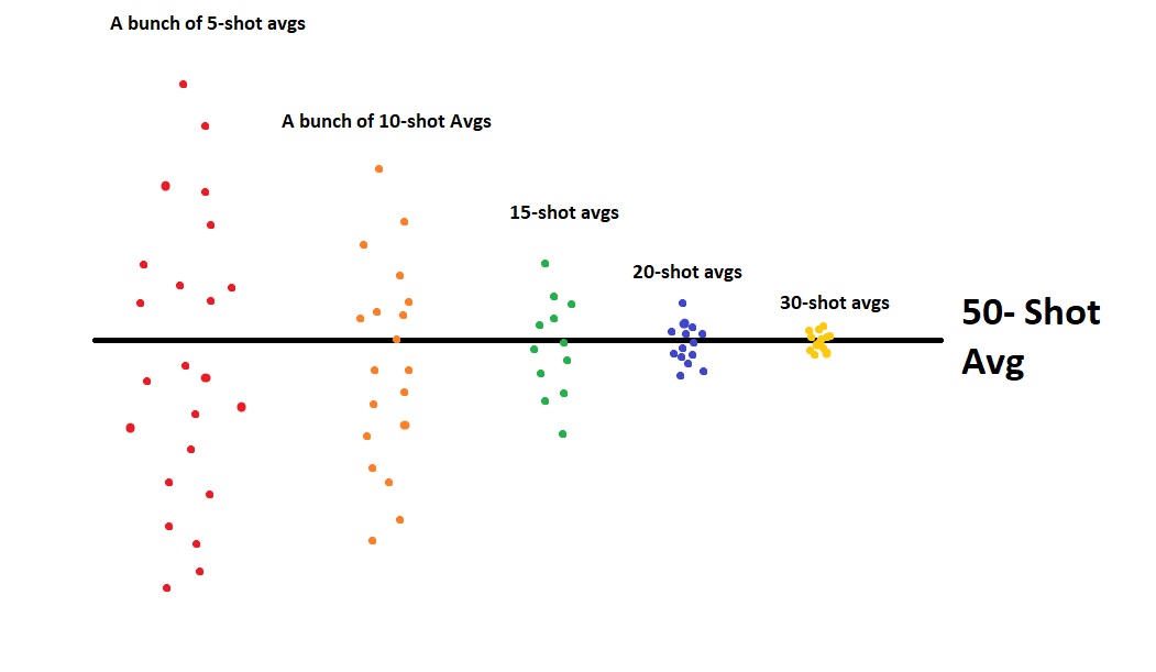

Just be careful using SD's with small sample sizes (under 20-30).
I've been doing a lot of testing lately with 30-50 shot sample size and the results are kind of surprising in a way. I haven't done enough to come up with a definitive load development method yet, but I will tell you that 5-shot sample sizes are for sure subject to be a total lie. The more testing I do, the more that statement solidifies.
If I take one of the 50-shot data sets I've collected then have Excel randomly grab 5 of those shots, then grab 5 more, etc.. and build each 5 that it grabs as a data set with an Avg velocity and SD, it will look like the red dots below. Then do the same thing for 10, 15, 20, 30 shots each....
Now what the outer bounds are-- the highest and lowest point-- varies greatly from combo to combo. I've shot rifles that had a 36fps ES, and some with 80fps ES. 0.95" 30-shot groups and 1.6" 30-shot groups. And like I said there's still a lot more variables I want to meddle with...
The point is that every 5-shot group you shoot represents any one of those red dots, and you gotta shoot 6+ of them and average the combined results to get decent data that's worth doing any statistical analysis that you'll use to make confident decisions. 20-shotters for the most part are what seem to be the lowest number of shots to get you a good picture. Same goes for Average velocity and velocity SD. 5-shotters of the same load are subject to bounce around quite a bit. Some are truthful, some are outstanding lies, and some (contain the extreme spreads) are dog shit lies. You never know which until you shoot more.

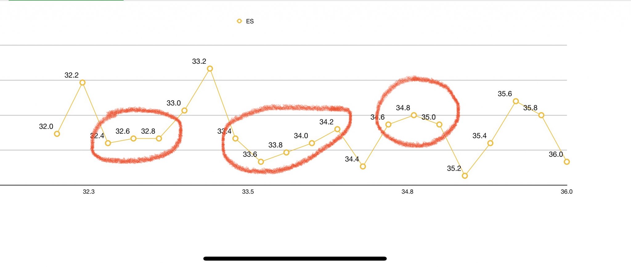

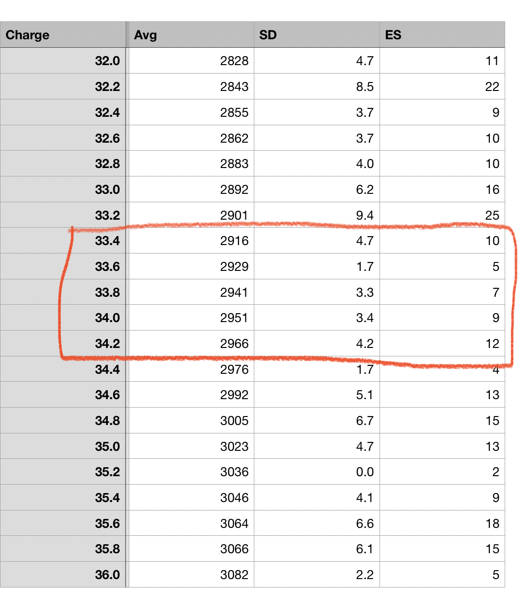

No. I was making a point that not every primer/powder combo will have flat spots in velocity.
My 6gt with cci 450’s and varget will keep climbing on average about 12fps for every .2 charge. From 31gr all the way to 36gr.
Which is why I look at ES to determine nodes.

Keep looking for one...heh. Sometimes you have to go slower...eventhough you don't want to...to find that good sweet spot. It will be there though....just got to look for it.
Here is an example of no flat velocity, but still 3 nodes based on ES:
That’s great data. It would be interesting, if laborious, to record the position of each shot too. You could then make simulated groups along with your simulated ES.
