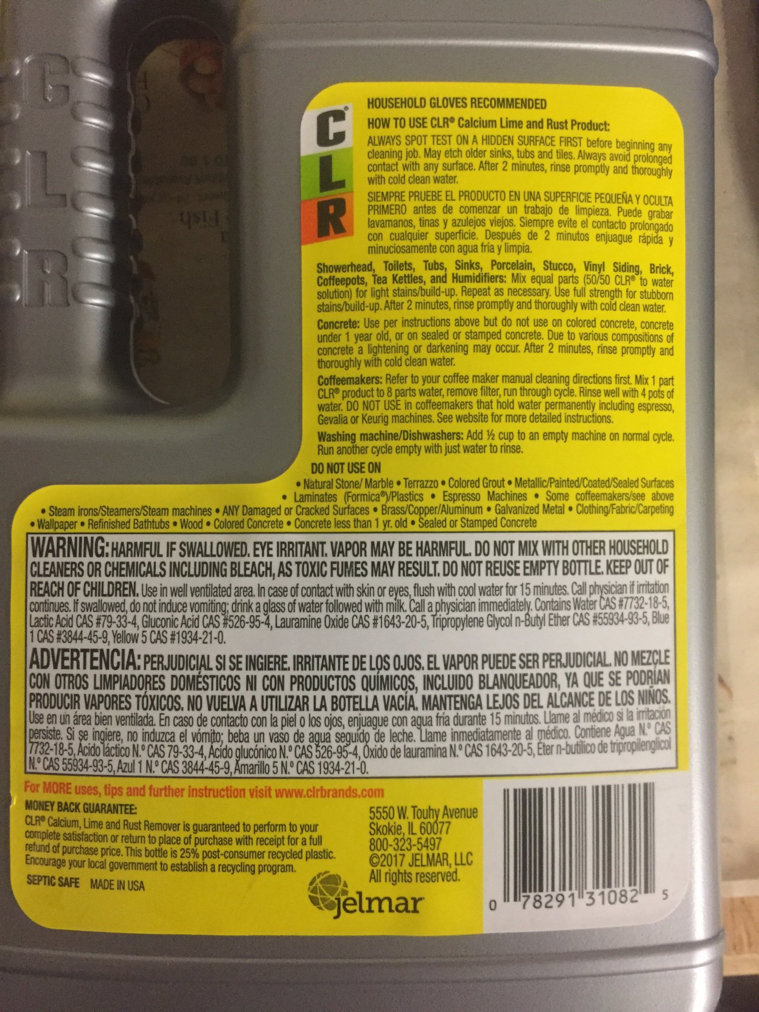

Cleaning with it, and soaking something in it or storing it in a us cleaner are very different. After killing an us cleaner at work, we don't allow it any more. Leave raw 17-4 baffles in it and they'll start to rust. 303 stainless will corrode in clr. Manufacturers recommend things for a reason.
Okay. I don’t disbelieve you in any way, but there is no manufacturer’s recommendation against using it on stainless on the bottle. That is why I asked.

Manufacturer, ie TBAC right above your post.
And stainless steel is a very broad term. Very few are actually rated for strong acids.
Yes, I saw that. You were very general yourself, as you posted that CLR should not be used on stainless steel with no qualifiers and no reference. Then when you mention manufacturer, you didn’t say the manufacturer of TBAC cans, so one was left to assume that you meant the manufacturer of CLR.
There was no way for us to know what you were thinking. But now, six posts later, since I asked, it is now clear what you meant. Thank you.
