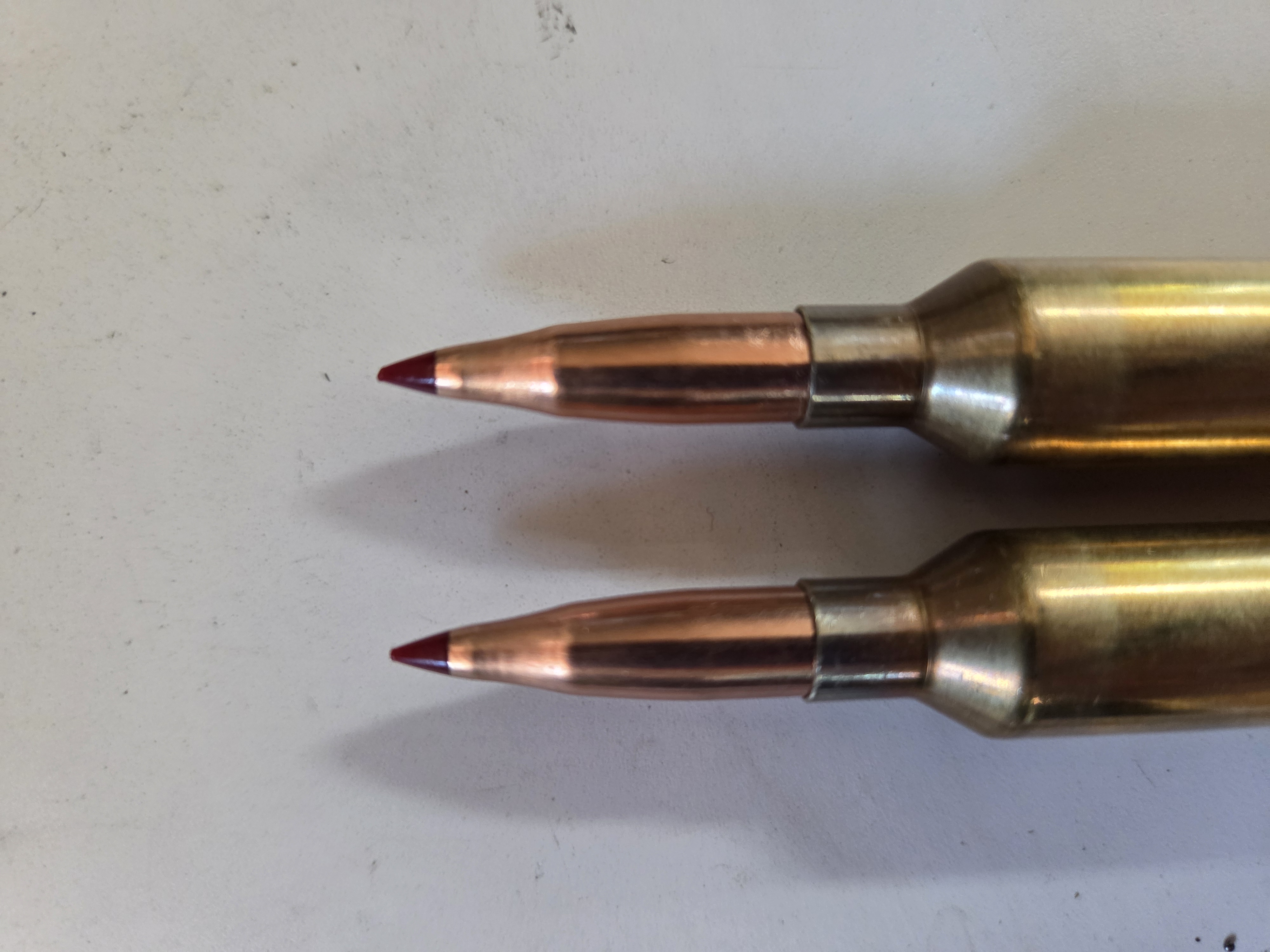

    Matchmaster seating die is destroying every 3rd or 4th 143eldx.
    New lapua 65prc brass. Run over expander mandrel (262) for uniformity.
    Load isn't compressed and I'm getting what appears to be actual extrusion of the bullet into the stem. I know the vlds shape are prone to scoring with standard stems, but can seem to find a vld Stem for this die.
    Has anyone seen anything like this before??? How did you solve it?

    Frequently had this exact issue w/ matchmaster seating die, despite dry graphing & double mandrelling w/ a .263”. Still occurred @ 1x fired, so I just honed the stem & that mostly fixed it.
    I didn't see it w/ 147gr ELD-Ms, but I only loaded ~20 ELD-Ms for 6.5prc. I didn’t pursue further... my initial ELD-M groups were atrocious, the ELD-X that didn't deform grouped very well, & I was loading for longer-range whitetail hunting. I decided it was easier to resolve the issue via honing than chase loads with other bullets.
    I also could not see any deformation with 153.5 Hybrids or 142 SMKs.
    A few things could be going on. 1) My ELD-X have not been particularly uniform in diameter, ranging from 0.263" to 0.264". I can feel a difference in the force to seat the ~20% that are 0.264" diameter. I took measurements as I was seating & noticed the 0.264" diameter were far more likely to deform. My 153.5gr Hybrids have had an incredibly consistent 0.2635" diameter across thousands of bullets from more than a handful of lots. 2) There could have been deformation of the jacket throughout the ogive and/or bearing surface of the ELD-M, SMK, & Hybrids, but I just couldn't see it, while the thinner forward portion combined with the very thick bearing surface of the ELD-X jacket concentrates any deformation towards the tip. 3) There could be differences in how close the lead cores are to the tip of these bullets, but I didn't look into that. 4) Some combination of the above
