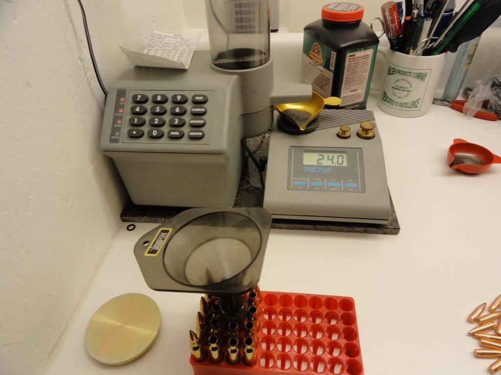

I have a 2002-2003 era Pact brand scale which talks to a Pact brand automatic trickler. It has by my estimates dropped somewhere north of 7K of charges. It of course gets calibrated with factory weights every time its fired up. Eventually this old workhorse will die but it's still going and doesn't owe me a thing
The first thing I did was take my weight sets to work and weight them on a certified scale. These scales are certified by the State yearly so I give them my trust. They measure to .01 Grams. The weights measured dead on.

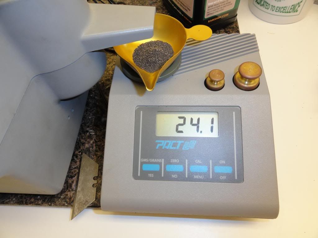

I loaded three charge weights and also measured them they were to within .01 grams which by my calculation is .15 grains. Two measured dead on, one over by .01 G.

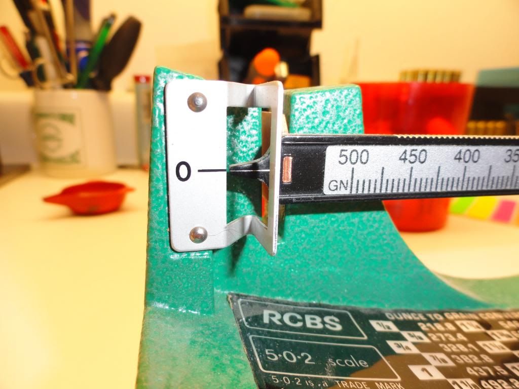

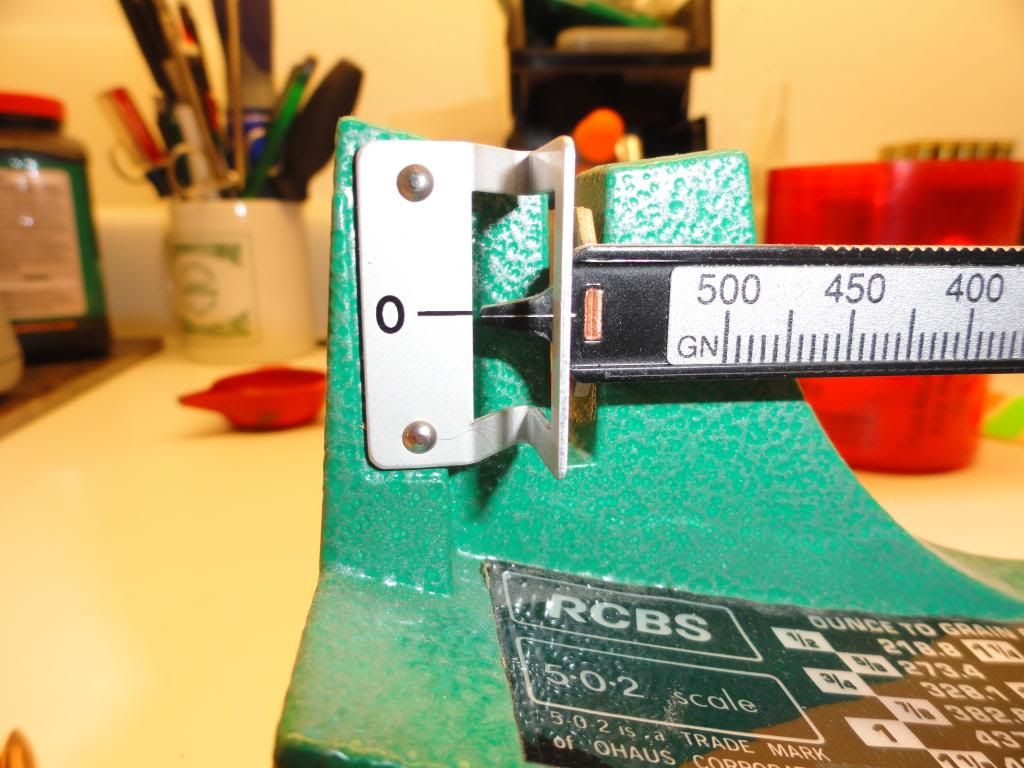

Since this thought I have double checked 97 loads produced on the Pact with my original RCBS beam scale. The loads measured again to within .1 grain of that displayed on the Pact. I have used extruded and ball powder for the test. The charges have been consistent from day to day with 7 reloading sessions within this test.
Here's what I am working with:
I came into this expecting to find a problem that I just can't find. I was ready to buy some new equipment upgrade to the RCBS Charge Master find something better, faster, more accurate.
So what am I missing here ?
