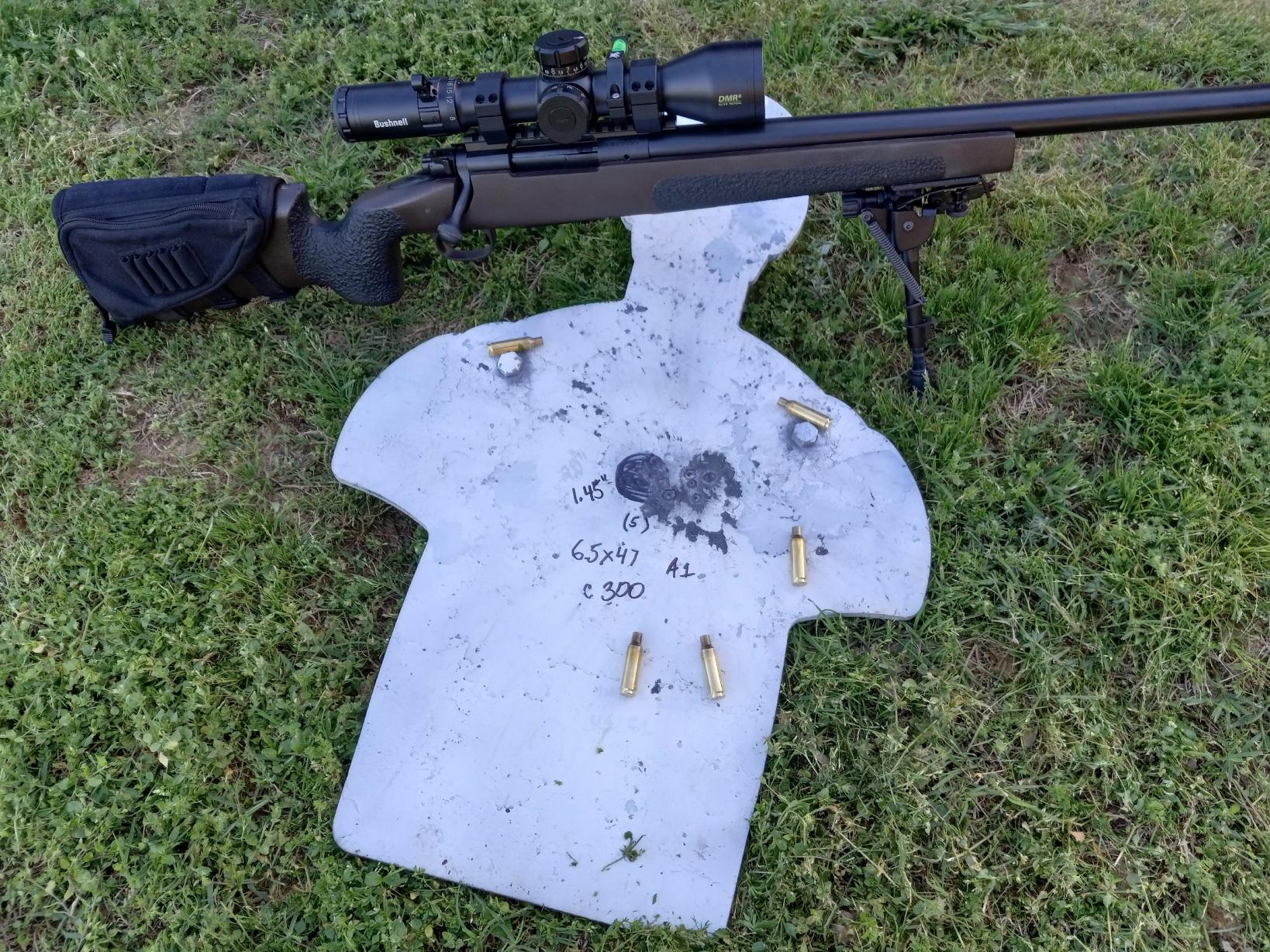

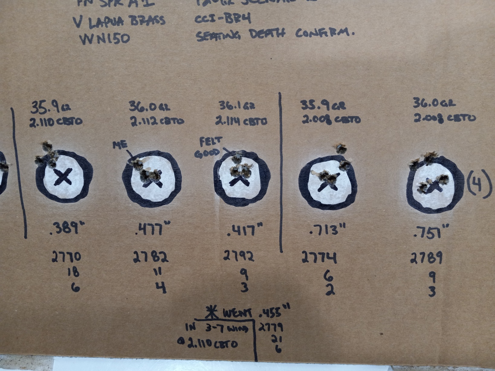

Here's my last workup for my second 6.5x47. I'm highlighting this because it is very seating depth sensitive:

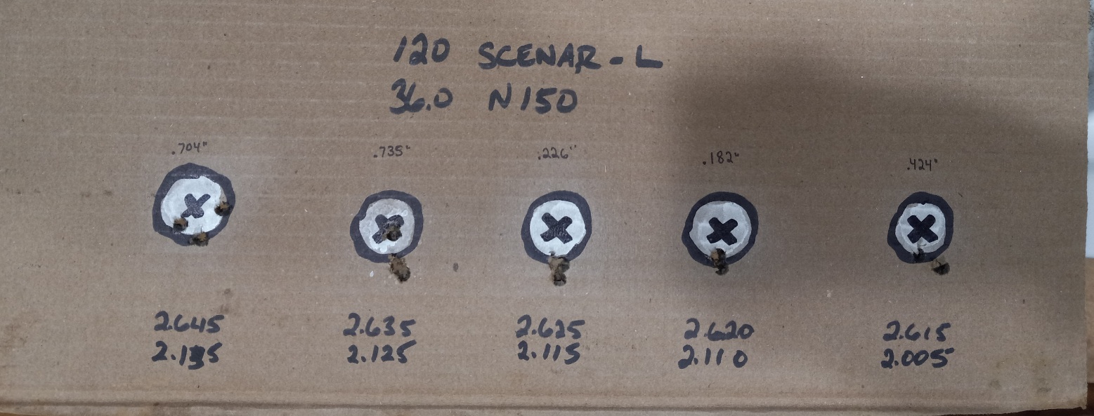

I already knew that 2.620/2.100 was a good length, because that's what the factory 120gr Scenar-L load was. It shot in the .5s during break-in, so I just bracketed it by .005, and then went another .010 and .020 out (please excuse the 2.005 typo...it's supposed to be 2.105).
^ Surprisingly, it has a two group window like old Senior Cortina mentioned. These were only 3 shot groups...except for the 2.615/2.105 - it sucked enough I stopped at two and kept the round for the CBS the next time out.

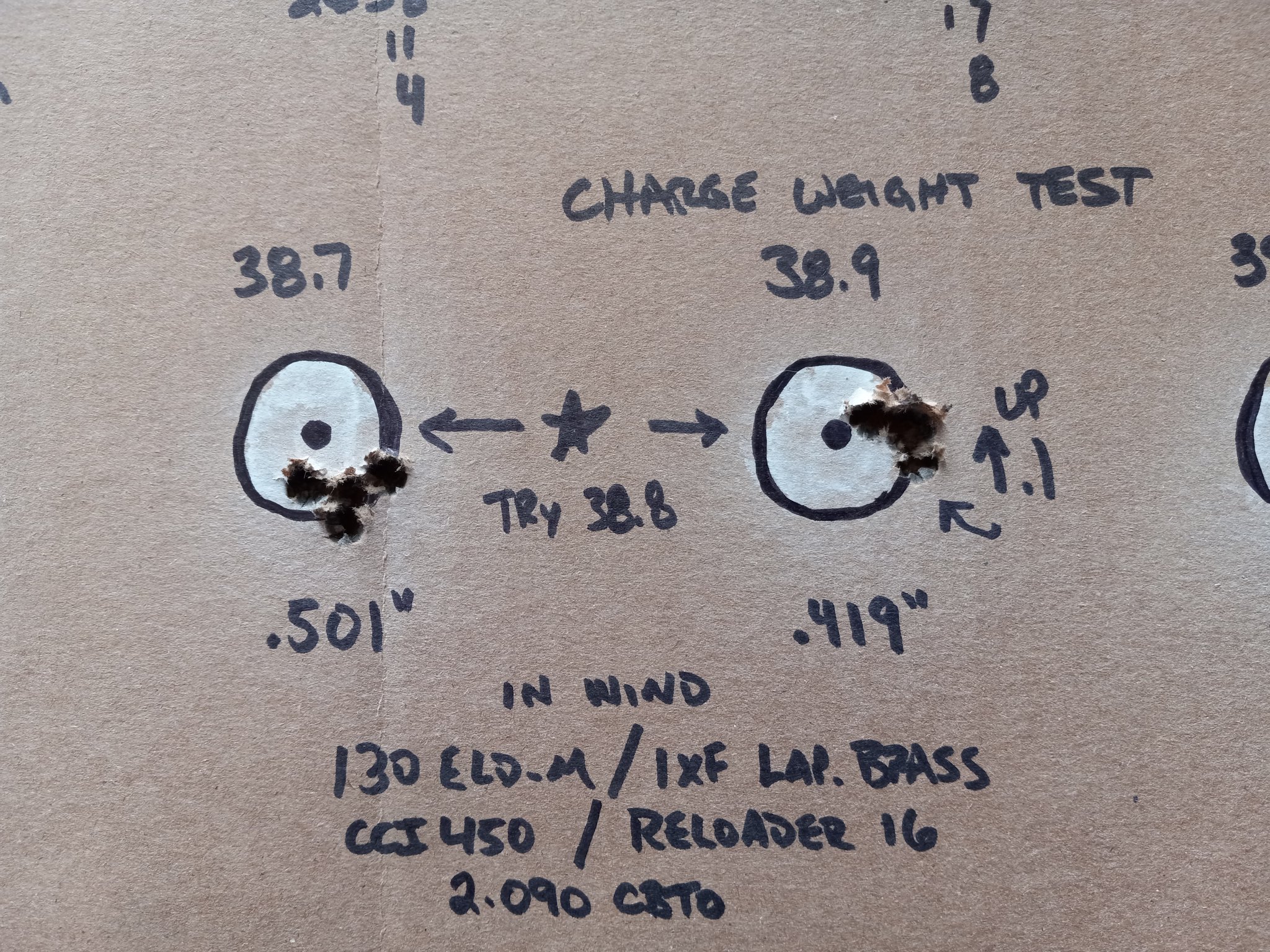

I then loaded to the longer depth and shot 5-shot charge weights. The best I did that day in a full value wind was this:

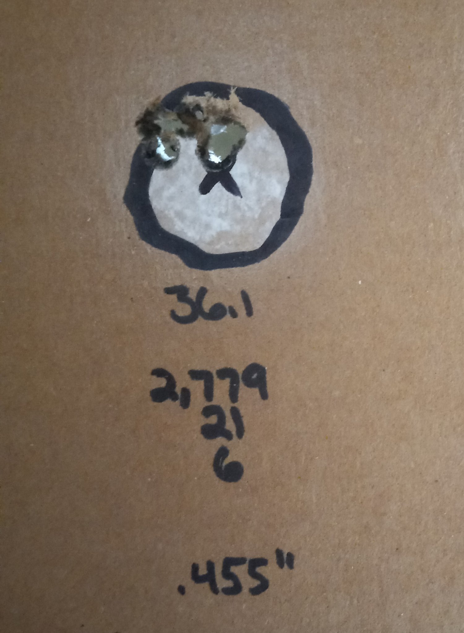

Then I fine-tuned charge weights and found that 35.9 - 36.1 all shot equally small on another day (no photo).

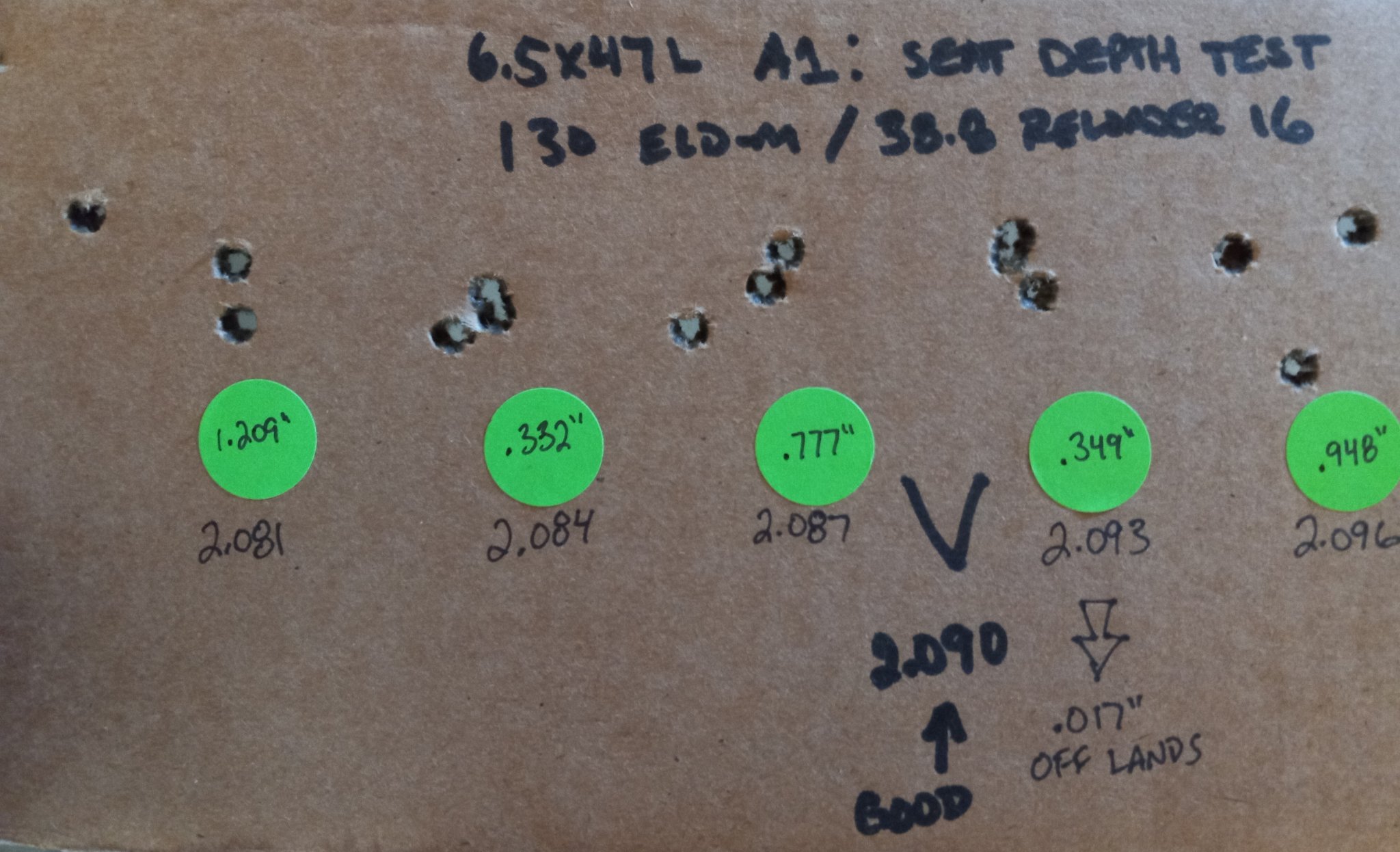

Finally, I screwed with very small seating depths at those charge weights with five shot groups again:
^ You can see that when I came out of the optimal depth by just a couple thousandths that my groups damn near doubled. I actually only shot 4 shots on the far right...it was sucking again, so I kept that round for a CBS prior to other load development.

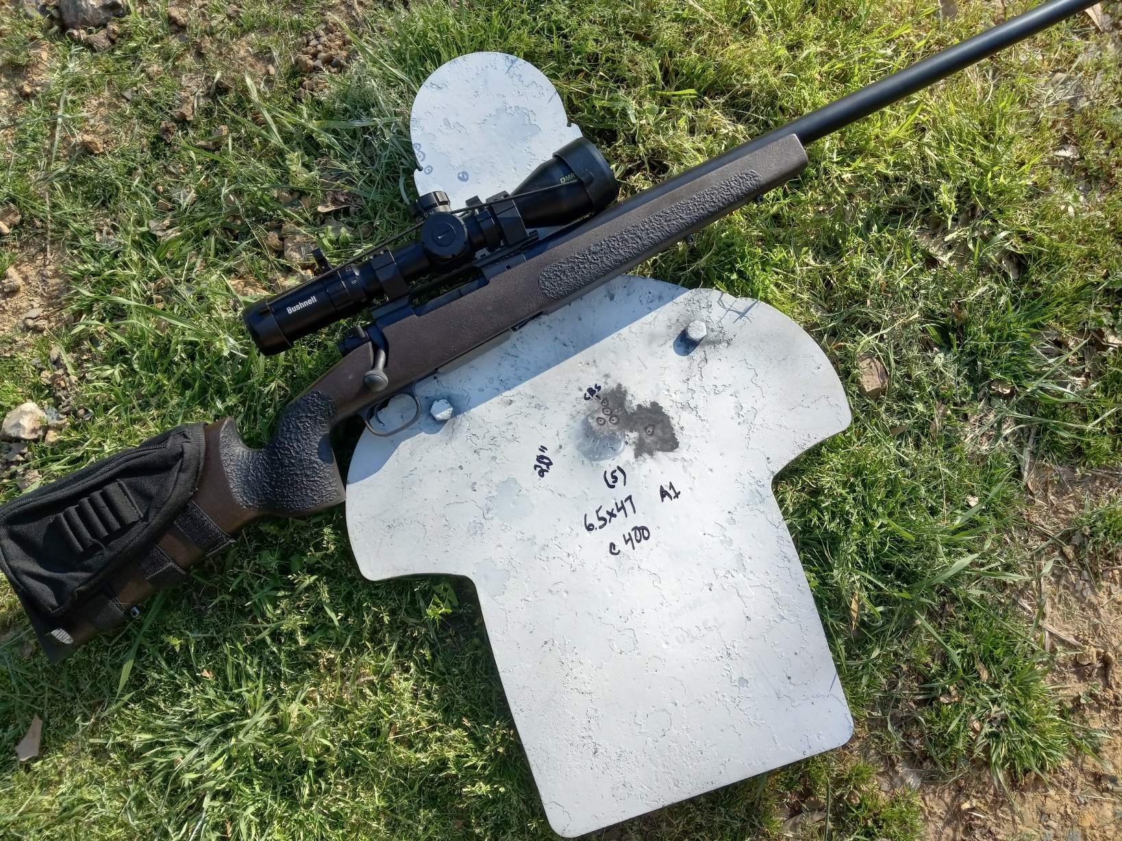

Then I shot that load at 400 yards on a good (little wind) day. 5 shots including a cold bore. I dropped one a bit low right, but it was still a 2" group on the nose.
At this point I'm confident in the load. It took me probably 85 rounds to get here including all of my confirmation stuff, but I don't have much hesitation in saying that my 120gr Scenar-L & N150 load - while a bit seating depth sensitive - is still capable of a little better than 1/2 MOA pretty consistently for five shot groups.
Once the load opens up, I'll seat out another .006 and retest.

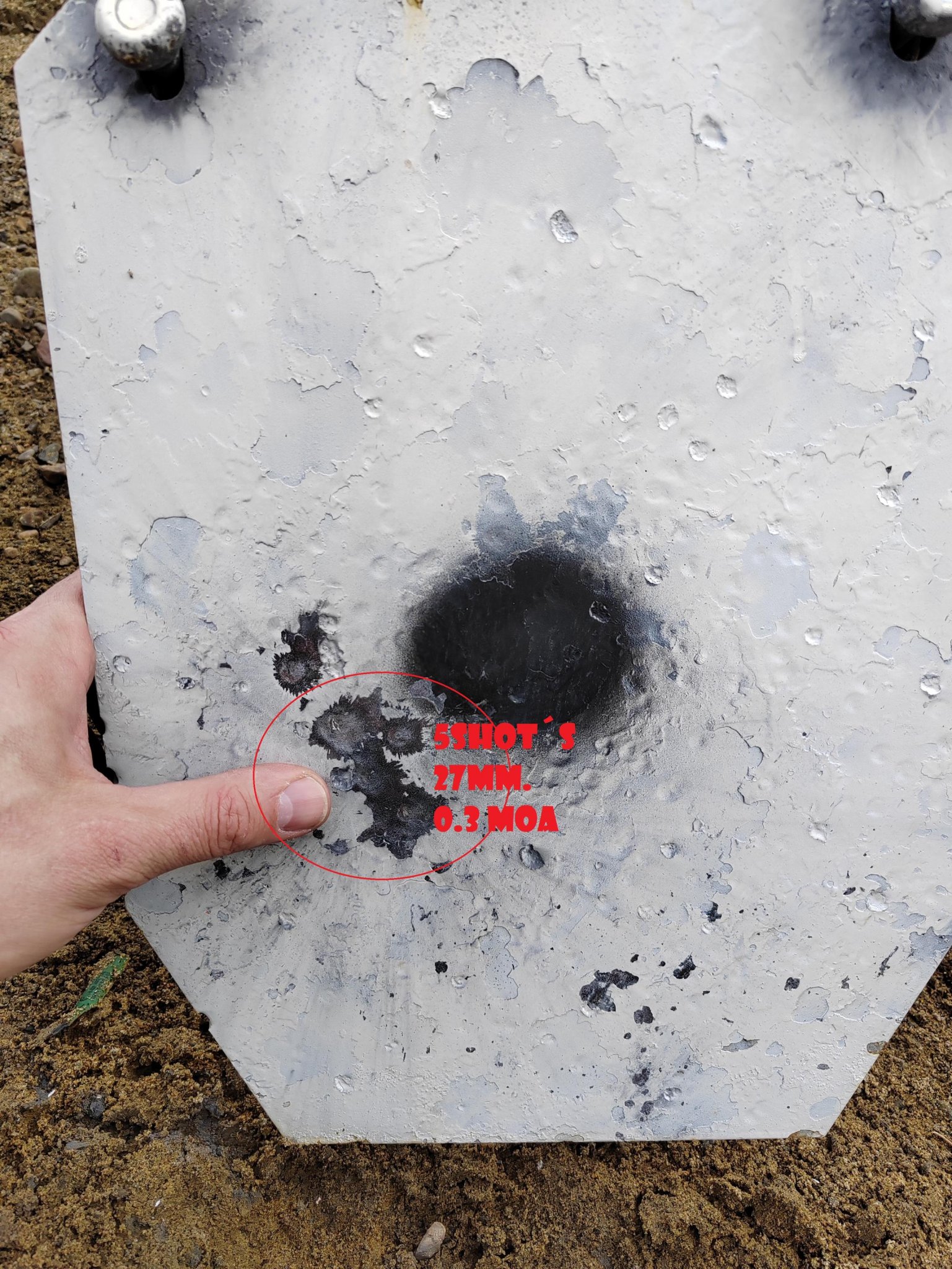

I have a new 223 barrel with .100 FB. I’ve found my velocity node and then started testing seating depth with 75 ELD. I’ve gone from below the neck shoulder junction to barely sticking in the case. Best 3 round groups were right at .5” but when I re-test them, shot gun patterns. Just like your experience with the RDF. So what now? Does this barrel just not like that bullet? I hope that’s the case and I’ve loaded some Berger 85.5s to test now.

You need to to try the N160.
Just tested on my Krieger SS .260rem that pill and N160.
NO 100-m paper test, straight to 300-meters.
I say that the powder charge is more importand that the seating depth.
Why i say that, i have loaded thousends and thousend of load, shoot, shoot and shoot more.
But i can say this only of Lapua bullets, but i dont think other bullets are so special, that they would work so much different.
On this video, we did shoot one full box of Lapua factory 136gr Lapua Scenar-L .260REM ammo.
Distance was 300-meters.
My friend shot the last 5-rounds that tight group(0,19 MOA), if you look the video in to a end.
Factory load is never even close to the lands, so why do you chase them??
I say the powder charge is more chritical than the col.
Rifle is factory Tikka T3 SS Varmint 24" with KRG Whiskey chassis.
AND the barrel is spiral fluted, some one say that ruins the accuracy🫢

Did another fine-tune seating depth test today. This time I used the 130gr ELD-M. During load charge weight development (done after a rough seating depth test), this load had shot in the .4s - .5s for five shots.
I "verified" the load at 300 with another five round group just to see if it would hold up. It did (~.46 MOA).
Today, I seated out .003, and .006 further (my "load" is .020 off), and .003, .006, and .009 in. The results showed a pretty significant disparity in accuracy. I'm going to load .002 further out as it puts me in the window of good accuracy. No shots were pulled/chunked.
Yeah, there's a bit more vertical than I'd like, but for a 400 and in critter gun, it's plenty acceptable.
At this point, I'm pretty convinced that seating depth is as important as charge weight regarding accuracy...and that both have windows/"nodes" of excellent and horrible results.
Reactions: Matagorda308
