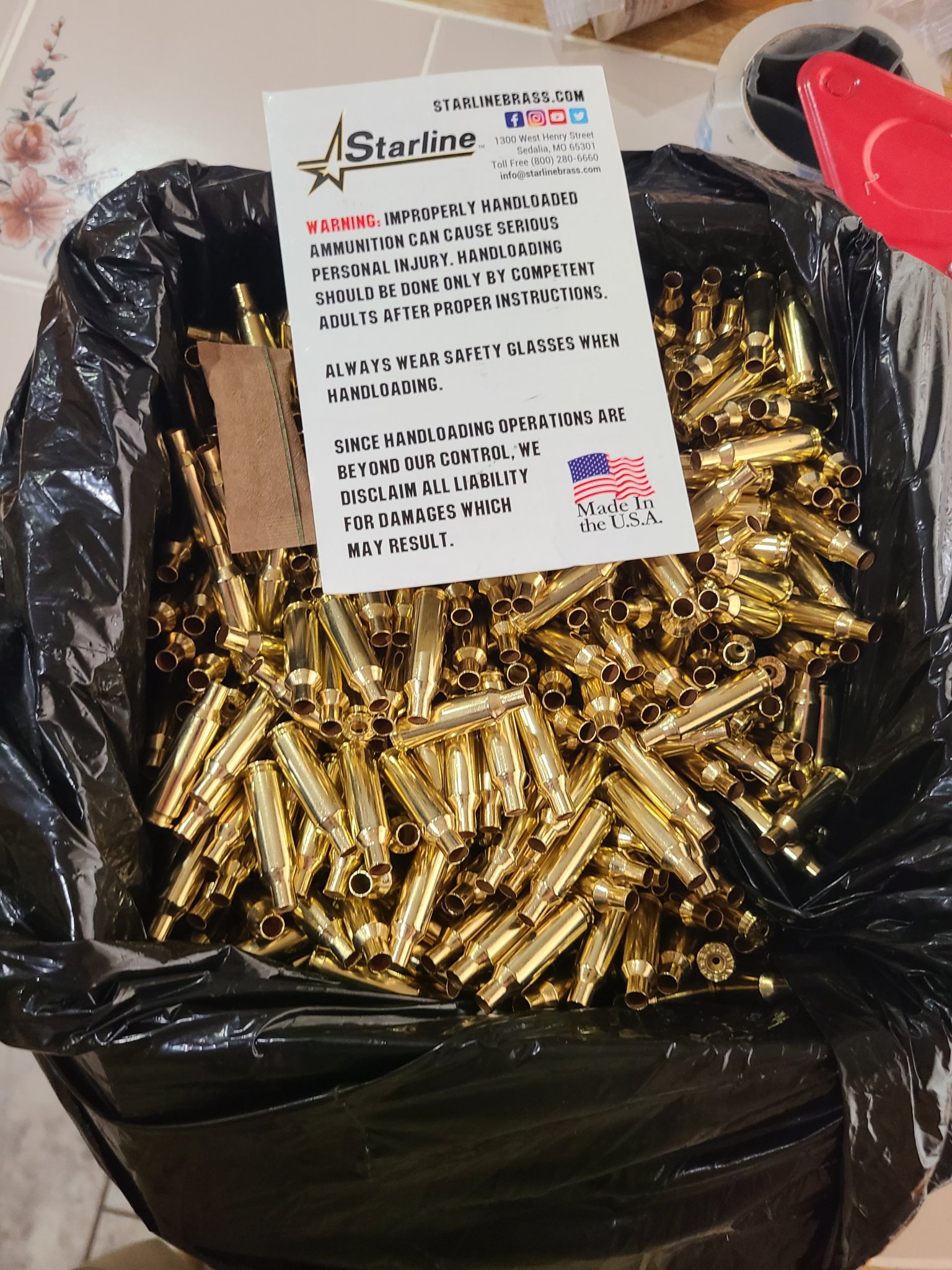

I think it's worth noting that starline has started fulfilling backorders and now has backorders open on their website. I just put down for 500.
Thanks Jack! Ordered 500. Must have just opened this morning. I was getting desperate & forming 24 Nosler brass.

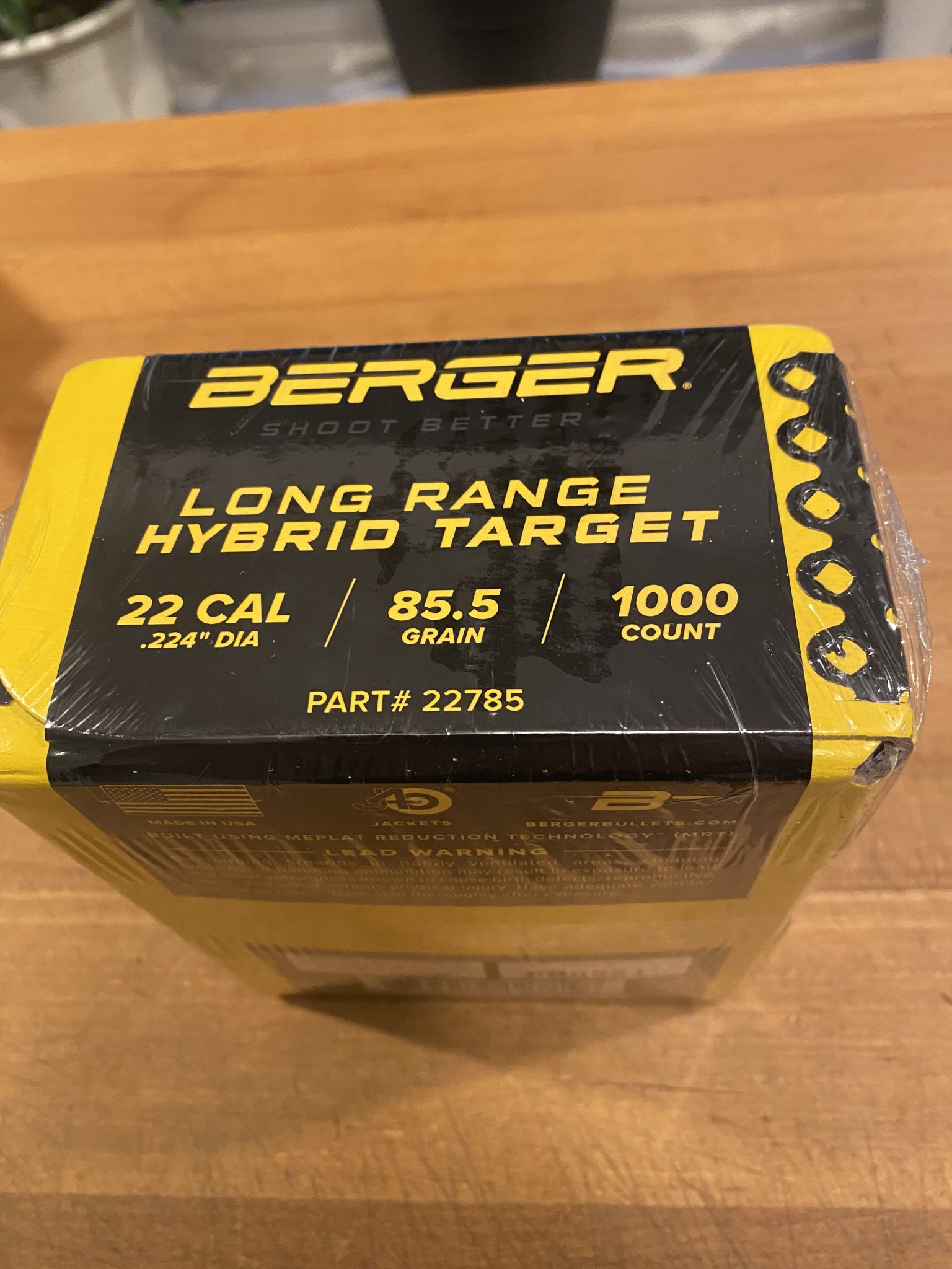

So I got a notification late Saturday night that Midway had thousand count boxes of Berger 224 85.5 bullets. I ordered a box right away. By the following afternoon, they were out of stock again, with no back orders.
Today UPS delivered my box of Berger bullets.
Instead of receiving Berger PN 22785 (1K 224 85.5) I received Berger PN 24785 (500 243 109).
Foiled again!

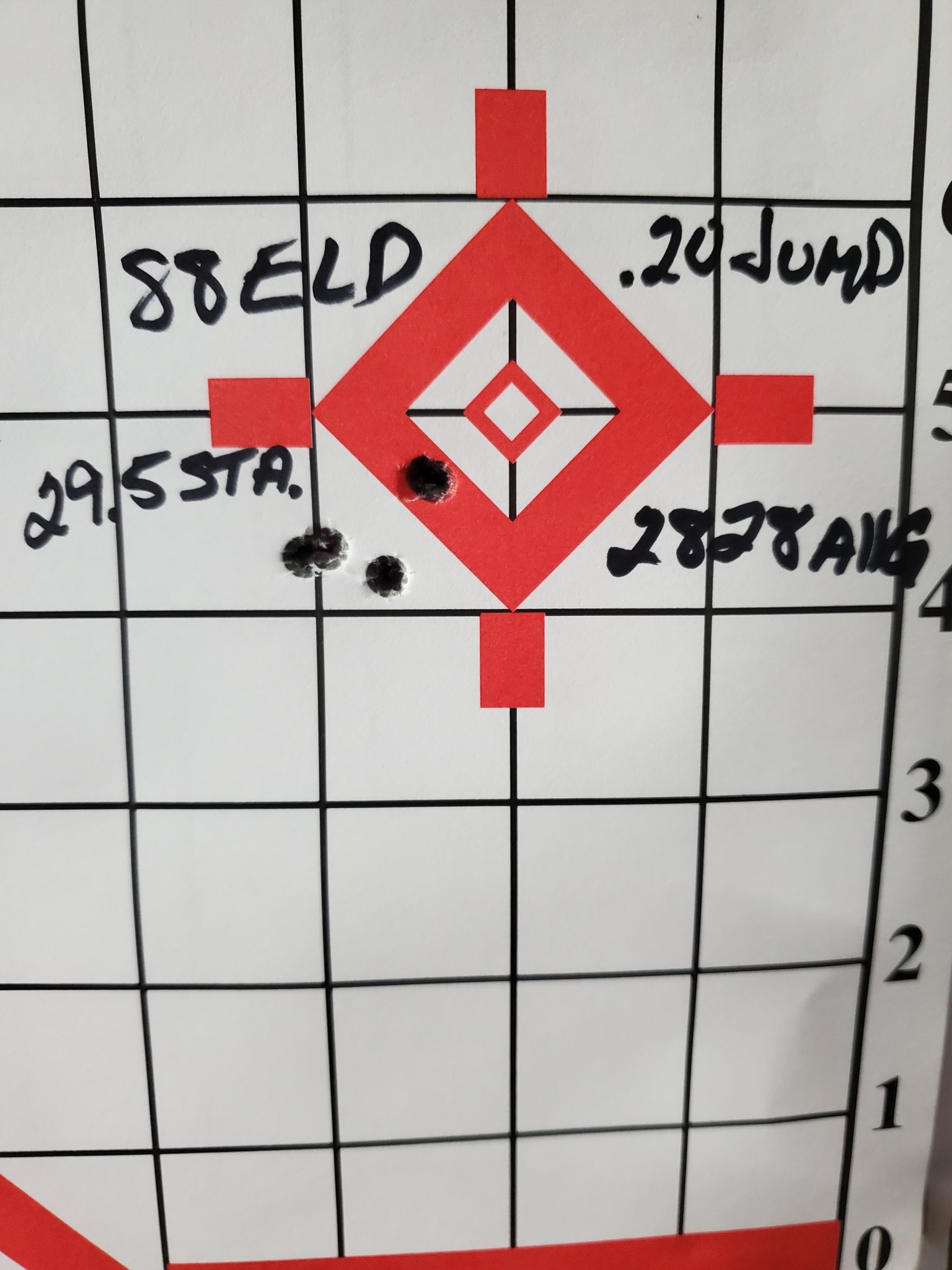

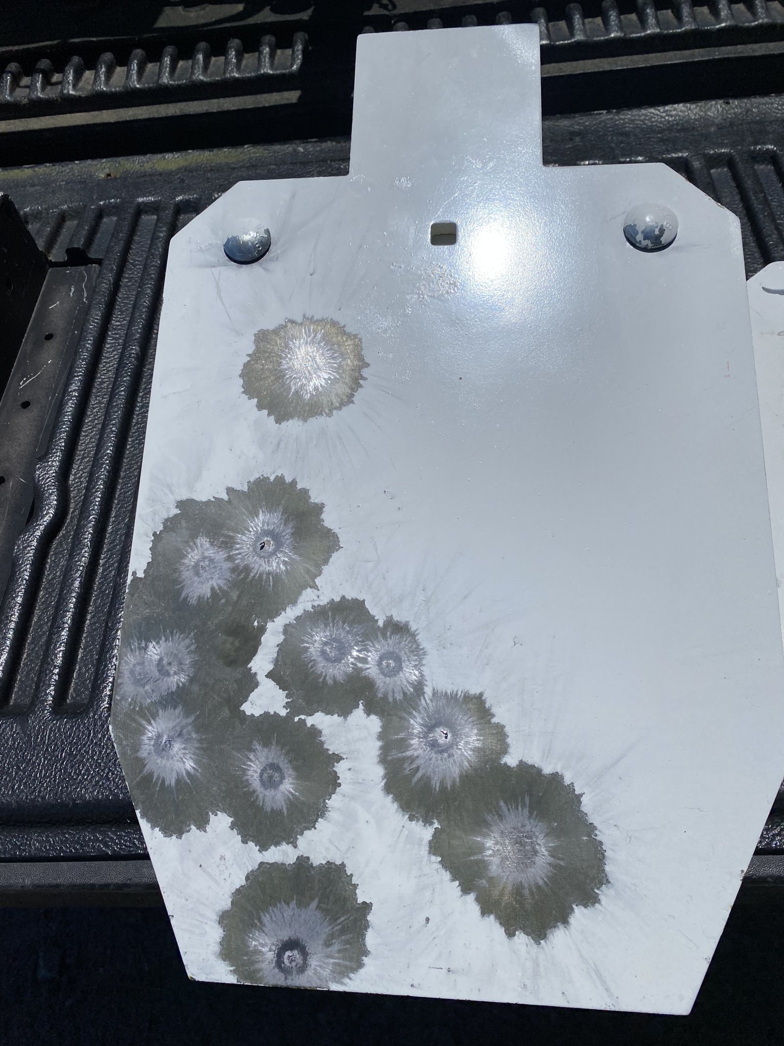

Going to work on this one a little. 100 rounds on the barrel of this new bolt gun. Can't get much more in the case and there were no signs of pressure.

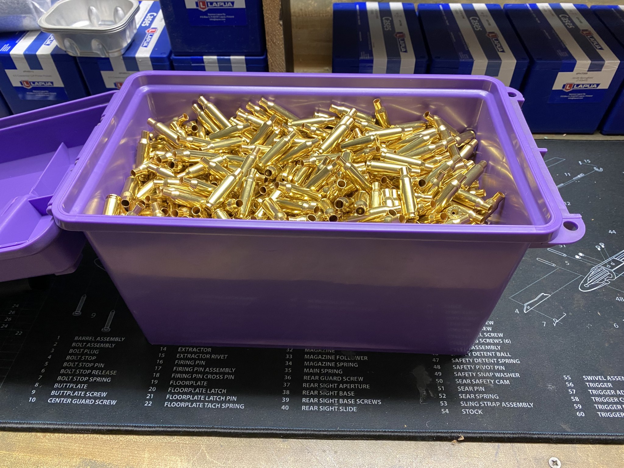

I probably have around 1500 pieces between fed/Hornady/ and now starline. I didn’t keep tabs on this barrel as it’s mostly my practice, training barrel. I think it’s probably at about 3K rounds or so at this point. I think I gave away at least 1k of the Hornady back when I was shooting the 88 factory stuff and before I decided to reload.

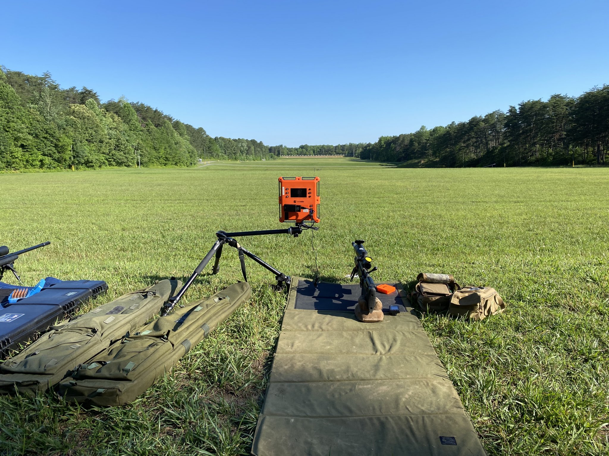

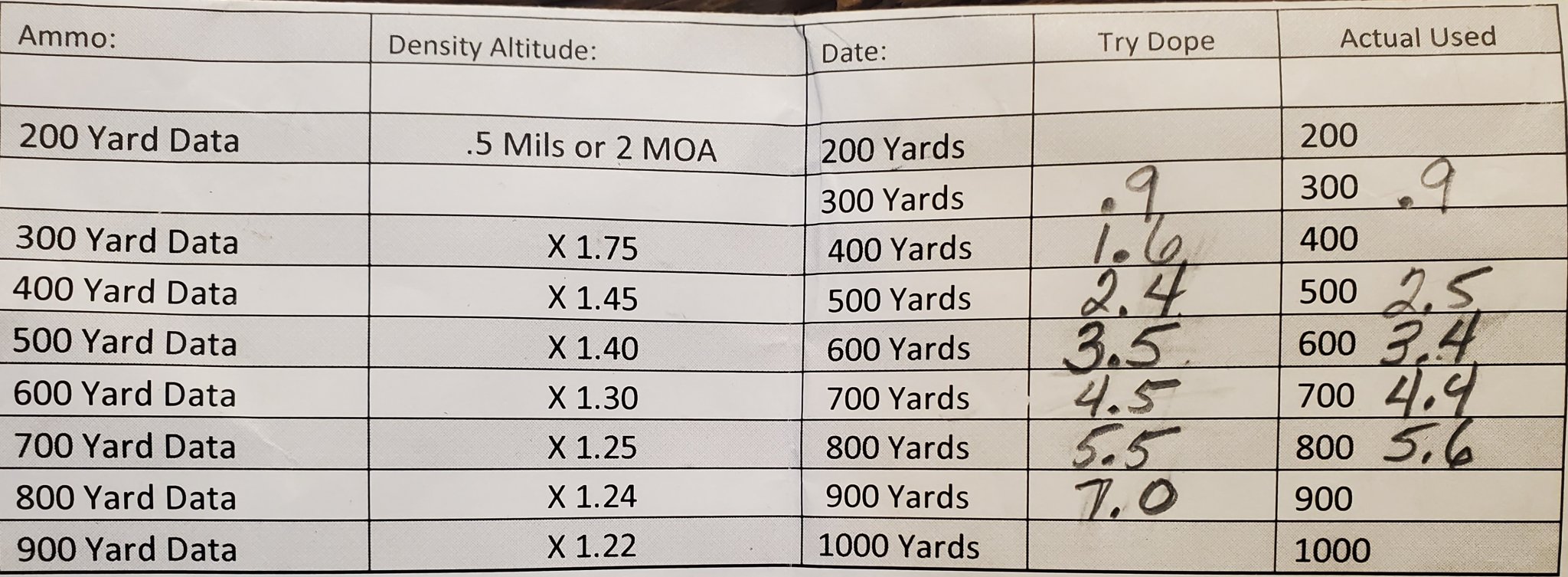

Ok, as promised, results thus far with Valk out to distance.

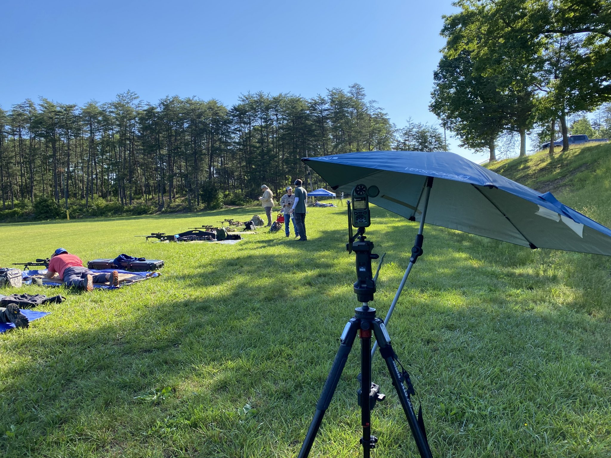

Shot today here in Va. Temp was a sweltering 93, and unlike you lucky bastards out west, we gots tons of humidity to go along with the heat. I was melting on the stock.
1B1268CA-1035-4909-9192-BAA4C3F26DB8.jpegSo I attached a photo of the course of fire. The numbers are what I held, and what I was off. As you can see the 1020, the 1100, the 850 and the 1000, my impacts were about .5 mil above my point of aim. The exception was the 850. I was only .1-.2 high. But anything past 850and I was definitely shooting high. Now, it would be nice if I could shoot multiple rounds at the targets, but alas, we get two shots per target. I am still confident that my dope was ~.5 high at 1000 and beyond.
My load was with MR2000 and chrono at the sight in showed 2929 with an SD of about 8.5. These were with Berger 80.5 FB. I shot two relays of the same targets. A total of 40 rnds. I hit each target at least once between the two relays. Out of the four shots at eggs at 200, I hit 3! Shout out to NF and the 7x35 ATACR! So I think an egg at 200 is prob .5 MOA right? The eggs are hanging from strings and sway a bit,so timing is everything.
So, not convinced that the 80.5’s are the way to go in the bolt Valk. Also not confident of the temp stability in MR2000. There was a slight breeze today that was switching back and forth. I plan to shoot the same load this next weekend at another match. For now, I’m not going to change anything except my dope in my Kestrel to true it up. Adjusted the BC to match results at 1000 and beyond. Following the next weekends performance I will decide if I will stay the course with the 80.5 or experiment more with the Sierra and Hornady 90 grnrs. However, regardless of what I do, I for one do NOT believe 2900+ with 90grn bullets will be achievable in the Valkyrie. If this is what you want to do then I think I try would look at the 22 GT. The load I posted previously with the A-Tips was pretty stout, and I would be a little afraid to try them in something like the heat I had today. But hell, if you ain’t afraid of some blown primers and a wooden stick to knock the bolt open, give it a go. OR, perhaps someone will come across a powder that will drive the 90’s at 2900+.
If anyone wants more details or clarification, PM me and I will try to answer. No point in extending the thread any more than what we have.
View attachment 7874827So I attached a photo of the course of fire. The numbers are what I held, and what I was off. As you can see the 1020, the 1100, the 850 and the 1000, my impacts were about .5 mil above my point of aim. The exception was the 850. I was only .1-.2 high. But anything past 850and I was definitely shooting high. Now, it would be nice if I could shoot multiple rounds at the targets, but alas, we get two shots per target. I am still confident that my dope was ~.5 high at 1000 and beyond.

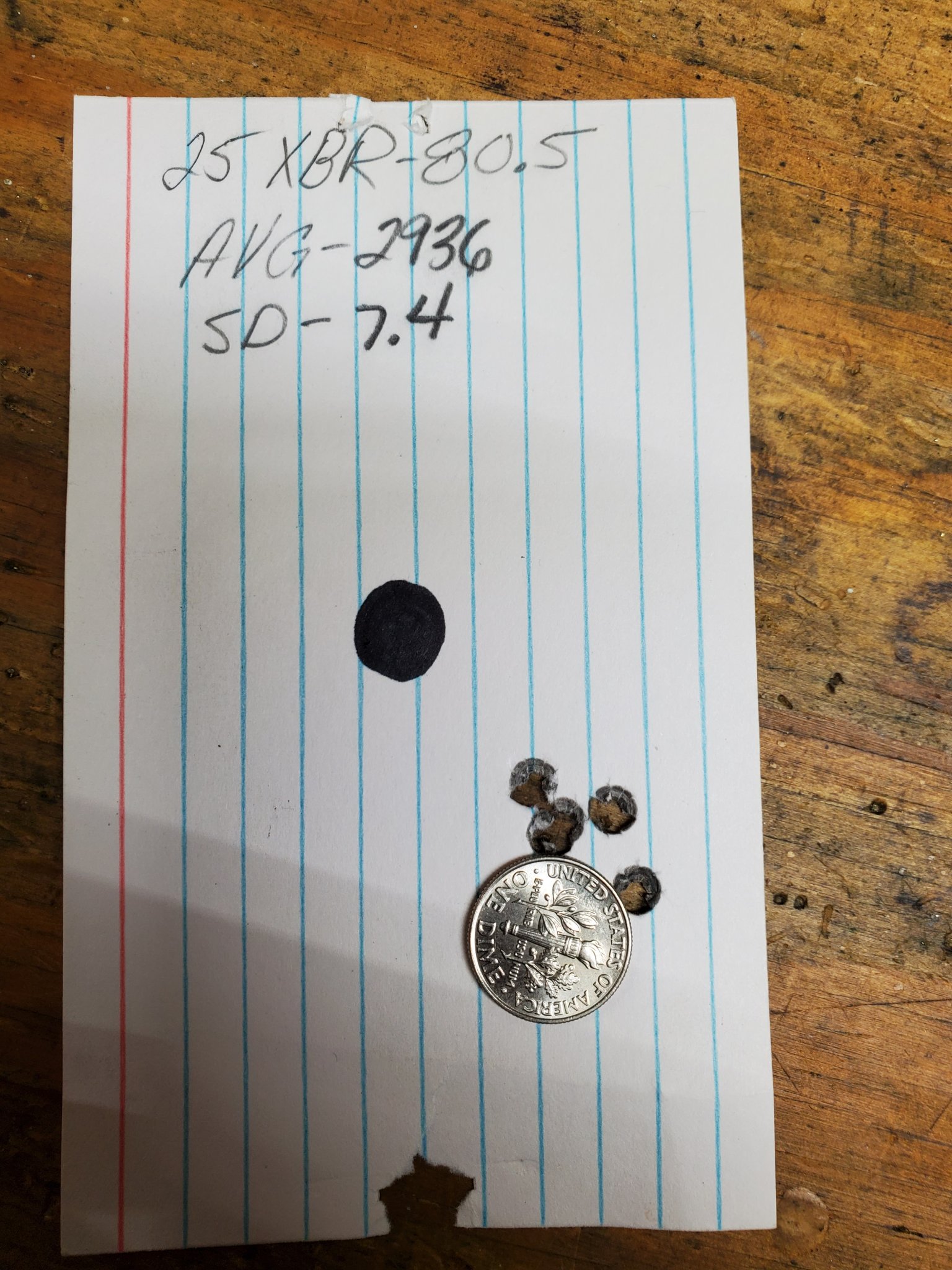

Got a little over 200rds through the new bolt gun. Here is where I'm stopping on this load. I had ever slight case head rub but not heavy bolt lift. The wind is blowing 18 and gusting over 25 which had my gun moving around a little. For a temp stabile load, for the powders that I have, I think this works. FYI....5 shots @100yds

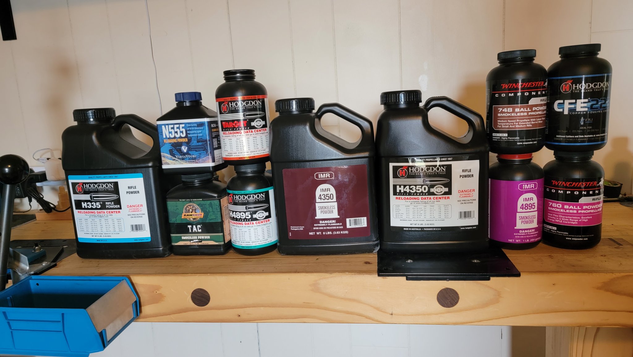

Alright boys, I'm ready to toast some brass (while keeping my face)
Here are some of the powders that I have on hand that I think may fit in the burn rate window for the valkyrie. Some of these are well documented to be decent powders in the 223AI and 224 valkyrie. Some haven't lol. Here's what I've got.
These powders were not set out in any particular order but are book ended on the burn rate chart by H335 and H4350 (maybe N555). H335 is the only one I'm hesitant about...
To make this quick I'll do .3gr increment 10 shot strings and call that good enough. This will only be a velocity/case yield test. I may shoot at dots but shooting suppressed with a magnetospeed makes groups kinda pointless. There are a lot of powders I wish I had on hand but I realize I'm doing better than most. I'd love to see more data on 2000 MR and 8208 xbr in my rifle.
With that said I've got a .115" freebore in an origin build. so I'm hoping to stuff a little extra powder under that bullet when I need to.
