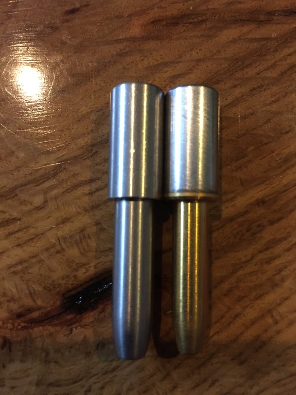

A sinclair expander has the same dimensions as a 21st century as far as fitting in the top goes. The Sinclair is a bit longer in overall length
I have used the sinclair mandrel in the 21st century body and it works fine and the dimensions of the mandrels are the same so you could do the inverse as well.
I just bought some TiN mandrels from 21st, they work just fine in my Sinclair die body.
I bought a sinclair expander just to compare the sizes to the 21st century and get an empirical measurement for us, Ill update after christmas when I get them side by side. I knew I should have just gotten them for myself and skipped this waiting on santa.
Got mine. They mic .307+ and .223+ not like they told me over the phone :(
Expanding.
The man said .306” and .222” for the expanding. Maybe he meant those were the plain stainless mandrels. The TiN coating must add .001” or so.

Finally got around to remembering to do this, taken with a Mitutoyo caliper (.0005 accuracy ) and rcbs micrometer (.0001 accuracy). (Though my mic touch is admittedly poor)
21st century TiN
22 cal turning mandrel
.2220 on the cal, .2222 on the mic
21st century TiN
24 cal turning mandrel
.2405 on the cal, .2409 on the mic
Sinclair stainless
27 cal turning mandrel
.2745 on the cal, .2748 on the mic
21st century TiN
30 cal turning mandrel
.3055 on the cal, .3057 on the mic
