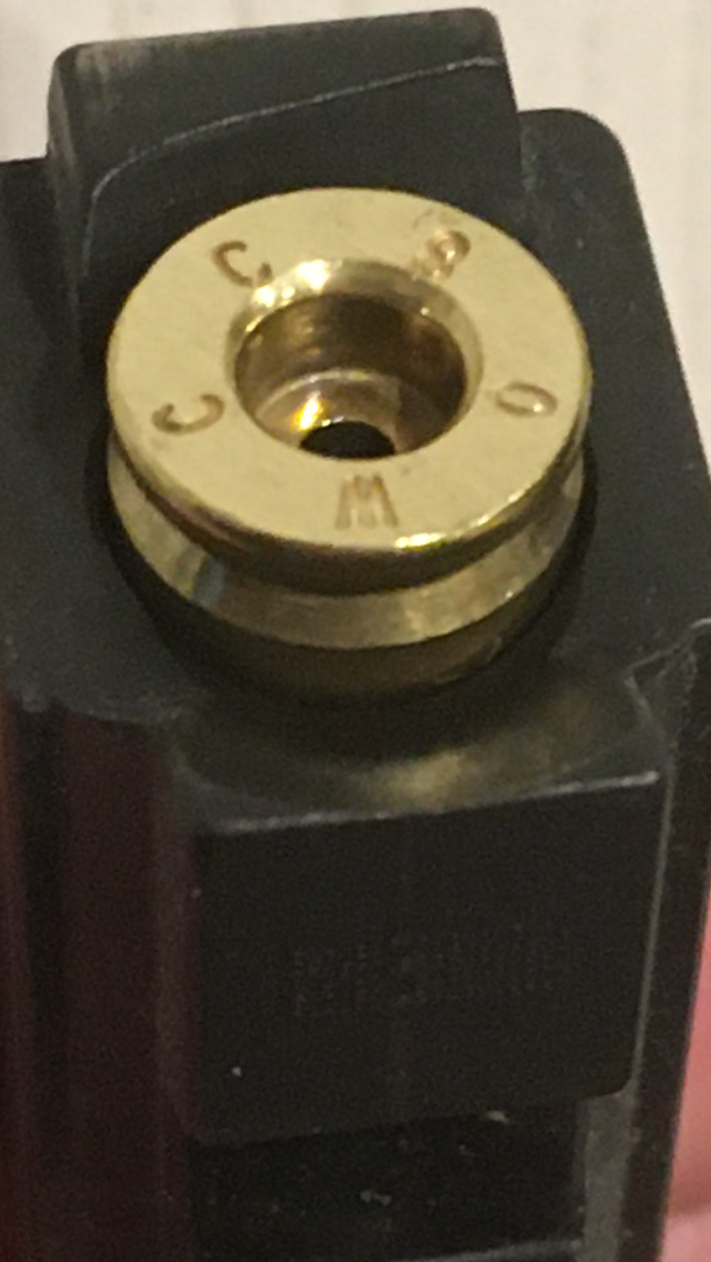

g26 blew up on my hand today
I use a 650 Dillon, all my tool heads have Dillon powder alarm die or the rcbs lockout die. I also use cfe pistol in 9mm,38s,40, and 45acp. It fills the case nicely and double charges will be up to the brim. Lastly 9mm glocks are supported, at least as much as any other 9mm auto. Their 40 and 10mm have the least support, but still as much if not more than 1911s in 40/10mm with non ramped barrels. I will never own a colt in 38s/9mm or 10mm, they make smiley cases that show up glocks, lol. Glad your safe op and didn't lose any fingers.
1) super glad OP is ok!!
2) I run exact setup as 6brahooter; Dillon 650 and cfe pistol. Hard to double double charge with this powder.
3) agree it is most likely double charge, for what my opinion may be worth?

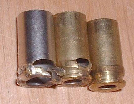

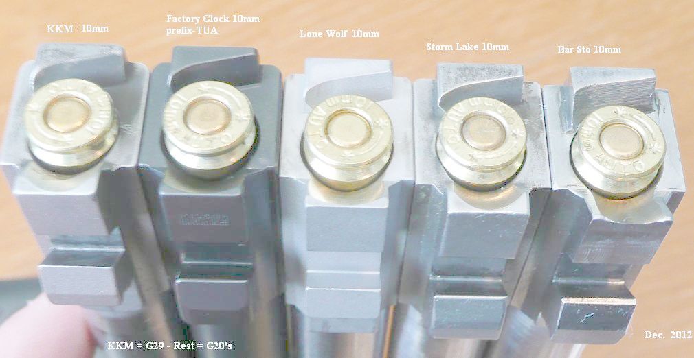

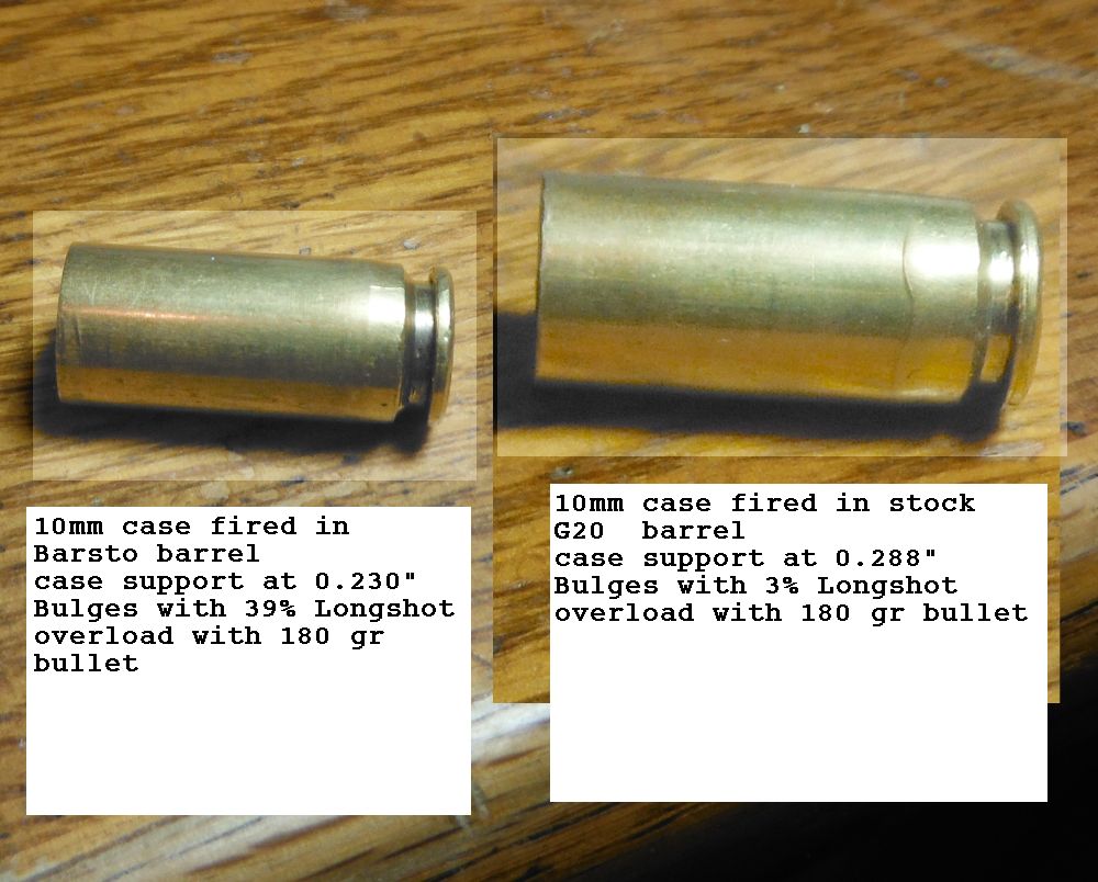

g out of battery is a known issue, especially with reloads.
As you can see with the factory Glock Barrel it doesn't take much at all
I added night vision to your pic and added my old pic from years ago.

G20 barrels haven't looked like that since 2nd Gen. OP doesn't have a 10mm. Glock 9mm barrels are supported.
I shot some (two mags) 9mm Major ammo out of a Gen 5 G17 barrel last weekend. The ammo was easily 40K PSI (124gr JHP over 7.2gr of Longshot). The brass looked like the factory ammo brass fired from the same barrel at the same time.

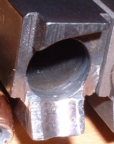

Glock, like other 9x19mm pistol manufacturers seem to have feed ramps that intrude no more than 0.180".
9mm brass has 0.160" thick webs, making for 0.030" of thin unsupported case wall. This is very good.
25acp, 32acp, 380, 40sw, 10mm, and 45acp barrels are often not as good as 9mm for support.
The 25acp and 10mm case heads are weak, with primer pockets too close to the extractor groove.
20 years ago when I started reloading, with 9mm I have worked up to destruction with many combinations of 90 gr ,115 gr, 124 gr, and 147 gr bullets. I used 3N37, AA#5. Bullseye, Unique, Power Pistol, Blue Dot, 2400, HS-6, 800X, AA#9, H110, and LIL GUN.
The case support in 9mm is so good and the case volume is so small, that the only powders that could damage the brass in overload work ups were; 3N37, AA#5, and HS-6.

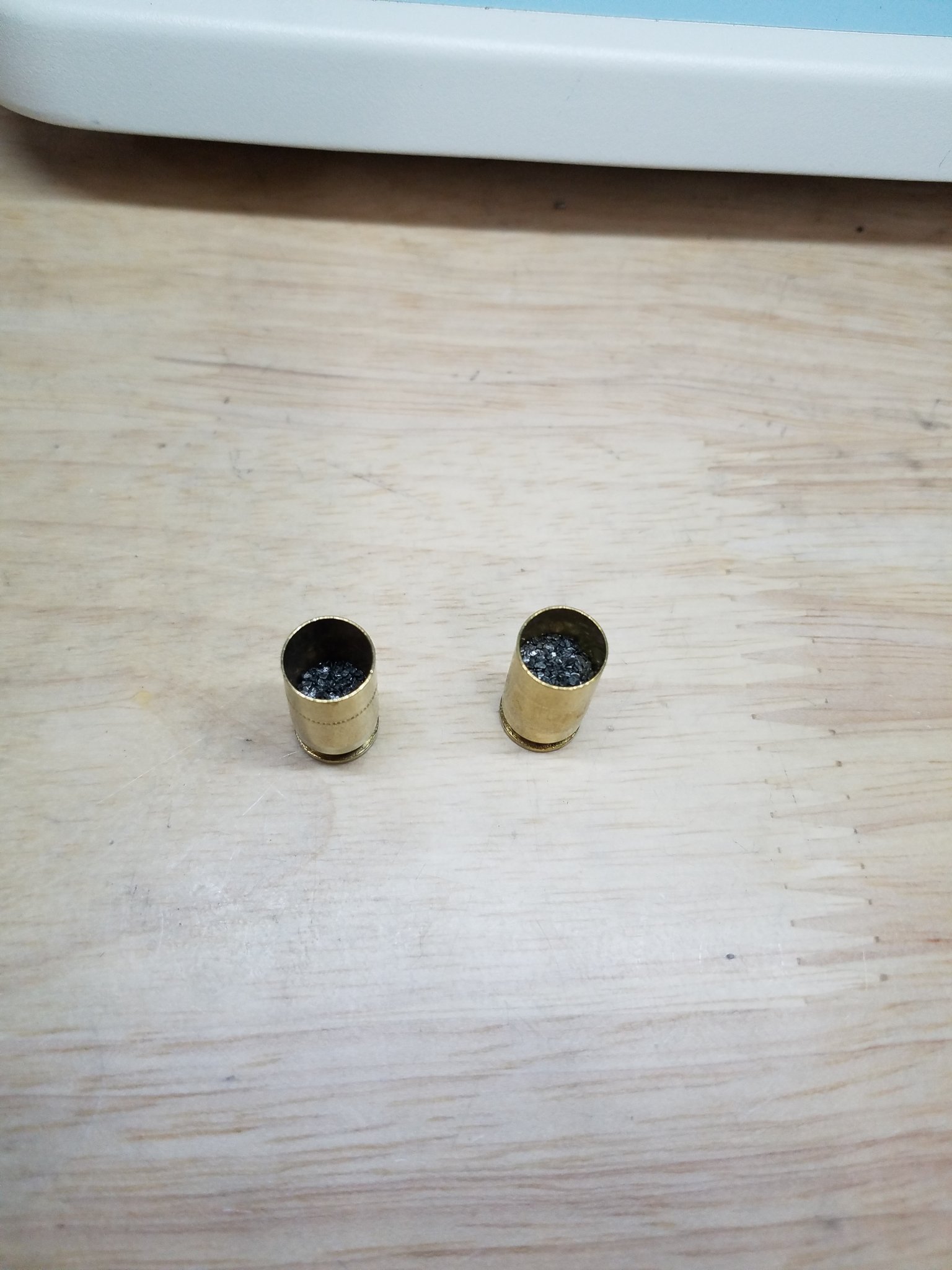

Here are some pictures, depth in the picture is somewhat hard to capture but the double charge is very noticeable in person. I took a picture on the shell plate too, station 3 is the double charge. See how little empty space is left? This is not hard to verify by sight, it is plain as day.
How asinine and stubborn to you have to be to refuse to admit that double charge you showed can be missed? And plenty of people use charges even smaller than that. I've used as little as 2.3gr in a 9mm case.
In contrast, 3.4gr of Clays fills the case about the same as the double charge you showed, and a double charge of that amount of Clays overflows the case.

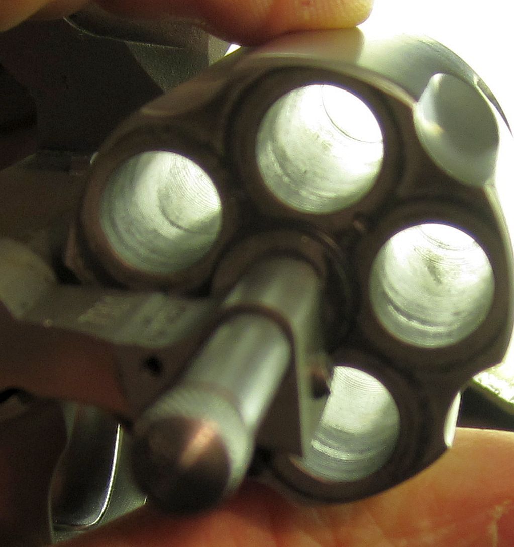

Years ago my dad bought a Taurus 380. The 11th factory loaded round blew the slide off the top of it in 2 pieces. I have never liked Taurus since.
A friend of mine sold me his Taurus 357 mag revolver. The inside of the chambers did not completely clean up when they reamed them. The result is that cases will stick with 357 mag loads... but not with 38sp loading.
Now I have lots of Colt 38 specials that I shoot with 357 mag loads and one Taurus 357 mag that I shoot with 38 sp loads.
That is my only Taurus and will probably not be joined by any others.

1. Glock barrel not supporting case as well as other semi-autos. Part of what makes Glocks feed so reliably.
2. Week brass with unknown number of reloading.
3. Titegroup probably wasn't double charged, but could have thrown heavier.
4. Pistol could fire without complete battery lockup.
Glocks are great but taking a chance with stock barrel and reloads depending on QC. Just my experience.
I've had a 9mm Glock do this. Hurts like hell. This was some years ago.
Stacking was the consensus then.
Glock 9mm chambers support the case as well as other brands.
918V has been make succinct posts since the earth cooled.
My 1993 Glock 19 9mm has a case support of 0.190" with a case web of 0.160", leaving only 0.030" of thin unsupported case wall to form a case bulge. This or better is representative of most other 9mm brands of pistols .
My 1992 Glock 22 40sw had a case support of 0.235" case support with a case web 0.180" thick, leaving 0.055". In addiction the diameter of the chamber was in excess of the sloppy SAAMI max.
After TIG welding the chamber and re cutting, the 40sw was capable of atomic loads.
