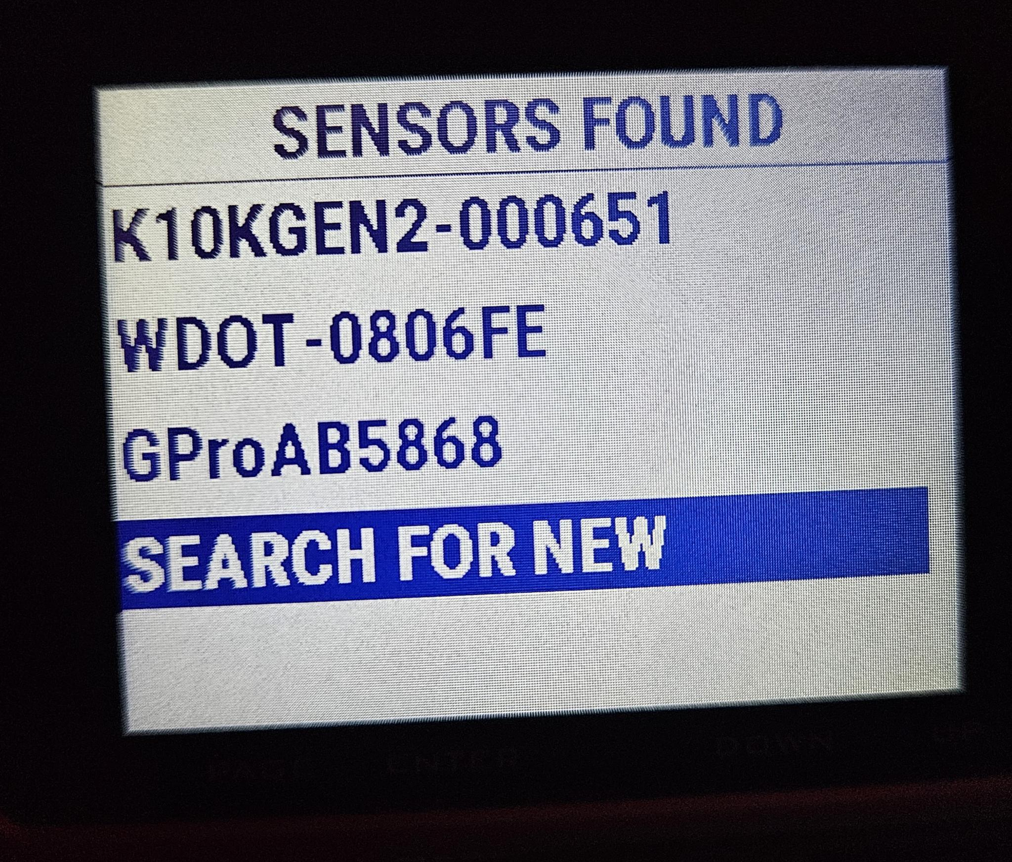

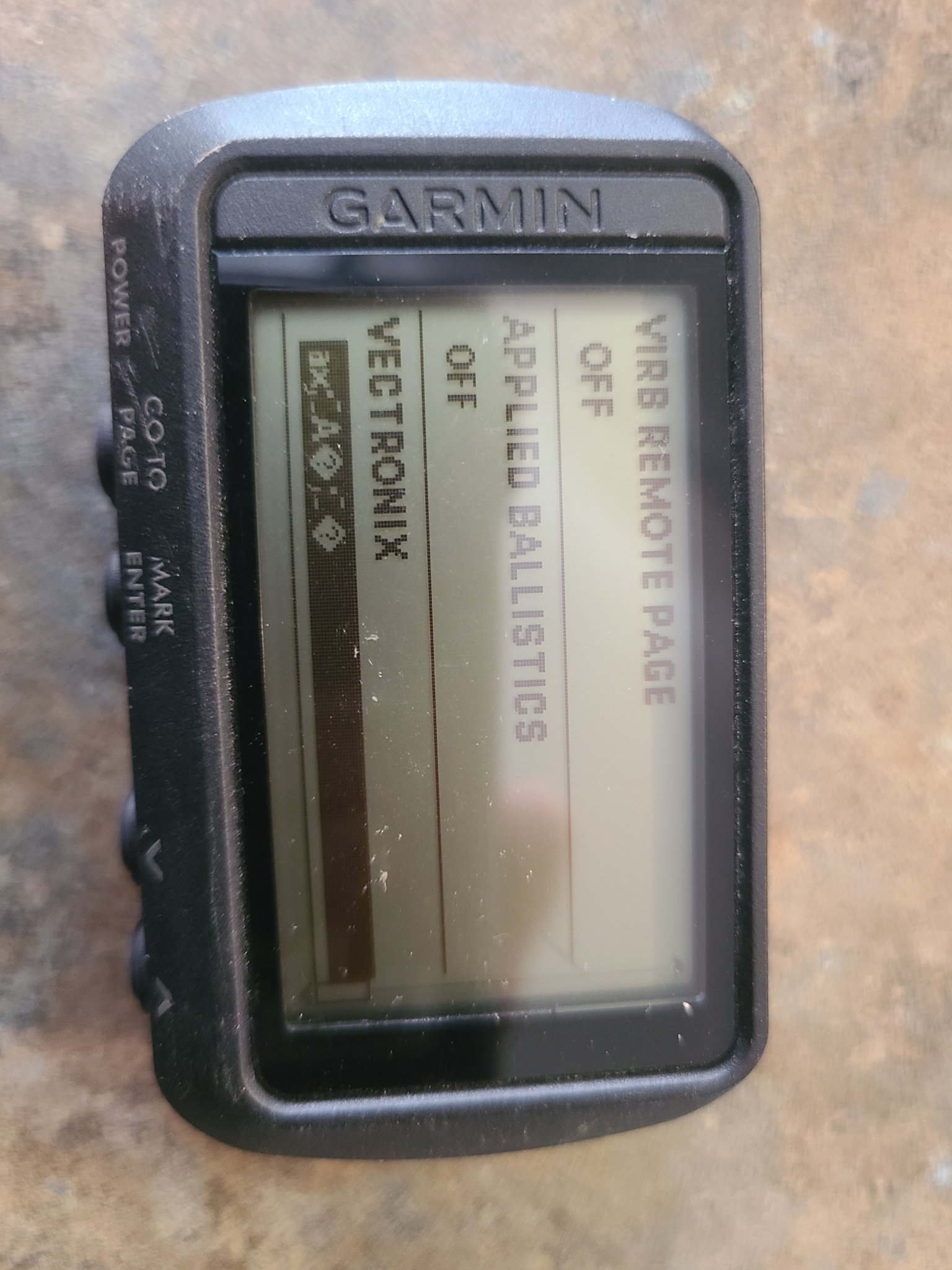

I just bought a 901 for NRL Hunter style matches. I downloaded the latest firmware on both my 901 and my Terrapin X.
After a successful connection between my Terrapin X and 901. The only thing that gets sent from my LRF is the distance, no DOF or inclination.
Thoughts? @DocUSMCRetired @Garmin
Also, can the direction of wind change with the DOF? The wind direction stays the same on mine regardless of DOF changes.
Thanks

With the Terrapin X I believe range is all you get. It isn't in the AB Ecosystem.

Got a software update this morning. Went to their website to see the update details, but only found last year's march update the most recent published.
It looks like they may have fixed some of the wind issues in target card. Only thing I can tell so far without taking them outside is that the wind direction shows up in "degrees" instead of "clock" when set to true wind direction.
I don't know about the terrapin, but SIG, Fury's and Vector X send range, direction and inclination.
What mode are you in on the Sigs? AB External?
Is your Foretrex on FW 2.11? https://www.garmin.com/en-US/software/express/windows/
Yes I have the latest 2.11 firmware. I tried both modes on my Sig kilo10k's, BDX elite and BDX external.
I have also tried connecting on the 901 under AB, Vectronix, and Other. It finds the kilo10k but won't connect with it after I select it on the 901. The screen just says CONNECTING for a long time.
Check and see if the Kilo 10K Gen 2s need a firmware update as well?
I have the latest firmware on everything. I've even reset the 901 back to factory settings and started over.
I just tested this on my Foretrex 901 and it worked flawless with the Sig Kilo 10K Gen 2. Setup the range finder under Connect -> Applied Ballistics. Range Finder is in AB External Mode. FW 2.11 on the Foretrex 901.
Make sure you don't have either connected to anything else at the time. Make sure the BDX app is closed, and the Binos are not connected to another device (They can only pair to 1 at a time).
@docUSMC Since the update i cannot connect my kestrel elite to the 901. It picks up my vectors just fine, but only connects them under the applied ballistics menu on the 901, which i guess would be the same as the kestrel. Has me thinking I cannot have both connected at the same time.
Either way, with all other Bluetooth devices off, it still won't find or connect to my kestrel. I've tried it in both with the kestrel in device mode and PC/mobile mode. Before the 901 update they would connect under "other" on the 901 in pc/mobile mode.
I took it outside with no phone or other electronics with me and I got to connect.
Thank you
It is sending the range and inclination. No direction of fire though. Is there a setting I may have off.
Thank you
