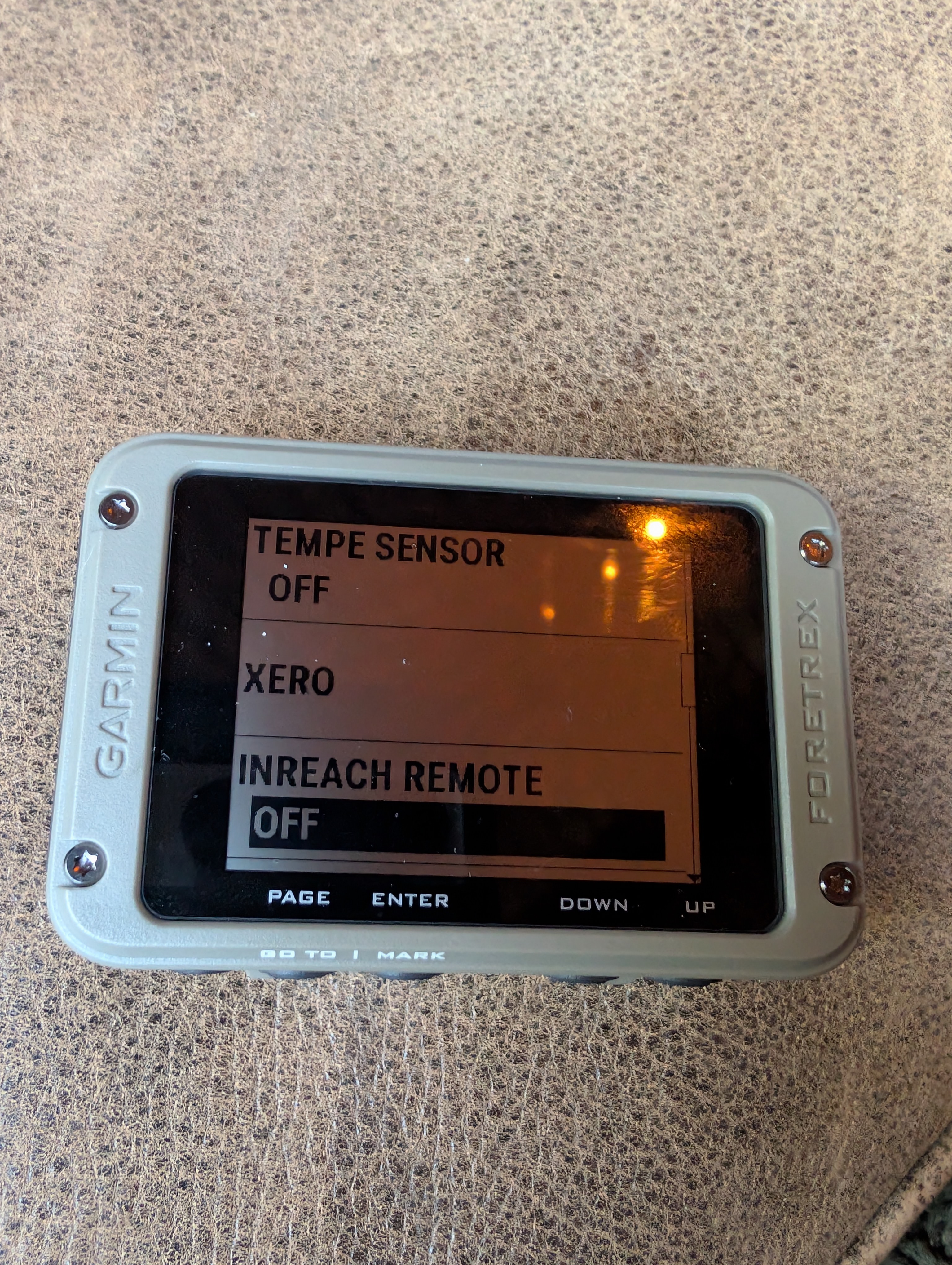

What functionality does the Xero provide to the 901? Is it just updating the current profile's mv? Saves you a couple seconds required to scroll the MV manually?
It's listed as a connectable sensor in the 901's connect menu. Perhaps future intention?

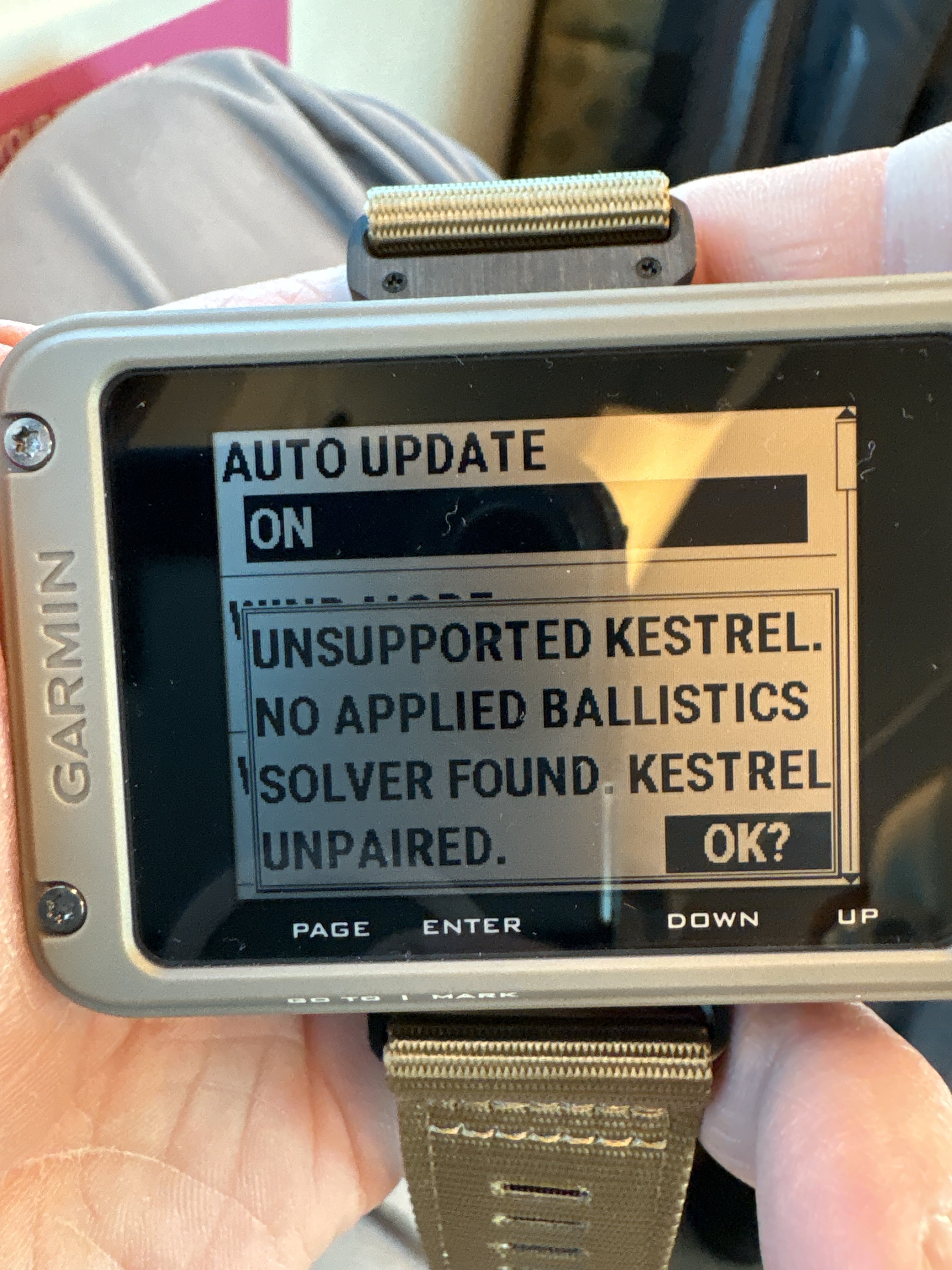

I believe you can connect both a Kestrel and LRF to the 901 at the same time. Because the Kestrel does not use the AB Comms it uses the Other slot. I would say at least give it a try to see if it works.
Hmm. I'll definitely give it a try this evening.
Ok can confirm this works now. Must have been something new in the updates because I couldn't get this to work in the past.
Vector X binos connect under the Applied ballistics tab and kestrel connects under the "other" tab. Could only get the kestrel to connect while in PC/Mobile connection mode. I guess this is so it doesn't try to connect to the vectors at the same time? You must also remember to not have any kestrel app open if your phone is nearby.
I'll put some time behind all 3 synced up and report back.
