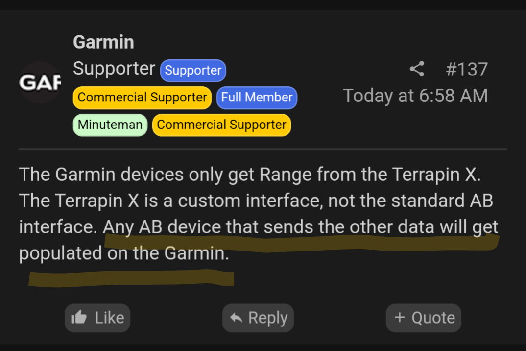

The Garmin devices only get Range from the Terrapin X. The Terrapin X is a custom interface, not the standard AB interface. Any AB device that sends the other data will get populated on the Garmin.

We use the AB interface to communicate with the Vector X. The Garmin will use whatever data the Vector X sends via that AB interface.
We use a custom interface to communicate with the Terrapin X. This custom interface only supports range.

I know there are Sig LRFs that have a compass that do not currently send DOF over the AB interface. I don't have a list of which ones do and don't. You would need to reach out to Sig and get them to update the software for your particular LRF if you're not seeing DOF on the Garmin.
