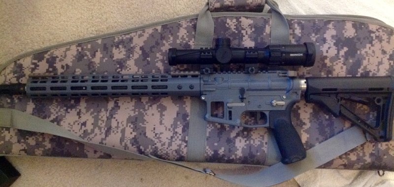

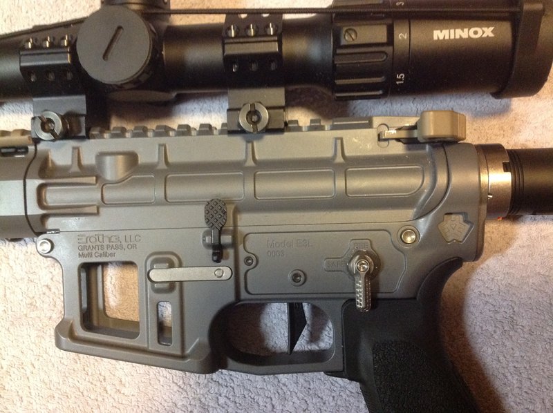

$99.99 + tax :( but I have coupon $10 off :) it's look nice :rolleyes:
I don't want to redirect this thread but piggy back a little on it. If you reduce the blowback, back pressure in an AR, whether its from the can or DIY job does that also reduce the sound signature at the shooter ear as well when suppressed?
I have silencerco Saker 762 Suppressors weight 23.4 oz. is heavy so I like to order the Saker 556 weight only 18.0 oz. or Saker 556K weight 14.2 oz.
And Size " smaller and compact "
why I picky the weight because my AR is like 5.4 lbs. ( with no flipping sights ) so keep light :rolleyes:
like this one

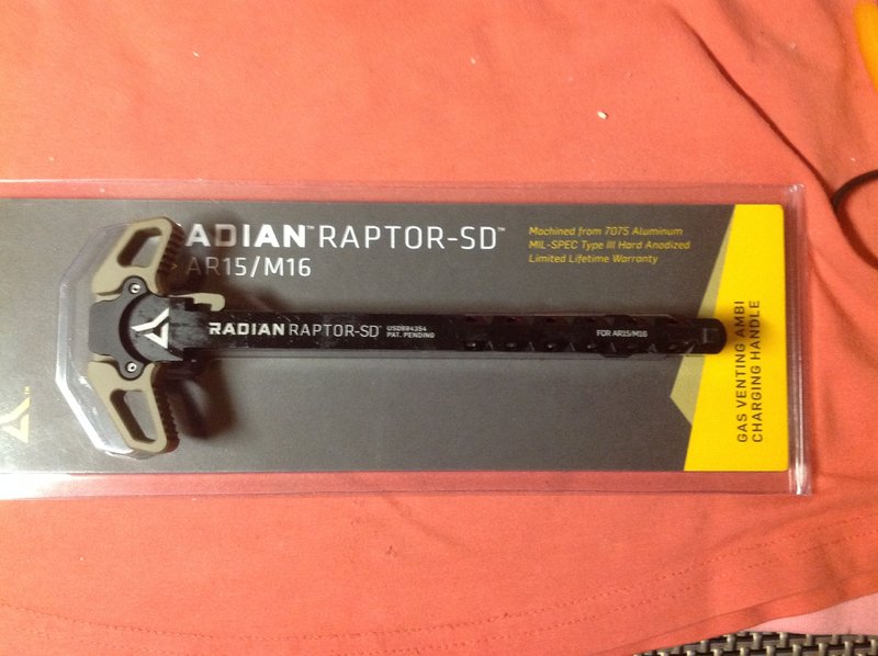

This question opens the doors to a lot of questions. What’ is the best commercial charging handle on the market for shooting a suppressed 5.56 AR? I’ve got a DDM4V1 & I’m waiting on a SUREFIRE can that’s in ATF jail right now. I’ve shot several suppressed rifles & pistols, but this will also be my first can. Right now, I’m running a stock GI charging handle but I’ve been planning to upgrade to an oversized charging handle. I want to avoid gas in my mouth &face as much as possible. There are a few brands out there who claim to vent gas to the right, etc so I’m curious as to what y’all recommend.
The PRI Gasbuster has a pretty solid reputation. The Radian Raptor SD & the Geisselle Super Charging Handle also come highly recommended. What have y’all found that works the best?

Geissele!
As I’ve stated earlier I was looking to upgrade to an oversized charging handle. You’ve used the Geissele charging handle on suppressed ARs & it (they) ran well?
The reason I ask is that while the PRI Gasbuster may work well, ideally I’d like a larger latch on the unit. I haven’t seen the PRI in the flesh, but it doesn’t look very big when compared to a BCM Gunfighter or Geissele, etc.
