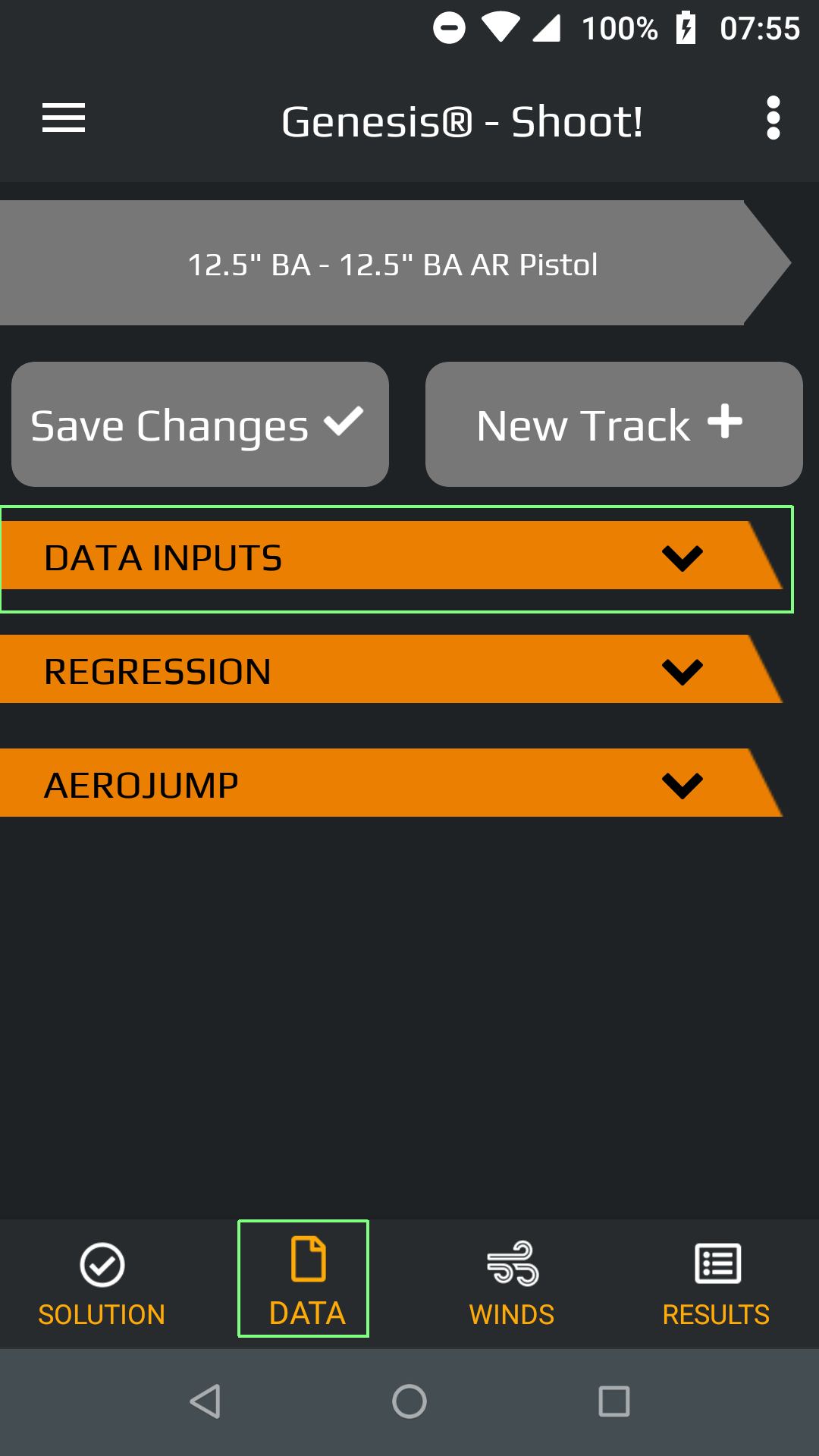

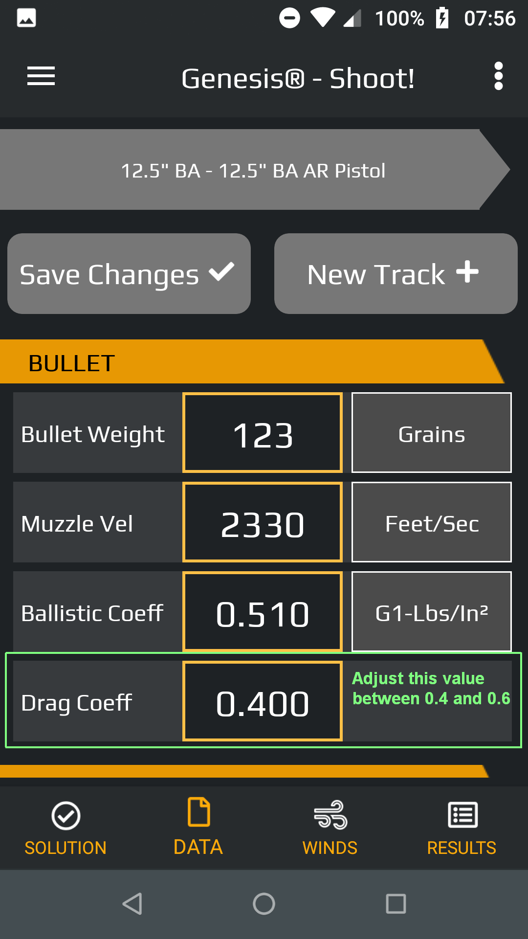

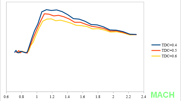

Until we get the official answer from THEIS and Gus I will provide what admittedly little I know.
The "drag coefficient" function provides the ability to tweak the curve to match the trajectory of your bullet+rifle.
There is controversy over the use of that term hence the quotes but it is what both apps call it.
Here is a graph showing 3 different "DC" values and their affect on the curve at different speeds:
This setting is available under the Shoot module>Data section>DATA INPUTS
The "Drag Coeff" is under BULLET
If there is a separate "I shot 850 yards and my impact was 11 Mils so adjust x/y/z to this value" truing function I have not found it yet in either app.
Reactions: iceng and lash

The G1/G7 BC is in the same place as the Drag Coeff under BULLET. Tap the "G1-Lbs/in2" on the right to toggle between them.
You must however manually enter the G7 BC value in the middle box. Then Save Changes for the Track.
You can see the fields in my screenshots a few posts up.

For example, we just finished an XLR class here at Gunsite. After class, I fired up Genesis and launched a few Warner Tool 351gr solids from my .375 CT. I use a Labradar, carefully positioned, the scope is calibrated on a fixture, the target ranges accurate to +/- 2 yards, WT provides a BC derived from Dopper radar data. The elevation at 2307 yards is wrong by .4 mil, 1501 meters is off by .3 mil, using the Labradar velocity and the factory BC.
What's wrong? The model is not faulty, I've used Coldbore for many years, it's one of the recommended software systems here. All of the basic systems available all have good and bad points, but most provide good solutions if correctly calibrated.
My FFS profile is correct for the .375, but it required an alteration to the 'factory' BC and a change to the DK value. Doing nearly the same changes to the Genesis program corrected the solution. I've got to use it more, but I don't really expect to see any problems with the engine itself.
Now, I should note that changing the MV by more than a couple percentage points is suspect, as is altering BC more than a couple percent without solid downrange velocities/TOF to compute corrected values. Changing MV from 2560 to 2500 to correct a .3 mil error at 600 is clearly wrong and is going to cause more problems than it solves. Changing the MV by 10 fps to move .2 mil at 1500 yards is quite reasonable, and hardly indicative of a faulty model.
Try for example, putting three LabRadars in position on one gun (L/R and above) Do they all read the exact same value? Which one is correct? Even the 8' spacing on an Oehler is subject to setup errors in the angle of the sensors.
Let me start by saying that the term "truing" is correct if applied correctly while "tweaking" is not when using some sort of "software adjusted MV" a really bad practice that tracks down to the now long gone Exbal, which is still prevalent in the realm of Point Mass solvers, clearly a practice that has nothing to do with the correct technical approach by relying on a methodology so common in the field of engineering when dealing with instrumental errors.
I certainly agree that using the DC value is the right way to "true" a somewhat dubious BC. Having said that, MV is another story.
