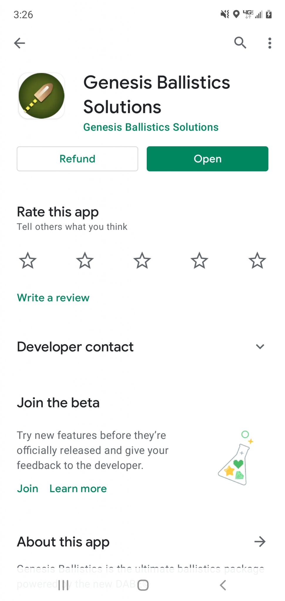

Hi,
Android getting closer, lol.
I just tested downloading from the play store.
Come on Google validation department!!
Sincerely,
Theis

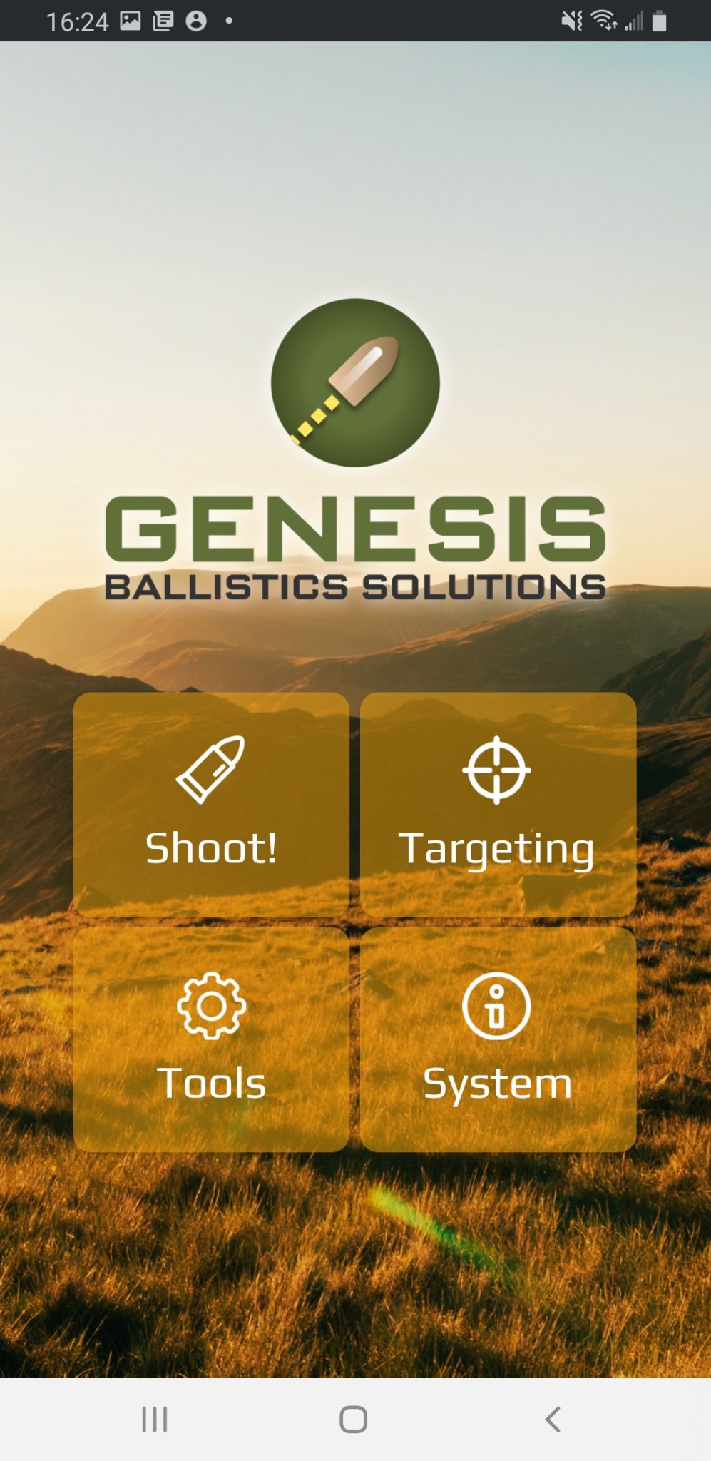

I bought my copy...
I’m looking about it, I create a track and saved it for one of my rifles, I choose one bullet from the database but length and other parameters are not present.
exit the program and join again, recall my track and I’ve an error message about muzzle velocity at zero, but if I hit results I’ve the table, but every time my previous setting are not present, I use metric and I see imperial.
may be I could do something wrong or no, later on I‘ll do some more test.
the Solutions are very close with other solutions ( Strelok pro, FFS, TRASOL ) I’ve checked till 1000 meters, not yet ELR distances.

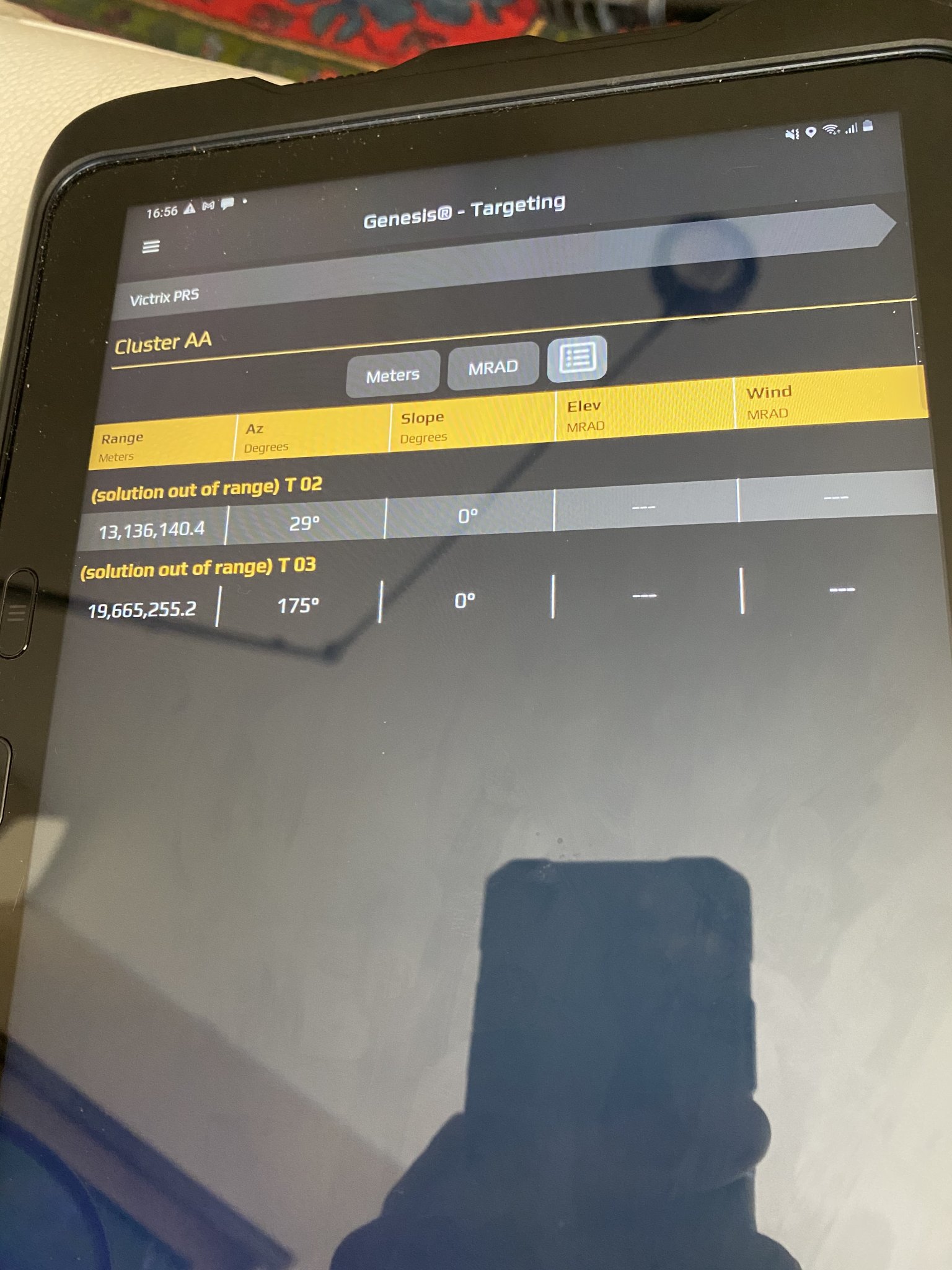

I like the targeting page, but to have target coordinates in MGRS or UTM I need to save a target before, will be much better if you can have the possibility to have same format as FFP on the initial page where you add a new target talking about map page.
I created 2 targets and a cluster, but if I select the cluster I don’t have the 2 targets on the map, if I use the range card I’ve the cluster with the 2 targets but with solution out of range, my targets position are very closed 400 and 700 meters...
may be as I wrote, I can do something in a wrong manner, I’ll check better later on.
In the next days I’ll check other functions.

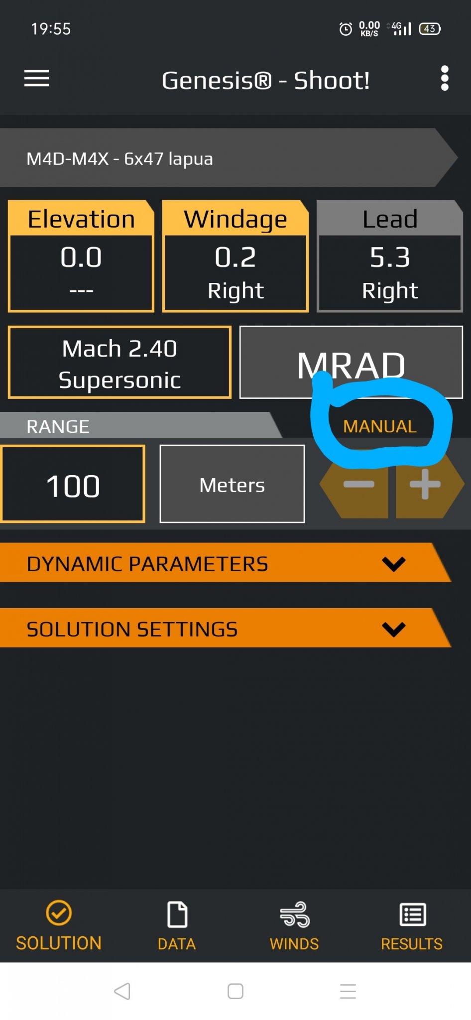

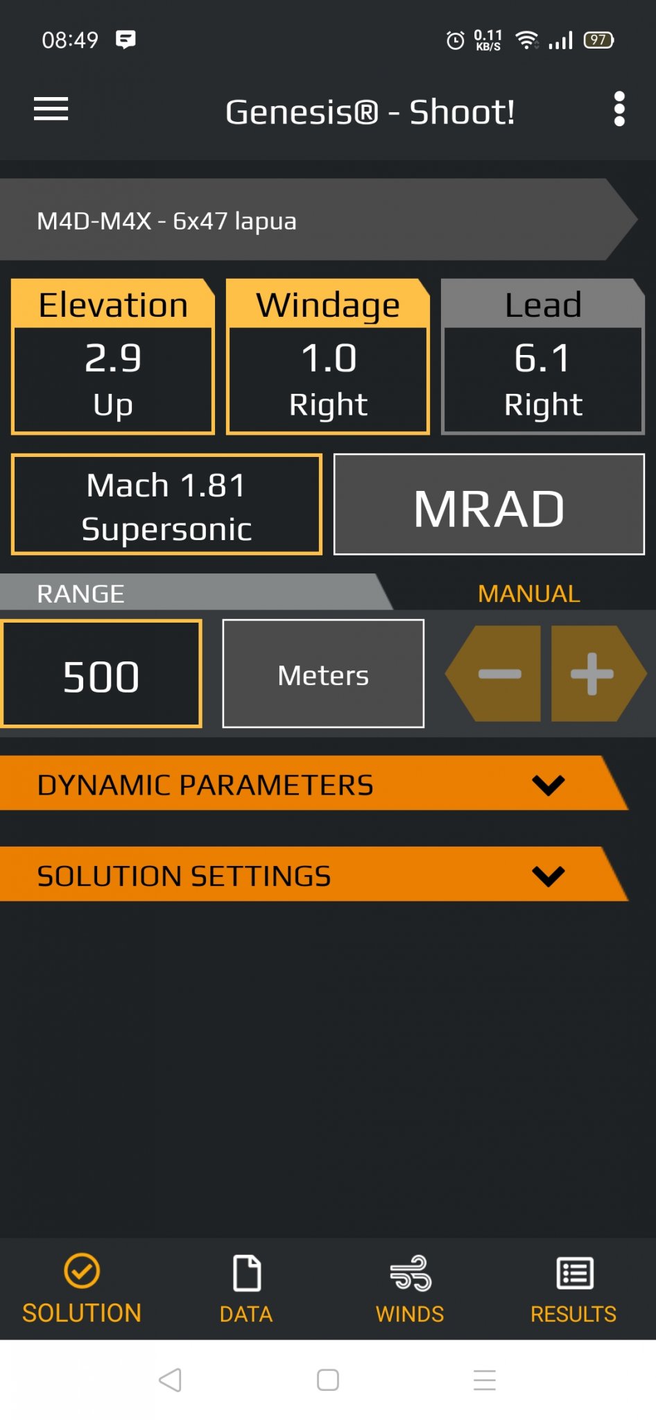

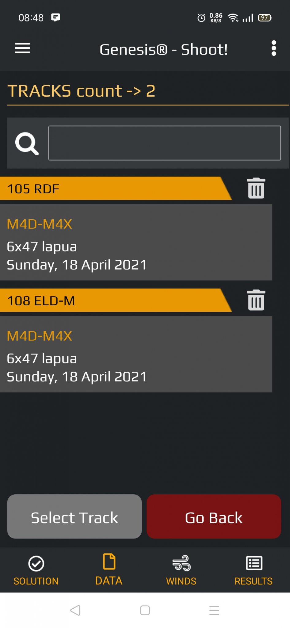

I was going to go shooting with it next weekend, with a mate and a camera and do a super basic "here's how to enter data and here are the results vs strelok and 5700e, and here was me shooting", nearly for a "quick setup" not in-depth. If you have a few people making videos, I'll eagerly await theirs.
- ability to rename a track. Long press ? I can't work that one out. I have 2 loads for one gun, entered them. My example I can (easily) tell which cartridge load I've selected, but once loaded, at the top it doesnt identity, so I want to rename the track.

I'm new to the coldbore engine, a "track" is a set of conditions, yes?
Reactions: BLKWLFK9 and lash
When I plugged the environmentals in and
A track is your rifle and cartridge setup. 223rem 68gr on a AR15 is one track, your bolt action 308win W/ 175gr SMK hunting is another track.
I personally run multiple ammo in one gun, purely for testing / comparisons, etc.. so same gun, multiple tracks.

4) Yes you can enter coordinates in either system by first starting the GPS, go to TARGETS select the system and tap on GPS or Manual or Map modes. So, there is no need to save a target first.
5) The Range card is based on the GPS current position and if the Target is beyond a useable range there is obviously no firing solution.
6) There is no need to select a Cluster, if there is no cluster selected all stored targets will be displayed.
