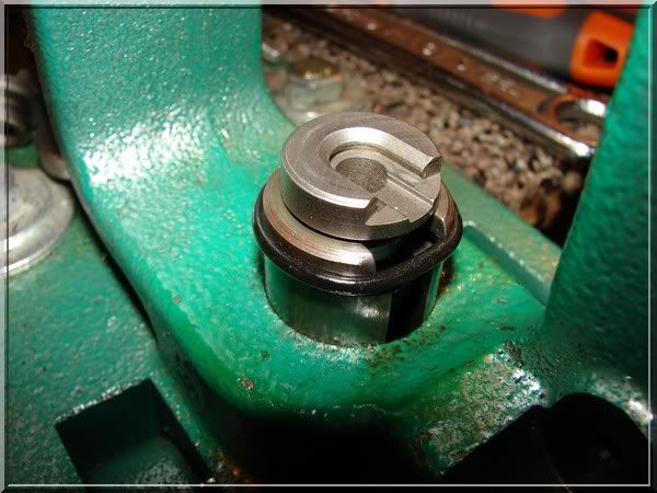

Tres, I myself have tried this in the past but have been concerned about my ability to return dies to the exact same position again and again due to the elasticity of the o-ring.
Have you found any negatives from using this technique?
Re: Got $2 for better handloaded ammo??
V,
What I did is scribe a line on top of my press across the die hole running 6 to 12 o'clock position. My seating dies a micrometer style and have a vertical line on them.
As far as my sizing dies I either have scribe a vertical line on them or made a stripe with a paint pen.
When I screw a die in I purposely dont quite line up the line on the die to the line on the press. I begin loading or sizing on the brass and keep snugging up the die till my measurements fall in place.

A "wrench" I made to fit my torque wrench and the the Hornady style split rings that I use.
Dies are set up and then torqued the same each time, which puts them back to the same place each time. I use 200 inch pounds.
IMHE, a whole lot more exact than fartin' around with lines marked on stuff, and o rings....

If You had a forster Co-Ax you dont even have to worry about tightening down the same each time because you just snap the dies in and out.

Been using the o-ring on the bottom for years since I read it in Zediker's book - it does work pretty slick. Never been 100% comfortable with the o-ring under the die ring - the concept is good and all, but there is some room for variability depending on how you snug it down from one time to the next, at least for me. The Forster Co-Ax press provides much the same effect both top and bottom between the snap-in floating die ring and the spring-loaded shell-plate jaws. For other presses like RCBS, Redding, Lee, etc. the o-rings are definitely worth looking into.
One observation... Lee Collet (dunno about their 'regular' ones) dies have been coming with an o-ring on the underside of the lock-ring for years - apparently they believe in it as well.

way to think precision but your still snugging your die down metal to metal. And when your metal to metal what you get is what you got regarding misalighnment in the tolerance stacking between the press frame, ram od, machining of the ram to accept the shell holder, machining of the shell holder itself, threading of the die, the bore of the die to the body itself... on & on.

Well, yeah, and that would be a worry with shit dies and a shit press....and of course a misconception about one's own mechanical apptitude. The truth lies squarely in the run out, or lack thereof.....(pun there, likely)
I run good dies and presses, which tend to aleviate a considerable amount of bullshit in that regard, and no one held a gun to my head making that/those choice/choices. One thing few "average" reloaders bother to find out about is in fact the variations in shell holders. This comes into play the worst when having several holders that fit the same case head dimensions; and allowing them to be used interchangably without any regard to the fact that not all shell holders are created equal. The biggest problem is the height of the shell holder, which will easily change the headspace of a sized case. I've at least a half dozen here to fit a .473 case head, and from shortest to tallest is about a .025" difference. Not exactly "bump-the-shoulder-back-a-couple-thou" friendly.
Dedicating a shell holder to a specific RIFLE is the only way I go.........

I have forster co-ax and I can't imagine using any other press anymore.
However, before I bought the co-ax I took the spring clip that held the shell holder in the ram out. This allowed the shell holder to move freely in one direction. I then turned the shellholder so that the opening for the case head to slide in was at a 90 deg to the opening of the ram. This allowed the case to slide freely in both directions. I also stopped snugging down my dies in the press at all but indexed them with witness marks so they returned to the same place every time. Once I had my die where I wanted it, I would just turn the lock ring back just slightly and lock the lock ring to the die. I have a set witness mark on the press, and then I made one on the lock ring. This way after I snugged the die in the press all I had to do was turn it back slightly to the witness mark.
Same theory as the co-ax, allowing the cartridge to self align itself with the die. I couldn't tell you if it made a crap of difference but it made sense in my mind to allow the cartidge to self align as much as possible and my runout numbers were still pretty good.
