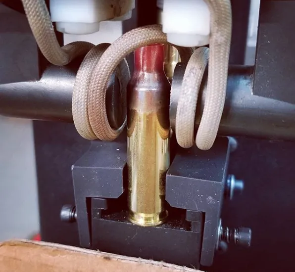

I have run around 200 rounds through my unit using the case feeder, and now know I don't need to buy an AMP. I had a couple issues at first. One issue was that the case feeder was not triggering the Annie, I troubleshot this down to a micro switch that was hooked up wrong. Garett at Fluxeon helped me sort the rest out. One note if anyone is considering the case feeder is that it does not come with a solution to hold the hopper (uses either Hornady or Dillon). Anyone else running an Annie/and case feeder?
Video of it in action (it looks like the brass got more red than it did in real life, I used templiaq and its at 750 ?)

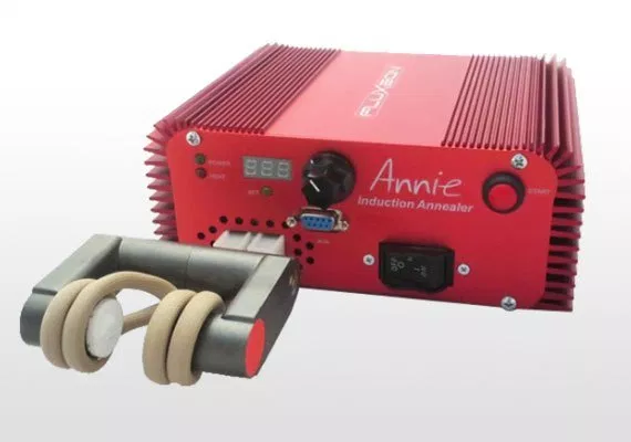

Yeah, red box is the annealer itself/power supply.
Annie in its base configuration
As you can see it is operated by the press of the red button to start its cycle. But you can also plug in a switch to the blue port on the front to operate it remotely via foot switch like a sewing machine or spot welder etc. But it can also be used to get it to work programmatically like I assume he has it set up to work in conjunction with the case feeder. Edit:(which is indeed the case)

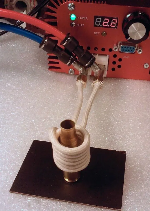

Water cooling replacement/upgrade coil
You can swap a coils connection at the front of the machine though for different styles.
Cooling reservoir
The tubes off the water coil just attach to this water reservoir/heat sink.

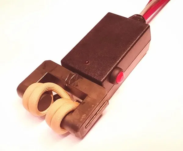

But in addition to a different coil attached right to the font of the machine they also have remote coils that let you stretch it some length away from the actual annealer body.
Remote coil
By combining those things you can have the remote lead atatched to the case feeder.
Case feeder
