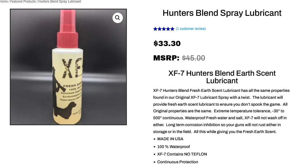

Yeah that’s pretty neat.
I wish it didn’t have a smell though. I’m with him and don’t like using stuff that can spook game animals.
I have their original formula & it has a mild citrus scent. They now have this Hunters blend.
