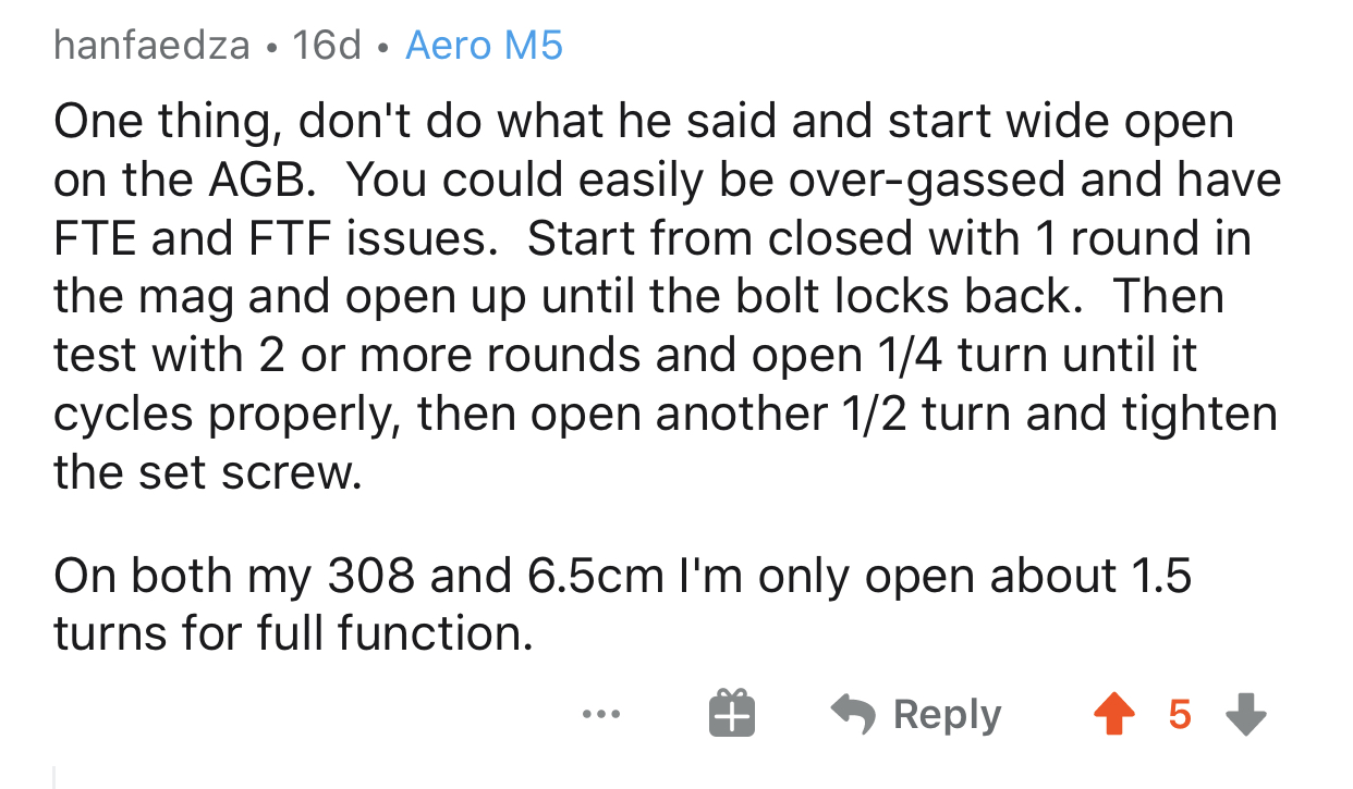

This is the post he made on a post I made on Reddit in reference to the fiasco that my post on ar10 forum became.

Like mentioned, having your gas block open all the way is not going to hurt a thing. The last rifle I built I didn't bother with an adj. block as it is a point of failure. It runs great suppressed and unsupressed with my buffer and spring choice.
Some barrel makers over size their gas ports for "reliability reasons" because they don't know the buffer/spring/ammo that will be used.
Some don't, and are made with more appropriate port sizes. So having to open the gas block all the way could also be a sign your gas port isn't oversized.
Having an over gassed gun will only beat you up, and maybe the rubber bumper on the buffer.

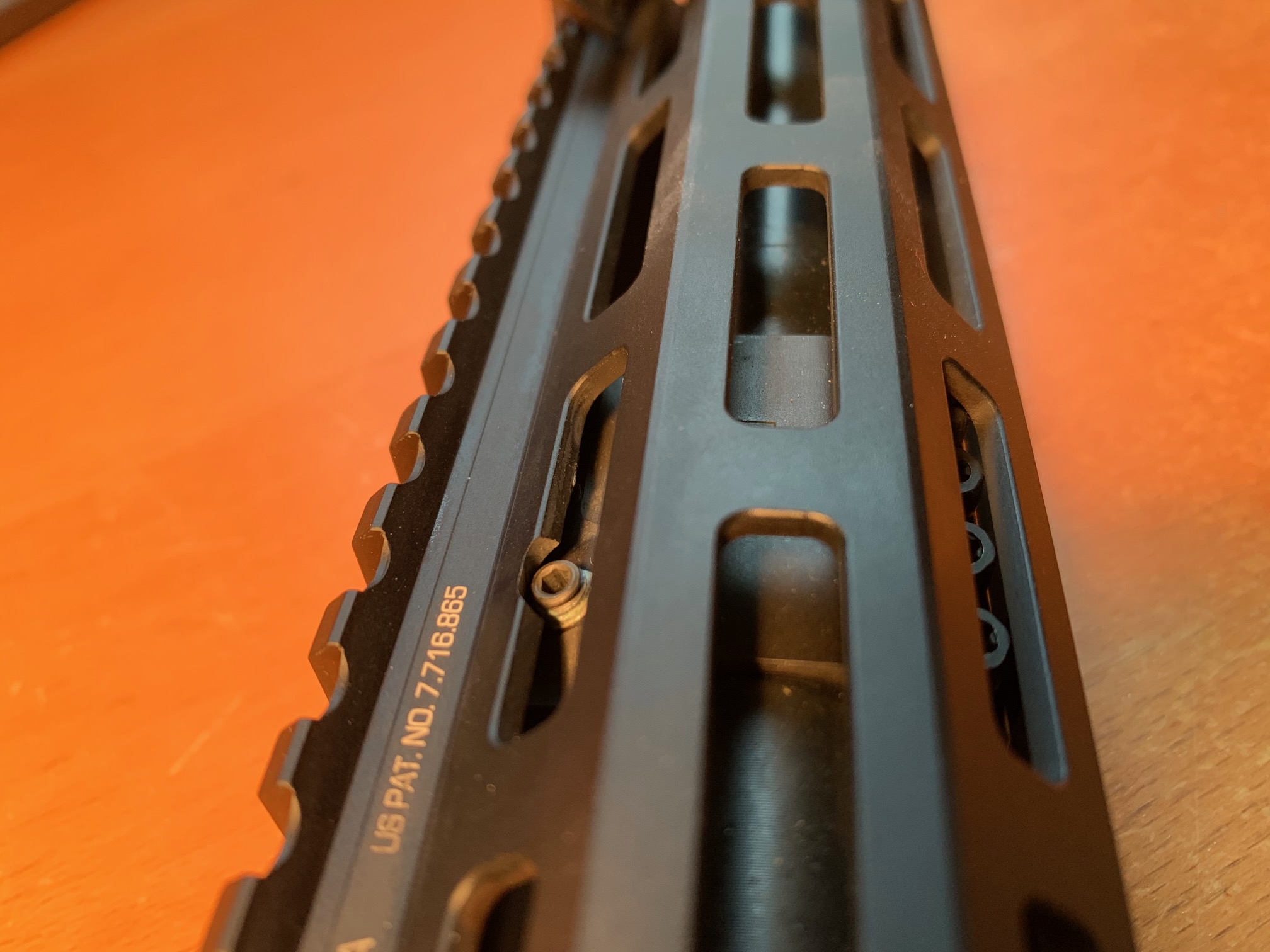

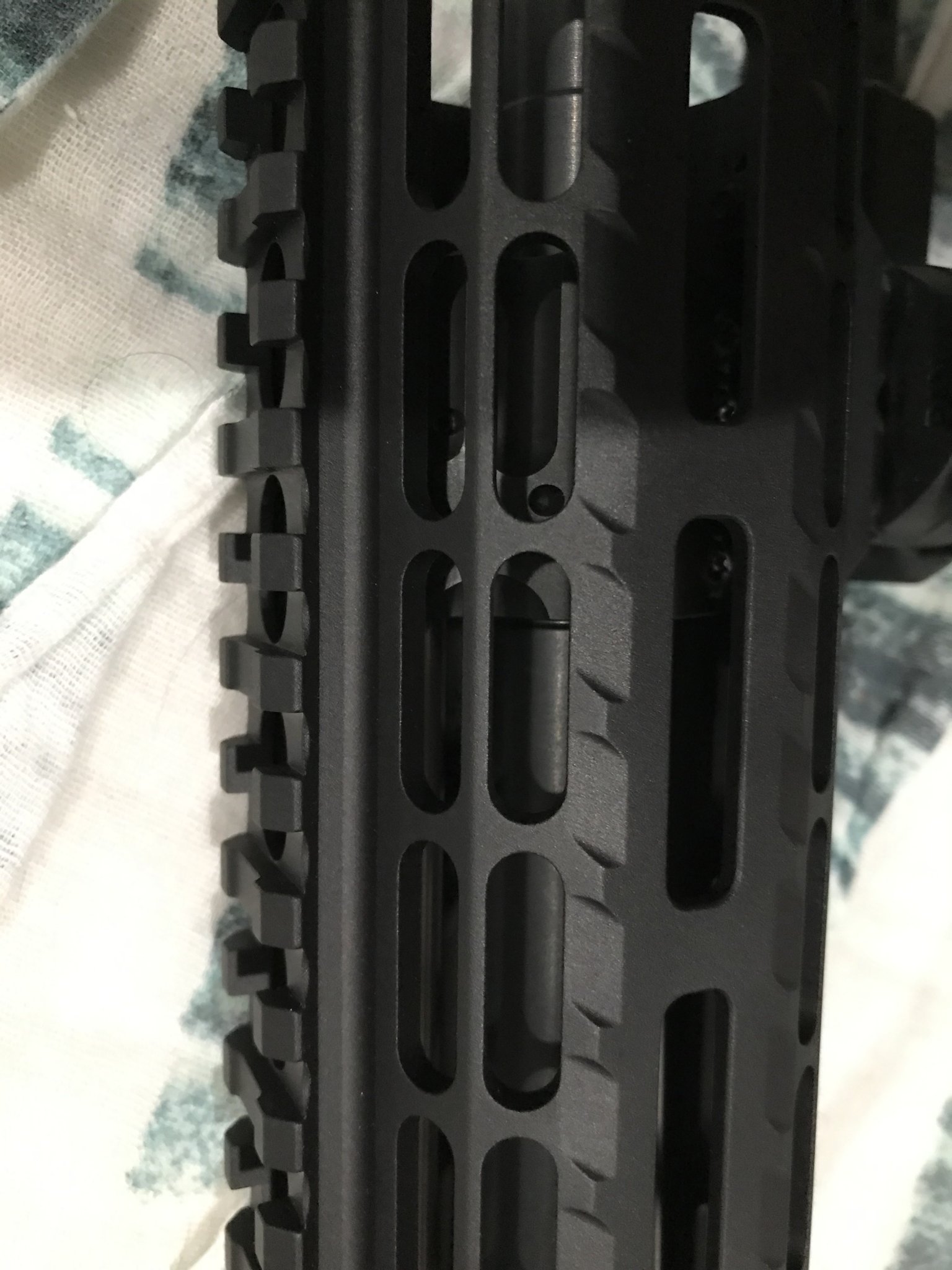

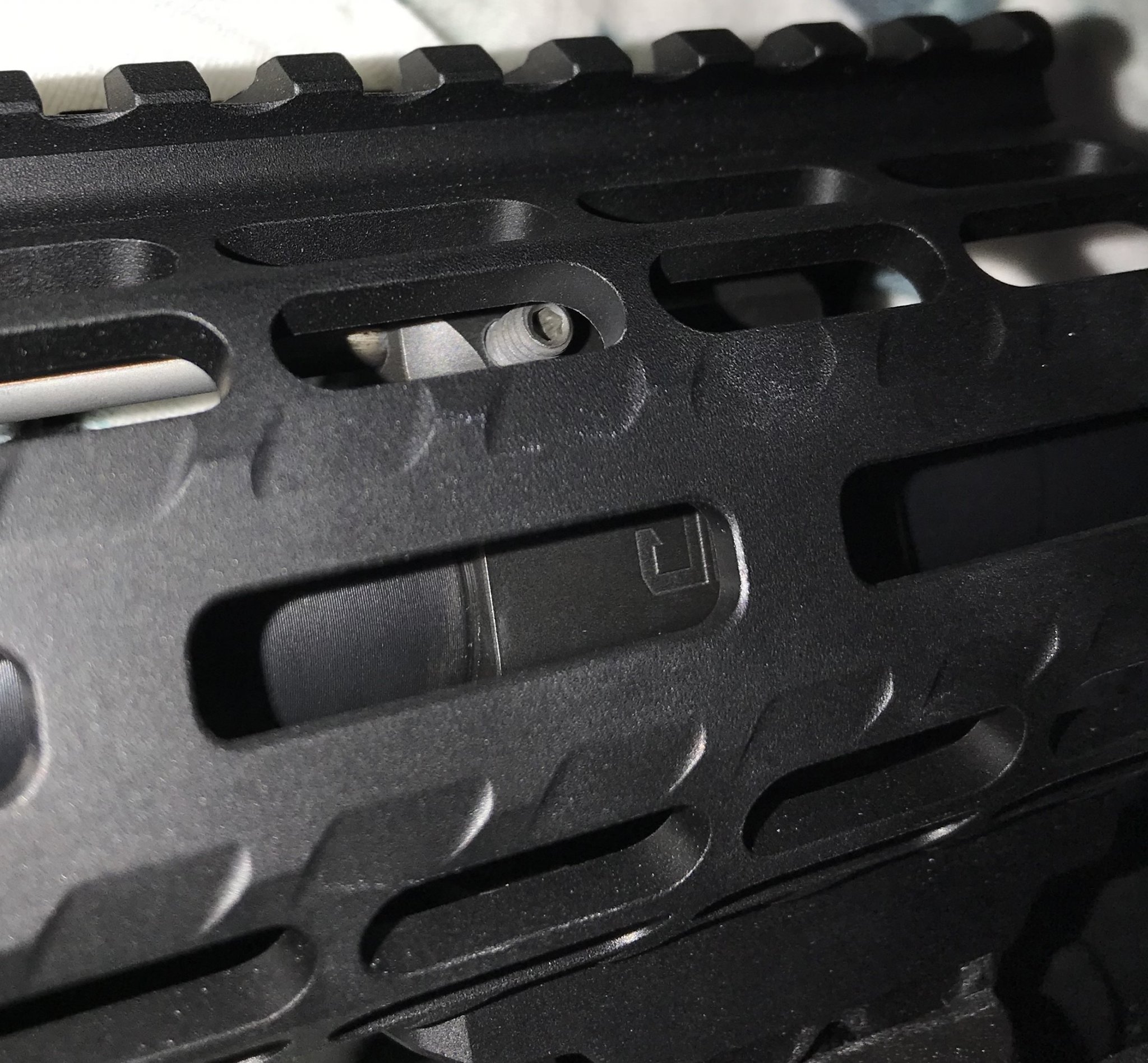

When I say it doesnt work on the bench Im not saying I rest the rifle on the mag. Im not sure where you got that idea? I have a bipod...
I cant really open it up much more without the adjustment screw falling out. I actually took your advice bro. Its really annoying messing with the gas setting as it sits perfectly behind the rail so that I have to remove the rail every time I adjust it. I think the trying other types of ammo might be it. I have only tried 180gr so far as it was the cheapest of what I have. I have 3 different Australian Outback loads and recently got a bunch of the steel case 308 for shits and gigs. I might buy another gas block to avoid modding the port. It needs to be a clamp on as they dimpled my barrel terribly off. Were close boys! The real question that I dont think anyone knows the answer to is why it only cycles when firing standing. When Im on the bench I feel like Im actually holding it tighter than standing. I do appreciate all the help and do take most suggestions. Ive got it opened up about as much as itll go and it seems like the port is just too small for this gas block and buffer set up. Im not sure how much more I can go out without losing the adjustment screw.
*edit* when I first got into guns I was an AK guy. They have always ran flawless. Ive literally never had any problems and that was running steel only. Then I got into ARs. They also always ran and have never given me any problems. I almost never clean or lube them either lol. I took a big leap to come to the bigger boy ARs and its just been one problem after another. I def appreciate the input and help. Dont give up on me yet!

I've never seen that actual gas block, but is there no lock for that adjustment screw? On all my adjustables with screws, there is a locking screw and an adjustment screw. On my M5 setup, it's a set screw and another set screw in the same hole for adjustment. You adjust it and run the screw up to the other one to lock it in. Other's have a screw from the side. If that screw is the only adjustment and there's no lock, that's a failure waiting to happen.
I'm sure you've looked at it enough to know, but there's not another screw in that hole, is it? (because that's how mine is setup)

Per your picture I can see you've got that block wide open now. .089 gas port (if it is) with rifle length gas in a 20" barrel would be enough for a 5.3oz buffer.

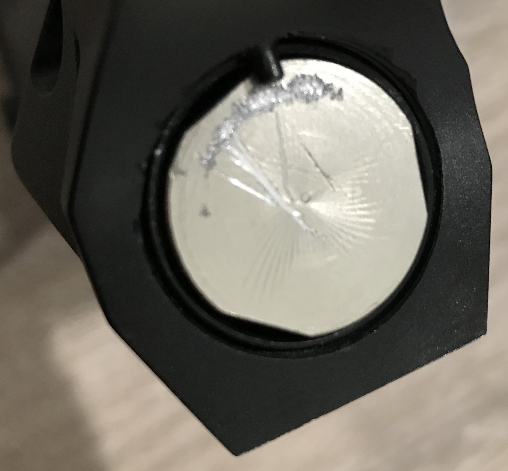

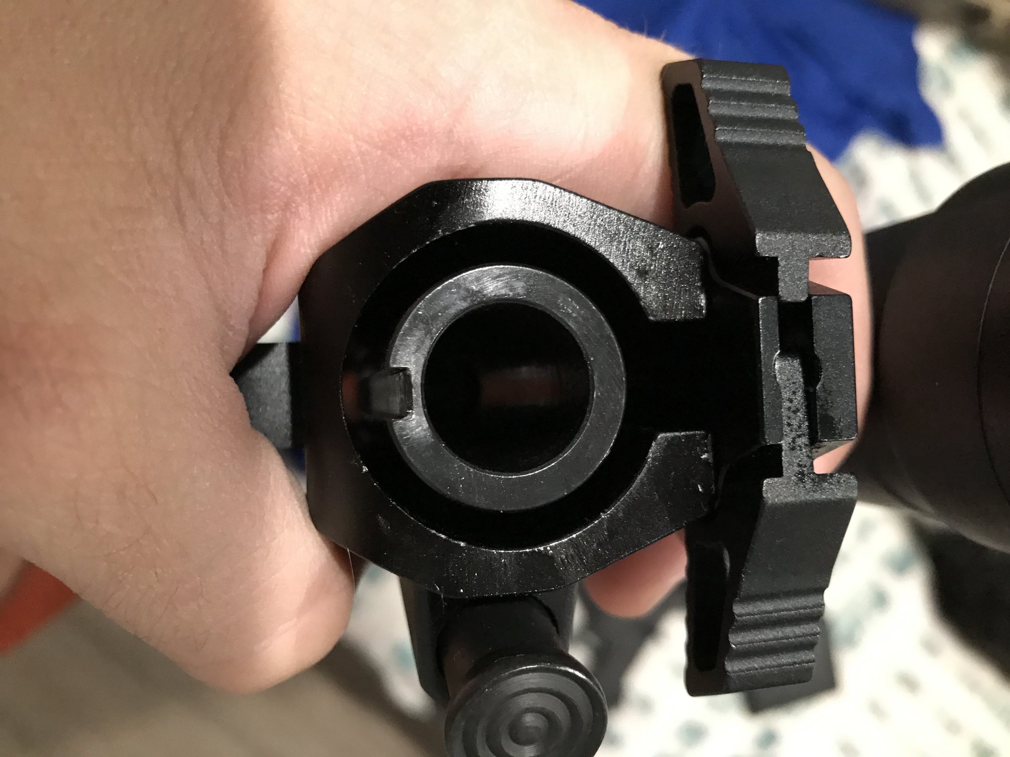

So I haven’t taken it to the range lately. Honestly it’s too painful lol. Anyway I ordered an A2 buffer spring it and came today. They are the same length but the new one has more coils. I’m hoping that will be the fix. It’s much easier to pull the bolt back now. It says on the package compatible with most AR-15 calibers. Will this not work for my big boy AR-15? Also I noticed some marks on my buffer is that normal? Since this new spring makes the bolt pull back easier I think I’ll try adjusting the gas again.

I wouldn't put an AR 15 spring in there if it was mine. The spring you seek is here. http://heavybuffers.com/springs.html
This one. It is the Armalite spring & has a very good reputation for reliable function in large frames. If it won't run with that then something else is wrong.
The marks on your buffer are caused by an out of spec (if there is one) lower. You could contact Aero & show them that picture, but I wouldn't bother.
There is a fix and it's pretty cheap.
The buffer retainer detent is machined to far back. The buffer should be sticking out beyond the face of the receiver a little, like .030 when resting on the detent. When you close the rifle & look carefully as they come together, the back of bolt carrier should contact buffer just before closed and push it in (again about .030). What that does is to push the buffer away from the detent pin a little. The only time the buffer should contact the pin is when you break it open via take down pin. Yours is smacking the pin while running. Probably also causing a little bolt bounce.
This will fix you up for $18.00 shipped. https://gallowayprecision.com/offset-buffer-retainer-for-AR-15-rifles
There is a full explanation on there sight.
