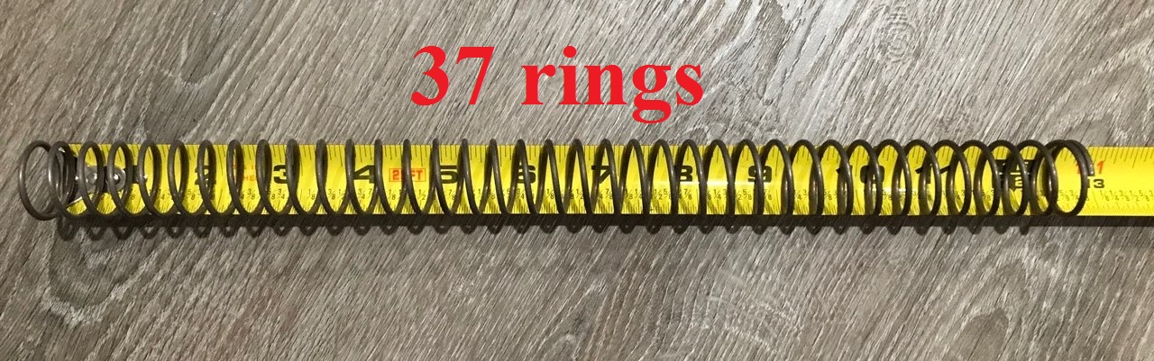

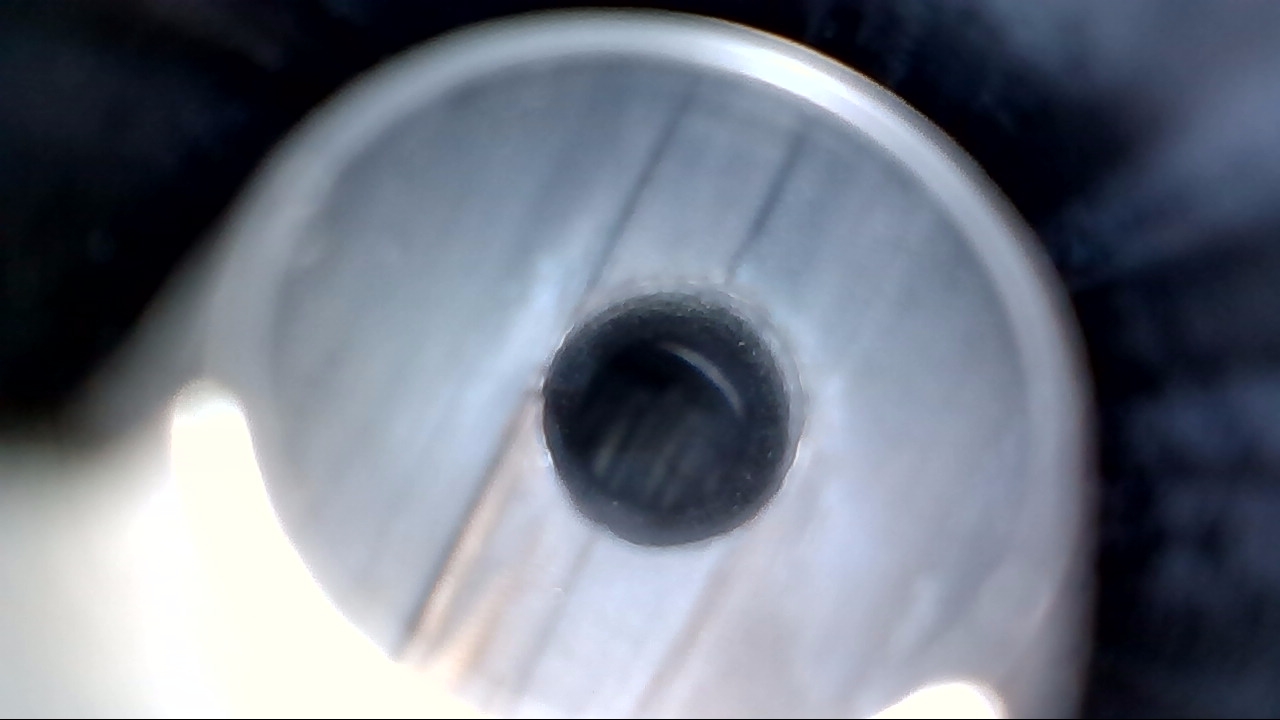

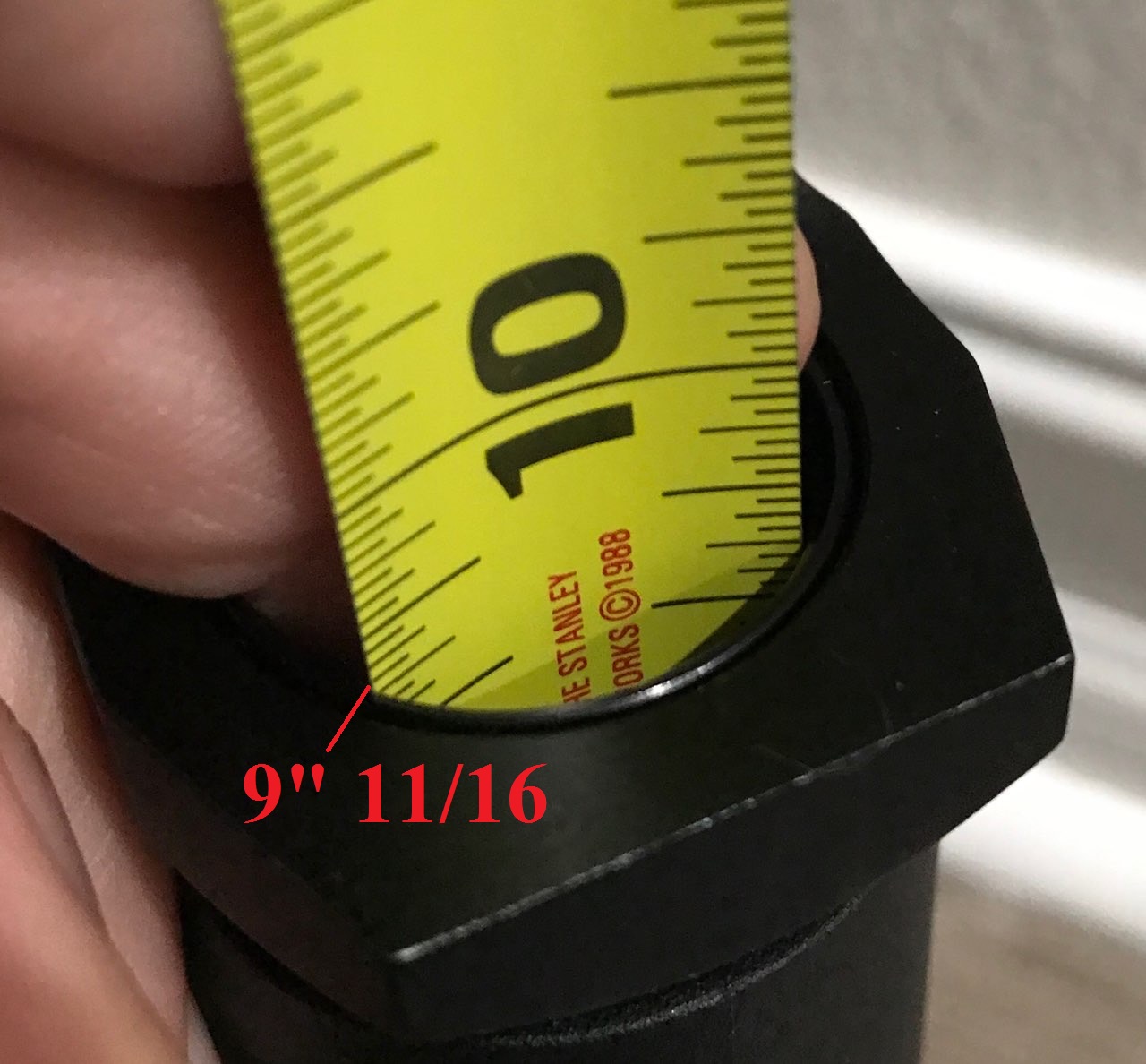

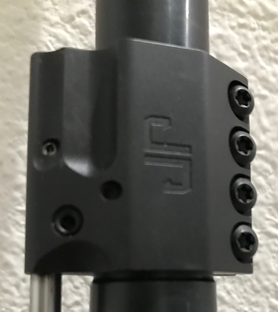

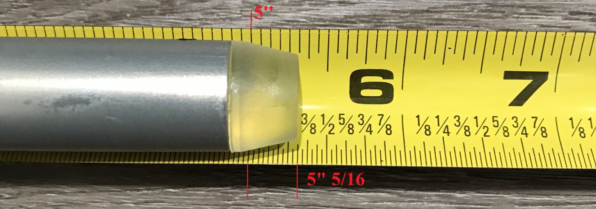

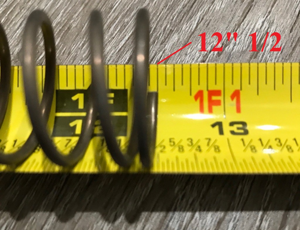

This is my first 308 build and its been nothing but headaches. I have the JP gas block adjusted almost all the way out. I have about ten rounds through it and have only gotten it to eject twice. It has yet to pick up another round. Im thinking my spring is too strong or something is up with the buffer. Im trying to figure out the specs need for an M5 build but not having much success. Any questions or pictures needed Ill try to get to ASAP. Id like to get this thing running.
Parts used for gas/recoil-
Luth AR 308 buffer, spring and tube
Aero Stainless rifle gas tube
JP adjustable gas block
View attachment 7356039View attachment 7356036 View attachment 7356035

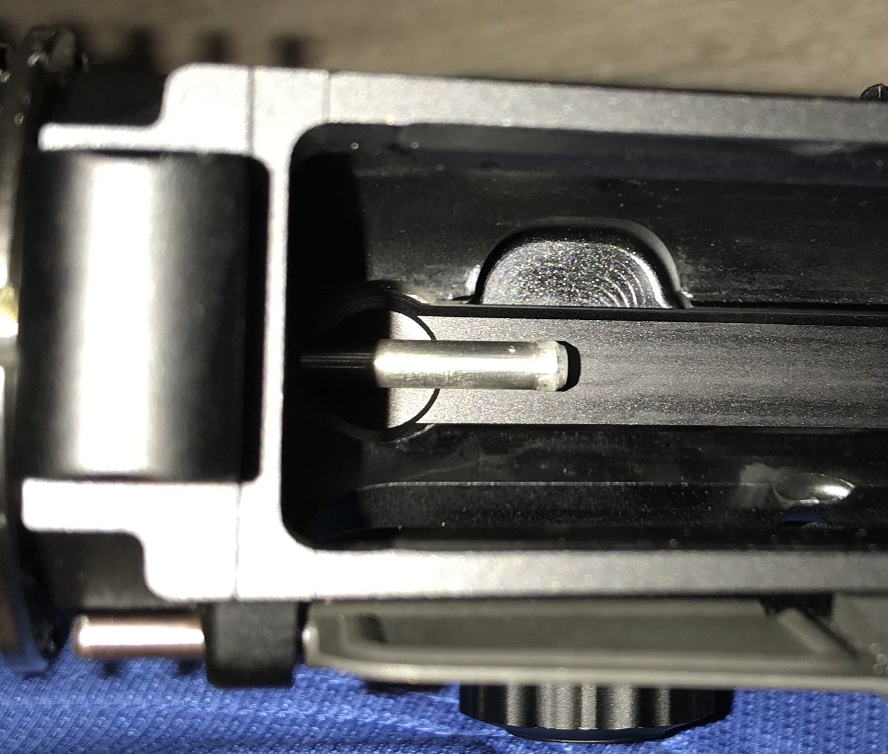

BA's response to my question about gas block placement on BA Modern Series 20"
When charging is the action smooth...does the BCG easily come off the gas tube and seat all the way back in, lugs have rotated, etc.. Neighbor's AR10 was cycling for crap and it was an oversized gas tube causing the BCG to bind.
Reactions: Ravenworks
Two credit cards' thickness is way more than 0.025". Did you ever shoot it with the gas block back against the shoulder? Did it work?
Yeah it wasnt working against the journal. After moving back like you see in the first picture it seems to be running the same. I might buy those little plastic dowels or the gas block genie to make sure its on there just right.

The gas block set back is definitely to much, that needs tightened up.

Just got back from the range. I still have a 1500$ single shot rifle! The gas block is 100% aligned. When I shoot a round still won’t eject. When I go to pull back the bolt after firing a round it is almost stuck. It takes a good amount of force to eject the round. This isn’t a problem when I’m operating the gun without firing. Any thoughts? I cleaned the feed ramps. I oiled the hell out of the bolt. I’m thinking it’s either the bolt has problems. The gas tube could be jacked up somehow. Maybe it’s the spring and buffer? Again thanks for the help fellas I really appreciate it. I’m disappointed every time I go to the range. Although to even it out I got some M4 and P90 full auto love to even it out.

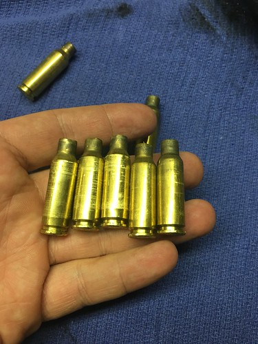

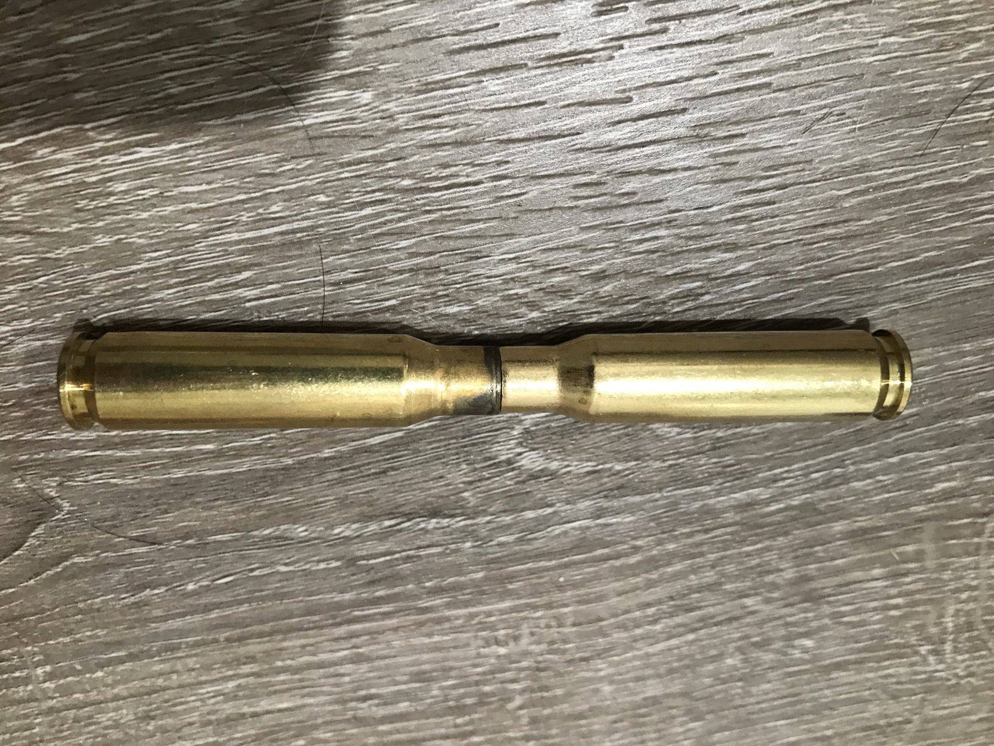

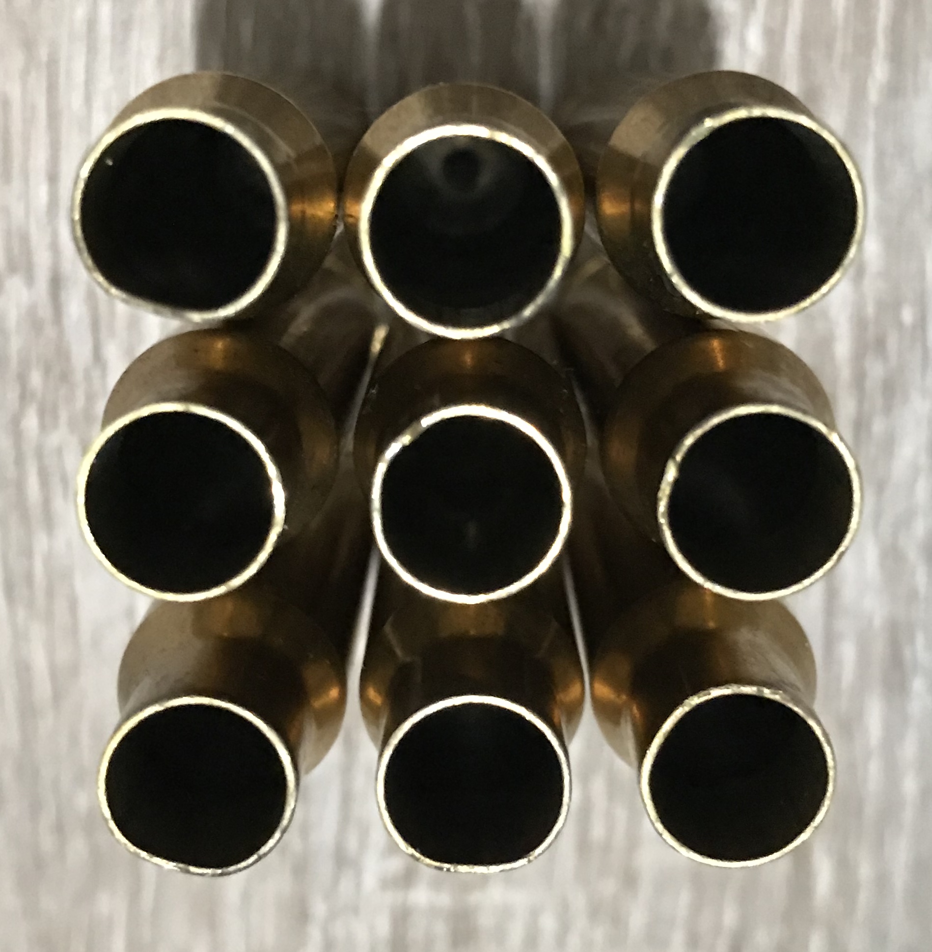

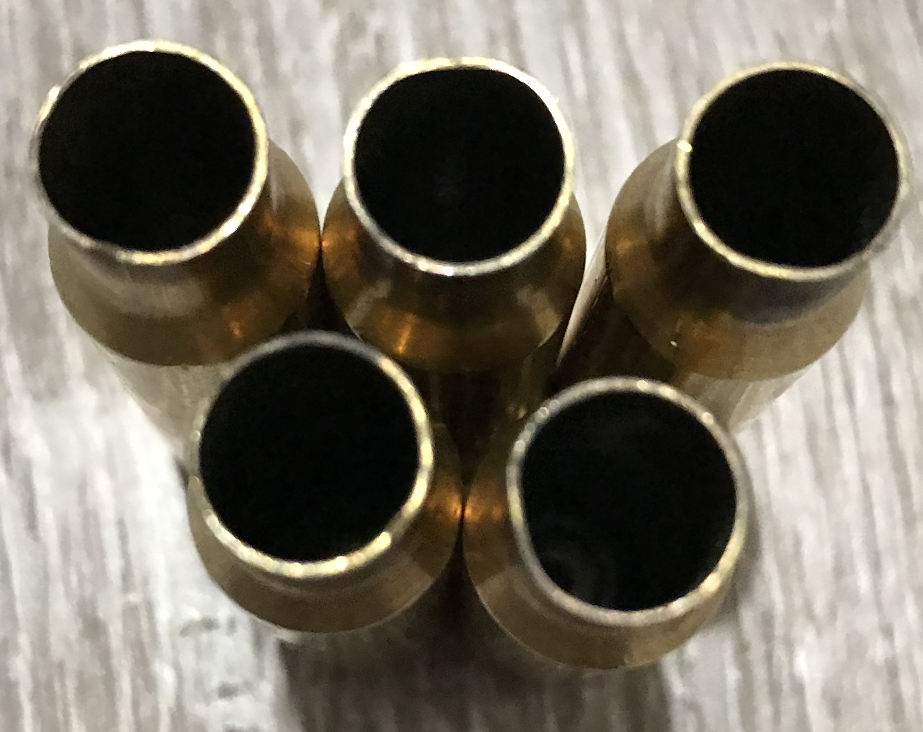

Can you post some photos of the fired brass cases ? Case rim , head ( and primer and body.
Looking for scratched up cases... from a possible buggered up chamber.
Also looking for the marks from the extractor , popping of the case rim.

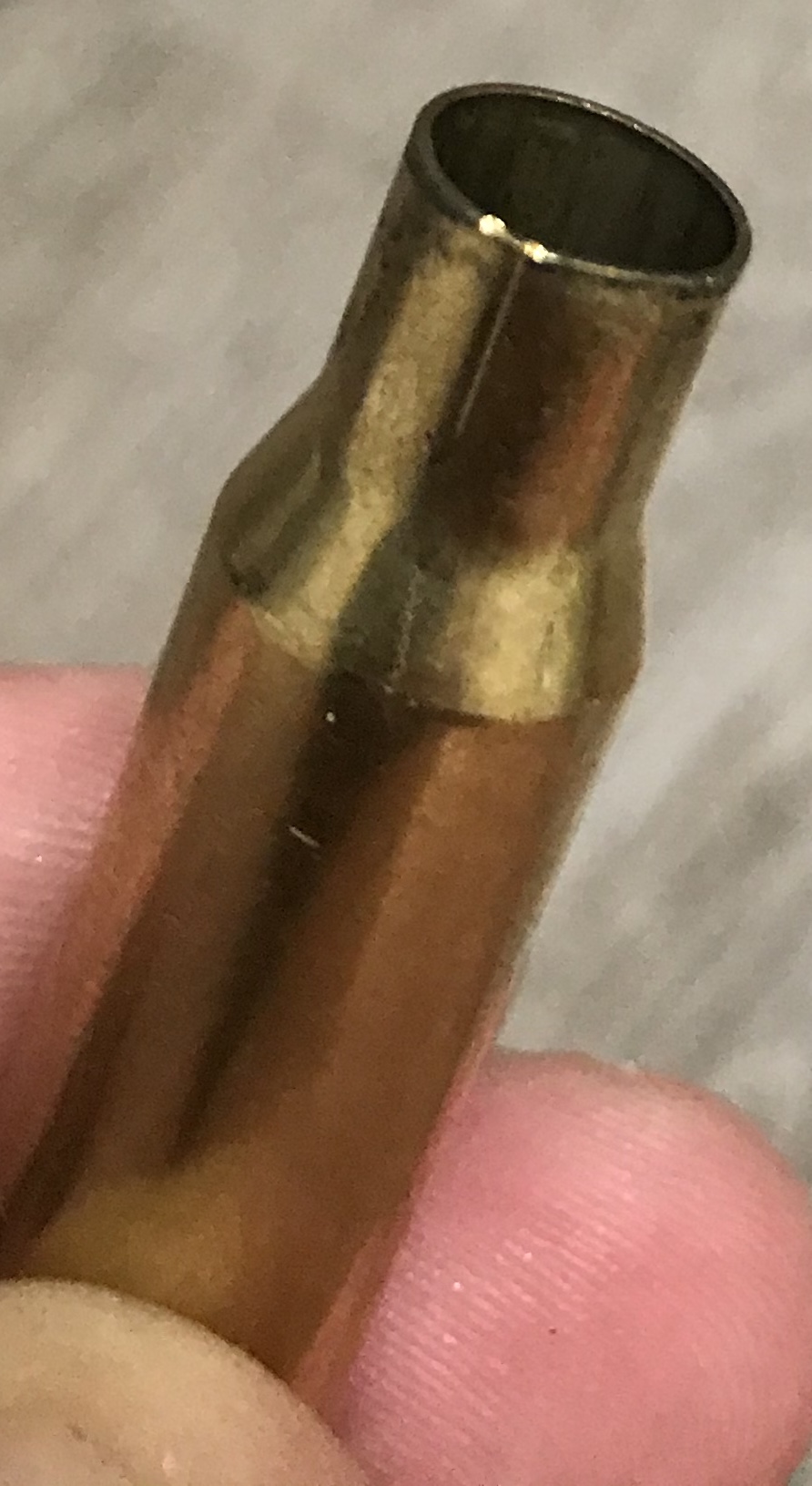

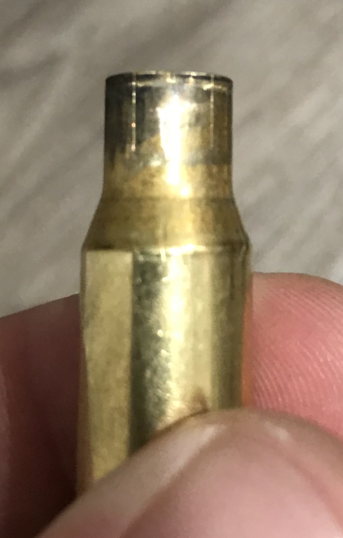

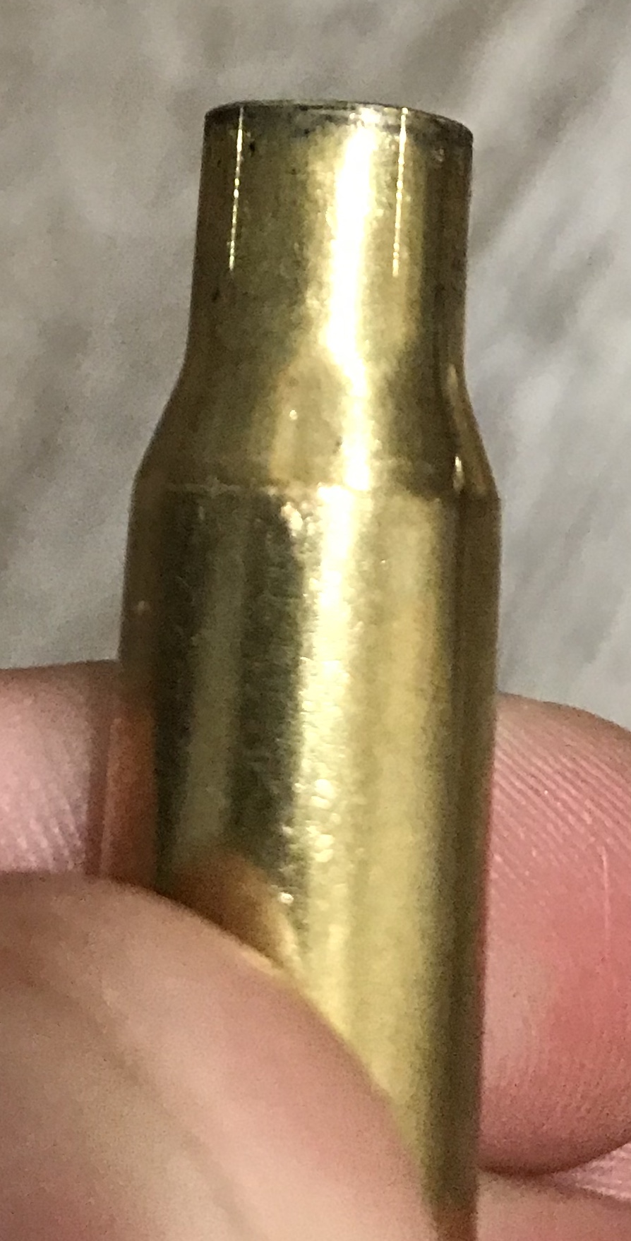

Here’s all the rounds fired so far. Only got two to eject total. Neither time chambered a new round. Both times was gas almost all the way open. The last pic is a fired round easily fitting into an unified round. I’m not sure if that’s common honestly as I’ve never tried to do that.

Curious....did you take any measurements on the fired brass to see if they are close to some fired brass specs? Switch out the gas block to see if it worked?
I don’t have a caliper but I might buy one. The gas block is definitely on perfect though as I bought a bore scope for this. They do seem a little expanded though. That might be why it’s harder to extract them.
-edit- after posting I hopped on amazon and bought a cheap caliper. By the time I get this running I’ll have the ultimate set of tools
Your fired brass looks perfectly normal.... well kind of... ( normal for a bolt gun, Lol ) ... Anyone else notice the complete lack of ejector smear, or typical extractor marks in the photos ?
Those mentioned marks are "the norm" when it comes to even my tweaked Large Frame AR's.
IMHO, that alone implies "no gas, or so danged little that it is meaningless" is making it to the bolt for proper function.
Did you ever check for gas leaks at the gas key ? Or missing gas rings ? .. or a blocked gas tube ?
I am tending to think a blocked gas tube or even the JP gas block ... or something in front of the gas key.
For the OP, and I realize you may not want to hear this.... but I would remove the gas block with the gas tube still installed, look for gas "burn" marks on the barrel, at the gas port ( that will show 100% if the alignment is correct and post PICS ! ;) so we all can see it is properly aligned, and eliminate the slightest doubt. )
Then blow through the shoulder end of the gas tube with the GB, adjusted wide open.
"If" you have another gas tube and GB available compare the 2 against each other.
Using the smooth part of a drill bit , inserted into the gas port.... ( doesn't have to be a perfect fit we are looking for a "this is to big, and that is to small ) let us know what fit and what didn't. That will give us an idea of the gas port size.

Brass wise......No odd scuff marks. So chamber is smooth. Winchester primers look a little flat for my tastes, but ....
The 2 lines on the neck are normal, and will smooth away after enough rounds fired through it.

Still reminds me of my neighbors AR10 with the bad gas tube. When unloaded you could cycle the BCG, but it was stiff. But when fired you had to pile drive it to get the spent shell out. Is it a nickel boron BCG? Could be too much coating in the gas key...

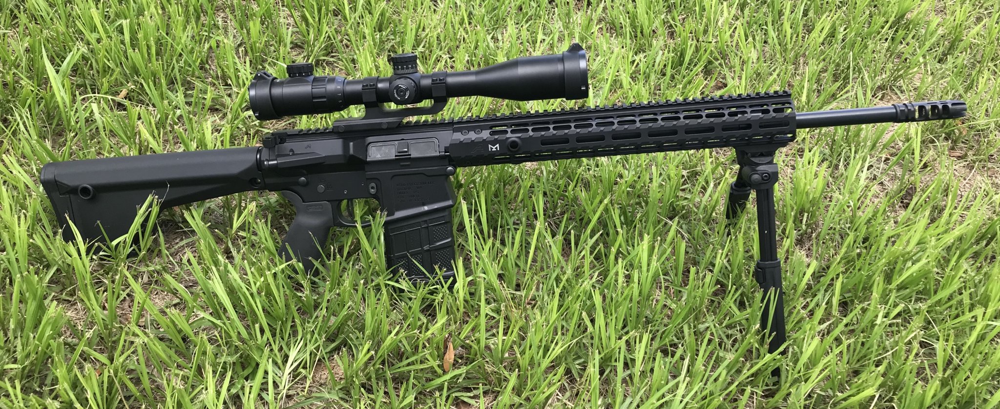

I don't know if this helps, I'm not qualified to know, but that looks like a rifle length buffer tube, spring, and buffer. I just finished a Aero M5 build and I have the carbine length buffer tube , spring, and buffer. It runs fine. I had to open the gas block almost all the way open to get it to eject and pickup the next shell, but the gun it very tight. I suspect as I get some rounds through it, it's going to loosen up a little and I can probably back the gas down a little. Is that the right buffer tube with that stock? Might be, I'm just asking, but I know mine is all carbine length and it runs fine. Maybe it's as simple as that?

Is it me or does it look like the brass is getting shoved into the lands? Maybe the chamber needs to be polished and smoothed out
99% of the time the brass will be scuffed with tell tail visual signs of a rough chamber imprinted on the fired case , and even then, the extractor smear I mentioned would more pronounced... since the case is not freely releasing from the chamber.
Example pic... from the internet
As for the brass being shoved into the chamber.... I would suspect the same mentioned "lack of marks" would be clearly visible because of a boast in chamber pressure.
Your tuning is spot on... but the OP's setup isn't getting enough gas and or certainly not consistently ( he did say he had a few eject. ). Check some of your fired cases, compare them to the pictured ones...I'll bet they are slightly more "abused " ......Lol, If my brass came out of all my Large Frame AR's that pristine , I would be ecstatic.

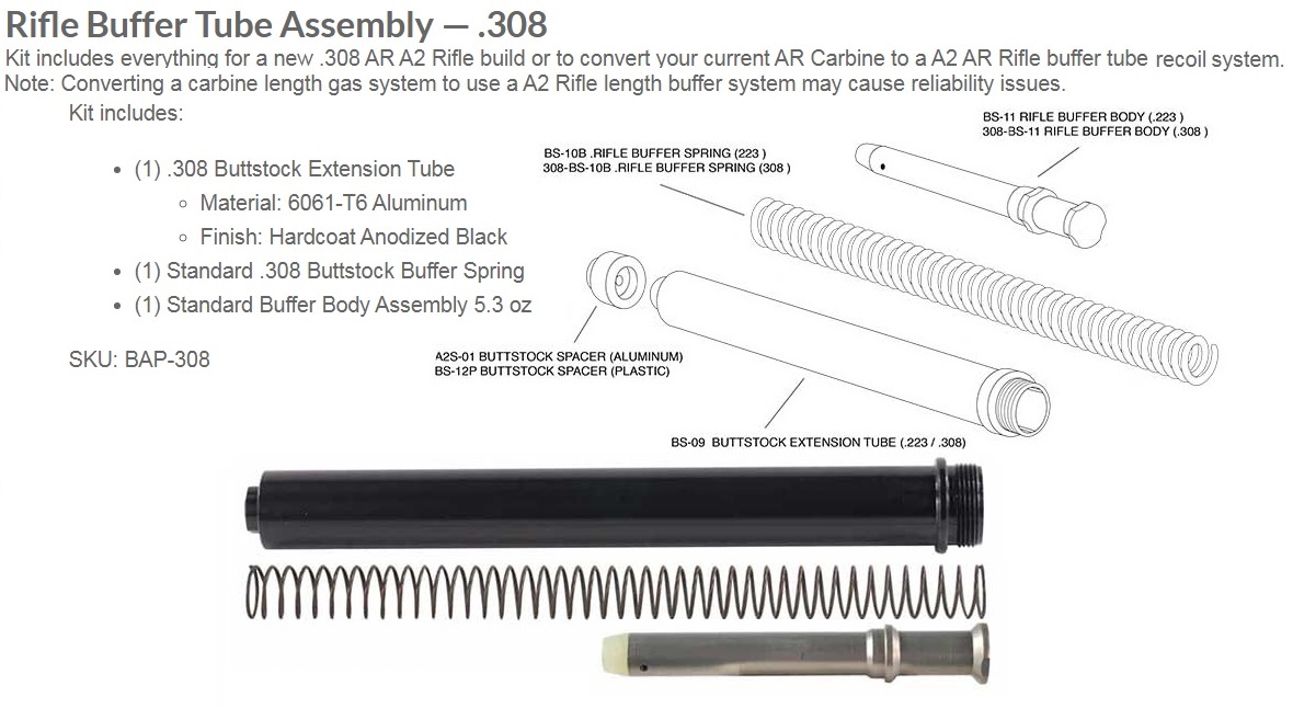

The gas tube is a stainless Aero rifle length

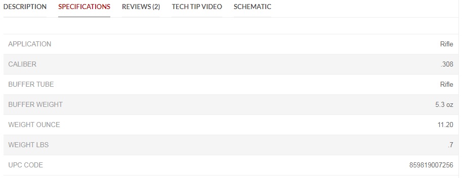

The buffer, spring and tube are all Luth AR rifle length and supposedly the 308 version. The bolt does lock back on the bolt catch quite easily.
Its you, those are not land mark, those are the distinct lines of the barrel extension scraping the necks on extraction right before it ejects

  • Per your picture the gas tube appears to be the correct length & set to the correct depth.
