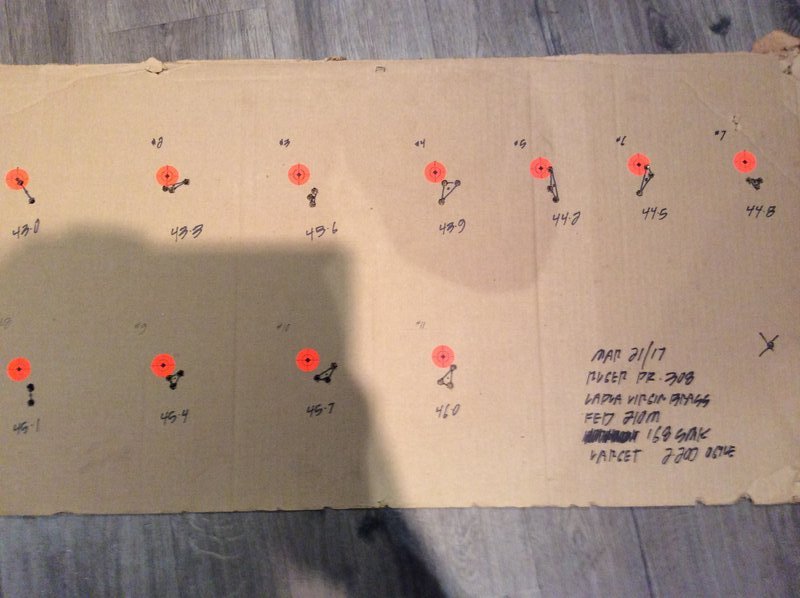

normally these are really easy for me to read.
target was levelled with a total of 33 + 1 shots.
i noticed a little swipe on the second round at 45.4 grains. Temps are right at freezing here so I thought I'd shoot this faster.
Anyhow , please advise how you would proceed.
specs
Ruger PR .308
Varget , SMK 168
lapua virgin brass
Your target shows that 43.0, 44.2, and 45.5 are your scatter nodes, which would make 43.6, 44.8, and 46.2 your accuracy nodes according to your verified results and theoretical results based on calculation. Since your seeing ejector swipe at 45.4, I'd verify a high node at 44.8 and roll.
