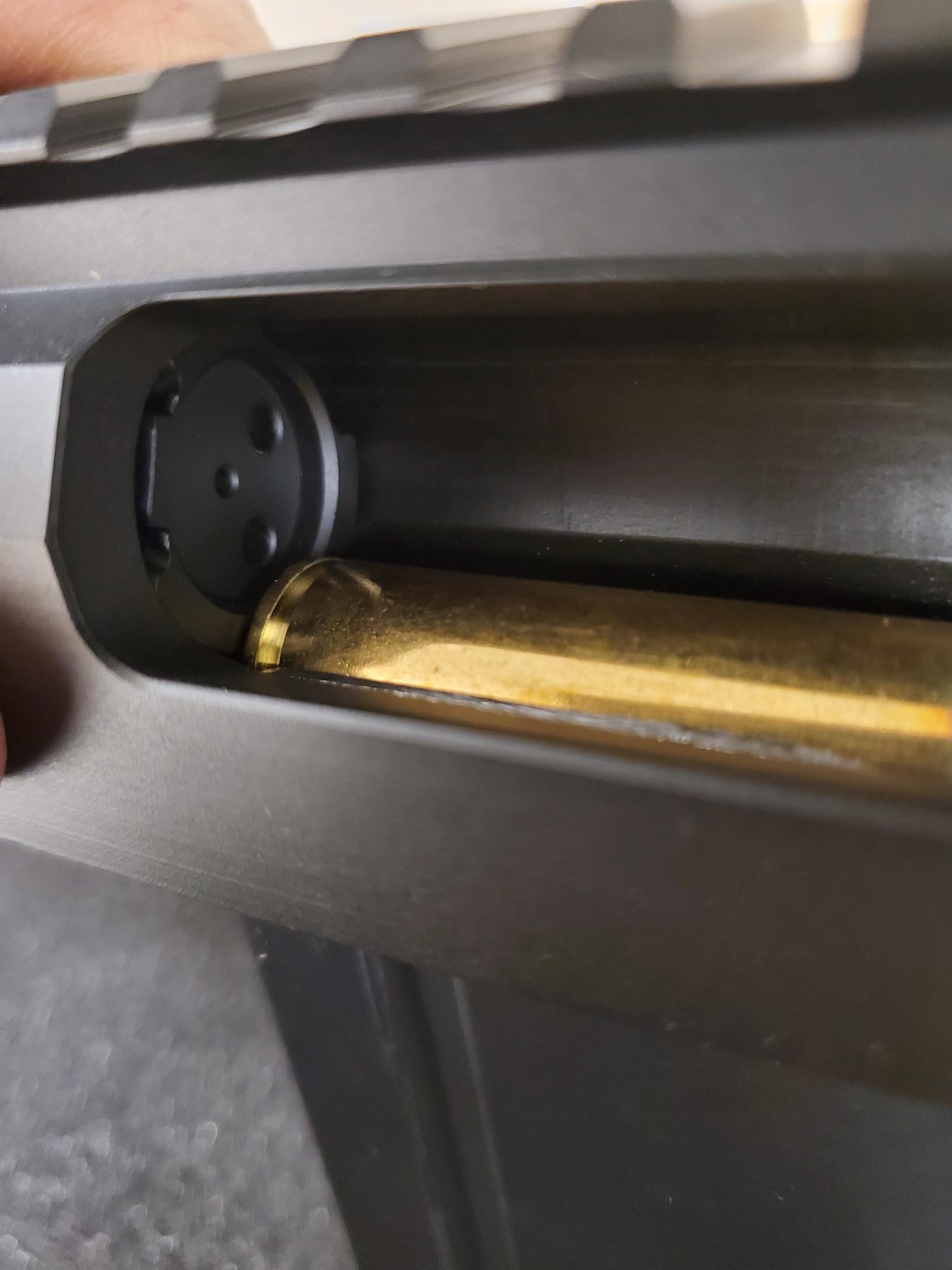

Hi,
Mainly just because I like the color contrast I will post this picture, lol...
But past that it was a functional test of magazine feed lips in relation to boltface in relation to smaller cartridges for the upcoming conversion kits.

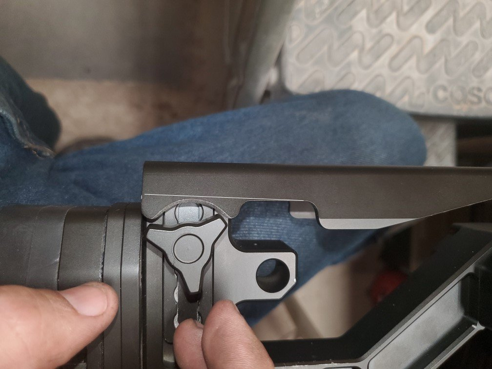

Here is just 1 super small change (The others being done right now to the first batch of actions and chassis will definitely be worth it) that nobody noticed for an entire year until the real pickiness began.
At its' lowest cheek height position the adjustment know could make contact with the actual cheek piece.
So we had to make cutout as pleasing to the eye as possible yet remove the contact completely.

Is milling the back of the knob to gain clearance an option? I think it might make manufacturing easier.
i was thinking the same, but not seeing other angles i wouldnt sacrifice any strength
i think the extra "cut"
flows with the industrial look of the chassis which is what i like to begin with
but my wife tells me im wrong all the time so id prob listen to you guys too lol
Reactions: THEIS
A perfectly done radius is a lot harder to do than a simple flat cut and stands out.
I think a radius would be perfect as it would look rather unique. Especially if you can then put a perfect bevel on it to match the other part of the cheek rest.
However if it winds up being too expensive for the machine time, I'd be fine with a straight line.
Reactions: gnochi and THEIS

I like the radius... and it is a really nice touch. But the flat is easier and cheaper. So put the radius on the first 20 rifles... and if you want one, you better be in the first group of 20 to order. Because after that... the cool radius goes away!
I vote Radius.

That is an interesting point.
I guess it would depend on how close the actual cheek guard is to the adjustment knob.
