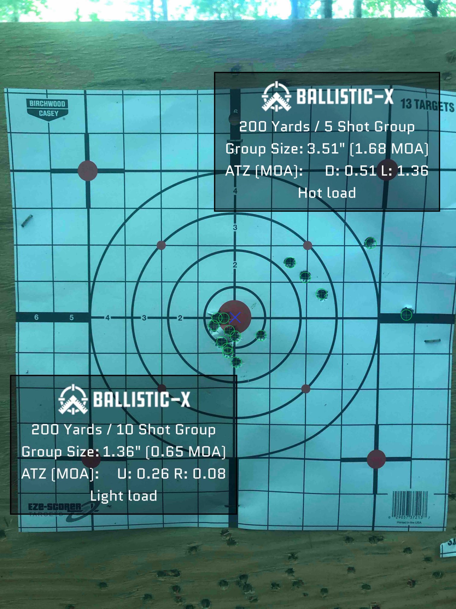

Okay - It was hot and windy, had a guy with us in another lane shoot my target.
Otherwise, good day. These were 208 Amax at 200yds in +/- 5mph of wind.
7102015
20 rounds - 4 groups of 5 shots each, included fliers.
The 2 flyers are from walking off for @20mins in between. Far right is the guy that shot my target from the other lane. :oops:
The 220s did well, but not at the powder drop I was expecting. So I did two variations.
7101920
5 top right was where it got windy and the hot load. 5rds.
Middle group is the light load. 10rds.
Going to tweak these a bit more and 300BLK will be good to go.

I can tell you that my SPS 16” 300blk tactical rifle prefers the lighter charge. Look at the spread 1gr more of powder produced. Same bullets.
Every rifle is unique, I want to help you get the best performance, every single shot downrange.

Look at my 300BLK SPS Tactical. I would've told you, the hotter load would do better BEFORE I shot it, I would've bet you on it. Turns out that cutting my barrel shorter, changed the harmonics. So, now it prefers lighter loads.
Losing 1gr of powder, tightened that group from 1.68 MOA to 0.68 MOA and I guarantee you, once I drop it another 0.5gr, that group will be under 0.25moa.
That's an adjustment I can make in under 5 minutes with a couple runs of metering the powder down. I'm cool with that.
