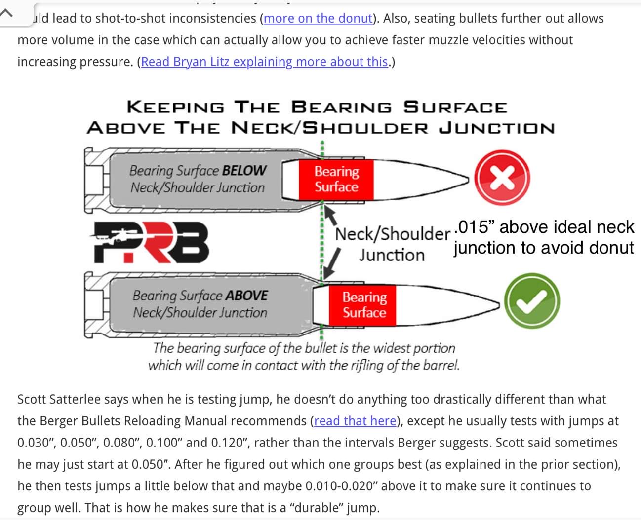

Question is genuine, ex SARS Vet and sniping not what I after perfect Terminology perhaps it differs here no Apologies. From Massachusetts - this is genuine question.. I would like to use a throat reamer to extend out my current OGIVE from 3.705” to 3.780” so I then could easily seat new longer VLD projectiles. Hope that explains it better…. Do you see problems with doing that as my gunsmith here does and refuses to explain why… and I thought I would put it out there for insight and your help. Exactly right b6graham , thanks for the clarity. I did provide the gunsmith a dummy round to the preferred new OGIVE 3.780” and just flat refused and would only support going out to 3.766”. And reuses or unable to explain why….do you see any problems with that. My bullet OGIVE to my barrel OGIVE too short. If I seat out to .010” below my projectile bearing surface below the junction.

Wanting to seat out to 3.760 with .020” left in barrel throat. An bearing surface then just above junction with a little more to be past dreaded donut if necessary. Using N570, Peterson brass, and Quickload (GRT too)

Sorry for the mass confusion my error for not explaining it well enough. The measured OGIVE using Hornady tool with cleaning rod to toggle back and forth out of Jam was a COL of 3.707” with 245 EH from the builder. This was bearing surface below neck to shoulder junction with bearing surface by approx .020 or ideally 3.727 COL. Then add .015” to avoid seating on potential donut puts you to around 3.742 COL. Which means ( or my flawed thinking) that the max jump then would limited by max useable magazine of 3.760” if my barrel throated out to 3.780” COL (dummy provided) then I could provide the end client to use max mag load development or grater if hand loaded. That was my goal. The rifle producer gunsmith would only go out to max COL 3.766” or .014” lower than requested. And would not provide any explanation to my client or to me. And was hoping if you guys could perhaps help explain what I’m missing. Apparently the N570 with the 245 Berger likes a jump of .045 to .070. I’m nowhere near that unless I go well below the junction with the bearing surface. Whew I wrongly tried to abbreviate that ….no other way I suppose. Sorry for all the confusion - I hope this now clearer as my situation with a Smith who built the rifle refuses to go out further than 3.766”
