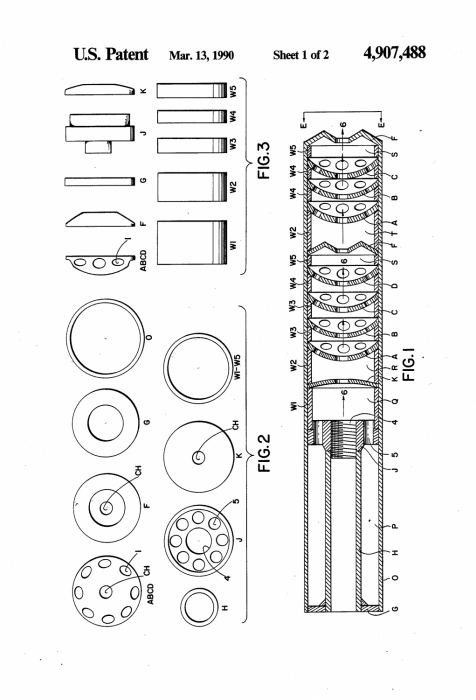

Here is a pretty good explanation of what you're talking about.
