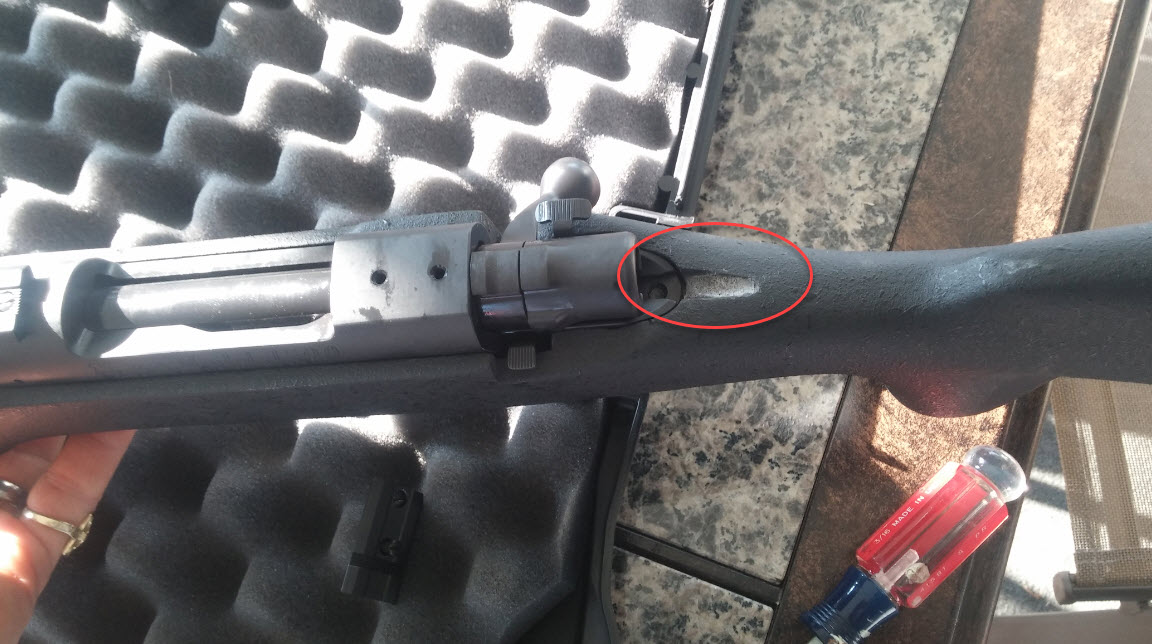

I had some time off this morning so I started building.
I think things went well, HOWEVER once everything was cleaned, assembled, and oiled, the action was VERY stiff. Stiff as in it reminded me of my Mosin.
Is this normal for a new gun and I just have to cycle the action a million times, or should I look closer before taking it to the range this weekend.
I initially had some trouble lining up the magazine so I took everything apart and put it back together, but it's still really stiff.
I'd start by removing the action form the stock and seeing if that allows the action to move freely.
Next would be to make sure the bolts that hold the scope base down are not too long, or that some loctite didn't get down into the action.
If you took the bolt apart, do it again and make sure all is correct.
Basically, start with the easiest to check - and go from there.
Good luck,
Bob S.

Thanks Bob.
Yes, I'll be taking it down a few more times to see if there's anything in the way.
To be clear, the stiffness happens when I'm moving the bolt all the way forward (beginning the loading cycle) or all the way back when ejecting an empty case.
From all the way open position it's a smooth push for an inch or so and then it gets stiff (and would actually stop if you're just using fingertips only). You then apply force and it gets by the snug part and goes smoothly into battery.
Same in the other direction.
From all the way closed you can move the bolt lever up, and the first inch or so is smooth until the bolt travels to the same snug spot and you have to use more force to get it fully to the rear to eject the empty.
I haven't pulled out the micrometer yet, but it seems as if there's a bulge of sorts in the bolt stem that drags in the same place when traveling forward and back.
Other than my Mosin this is my first bolt rifle, so I don't know if this is normal out of the box (being brand new with tight tolerances) and it will smooth out over time or if it's a flaw of some kind in the bolt.

I'll bet a shiny new nickel it's the scope base/bolts. Remove the scope & the base and see if it still hangs. (also look for Loctite or a burr at the mount holes)
Bob S.

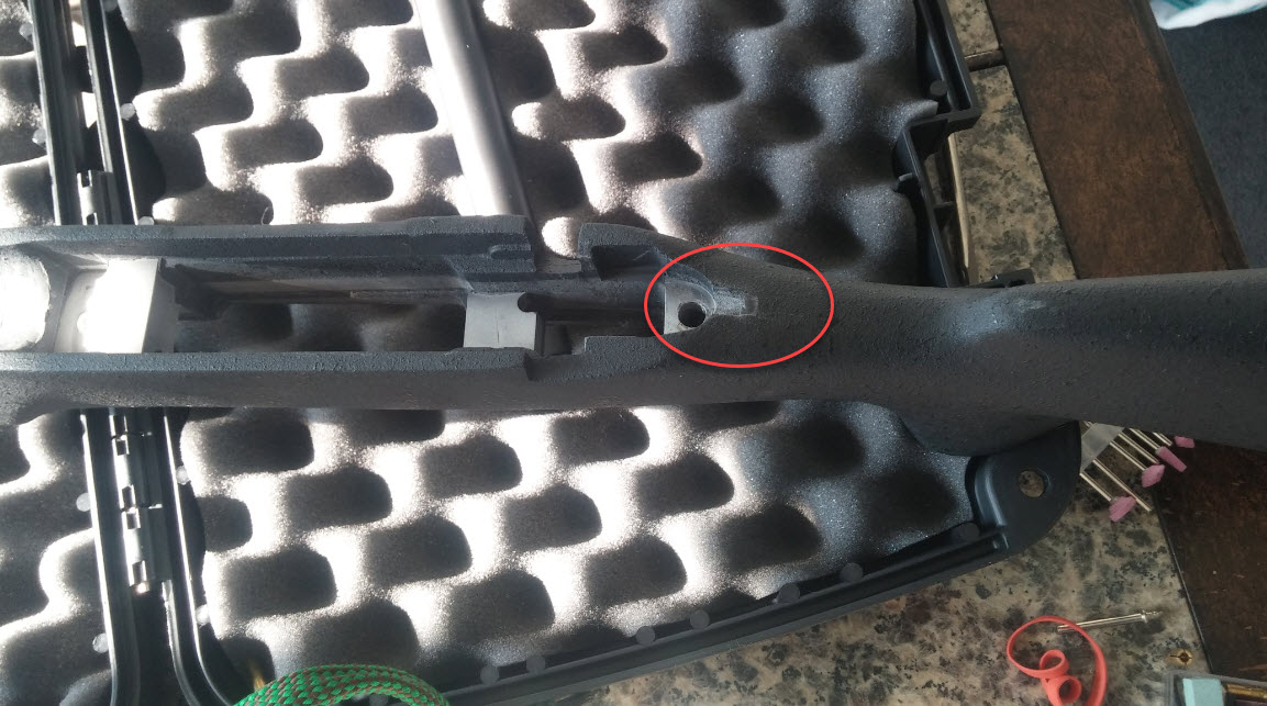

Figured it out.
After taking everything apart...again...it turns out that the problem was with the stock. There's a little channel behind the bolt that's supposed to allow it to travel freely back and forth, but the channel wasn't deep enough so the bolt was rubbing against it. So each time the guide part on the bolt passed it, it made a bit of a ramp, so the line of travel wasn't straight and there was friction against the metal frame.
I used a light tough with my dremmel tool to make the channel big enough for the bolt, and now the action is smooth as silk.
Before:
After:
Thanks again Bob.

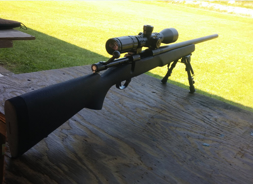

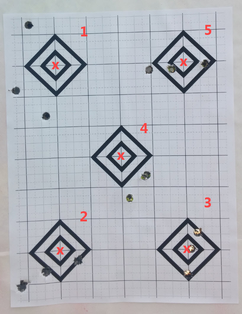

Just got back from the range.
I had a great time and the gun functioned with zero issues.
I know that many people think barrel break-in is a waste of time, but I figured that it couldn't hurt at all, so I cleaned the barrel between the first 10 shots and allowed the barrel to cool before each shot. That's just one more factor I can remove from the equation when I get frustrated about my crappy shooting!
After the 10 break-in shots I tried some 3 shot groups at 100 yards. I was using Federal Lake City 149 grain 7.62 NATO ammo and there were no issues at all feeding or ejecting. This was the only ammo i could grab. I have some 168 grain .308 ammo on order that MAY be here today, so I'll try to get to the range tomrrow to see if that makes a difference.
This is my first precision gun, and my first time trying for groups, so I considered just hitting the paper as a success. I labeled the order of the groups as well as my point of aim.
I was hoping that the gun would magically make me a 1 MOA shooter, but honestly I built it this way so I could do a lot of practice and learn how to shoot, so I think it will work well.
Thanks.
It's not a bad start with a new barrel - it will get better as the gun shoots in.
I'd go over all the scope mount & rings screws just to be sure they didn't shoot loose. Action bolts too.
Clean the barrel, and get a few different types of ammo to figure out what it likes.
Now the fun starts - enjoy it.

Great shooting! Don't be discouraged! You were shooting the equivalent of M80 ball ammo, that is pretty good for that ammo.

Well a sub-moa gun won’t make you a sub-moa shooter, but it does let you know that what needs work is you.
First, pop that bipod out to the first notch. Those feet are sprung and that’s not helping you. I bet you see an immediate improvement from that.
Good luck!

That's about as good as you can expect from the ammo you're using. Match ammo that the rifle likes (it won't like all of them so be patient) will show you something else.

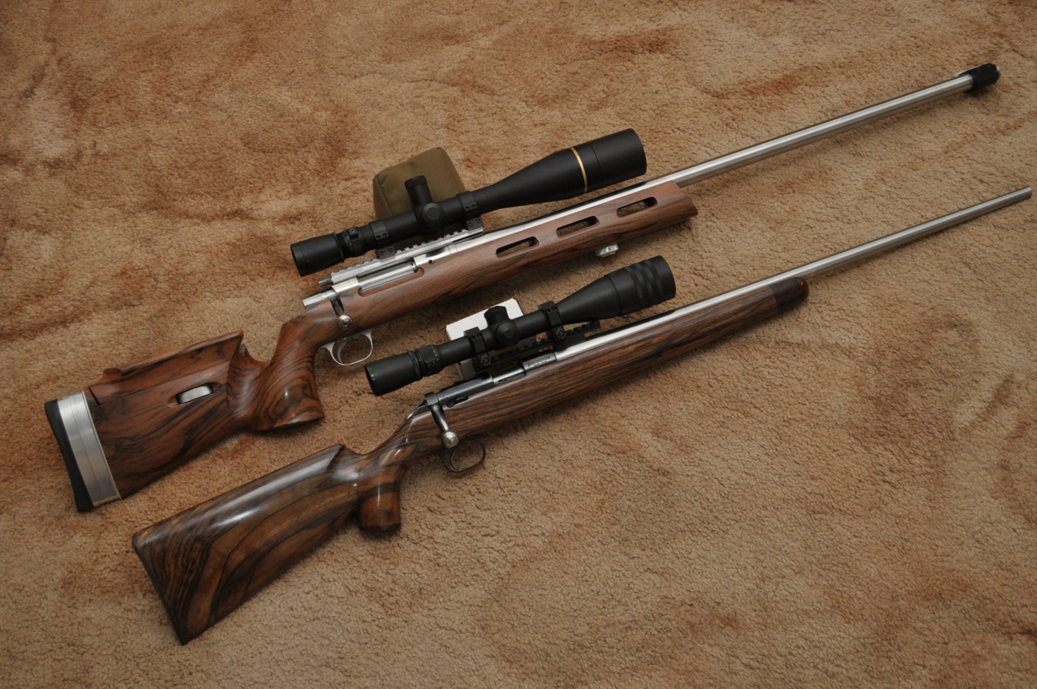

All but one of my prone stocks are from Robertson Composites, in their H&H pattern, which fits me pretty well. Have shot a lot of NRA bullseye prone Hi Power mid- & long-range matches with them, and never had much of a problem getting comfortable behind the H&H for the duration of a 22rd match, or more rounds if it was a 1000yd prone match with unlimited sighters. The one stock I own that's not from Canada is a McGee prone in their Trudy pattern, named after Trudy Fay. They're among the first people I met when I started shooting XC HP matches, and became good friends & prone shooting mentors. They'd bought some really nice English walnut blanks, and wanted me to pick one out for a BAT 3L rifle in 6.5x47. The blank I chose looked good on the outside, but turned out to be really exceptional once they'd run it through their duplicator, and is even more beautiful since Doan Trevor finished it for me. As I get older, some of my rifles are probably going to be sold, but this one won't be leaving my safe until I'm gone.
Individual tastes really do matter when it comes to rifle stocks... The M52 Sporter below the BAT is the 2nd stock that Doan did for me...it's another keeper.

I finally got some time after work today break-in the Howa. I followed the Howa directions - cleaning after every shot for the first 10 rounds, with 5 minutes between shots. Then cleaning between every 2 shots for the next 10 shots (I kept the 5 minute between shots).
Here are the first 20 shots - you can see the first 6 are low right, then I started to adjust the scope. Somewhere in this, I noticed the scope was moving with recoil, so I had to adjust a little - but the gun did better than I expected.
After each shot, it took about 5 patches to get it clean - used Shooters Choice...
I then put 5 rounds into a new target right before sunset - too bad I pulled one low.
Shots were from a bench at 100 yards - sandbag under the forearm, just me behind it. ;)
This is with Sellier & Bellot 140 Gr. - cheapest ammo I could find. I think it shows promise

Dittos on nice shooting. I'd say you have reason to expect good results at longer range, especially with some better quality ammo, and you stand to benefit from the experience gained in the process of breaking in your new bbl.
