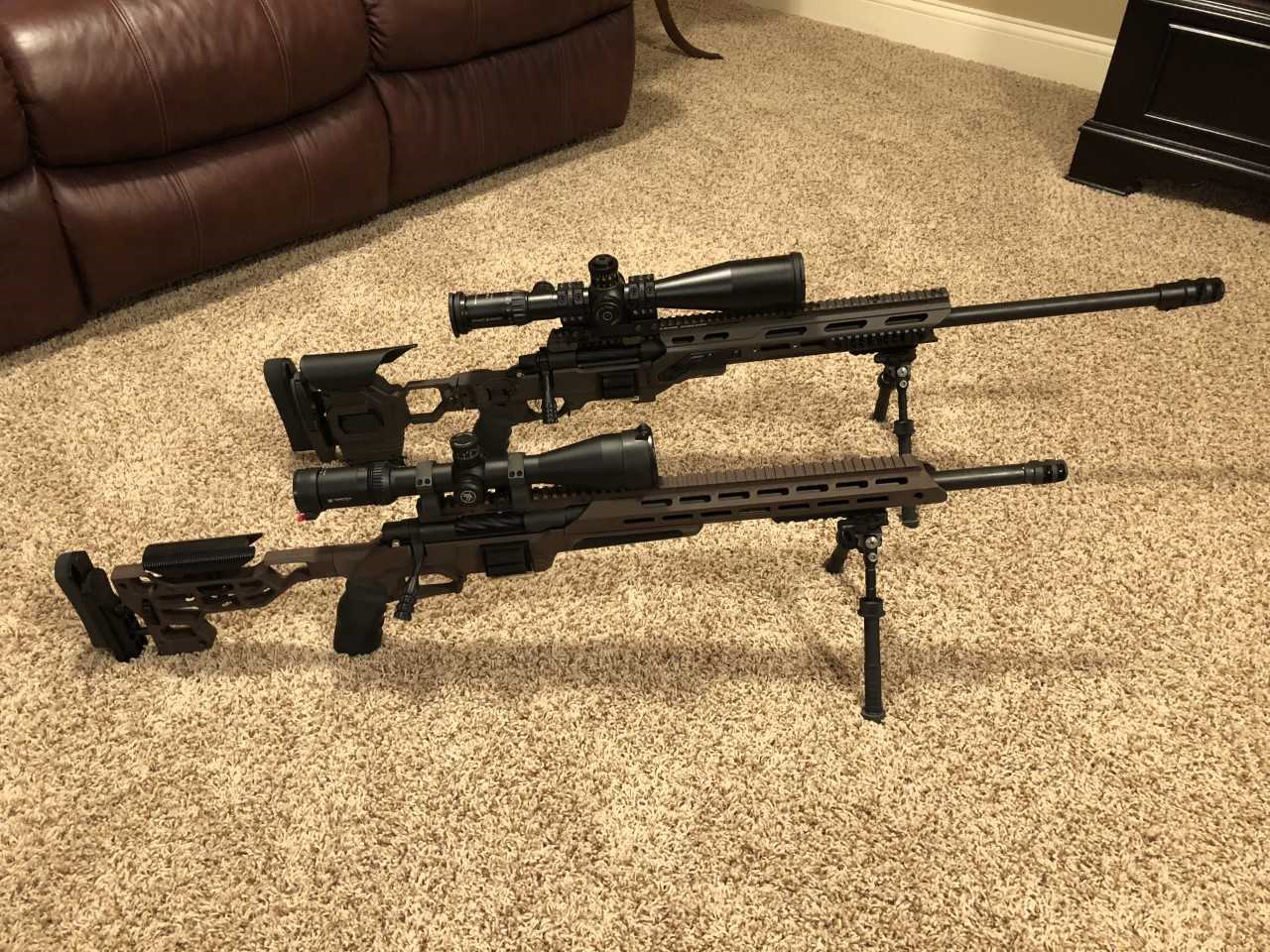

Josh, I'm here to tell you that I bought two KRG 180-Xrays for my Howa rifles instead of MDT products precisely because of the above.
The 308 has worked from day 1 with Magpul, MDT (steel), and Alpha Industries AICS magazines without modifications, adjustments, or issues. Shove the magazine in and start slaying targets. The 223 works perfectly with MDT plastic magazines (haven't tried any other) same as the 308.
So add me to the list of people who are asking for this issue to be fixed.

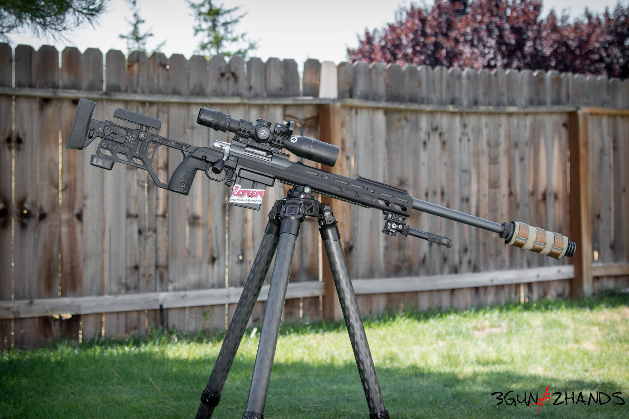

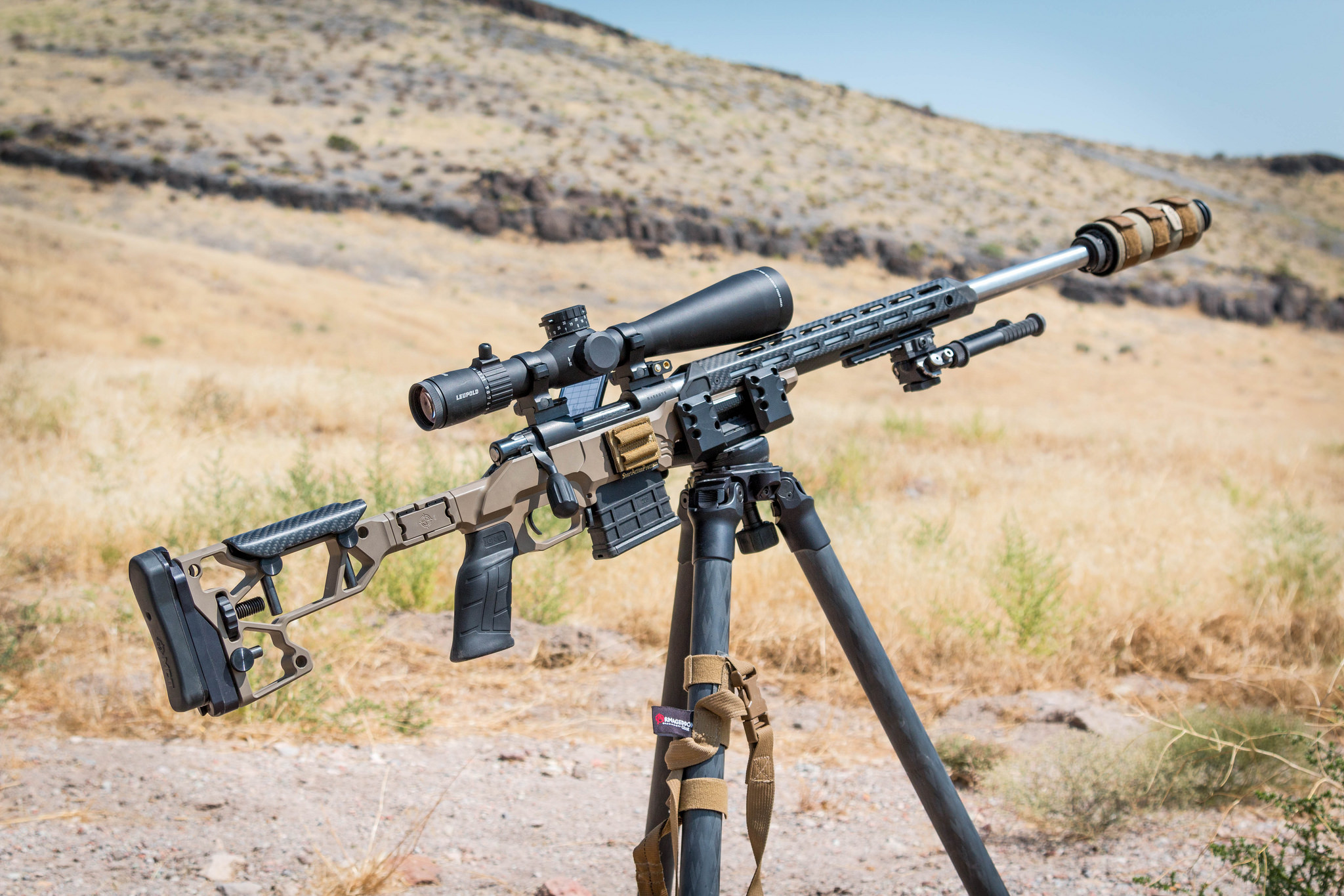

I'm still wanting to know where they offer that chassis system that Matt@LSI posted! It looks sick. And it does look like a W3 with some different forend attached to it!
Which of the two guns pictured are you asking about? The carbon fiber handguard chassis is a MDT I believe, and I think I did see Matt interviewed at a match once with the other one and he said it was a KRG.
Where did you zoom to identify the action?
I zoomed up the lower photo in Matt’s post—the one with the Spuhr scope mount. The bolt looks like a Howa and the serial number is right where Howa puts them. Also, not that by brain is fully engaged, I realize that @Matt @ LSI woks for Legacy Sports, Inc, so a.) he’s unlikely to post anything that’s not a Howa, and b.) he probably has access to some goodies that you can’t get by simply clicking on a web page. ?
BTW, the interview with Matt on the Precision Rifle Podcast is well worth a listen.
It's a Howa 1500 in Bravo chassis with a Whiskey 3 back end and the optional enclosed forend
Oh!!! Yeah that I was sure of. Matt wouldn't post anything other than a Howa lol!
