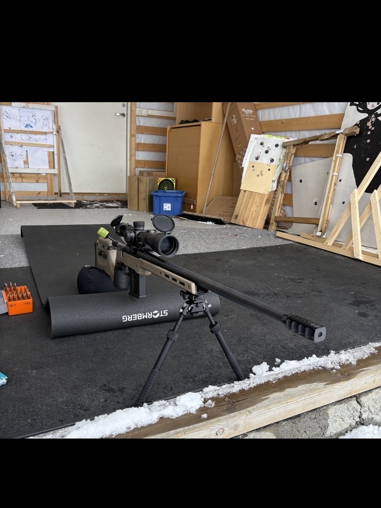

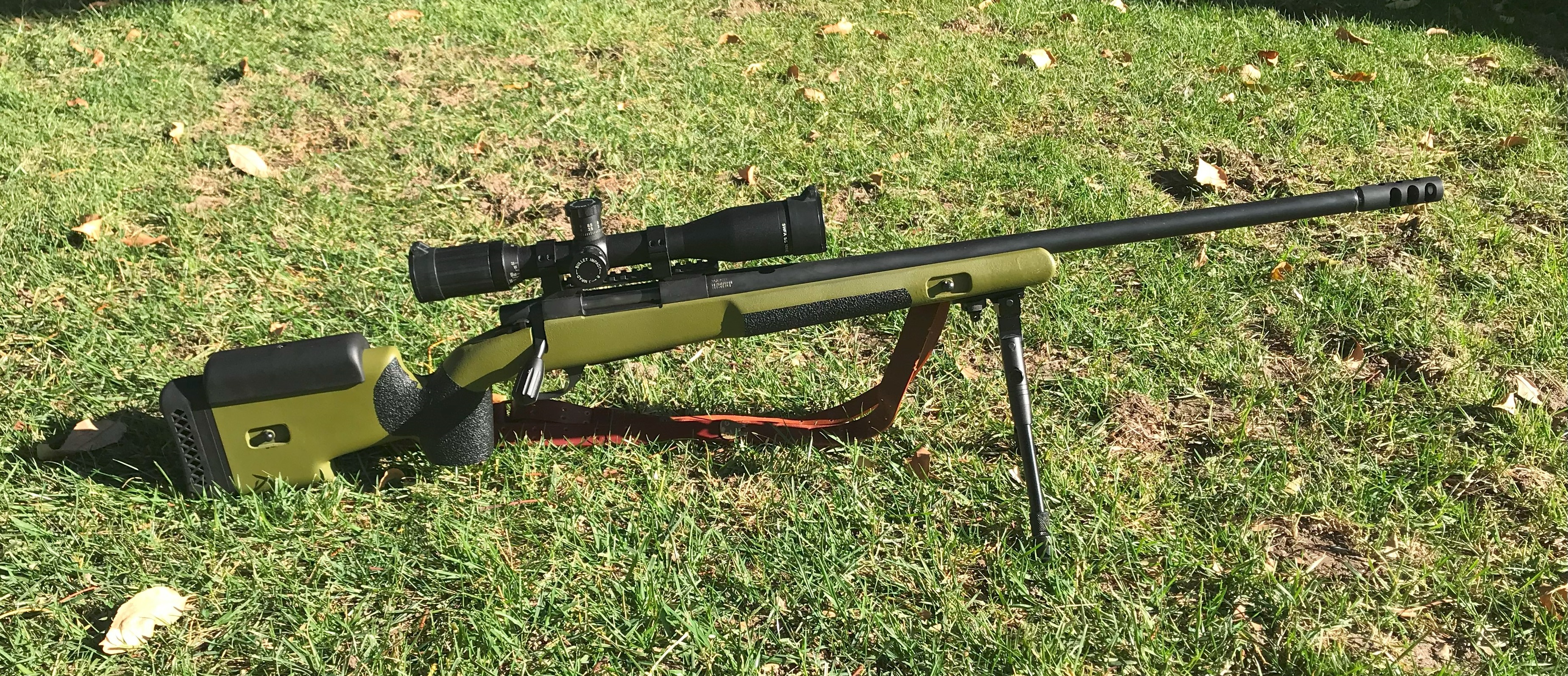

My Howa in .243, just got my first hits at 1 km+ last weekend, which was probably the last shots through this barrel.
2 hits in a row on a <1 MOA rock at 1260 meters (1377 yards), which I'm very happy with, especially considering the limitations of a 10" twist .243 barrel and the bullets I can stabilize.
Used 95 grain Berger Classic Hunters, as they are the highest BC bullets that I can stabilize, and my barrel really liked them.
Will get it rebarreled sometime before fall, probably in 6.5x47 or maybe Creedmoor, ammo cost is about the same here in Norway, so I'm leaning towards the 47.

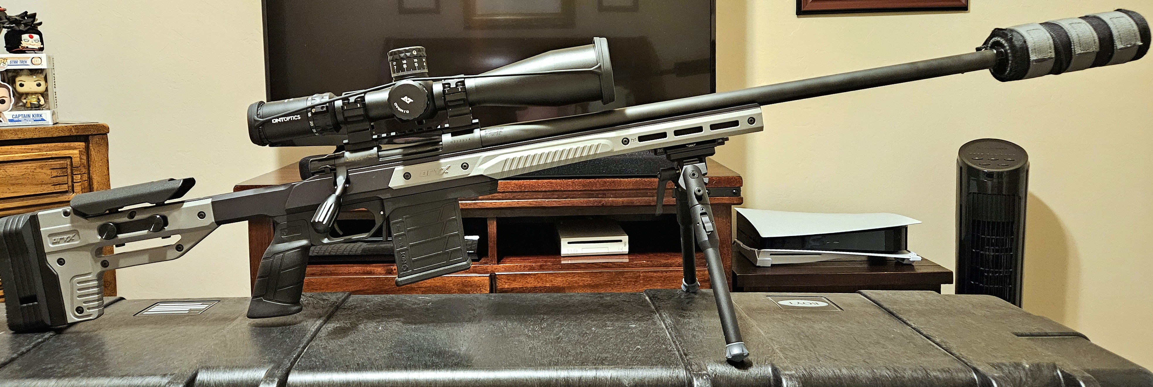

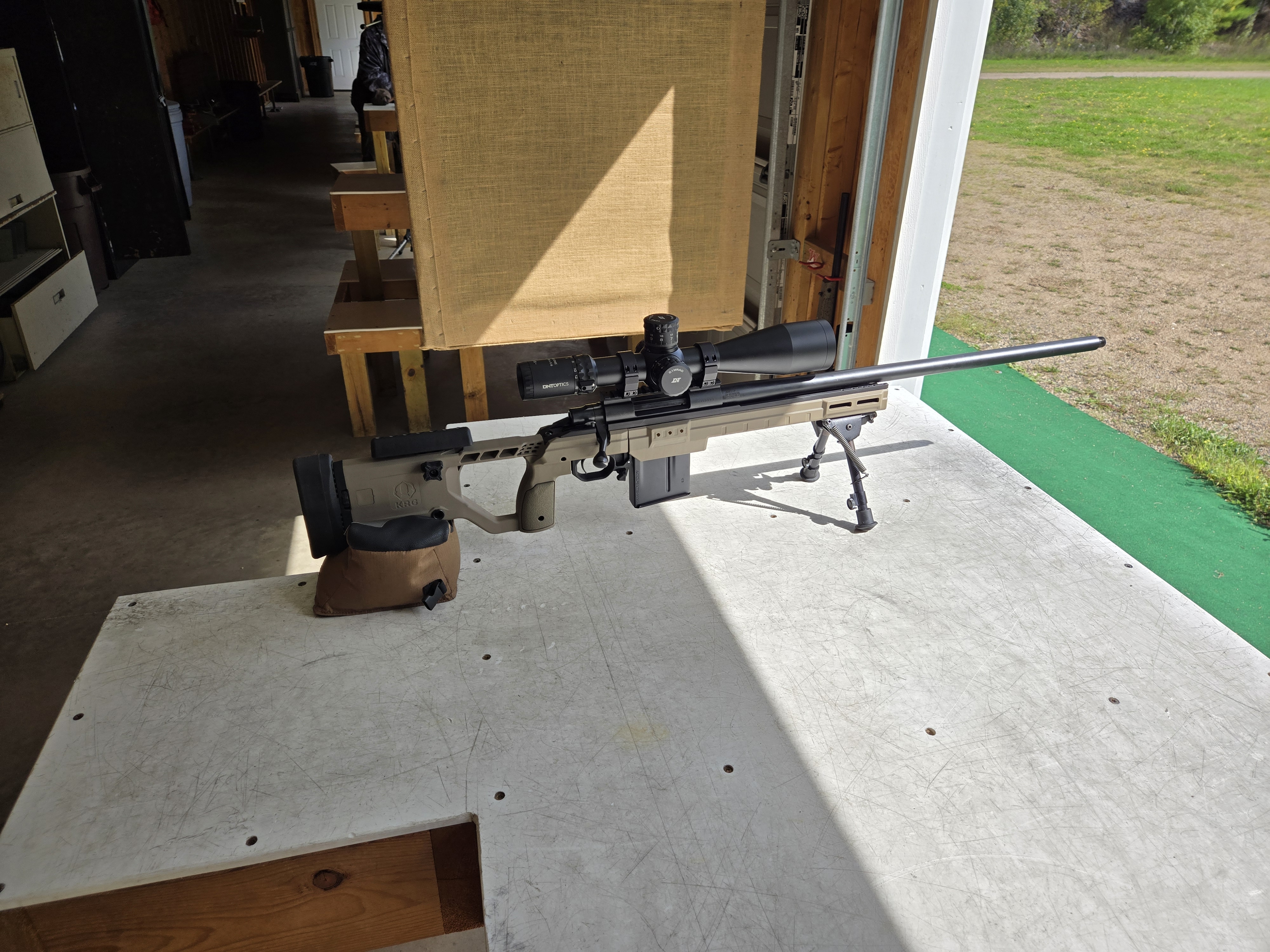

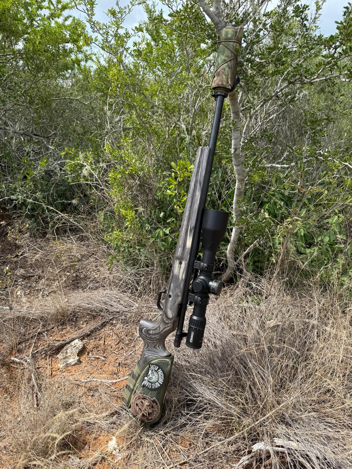

Its final form: 6.5 CM, 24" heavy #6, Oryx chassis, DNT TheOne, Warne 7914M Lite Bipod, OCL Polonium 30/7.62. Fairly budget, fairly precise. Can't complain. Except for the fire restrictions which kept me from finally stretching it out this weekend.
Reactions: stello1001
It looks sick but is it me or does that scope look just like an arken lol?

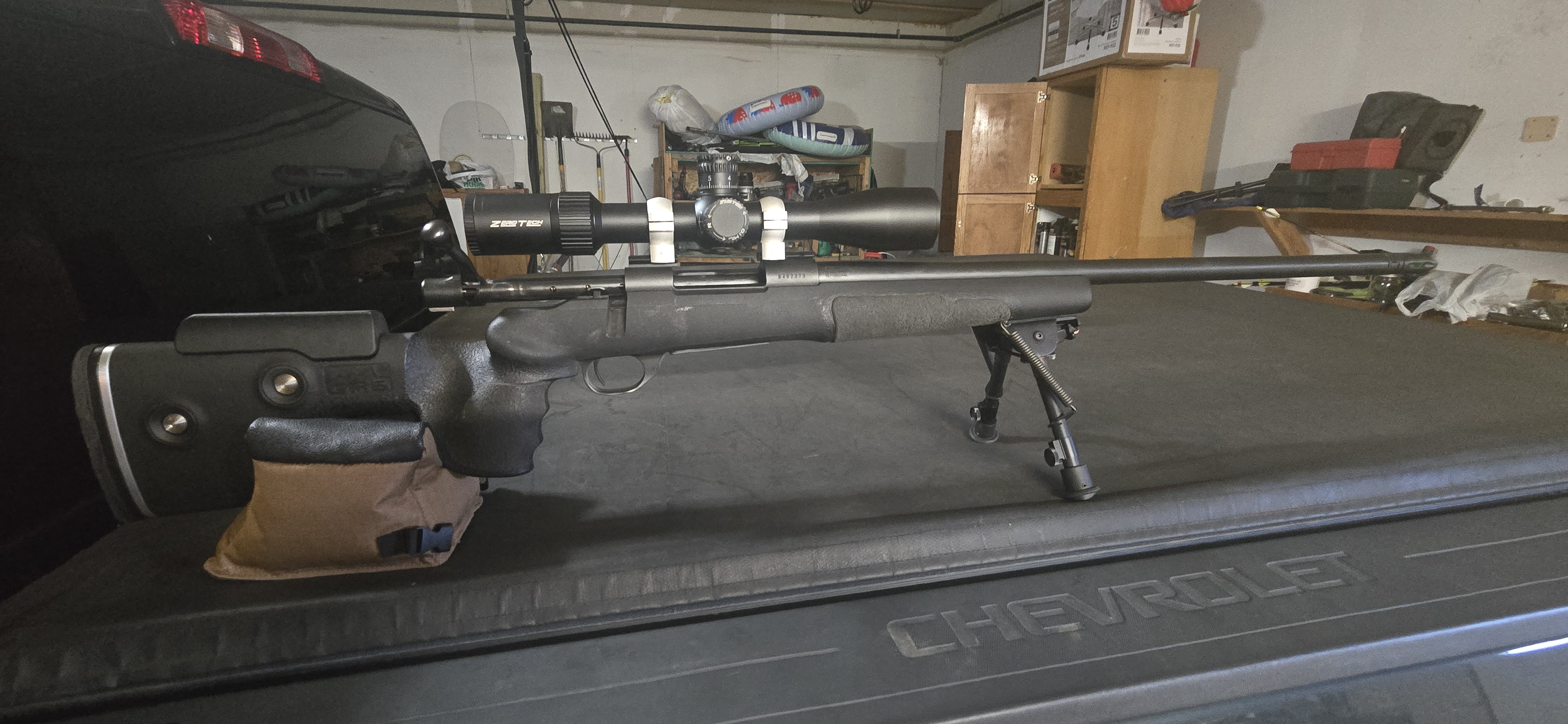

I may have just posted my Howa 1500 6.5 CM but my girlfriend had gotten me a Swarovski Z3 4-12x50 BT for Valentine's Day and I had a spare barreled action that I was keeping for when my other barrel got shot out and there were some spare parts lying about and...
Anyway, you see were this is going. I had a moral imperative and whatnot to build the hunting rifle that I will probably never use but could now if I wanted to.

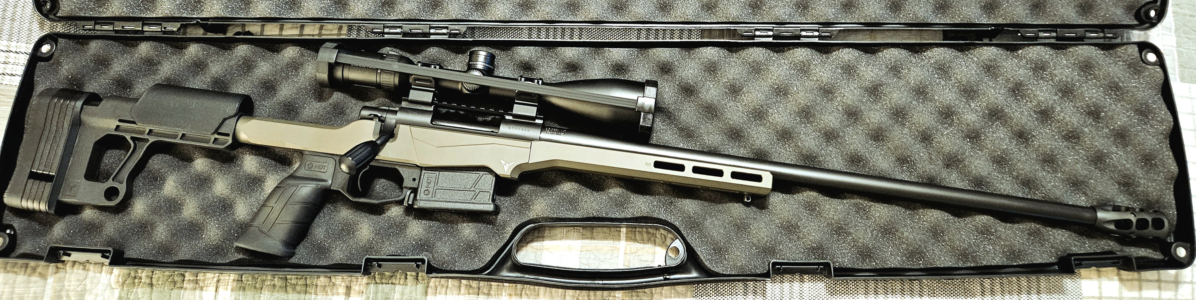

I have a 28” 6.5cm howa 1500 in a krg bravo chassis. Only mods ive actually dont to it is the 1.5lb trigger springs.
Thinking about doing a bartlien barrel in like an m24 contour. Anything thing else worth doing? Seems like a pretty decent out of the box action.

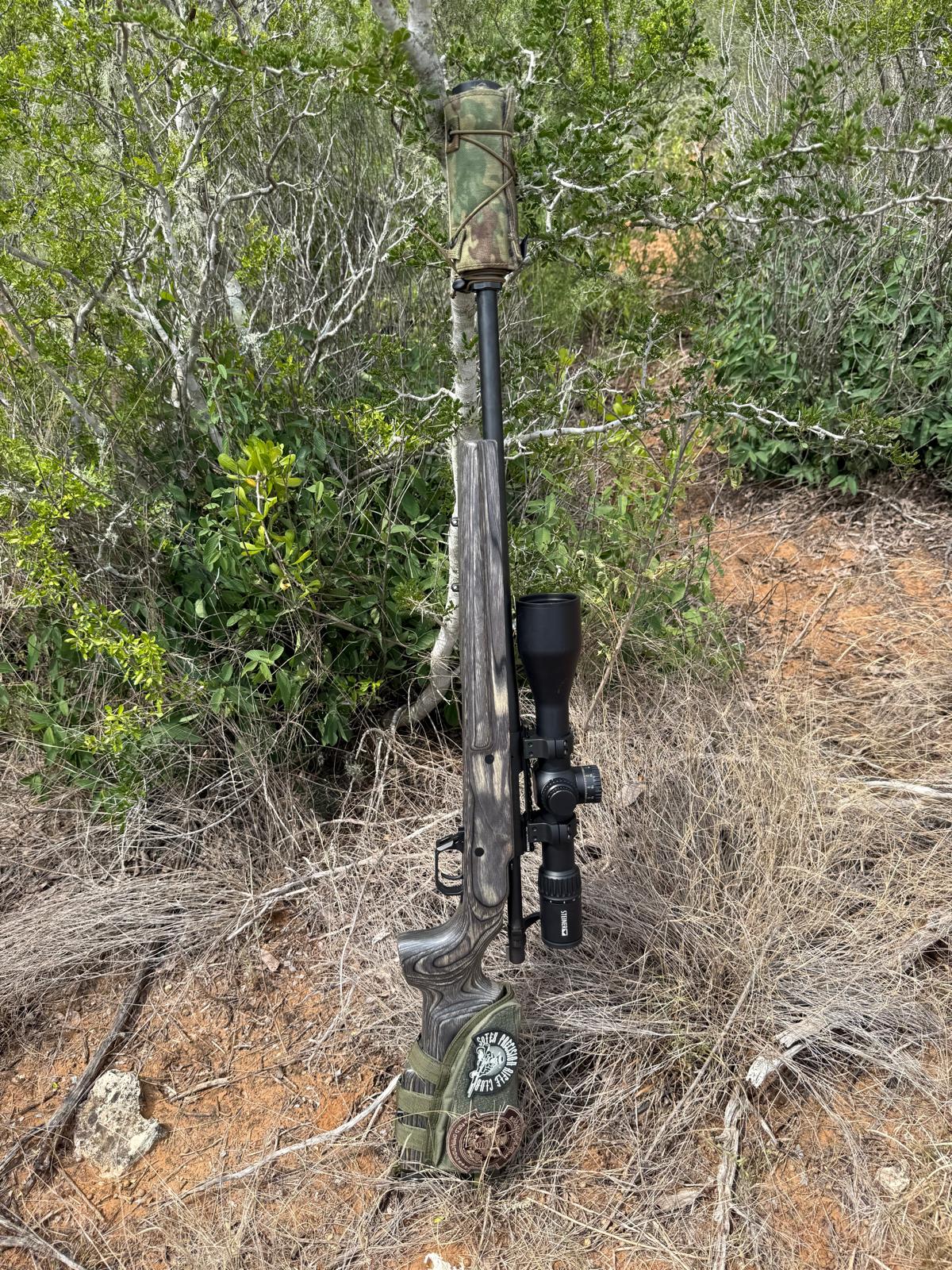

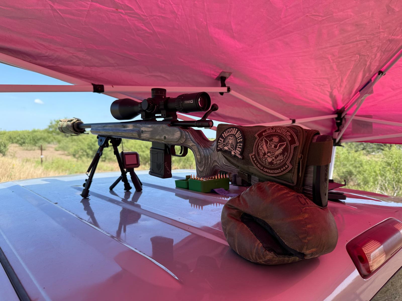

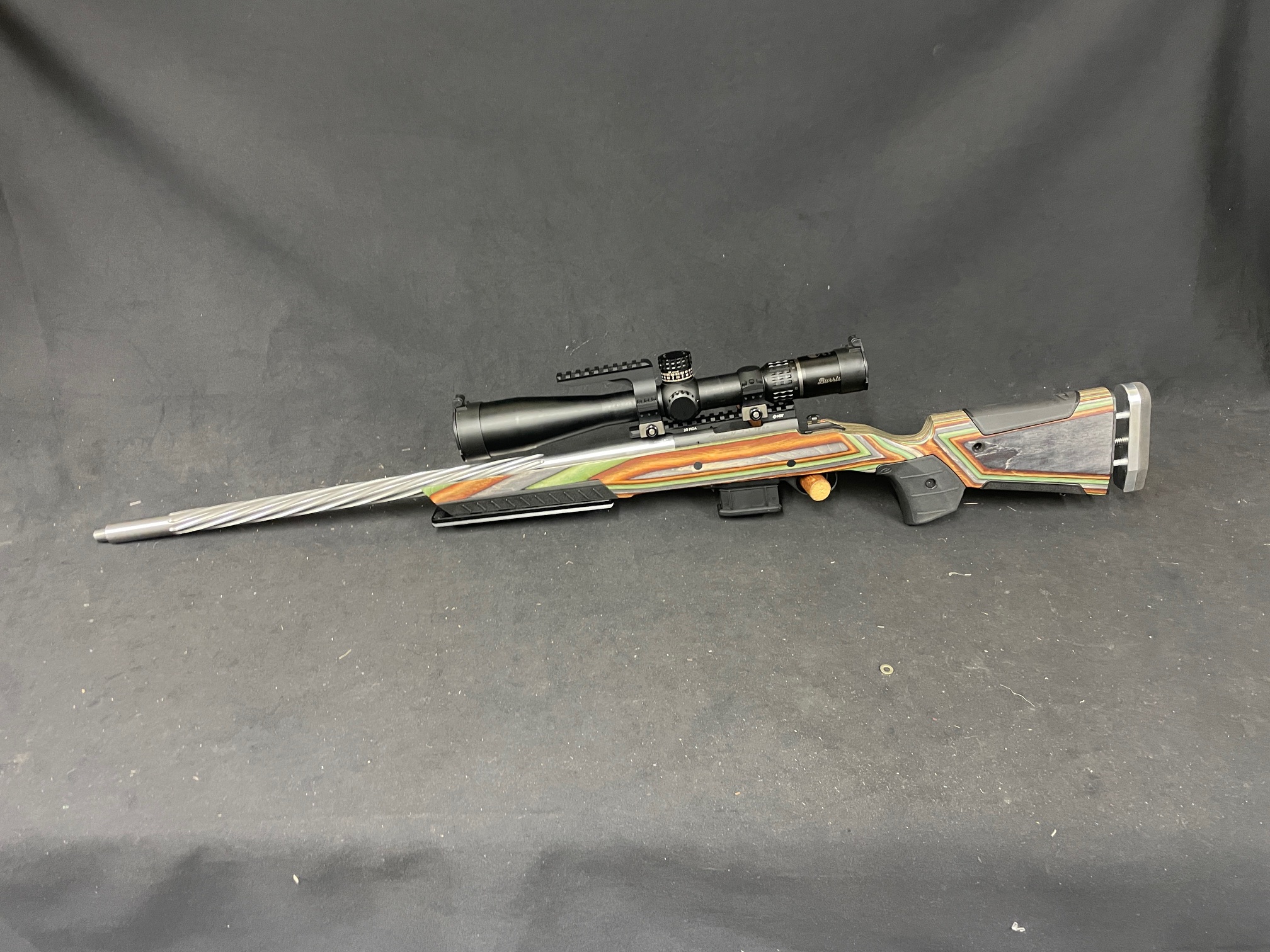

Not a Howa but essentially the same thing, Weatherby Vanguard "Sub Moa" edition. Bought used for just under 300€, the front of the barrel was rusty inside and out... I guess the previous owner wasn't a big fan of cleaning and/or removing suppressors after shooting. Cut a few cm off and got it rethreaded, now it's actually shooting sub moa as the model designation suggests.

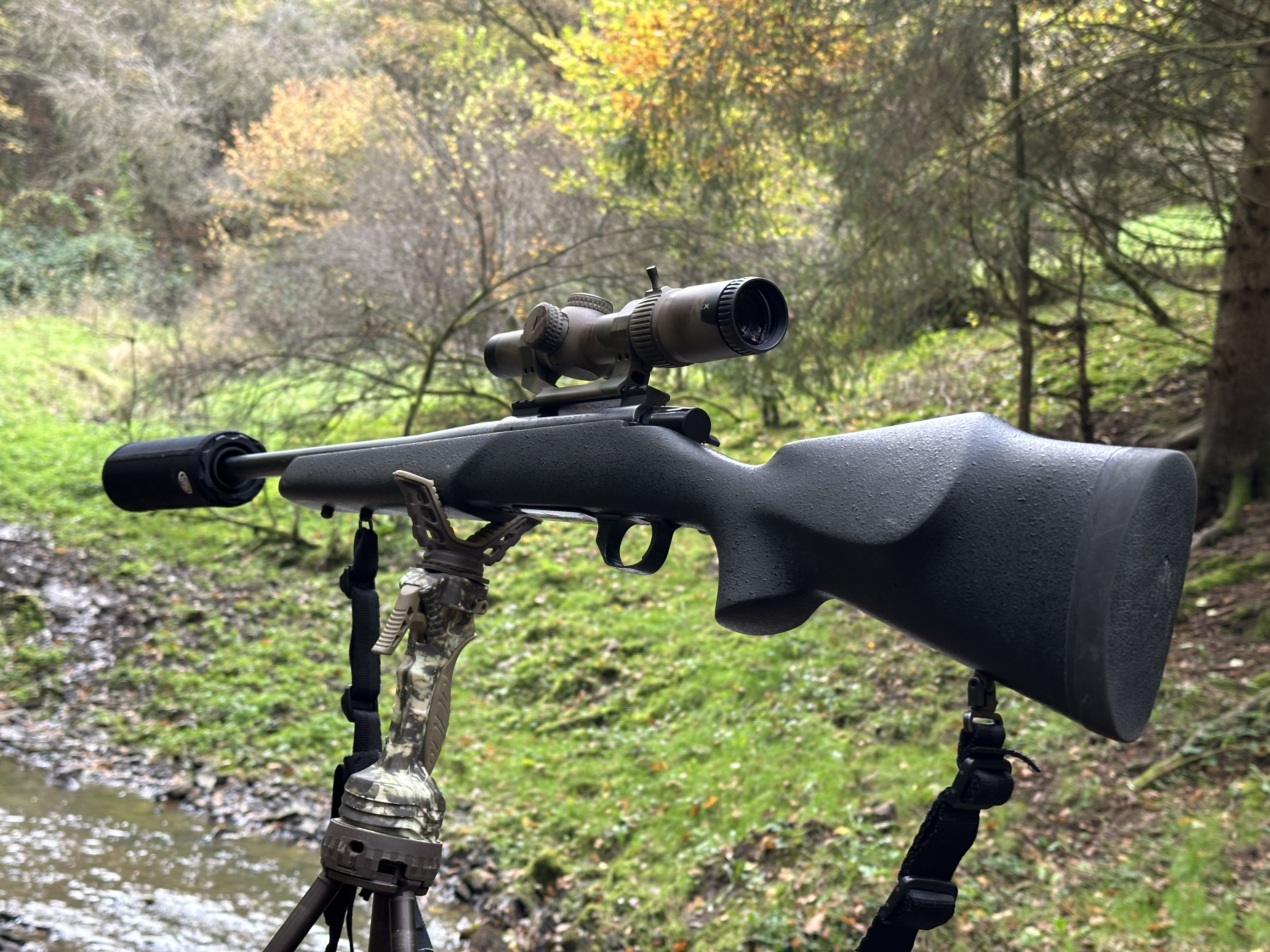

Original Stock + LPVO borrowed off the .22 for a driven hunt:
Current setup:

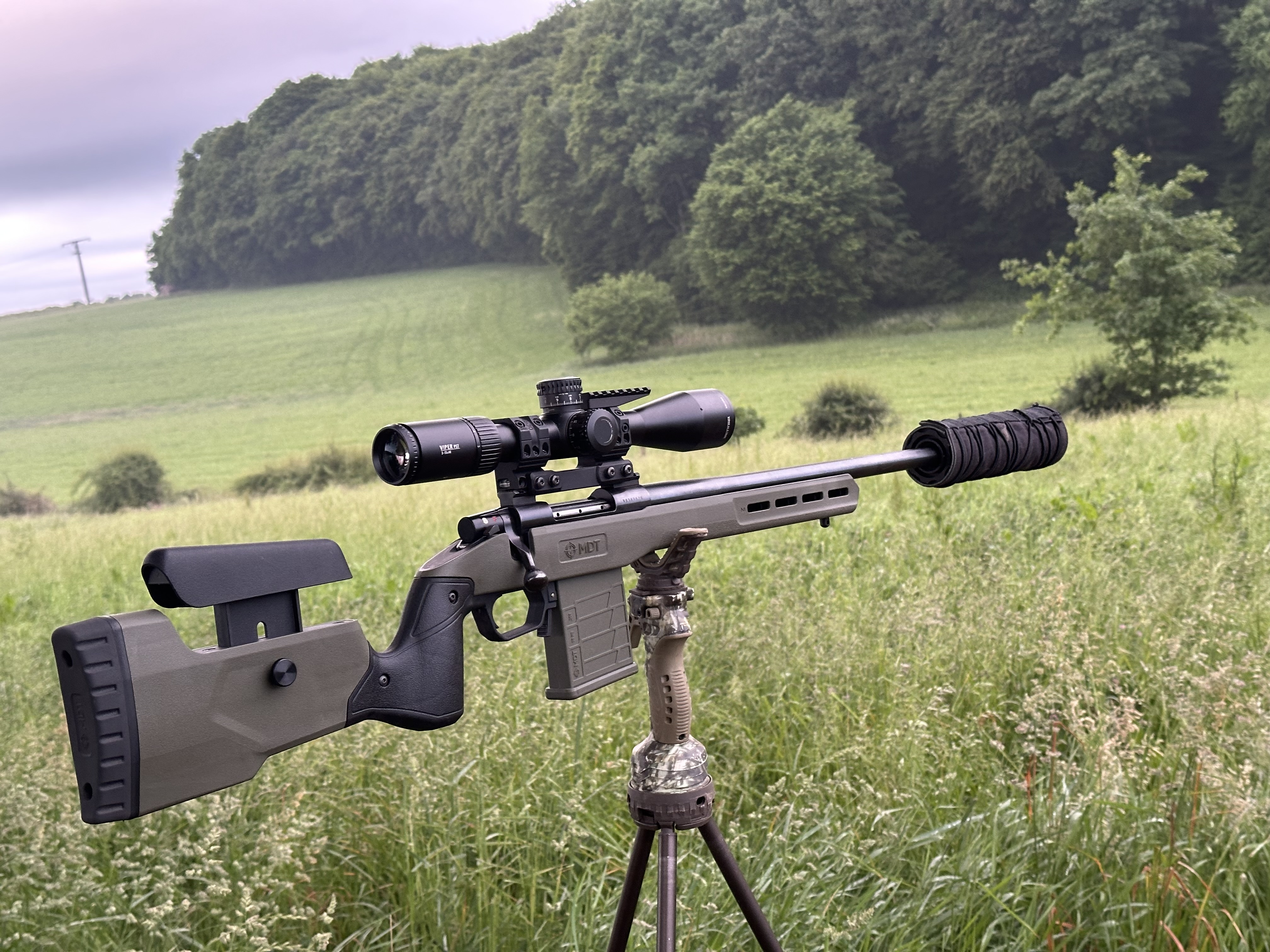

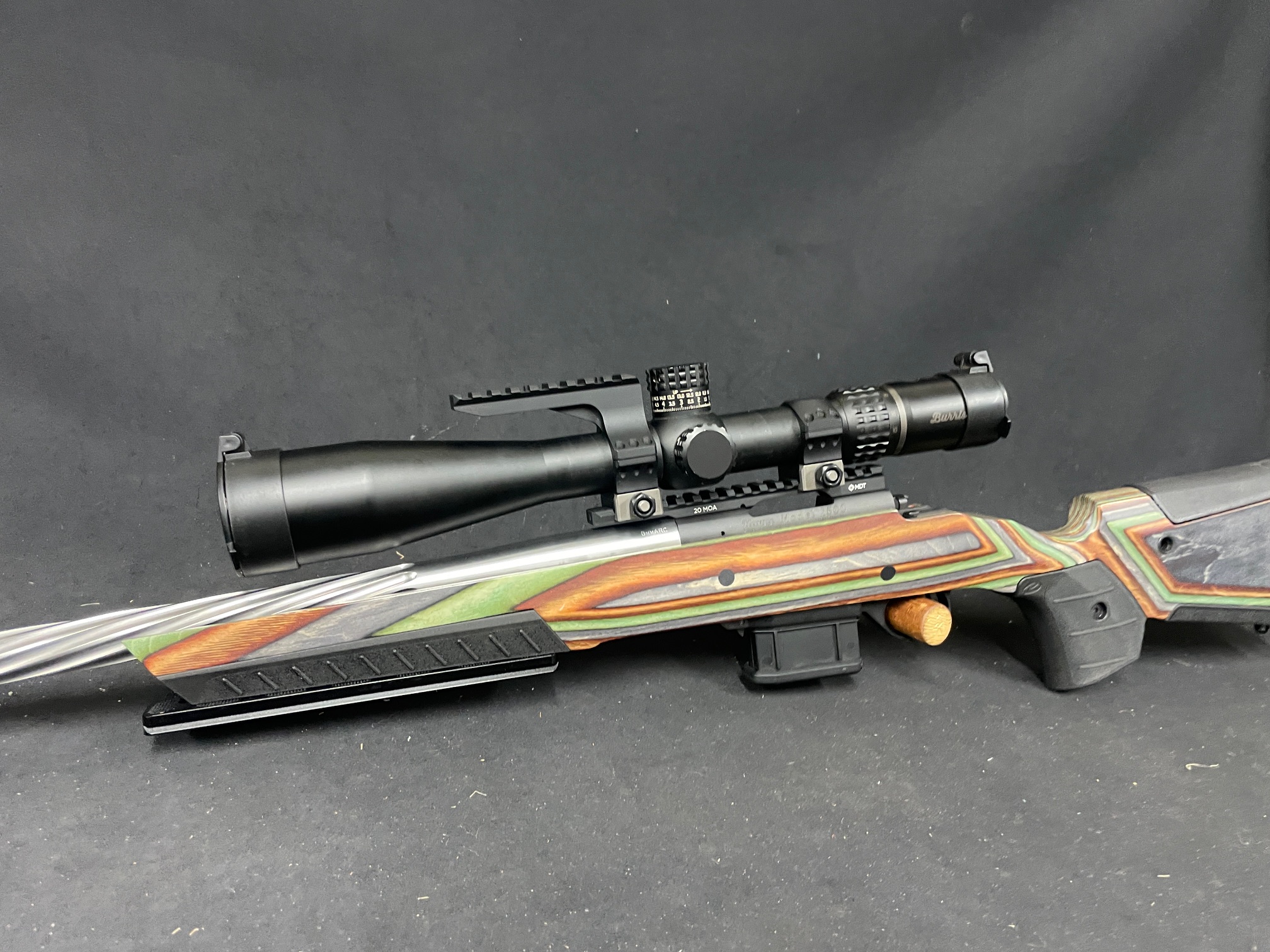

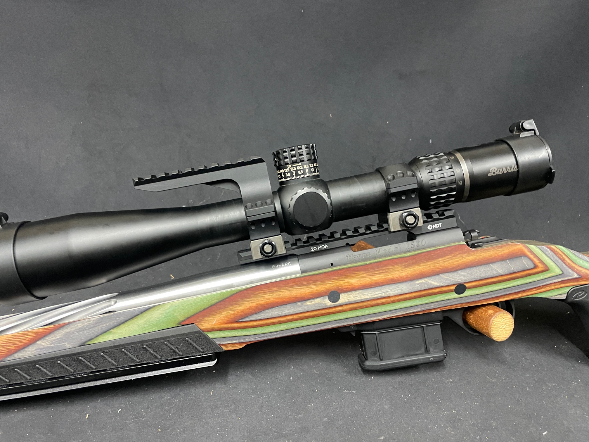

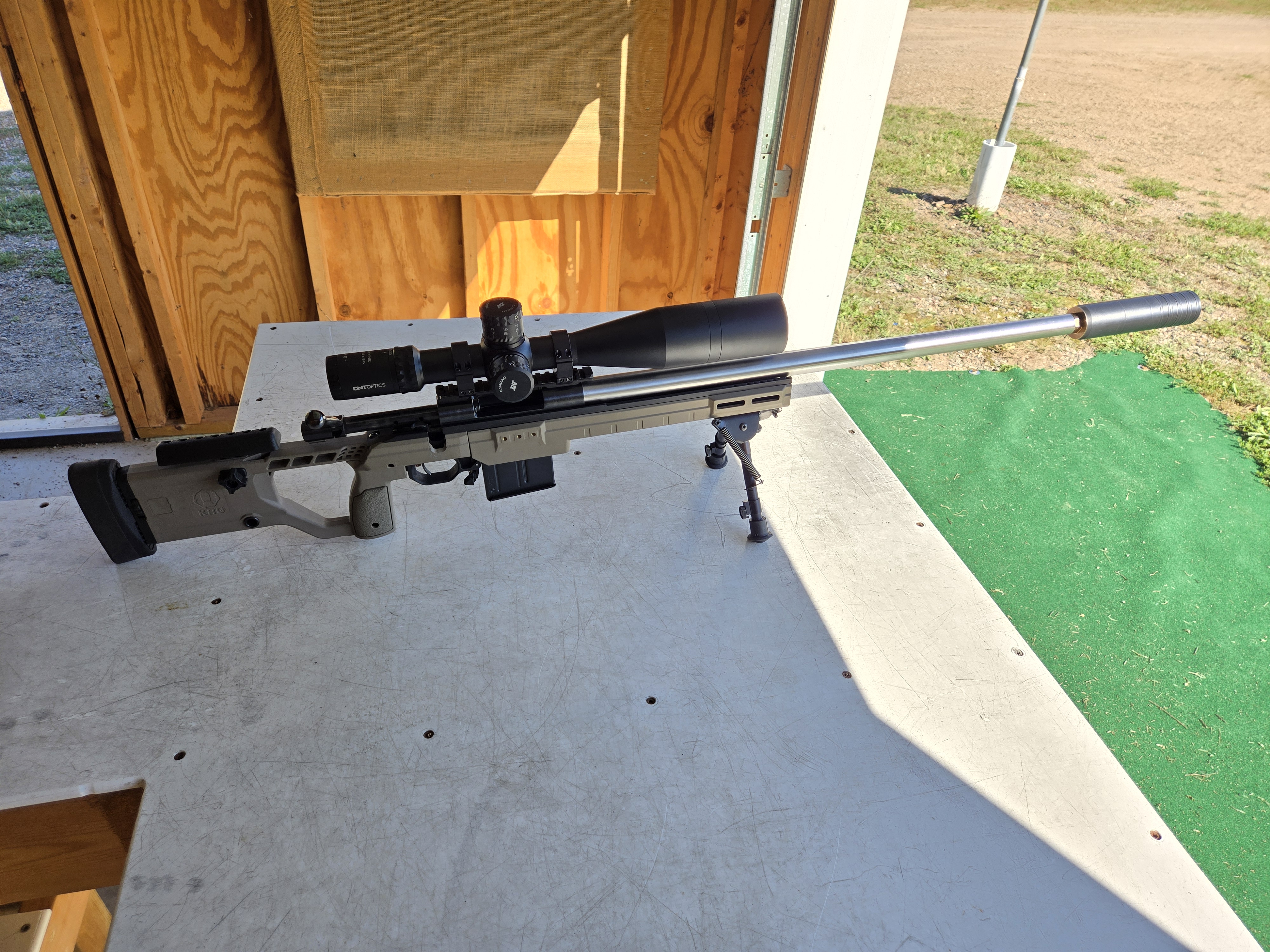

Howa 1500 Mini 6.5 Grendel Action
IBI 26" MTU Spiral Fluted 1:7.5" Twist Barrel
Chambered in 6mm ARC
Boyd's At-one Adjustable stock with target grip
MDT 20 MOA Picatinny Rail
Leupold Heavy Duty 6 screw Rings with 'Diving Board'
Burris XTR II 5-25x50 SCR2 MRAD Scope
Howa HACT Trigger with Spring Kit 1.5lb
ARCA Rail

Looking good. I'm thinking about re-barreling mine.
Looks really good. Xray make a really nice chassis. My 1500 came with the Oryx chassis by MDT. Overall I like it, but if I were going to buy a chassis it would be the Xray.
