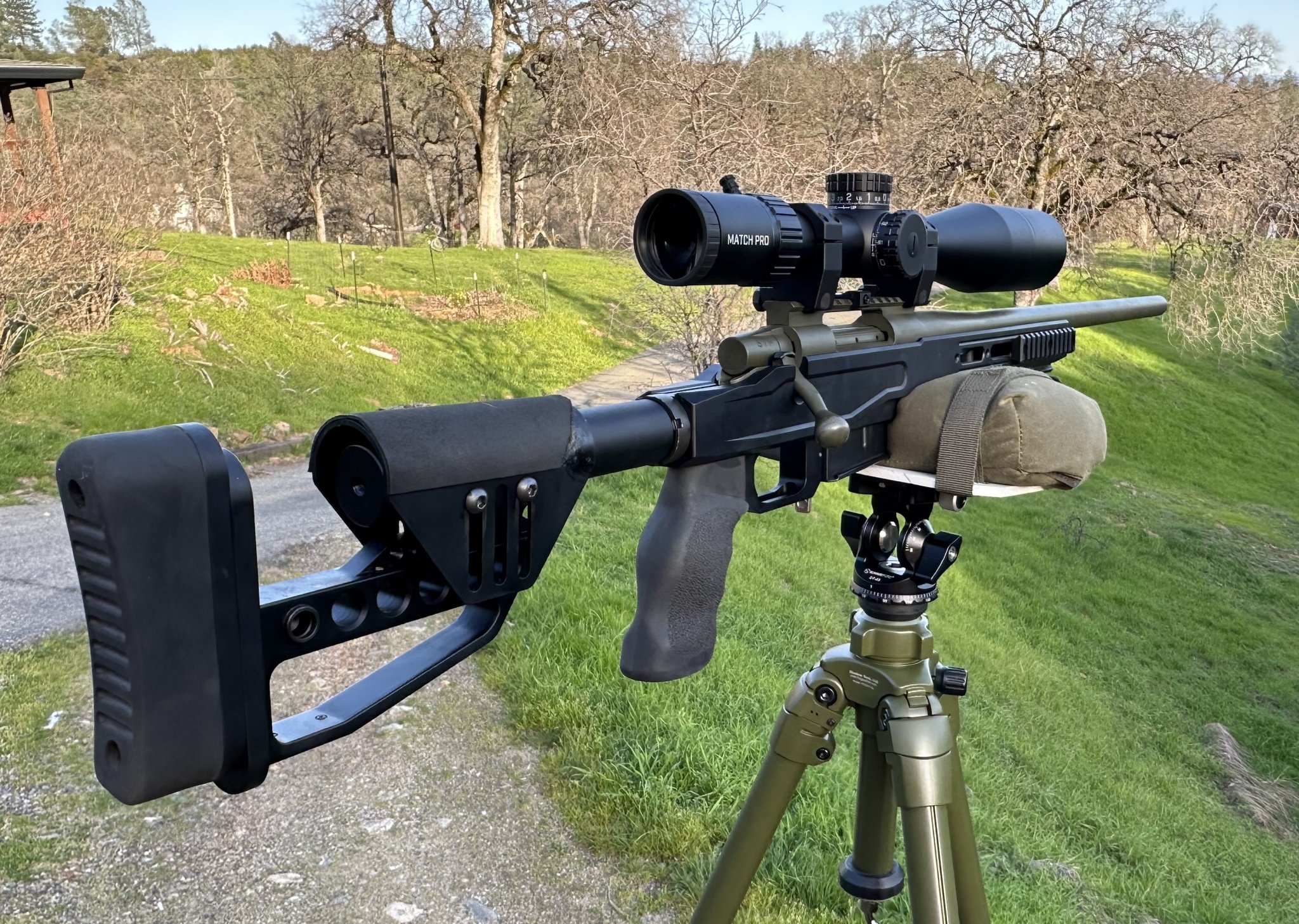

If it is the short action and not the min action, I would look at the KRG Bravo before the Oryx chassis, and the B&C M40 if you want to do a M40 clone. I would also look at stocky's stocks if you want to go carbon fiber. For odds and ends like bolt-on bolt knobs, look at tactical works.

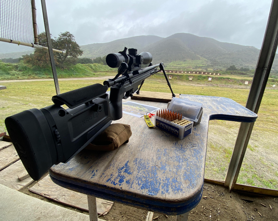

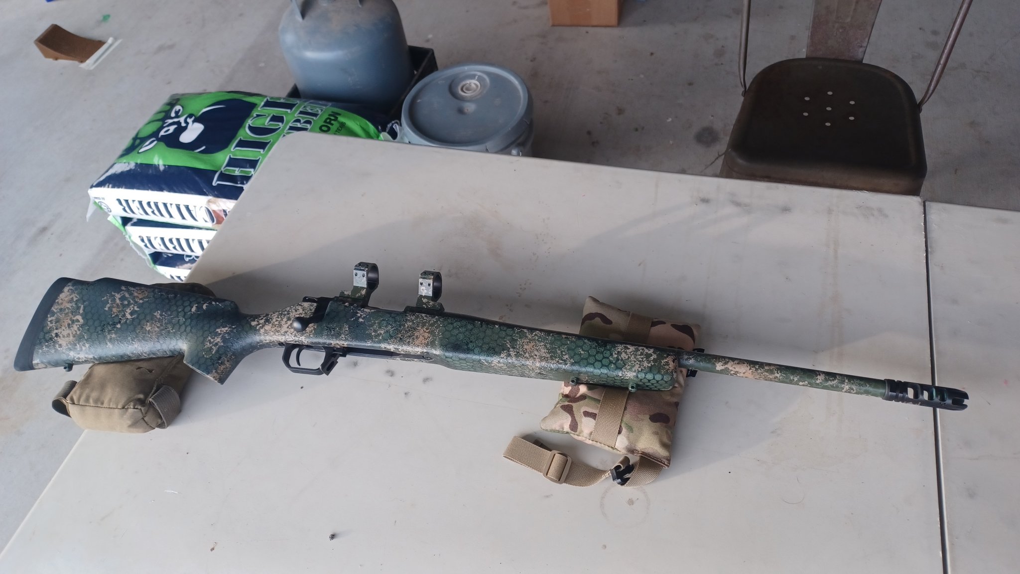

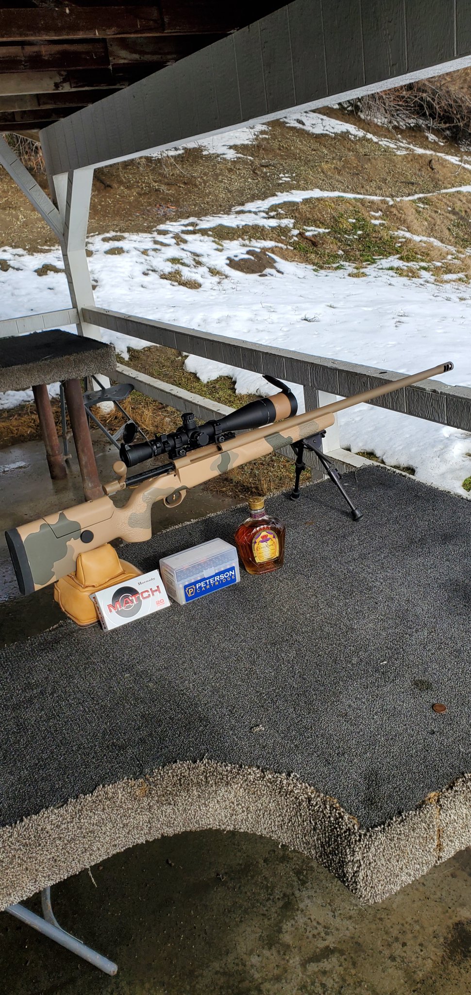

My new howa 1500 SA 223. Sadly it's a 1/9 twist but shoots 62 gr hpbt and 69 smk very good. Using my dad's old leupold scope from when he was on the swat sniper team. Back when leupold was made in the USA. Shoots very well with the cheap hogue stock and the heavy as hell 2 stage trigger. Plan on ordering a rifle basix .75-1.5 lb trigger and haven't decided on a B/C stock or a oryx chassis. Needs to be threaded for my OSS 762 can. Any recommendations on stocks??
I have a Howa SA .223 with 1:9 twist Varmint Fluted barrel at 24”. It’s a laser. I found that it shoots 75gn Hornady HPBTM and 77gn SMKs into 1/2” groups after I did seating depth testing and they fit in the magazine too!

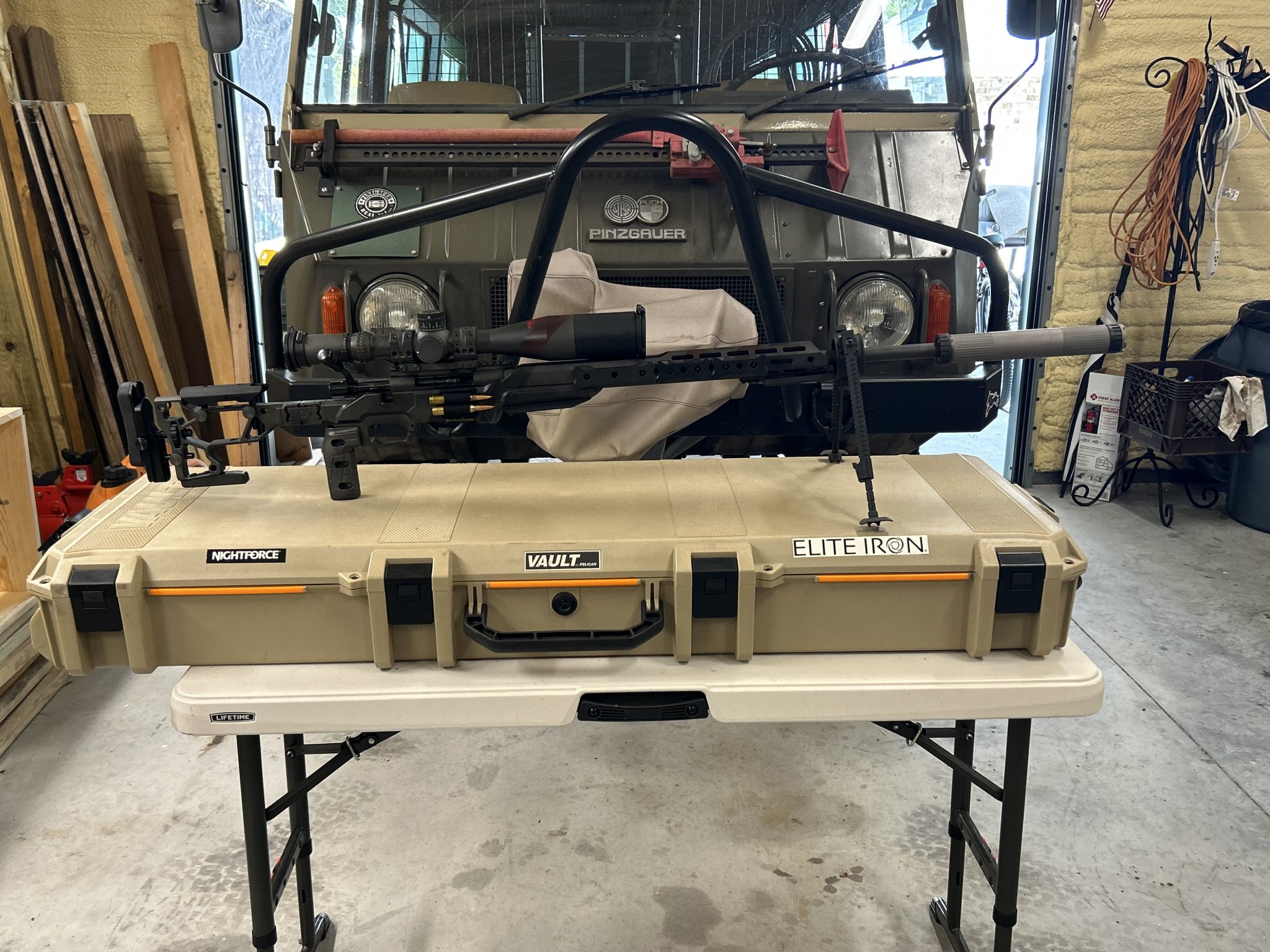

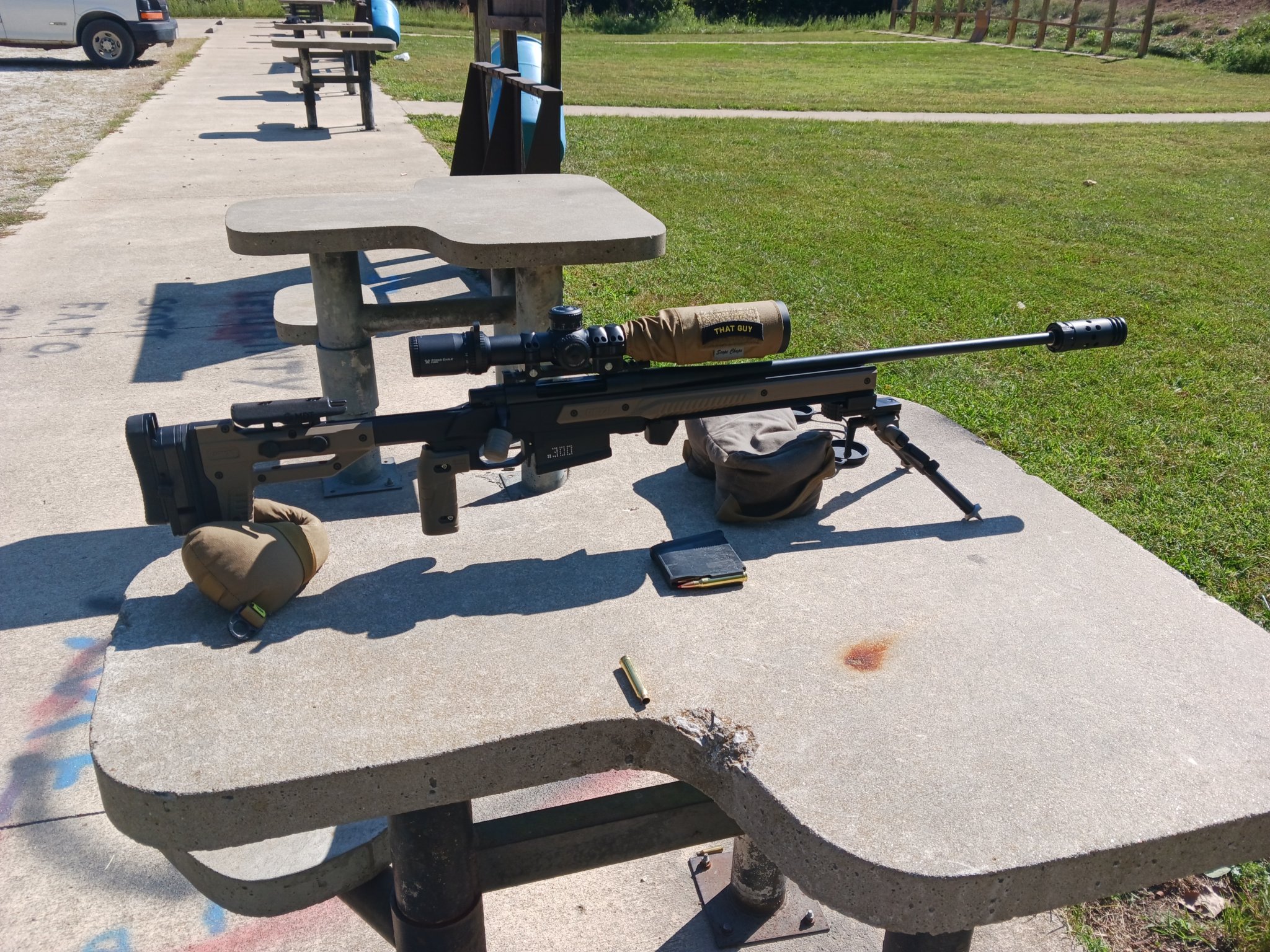

Howa 300WM in a MDT ESS

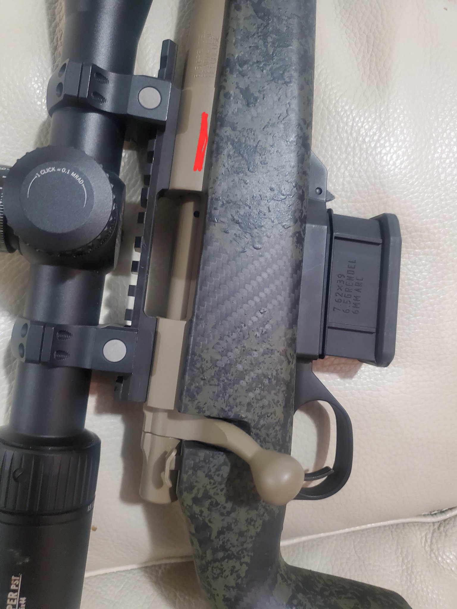

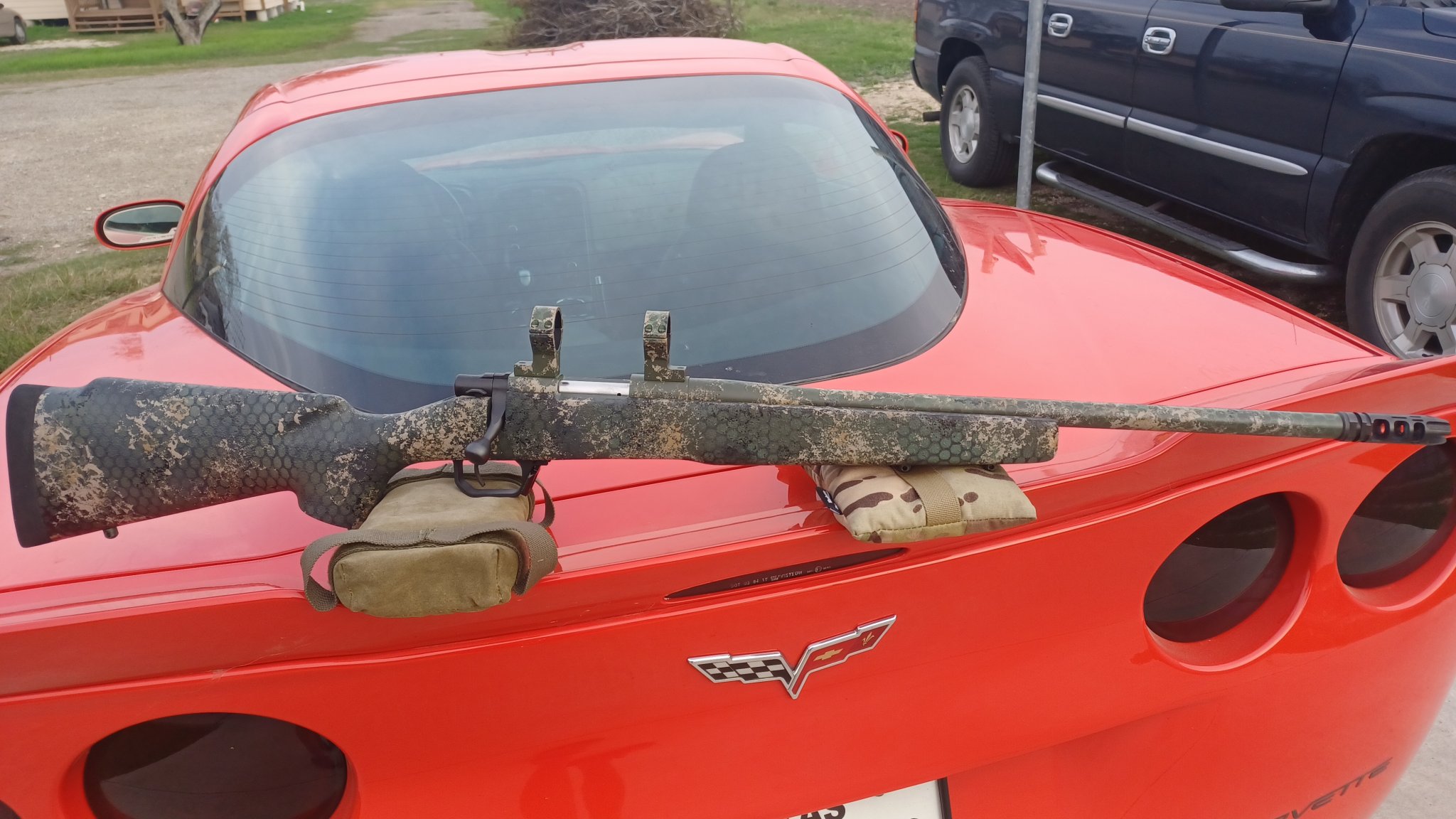

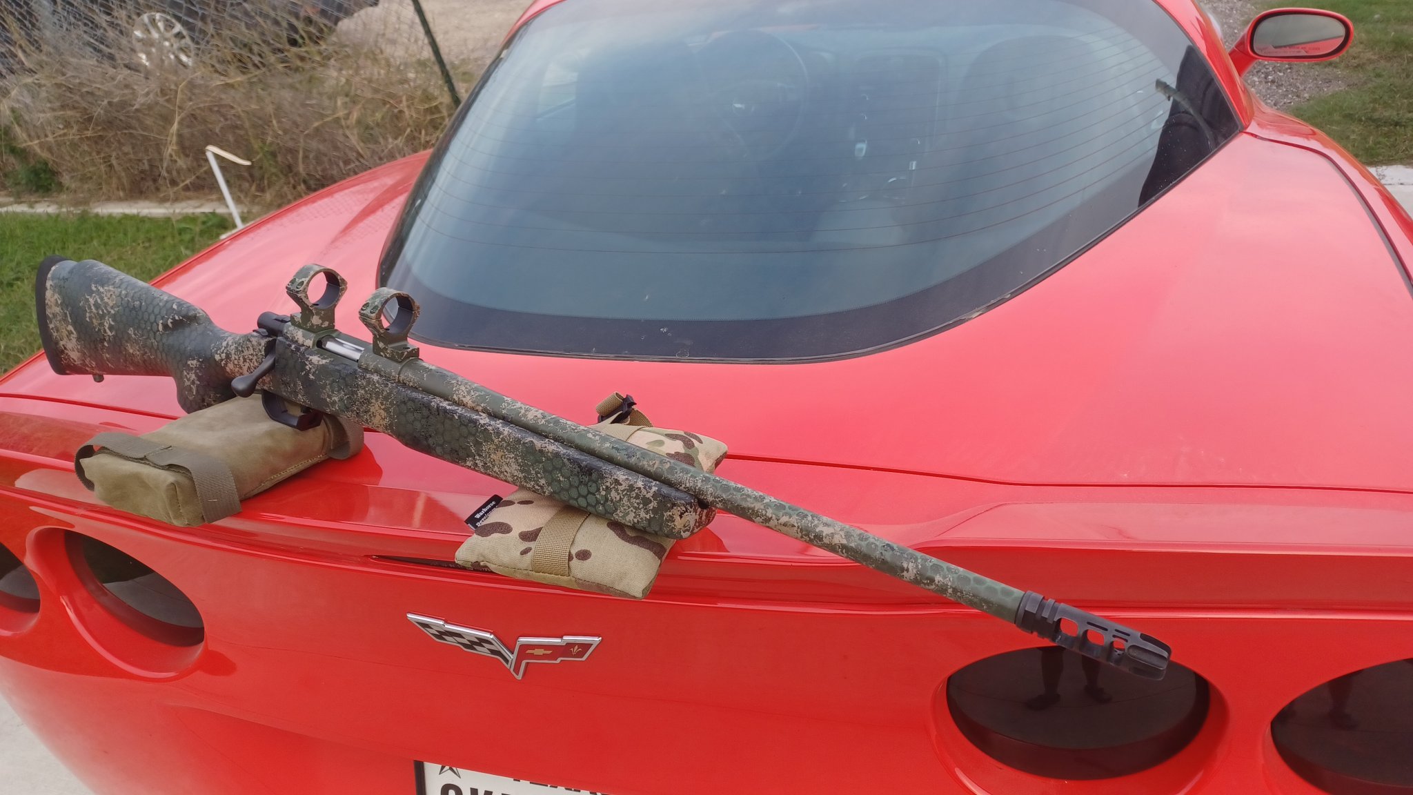

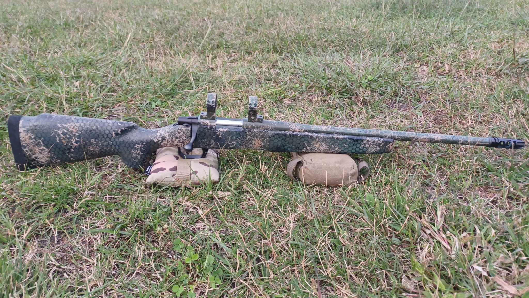

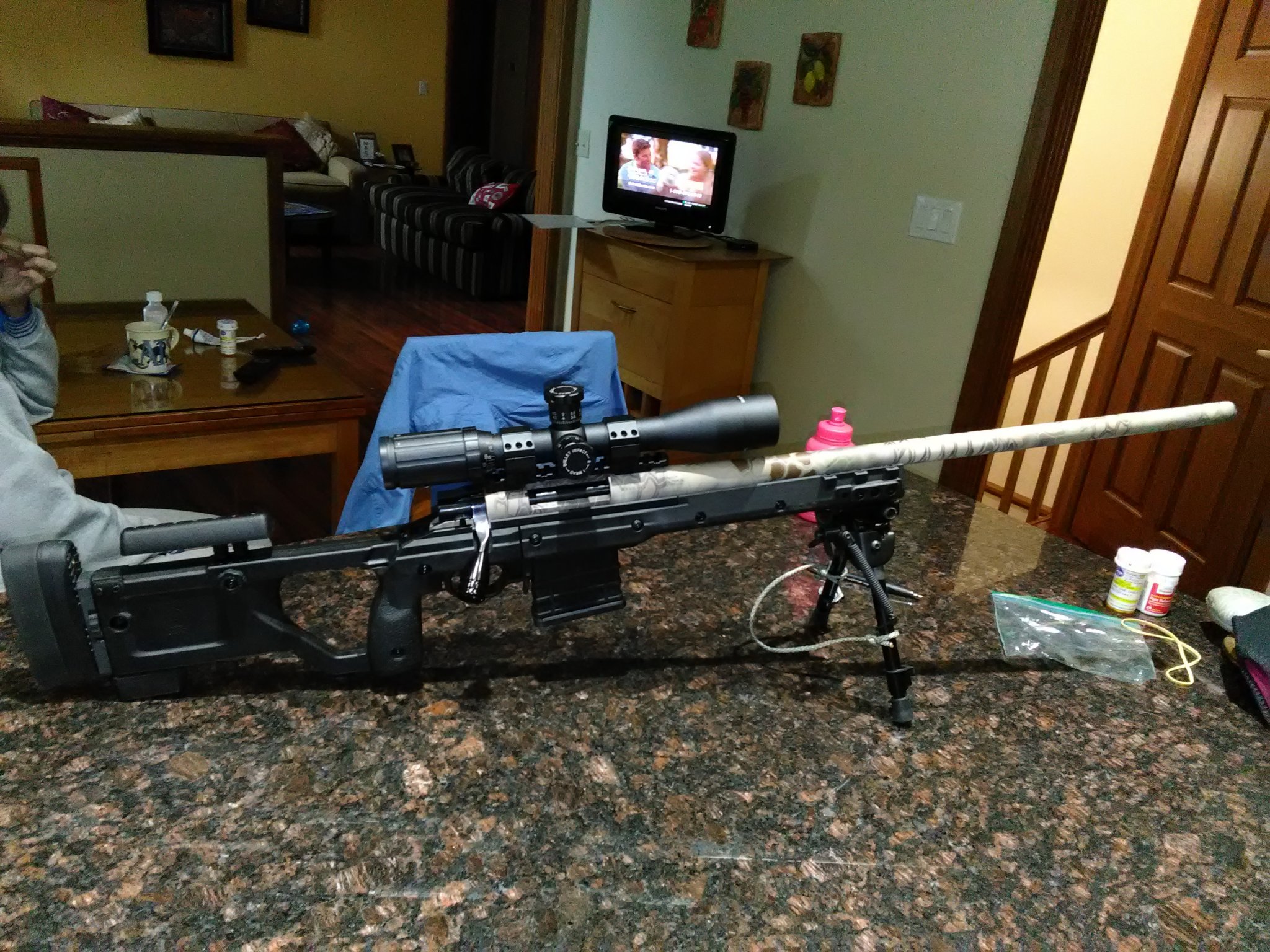

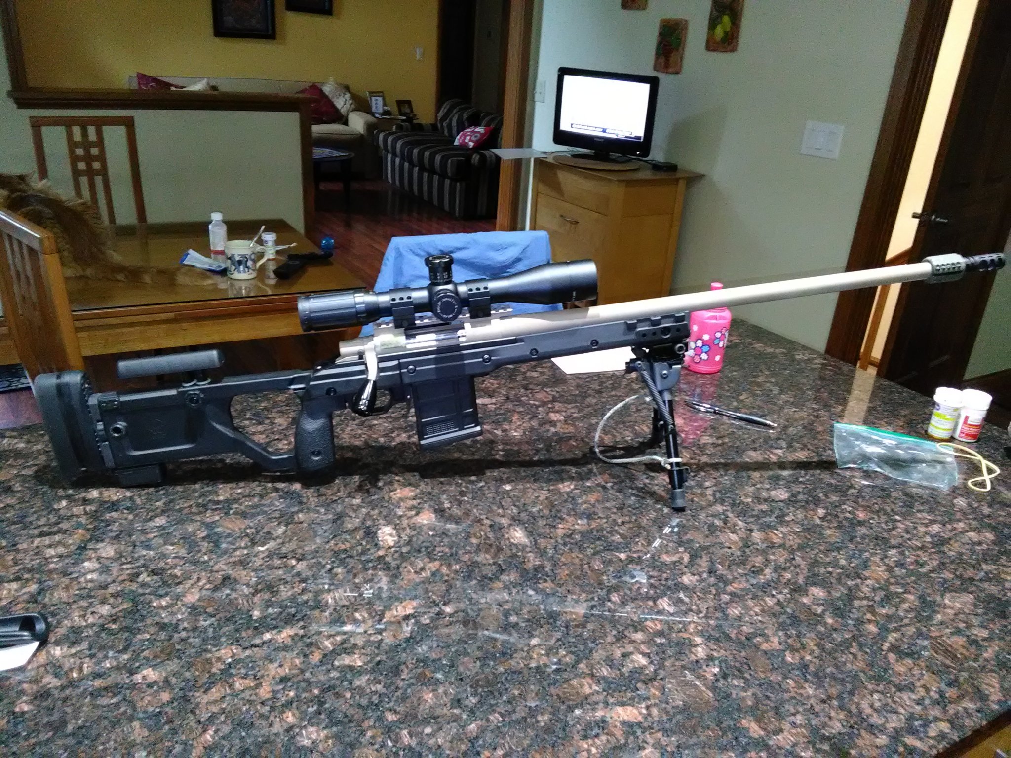

The kids Howa Mini in 6.5grendel. Weighs 7lb6oz as pictured with no ammo. The scope is a gen2 pst 3-15 which I had laying around.
My 11 year old did the load development and was getting sub moa with decent sd's in a medium node with 123gr eldm's.
The barreled action was Cerakoted in FDE and put in a Stockysstocks VG with olive webbing. A metal bottom metal is next. And probably a lighter scope. The boys like this one though.
My 6yo can routinely get first round impacts at 510yds on our 10"plates.
View attachment 8309408View attachment 8309410
Which bottom metal do you plan on going with? One of my minis has an MDT and the other an oregunsmithing. I hear there is one by Jefferson that's good. I would not buy the oregunsmithing again if it were me.
Reactions: BAMAboy18
As much as I like the MDT I won't be using then since you are stuck using their 10rd mags. That doesn't work for hunting. For me with the kids anyways. What don't you like about the oregunsmithing?
Did you buy the mdt and then realized they won't work for you so now you're stuck with them?
Or you just never bought into them since you already knew you wouldn't like them for your application?
The oregunsmithing just needs a lot of tinkering. In one of my rifles, I was able to get it to feed fine but I can only load 3 rounds into it instead of the advertised 4. The 4 will fit but very tight and induce problems.
For whatever reason, on my other mini, it just doesn't work. Once I torque the action and bottom metal onto the stock, the hinged door won't latch close. Or if I install it already closed, it's going to be a bitch to get it opened and if I do, I won't be able to close it back.
I found that I need to bring the entire bottom metal out a bit for it to work. The solution would be to bed it where I need it, which I can, but don't want to.
Aside from that one issue, I have no idea why most times the rounds don't want to feed up the ramp correctly. They seem to hit flat on a wall. I thought maybe you just have to run the bolt hard. So I did. I ended up seating the bullet deep into the case on 3 different cartridges. I can't have that happen in the field, this was supposed to be a hunting rifle I want to give to my dad so I want something he can rely on.
So for now, I left it on the rifle it works, but that one has a full rail over the receiver which makes it tough to top load. I did not want the oregunsmithing on this rifle for that reason. I ended up using the mdt on the hunting rifle I want to give my dad. It looks silly with that huge bulky mag sticking out under it.
I never bought one once I leaned that they only work with the mdt mags. I don't mind the poly bottom metal as it's the kids rifle and I want it to run 100% over shooting 3/4" groups versus 1". If that makes sense. The dip was where I was leaning.

I think need to look for either a lower scope mount, which means a different scope as this one is already close to the bolt, or add a cheekpiece to raise it up a little. My middle kid has to float his cheek pretty high.

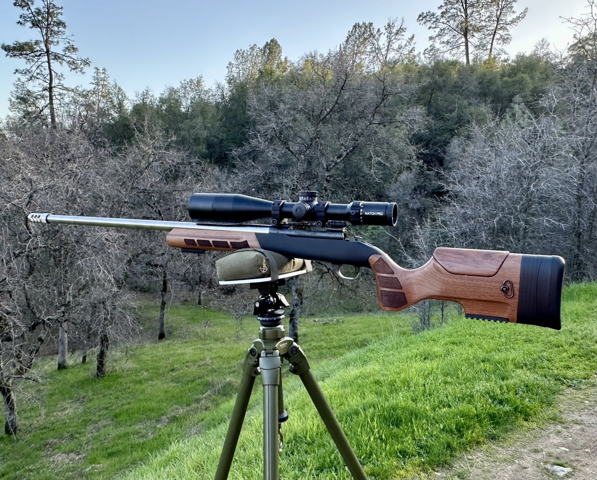

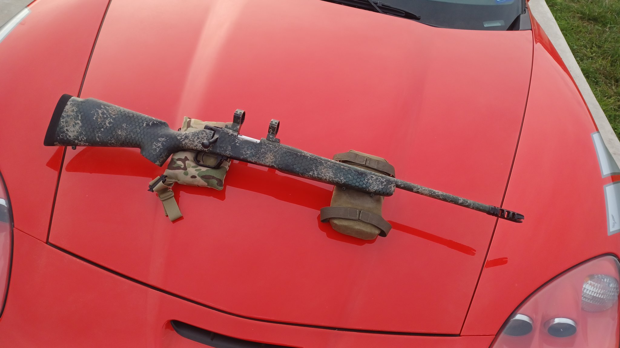

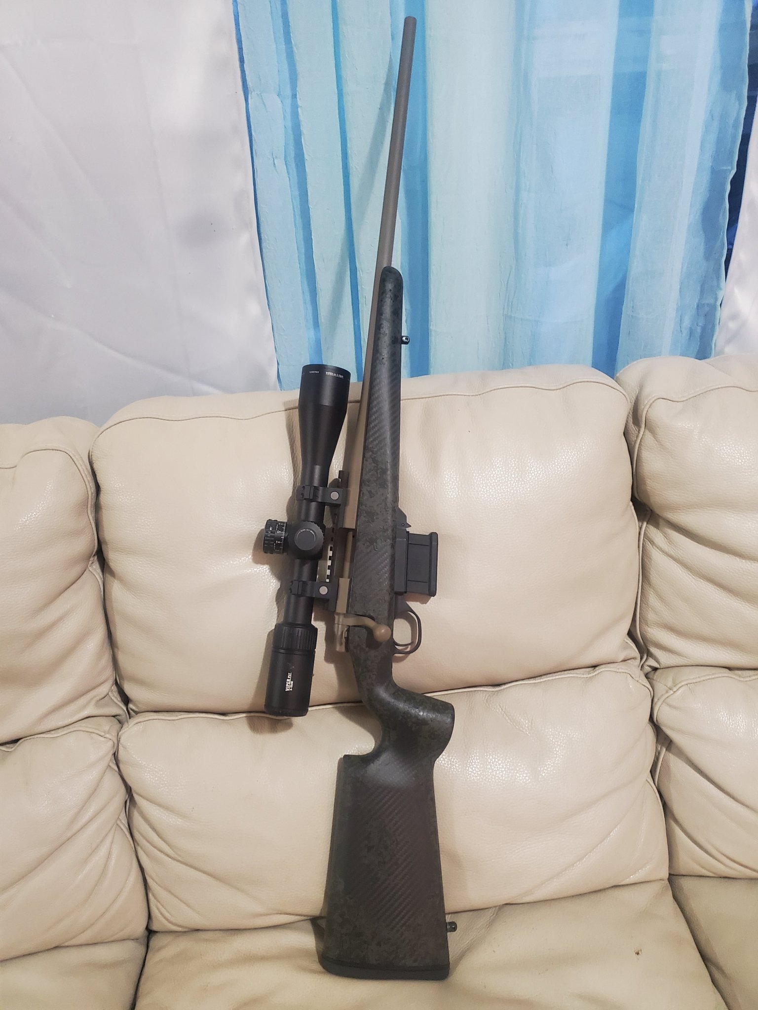

Got my new field stock. Did some grinding on the bolt stop this evening and it's perfect. Just need to get the barrel threaded. 😩
Sweet! Are you going to have your bolt threaded for a knob at the same time? I ordered 2 new rifles with 16" heavy treaded barrels; 308 & 6.5cm. I gifted my hunting rifle to my son last year, it wasn't cobbled together sub-tier, but it was everything I didn't want; Atlasworxs DBM, HACT trigger, Outer impact rail, Weaver rings, and a 20" non threaded barrel. My 6.5 is complete, 308 has all the prep done to bed the stock, I keep procrastinating about mixing up the Devcon. Incidentally, I don't have threaded bolts, I clamped on some knobs, for now...

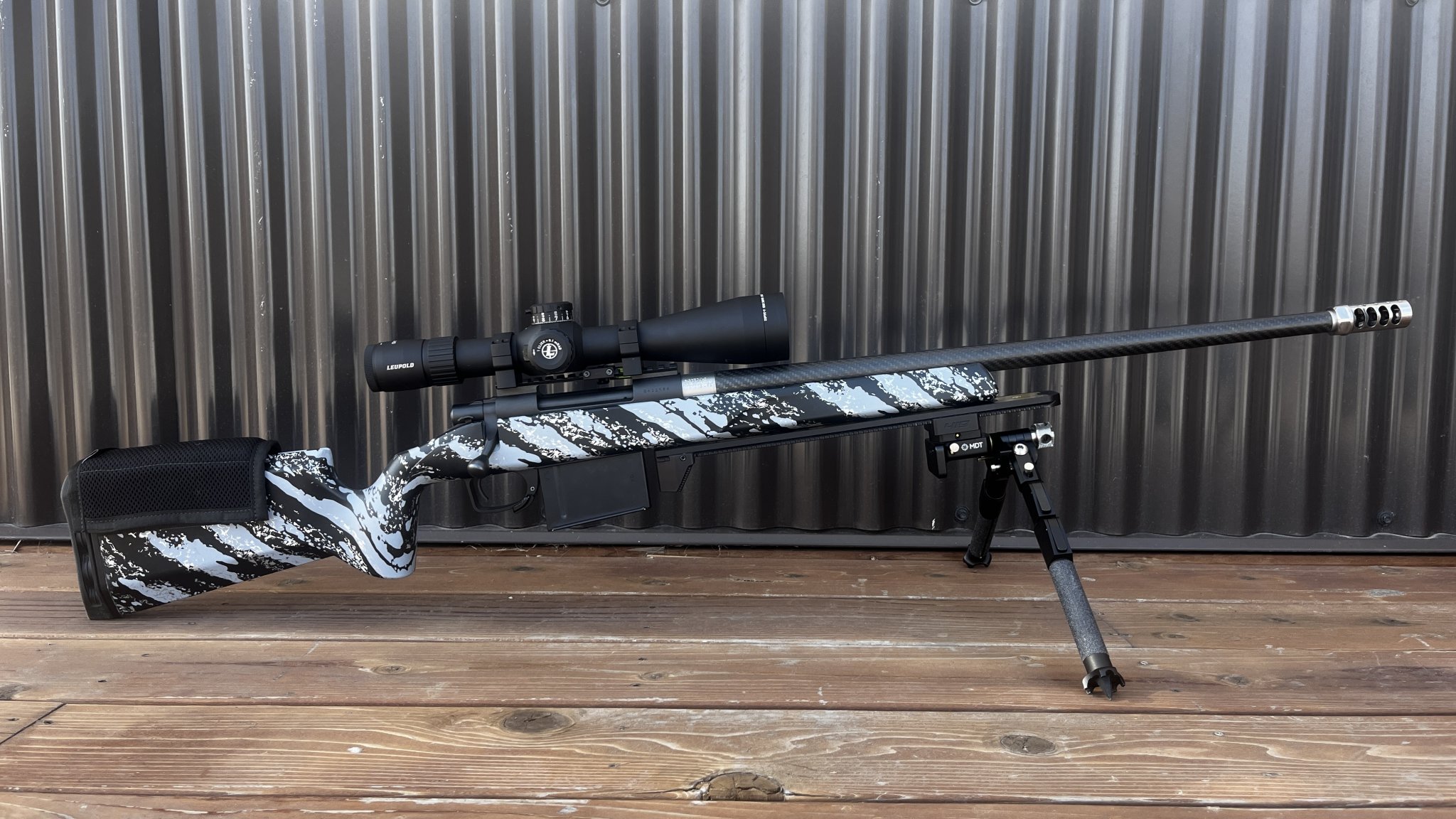

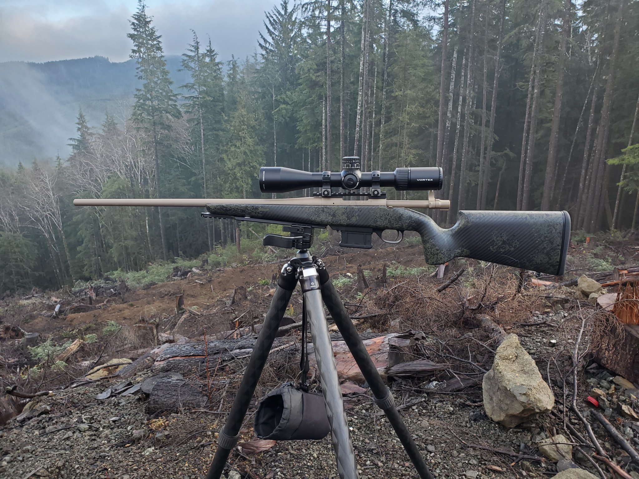

Howa 6.5 PRC Carbon Wrapped Barreled Action
Stocky’s VG2 Stock
Atlasworx bottom metal
Leupold Mark 4 HD 4-26x52mm
APA muzzle break
Area 419 Tunable rail
MDT Cyke Pod Double Pull

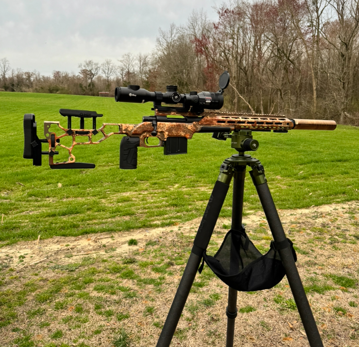

Recently put this together. Planning to shoot some NRL Hunter matches this year with it. Will swap out that weighted rail for a 4in rail by area 419 when I take it hunting. Probably will put a lighter bipod on it for hunting trips as well.

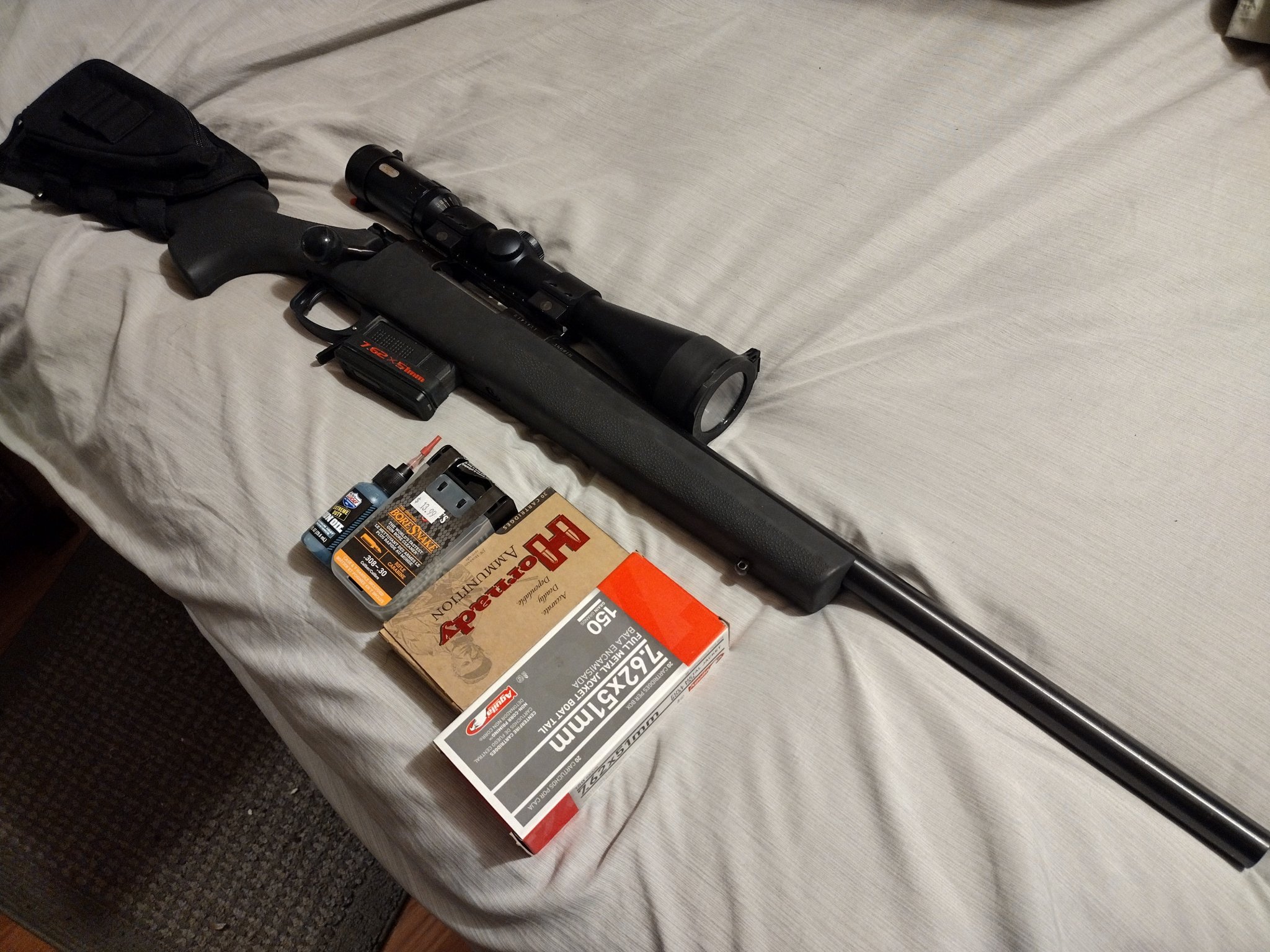

1-12 308, KRG 180-Xray, EGW 20 MOA base, Burris rings, SWFA 3-15X42 mil, Harris knock-off that tilts and pans, Timney trigger (2 lb), Witt Machine clamp-on thread adapter, VG6 Gamma 762 brake, QuickLoad bolt-on bolt knob, Magpul and Alpha AICS magazines.

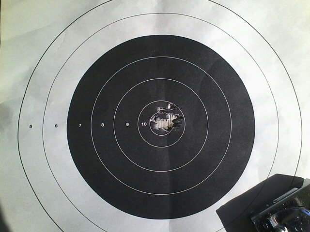

1500 308 ten shot group at 100 yds. The X ring on that target (NRA 100 yd smallbore) is 1", the ten ring is 2".

With the polymer mags, did you have to machine off the tab at the back of the receiver. I have two Howa 1500's
I have done the machine work on my 308. I can use both metal and polymer MDT mags. Since then I have heard that with polymer MDT mags its not required. Before I do my 223 I'm trying to find out what's what.
I have not removed the tab at the rear center of the underside of the receiver on either my 308 or short action 223. It's not necessary to do so for any magazine to function with a short action Howa in any KRG chassis.
Both mine are in GRS stocks. It only takes 5 minutes to do the mill work. The set up actually takes longer. I was hoping the reason was the polymer mag as apposed to using a KRG chassis. Since I have to order the mags and bottom metal anyway, a Mockup will tell the tail. Keep your fingers crossed for me.

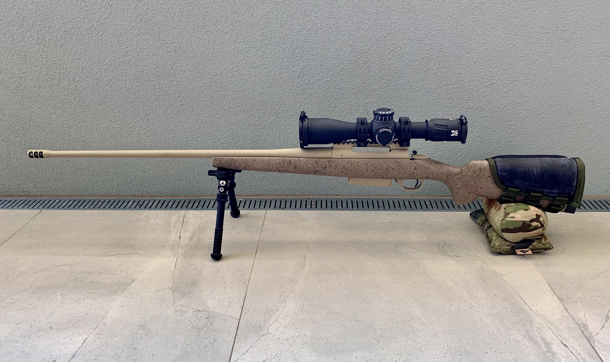

Decided to go for lightweight LR hunting rig and ended up with the below.
Howa 280AI
Maddco 26” barrel
Trentech custom muzzle break
Wild dog lightweight hunter carbon stock
Arc M10 rings
ZCO 420 MPCT2
Atlas bipod
Overall weight - 5.2kgs / 11.46 lbs
Easy chip shot @650m

Did Lee at Trentech do the gunsmithing ?
He just built me a Rifle and it’s the most consistently accurate Rifle I’ve ever owned .
From the photo your Chronographing the load , what did you end up loading/ using?
Yup, Lee did the work few years ago for me but due to personal situation hadn’t had the rifles out since. Lee’s work is always quality!
3013fps average / 162gn ELDX / 61.3gn 2213sc / Norma brass / SD 6.5
