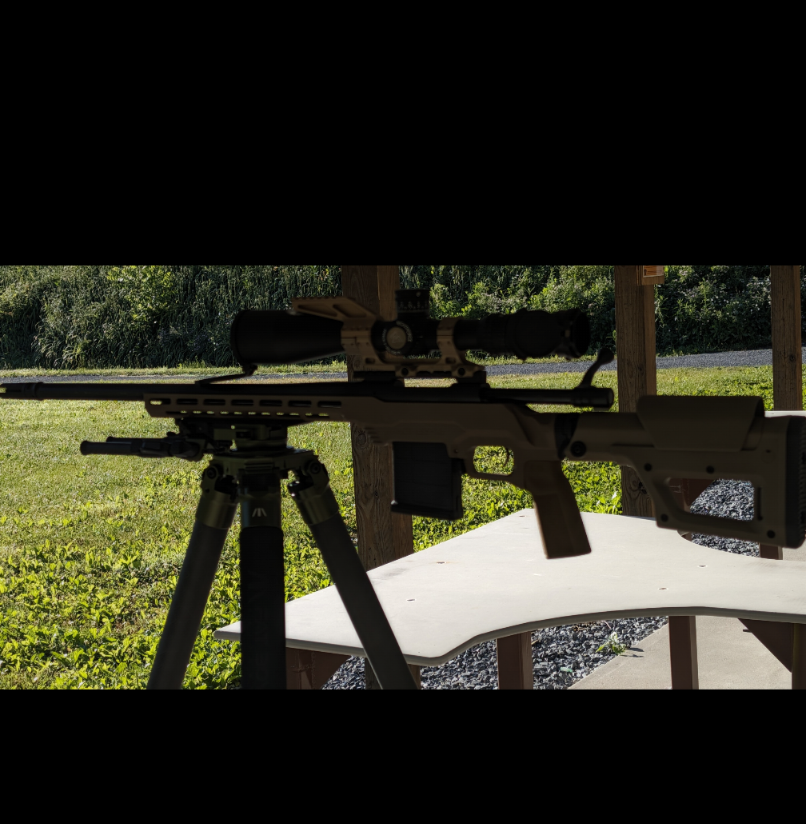

Howa 1500 with an LRI fitted K&P 28" MTU Contour 1:8 Left Twist with an Ultrdyne Apollo LR brake sitting in a Woox Exactus precision stock using the Vortex Strike Eagle 5-25x56 in a 30 MOA American Defense mount sitting on a 25MOA rail.
  • Love
Reactions: rhsc and MO Fugga

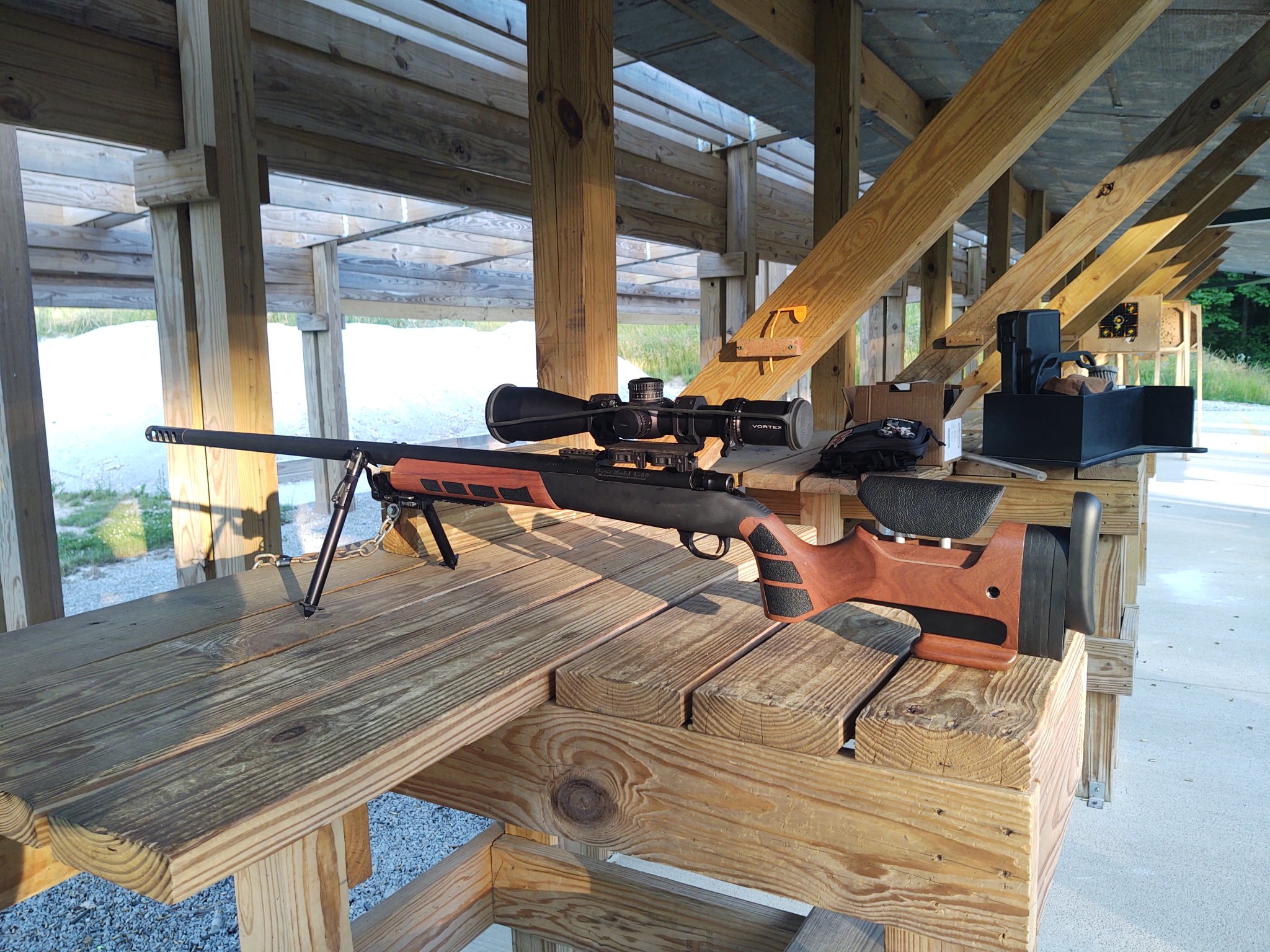

Howa 1500 20" Heavy .308 SA from Brownells, got it with the Memorial Day discount out the door for $419 from my FFL after ePICS (PA NICS) fee.

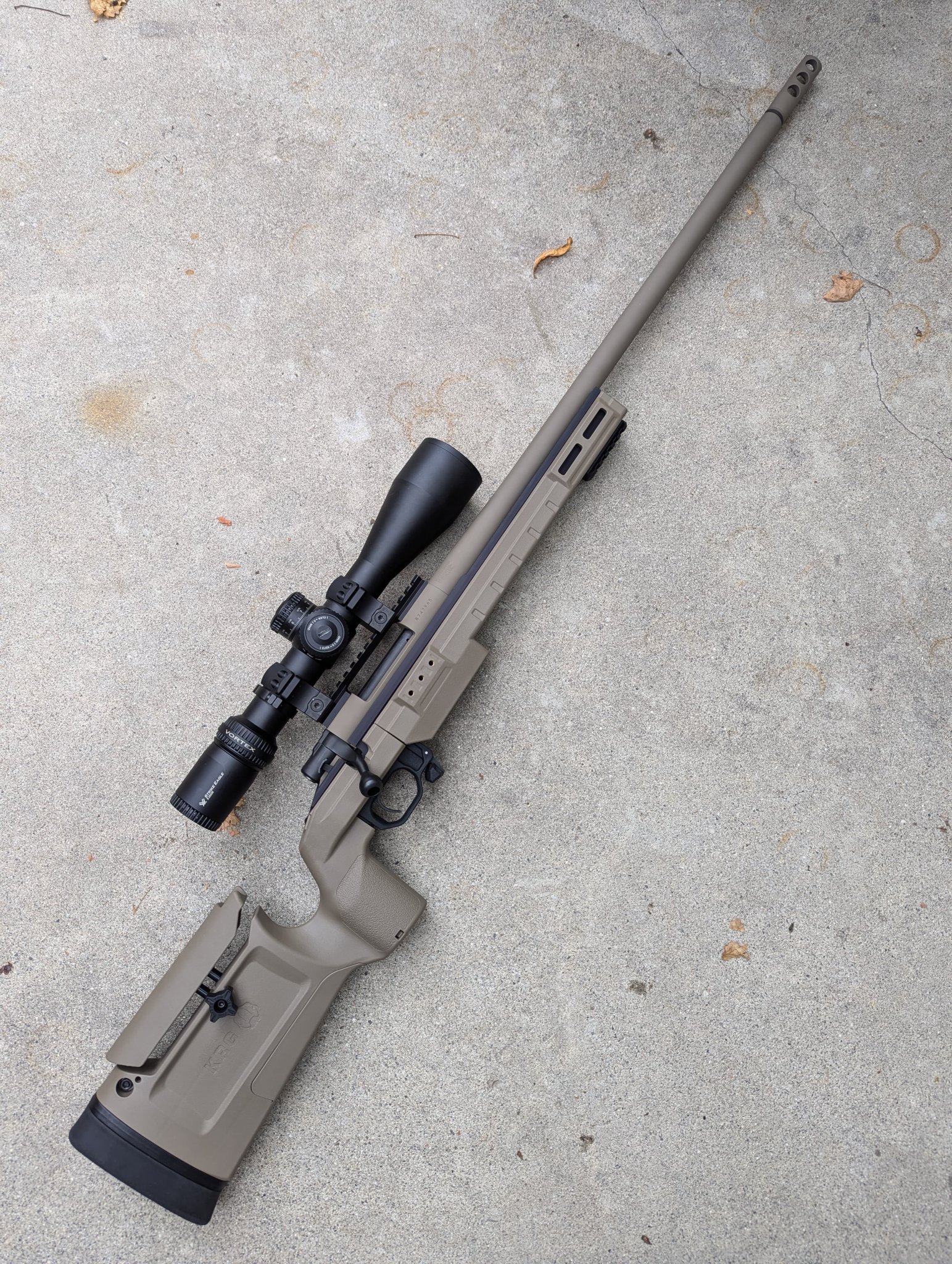

Threw it in a MDT XSS-XL Gen 2 with a Talley picatinny rail, MDT 7 inch ARCA section, PRS Lite, B5 Systems T22 grip, and a SF3P waiting for my RC2-762 to be approved.
NF 7-35 F1 in a Reptilia 1.54 AUS mount with a diving board.
Was not expecting much for under $1100 all in minus the glass and mount I pulled off an M110A3. Shot 5rd groups under 0.75MOA at 100yd with Federal GMM 175s. The piece of shit MDT GRND bipod fell apart though, stripped screw inside, have an RMA opened up will get an accutac next time

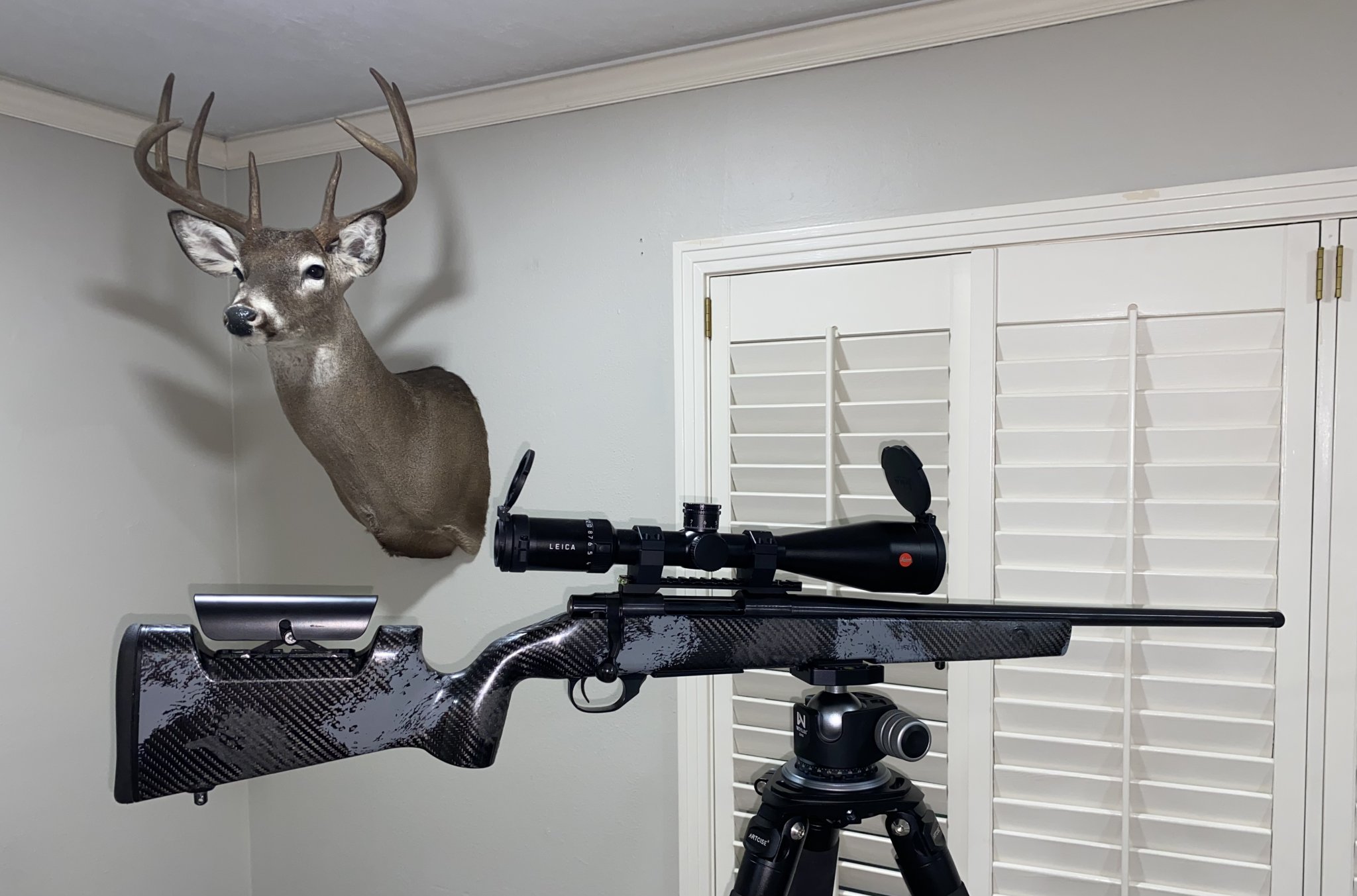

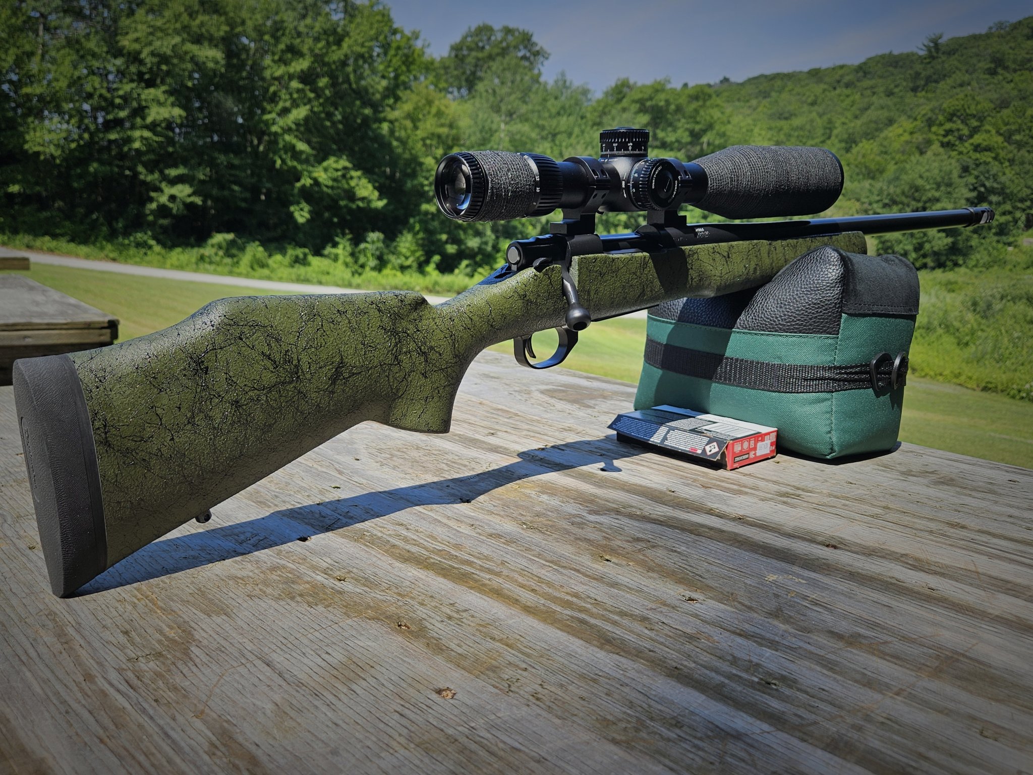

Back in 2014, I bought an old Howa 1500 chambered in .308 off a buddy for $200; he'd won it in a local gun raffle. I finally decided it was time for some upgrades.
I swapped out the stock for a Stocky’s Stock VGA and drilled and tapped it for an SRS mini Arca rail. The original Nikon Monarch scope was replaced with a Leica Amplus 6, still SFP but now its capable of dialing for distance. I’m excited to see how it shoots when I hit the range next weekend.

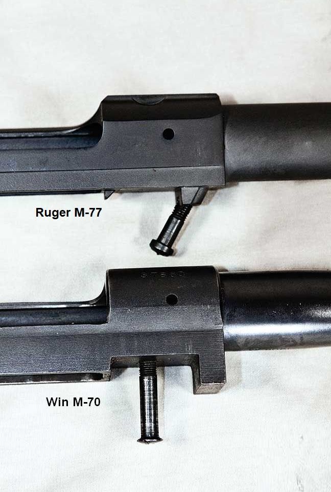

My theory is that since Howa is a unique square-style action that nobody else makes...
Winchester and Ruger have entered the discussion... ;)
I've had good results pillar bedding my Ruger M-77 receivers, and they have the added complication of the angled forward action screw. I first bed the pillars to the action and stock, then bed the recoil lug in a second separate step. I epoxy bedded my Howa's recoil lug into my stock's aluminum bedding block as it didn't show full contact across the rear face of the lug, so that was a very simple process. Bedding a Howa into a more conventional wood or composite stock shouldn't present any unusual problems, just be sure to bed only the bottom of the receiver and the rear-facing surface of the recoil lug as you would with any other action.
Thank you for identifying my area of ignorance.
I assume that Ruger only fits Ruger inlets, Winchester only Winchester, Howa only Howa etc?
I.e. none of the square actions are interchangeable across platforms as the R700s from multiple manufacturers are?

Correct. Perhaps your point revolves around the fact that only Howa makes a Howa-1500 pattern receiver?
My thought revolves around lots of companies with various levels of talent make R700-style receivers and stock and chassis manufacturers have to leave enough room in their products to reasonably to fit them all.
If a stock or chassis manufacturer is making a product to fit a Howa, Ruger, or Winchester, shouldn’t the stock or chassis manufacturer be able to make their stock or chassis tolerances tighter since they are only worrying about fitting one manufacturer’s product?
-Stan
Reactions: rhsc
O.K., I see your point. You would think that's the case as Howa appears to manufacture their receivers to tighter tolerances than Remington alone ever has, not even considering all the 700 clone-makers. It's very doubtful that any stock or chassis fitment issues are the fault of Howa.
