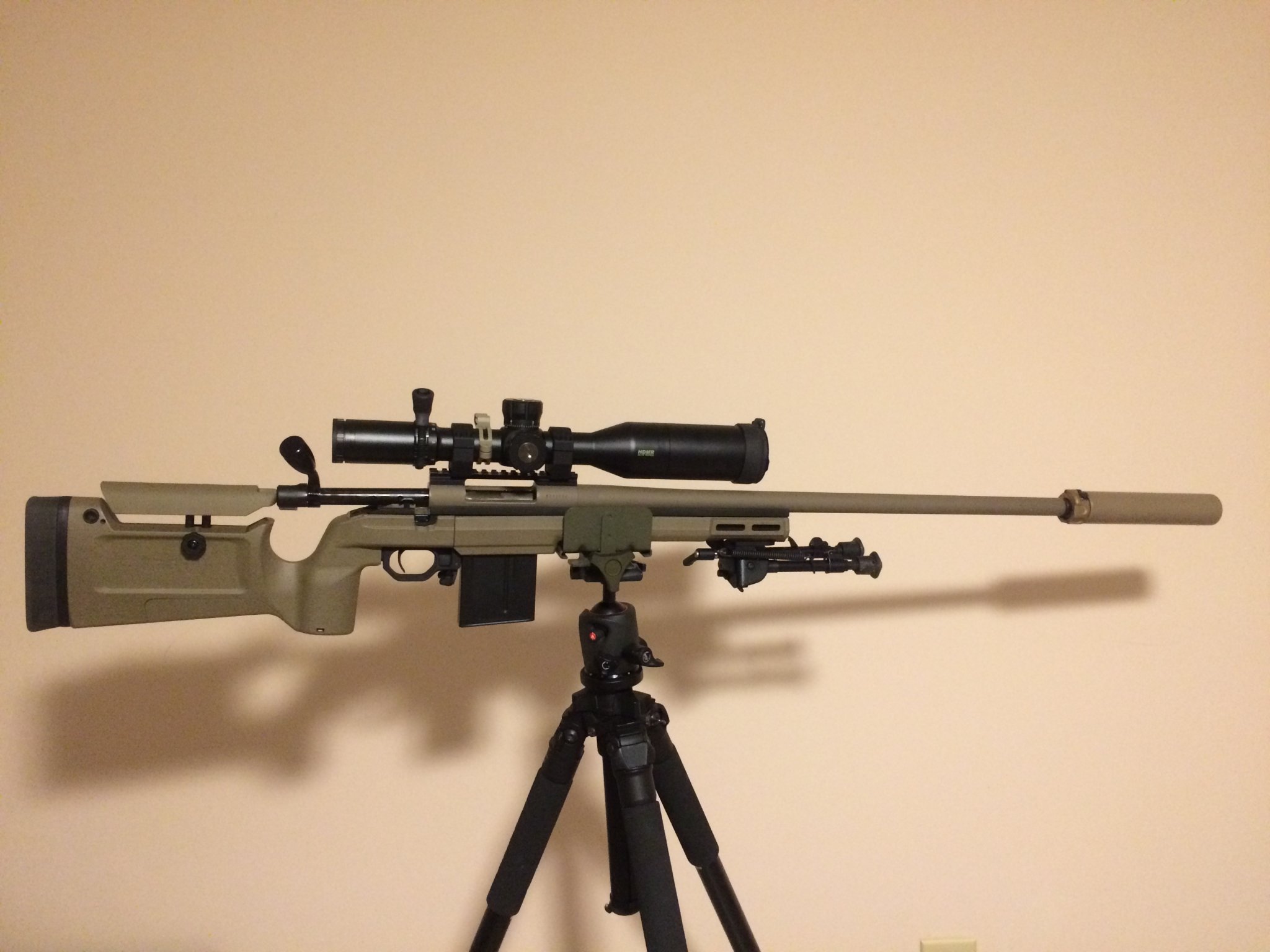

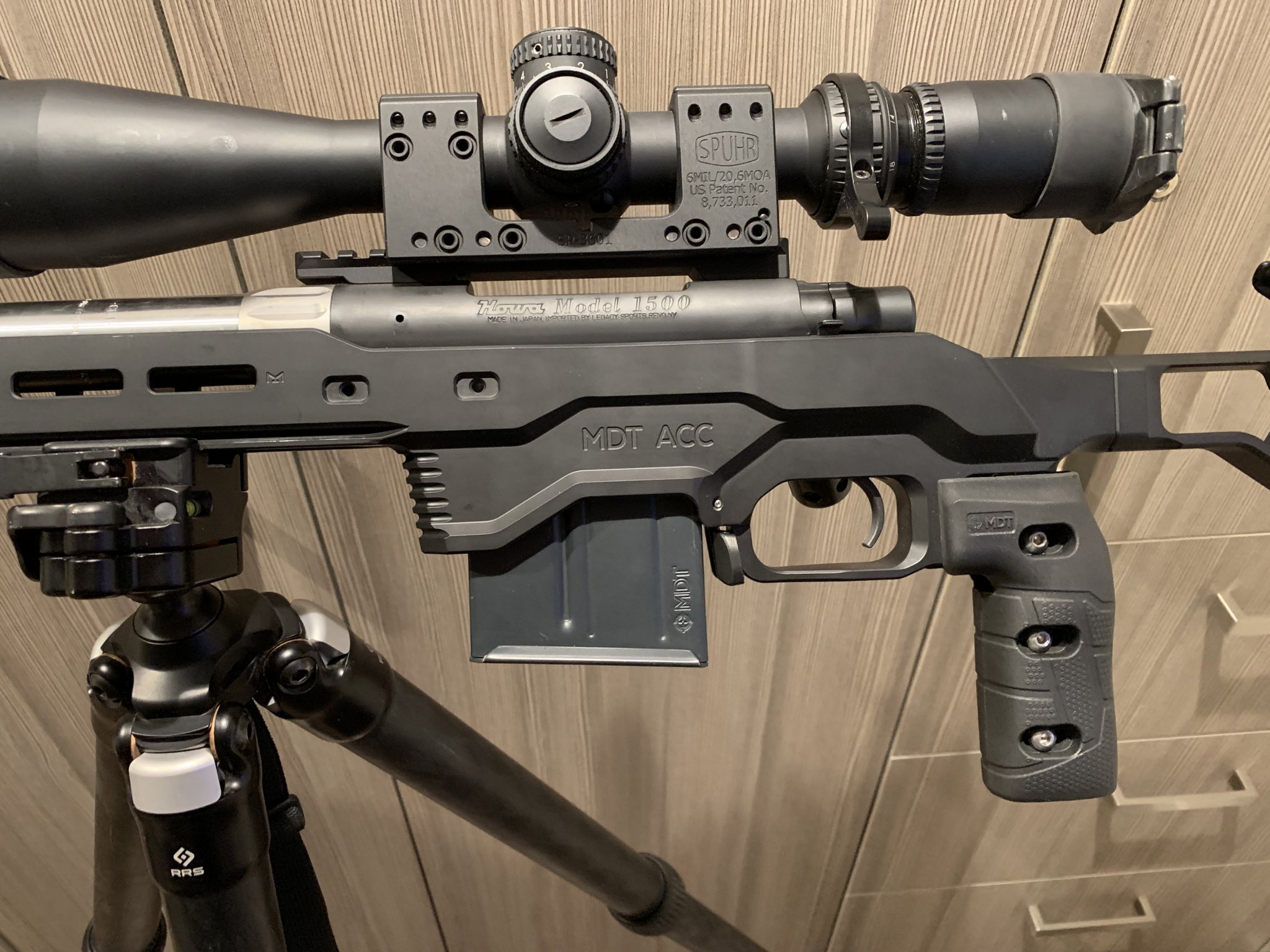

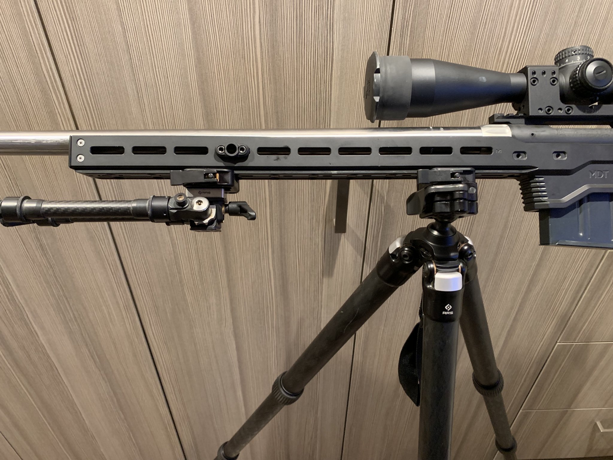

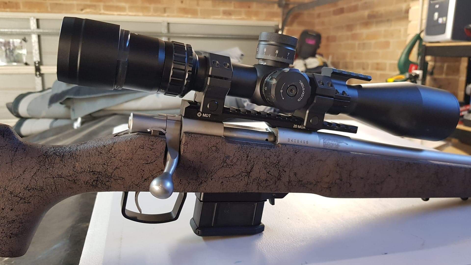

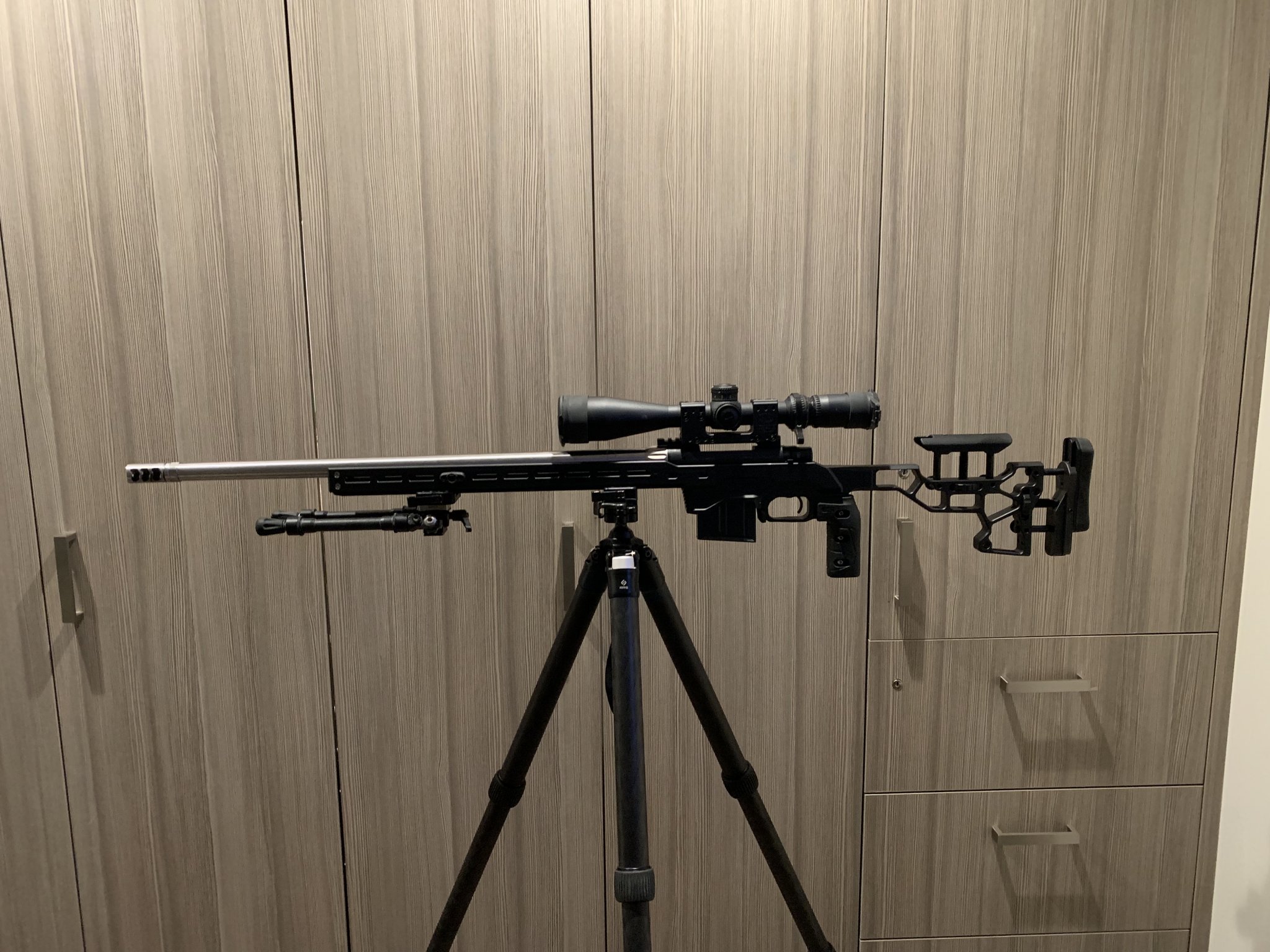

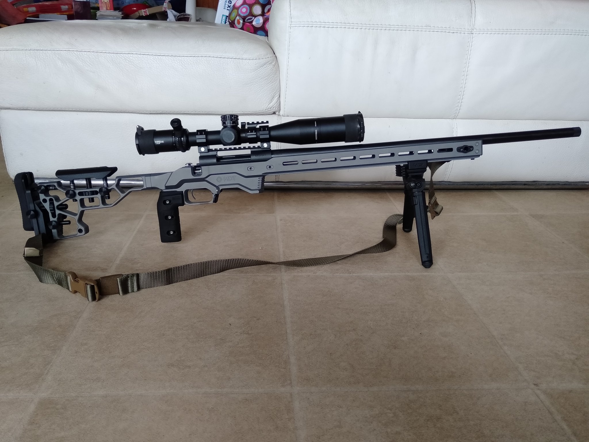

I got my action in an MDT ACC chassis today. @MDT_Josh was a big help through the process. The rifle started life as a Hogue model. How things have changed!
Configuration:
  • Howa 1500 action w/ Tactical Works knob
  • Timney Trigger set to 2lbs
  • Vortex Razor AMG w/ MK lever in Spuhr mount
  • Criterion Tapered Target barrel
  • MDT ACC Chassis in black with the MDT vertical grip
So far, I’ve only dry-fired it from the tripod since it got the ACC (after the Hogue it was in an MDT ESS). I like the vertical grip a lot. The length of the chassis is great, and I love the ARCA rail.

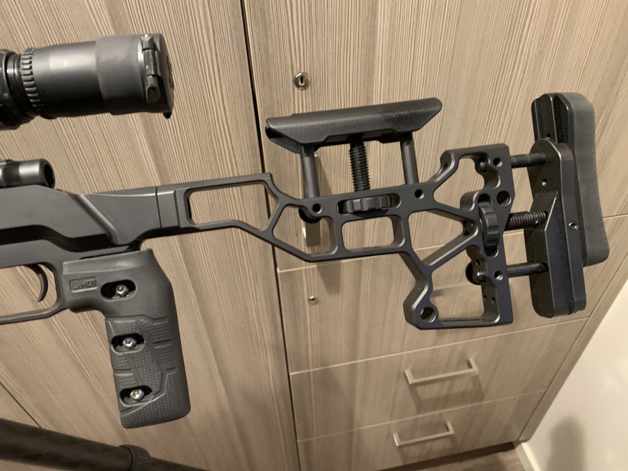

I posted this in another thread because I didn’t realize this was here:
Configuration:
  • Howa 1500 action w/ Tavtical Works knob
  • Vortex Razor AMG w/ MK lever in Spur mount
So far, I’ve only dry-fired it from the tripod. I like the vertical grip a lot. The length of the chassis is great, and I love the ARCA rail.
View attachment 7015077View attachment 7015078View attachment 7015080

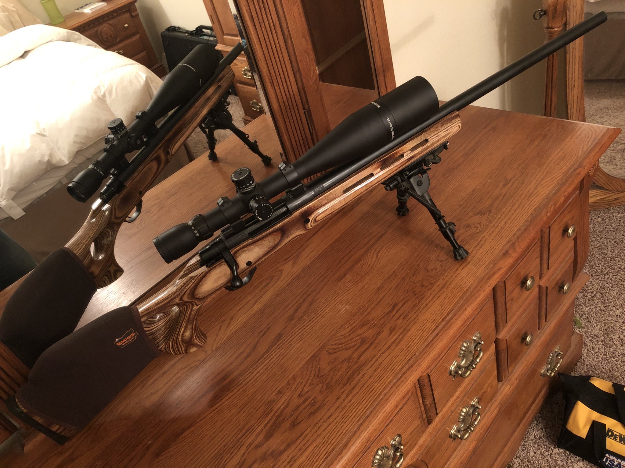

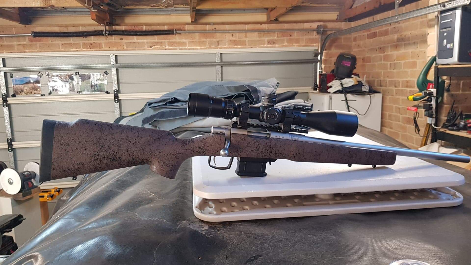

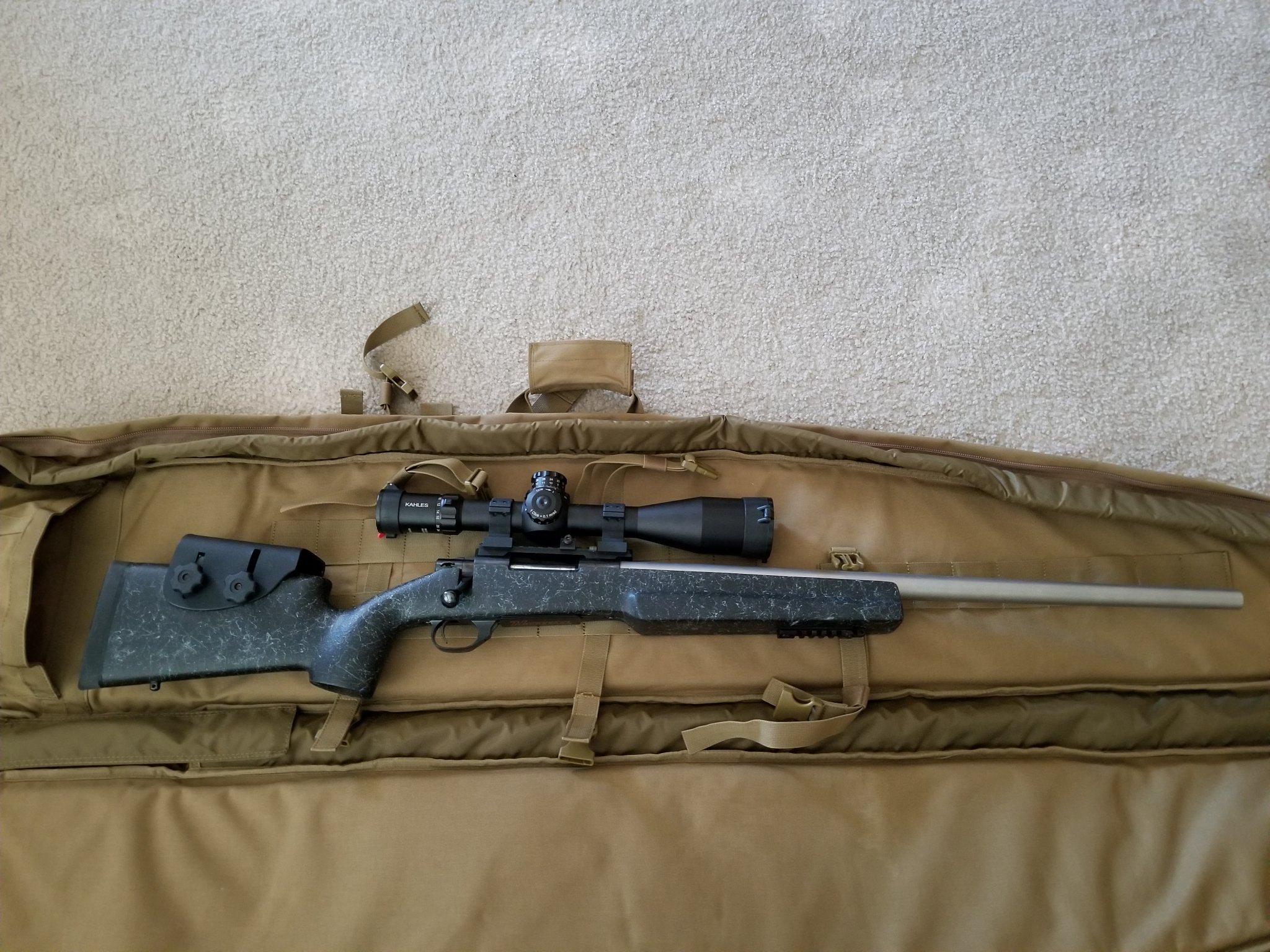

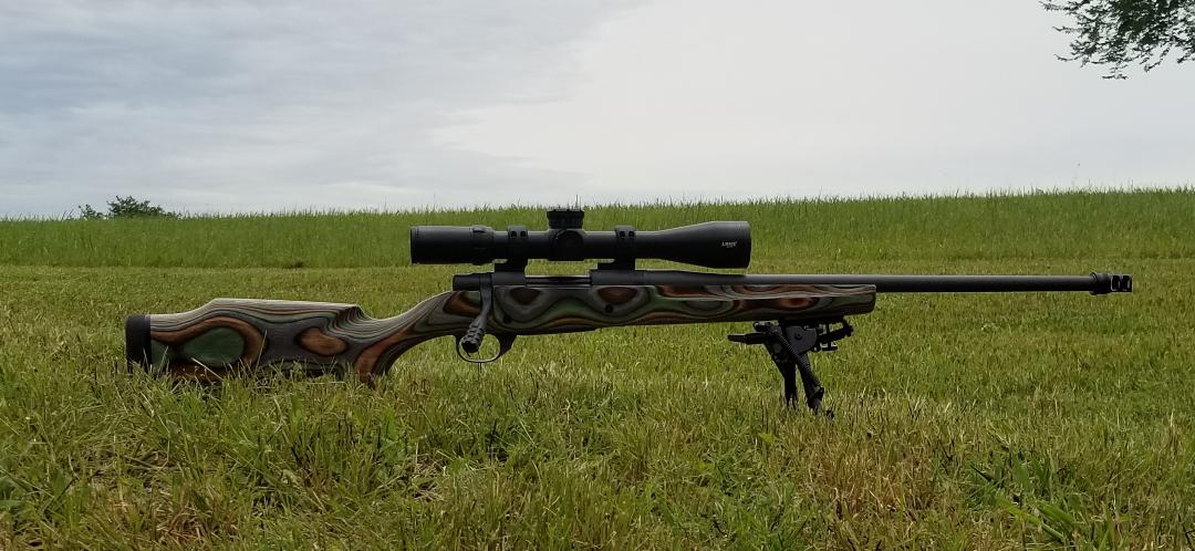

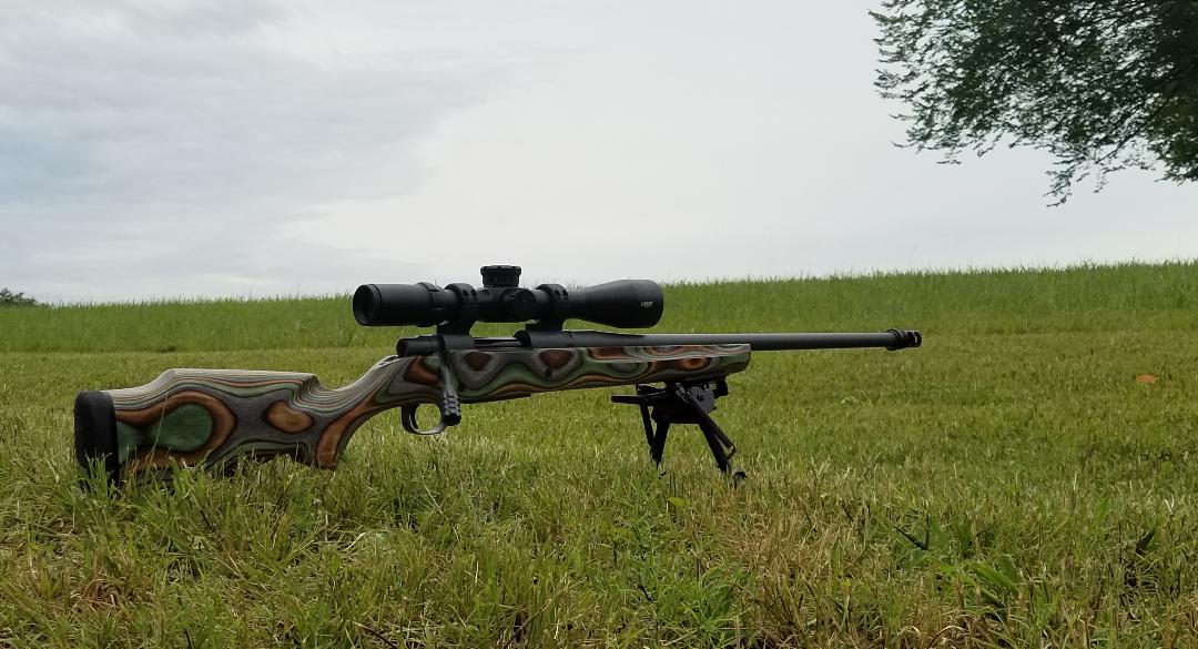

Howa 1500, barreled action (in .308) purchased from Brownell's
Brux 8-twist #3 contour cut to 22" and threaded 9/16-24, chambered in 6mm Creedmoor
Bugnut
Bolt handle threaded by LRI
Glades Armory bolt knob
Factory bottm metal
Factory trigger modded to break ~1.75 pounds
Cerakote (Elite series Concrete) by Alamo Precision
TBAC CB brake/mount
Boyd's Prairie Hunter stock in Ripple Timber
DNZ low Hunt Masters rings (coated in Brownell's Aluma-hyde)
Bushnell 4.5-18 LRHSi
Home-done bedding w/ JB Weld

A GLADES ARMORY bolt handle?
When did you ordered this?
Did you have problem with this company lately?
I'm asking because I ordered 2 bolt handle from them last month and still didn't received them…
After 1 week I ordered, I contacted them to an update and they told me it was frequent to wait up to 3 weeks since I'm from Canada and custom could retain the package….
I said OK, but at the forth week, I contacted them and no response then!
So for now I look for people like me who had problems with this company...
Thanks for taking the time to share you experience with this company.
Martin from Québec
I had problems ordering a glades armory
Martin from Québec
I've had the knob on the shelf for awhile now. Unfortunately, the service that you're describing seems to be the experience that most folks are having with Glades these days... which is really unfortunate, because I like their products a lot.
I'm sorry I can't be more help.
Thanks for your reply!
That confirms what I thought.
Have a good day!
OK... Update:
I just received the 2 bolt handles that Glades armory shipped to me 4 weeks ago. (I'm from Canada)
Both are for CZ 455.
I installed one and I can say the machining is not exactly like the original CZ.
I had to file down a little ramp on the handle so my bolt could slide on that ramp and fully open it...
Without that little correction the bolt would cycle but with some grit in it...
It is not perfect but it will do the job.
Should I have paid that little extra to get an anarchy bolt handle? Yes!
Martin from Québec

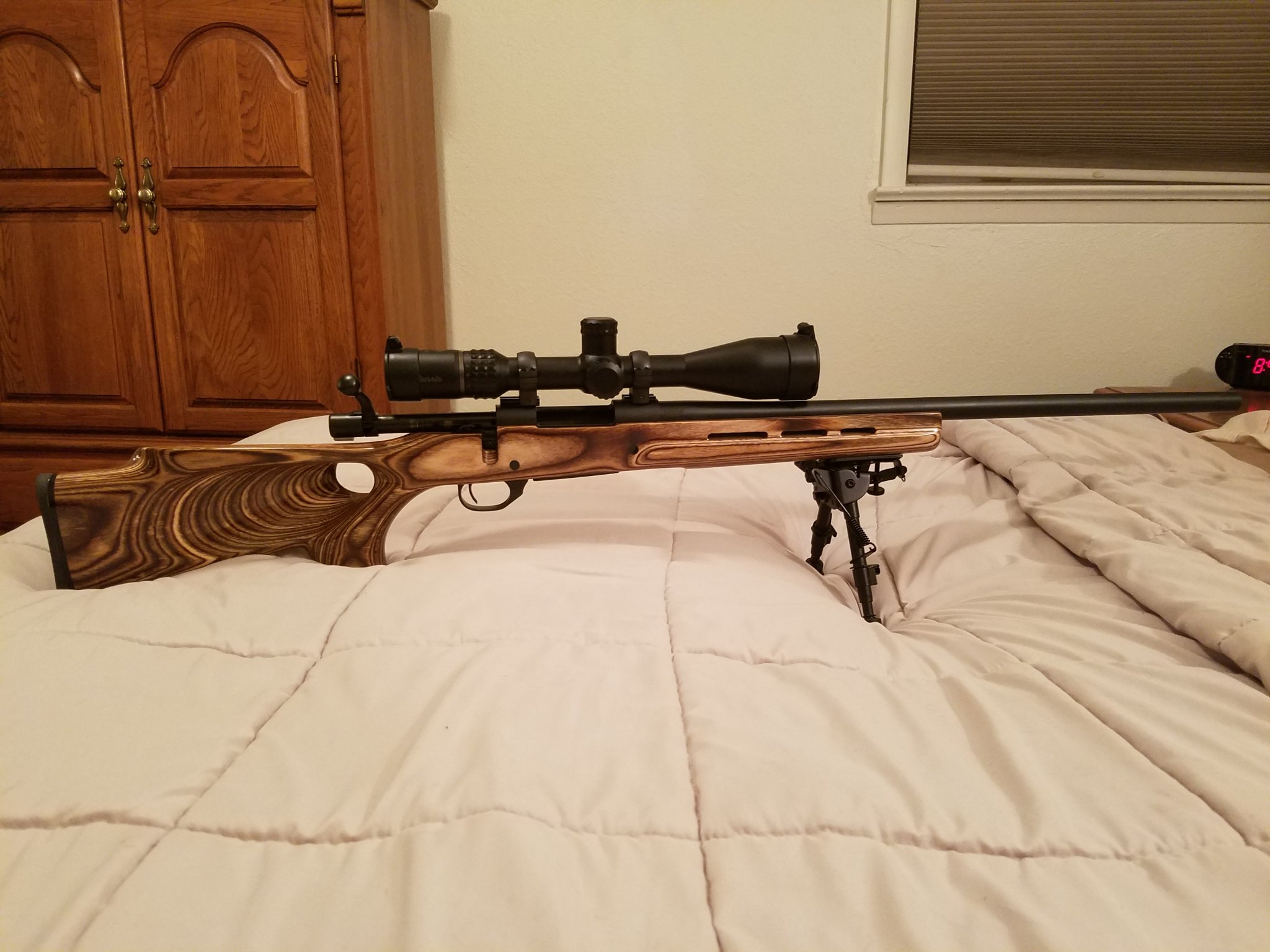

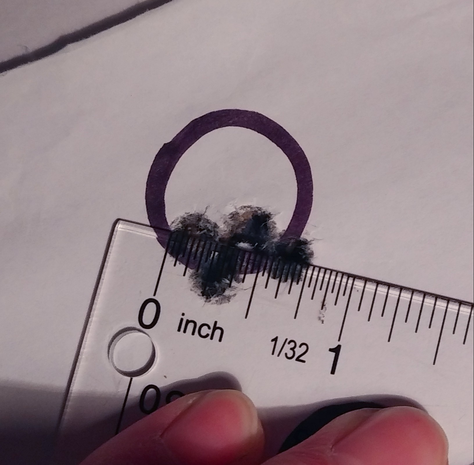

I'd say that would be the ammo of choice. Good shooting. I've got a Bartlein barrel chambered in 6.5 Creedmoor 1/8 twist, 5R, 26" and 3B contour threaded to fit a Howa action. Can't decide which one to tear down and put it on. I've got a 20" HB 308 and a 6.5 Creedmoor with the slim sporter barrel. I like the Howa actions better than the 700's. Longer magazines and the integral recoil lug with the flat bottom. Decisions, decisions.......

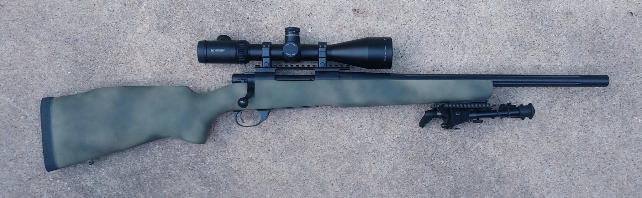

I bought my Howa barreled action from brownells.com. It's a .308 with a 24" #6 contour. I have it topped off with a Leupold Mk6 3-18 in Leupold rings and EGW 20 MOA base. It has a PT&G bottom metal that I really like a lot. It extends past the stock about a half inch and you can push against barricades with it. I had a "smith" bed the action in a Bell and Carlson stock he messed up and the barrel isn't straight in the barrel channel but it is free floating. Lastly I had him thread the bolt handle for a tactical knob and it turned out OK at best looks wise. Wasn't happy with his work at all. I recently bought a spring kit from "gunbloke" on ebay. I thought I would like a lighter trigger but turned out I was wrong and already threw the factory springs away?. With that being said I'm not talking down on the springs just my thinking. I get really good results with Magtech CBC Sniper 168gr ammo. For ~$30/50rounds it can't be beat! FGMM is around the 3/4" mark and Prime flirts with MOA. I also get pressure signs with Prime not sure if that's normal. I still have over 2 cases of Prime and I'll buy more once available again as back up. I do reload but 308 isn't my priority when I have time. So far I have around 13-1400 rounds down range with it. I plan to have it rebarreled around the 5k mark with a Bartlein thinking maybe a gain twist but not sure yet. Who knows?!

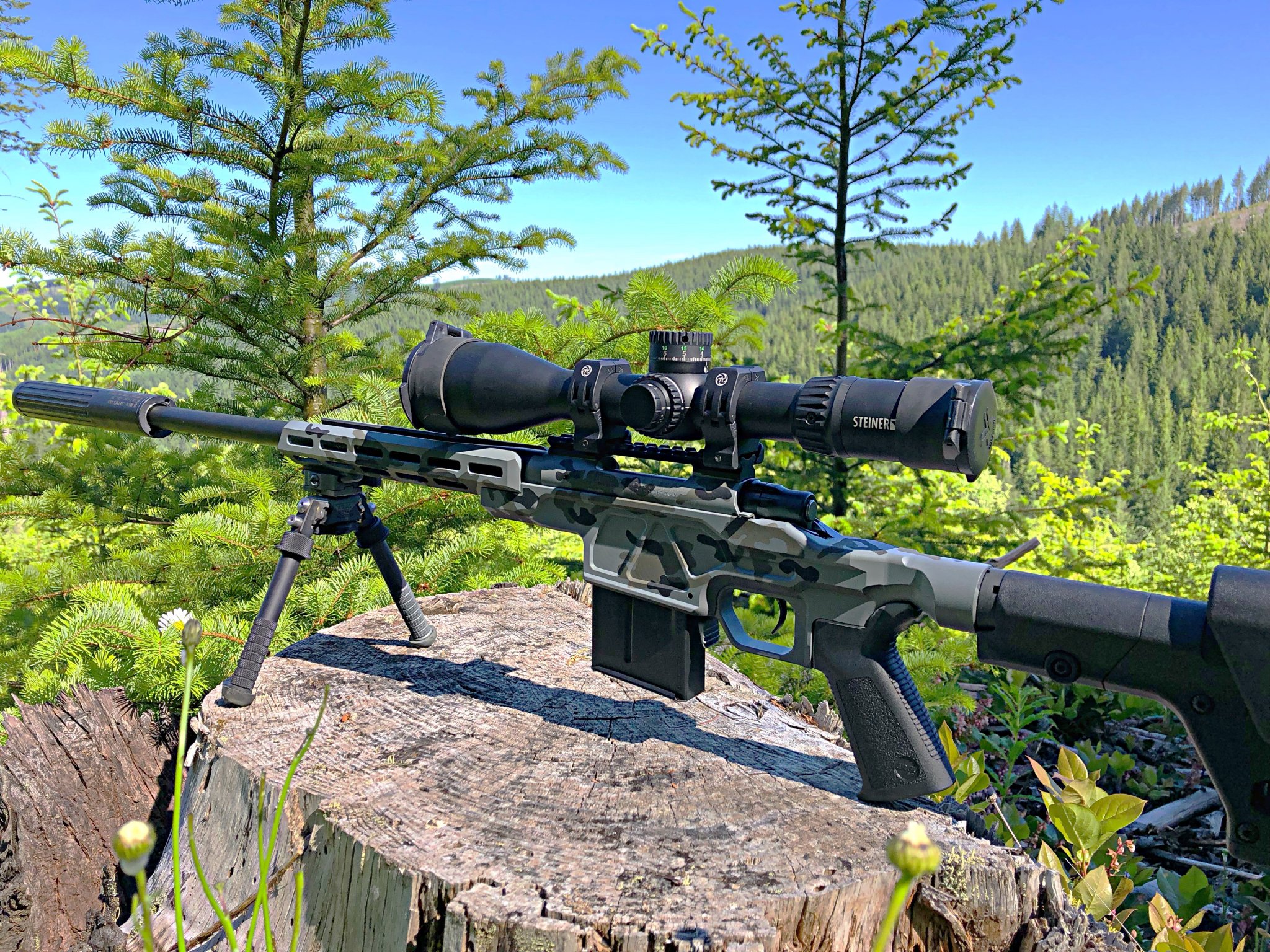

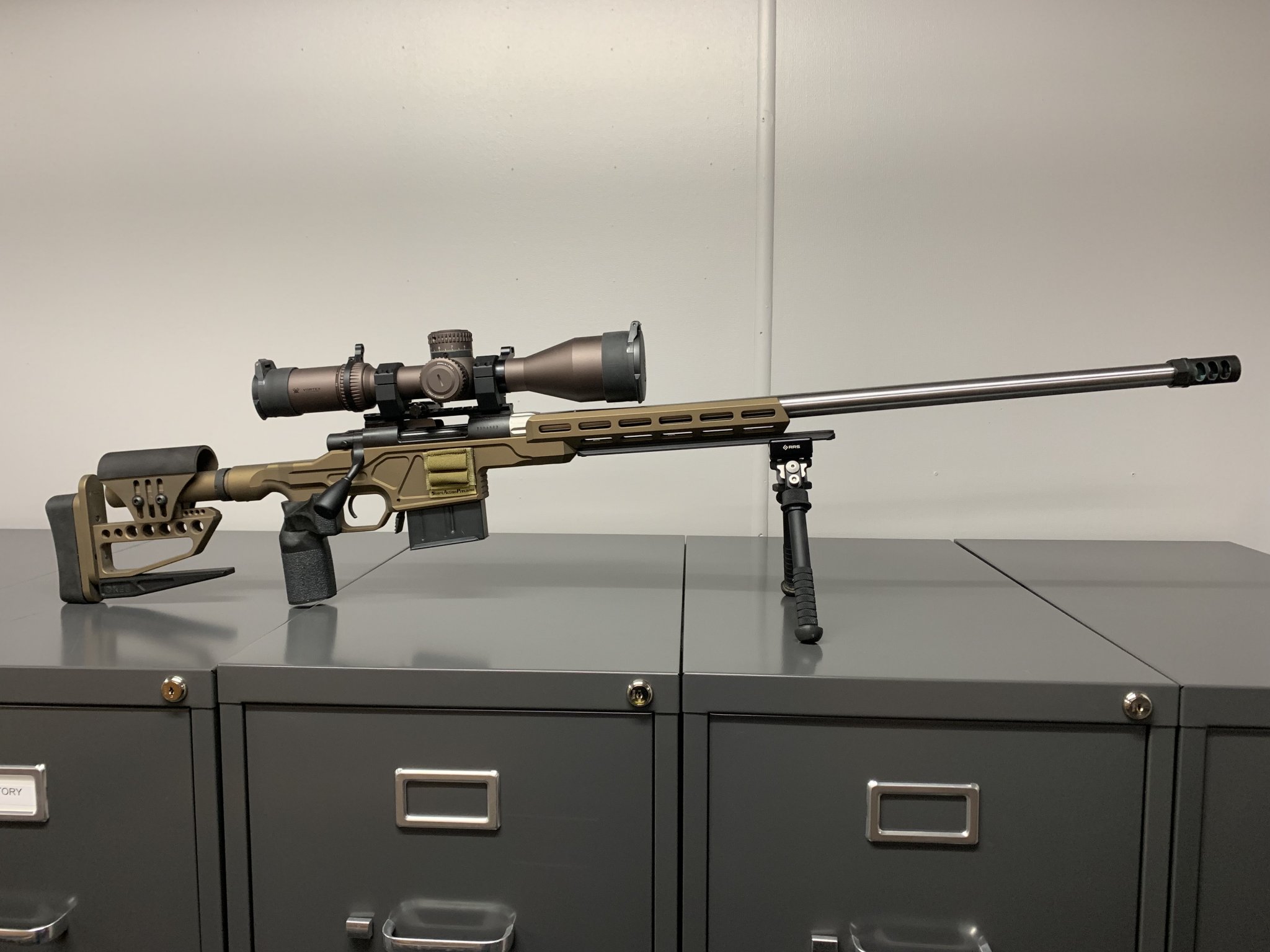

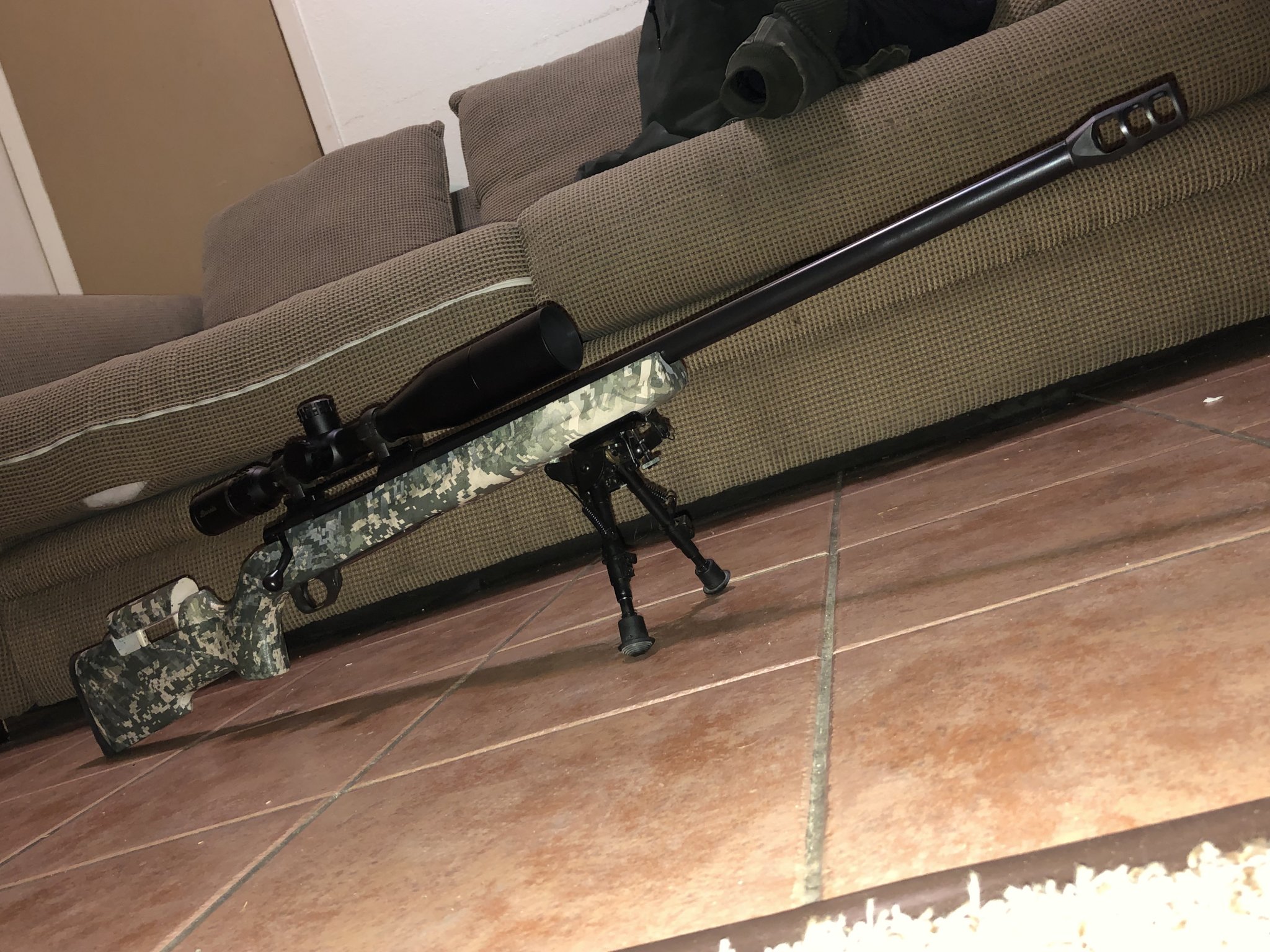

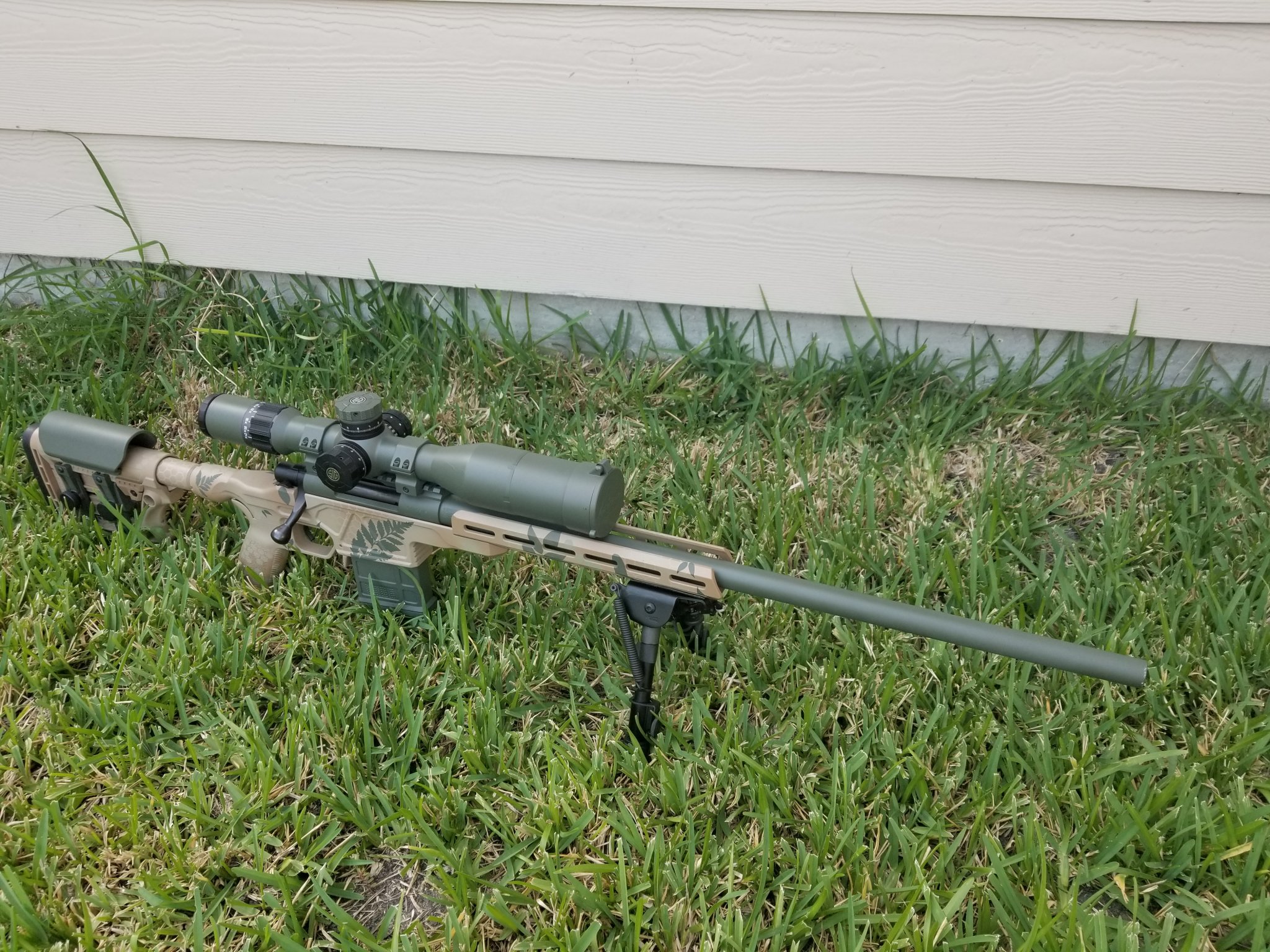

Here’s my Howa 1500
26” 308
AMTAC Sniper 7.62 reflex suppressor
Steiner P4Xi
ARC rigs
NF 20moa base
PRS gen 3 stock
Atlas bipod
Rattle canned paint job
Did you buy it as an HCR and switch out the butt stock? She's looking real good though. Care to post more pics? Also, wondering why you didn't rattlecan everything else?
Yes, bought it as an HCR and just added the stock. I didn’t want to spray everything else. It’s more for looks than practical camo. I just thought the chassis alone was a cleaner look than the rifle being painted.
That’s the best picture I have right now. I will upload more later.

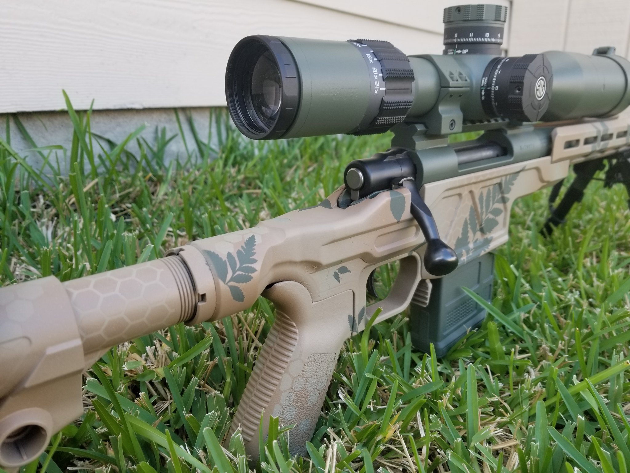

The first time I rattlecanned mine I only did the chassis itself, no pistol grip, butt stock, action, etc. Then I decided to do the whole thing lol.
Bipod isn't painted in pics but it is now...
Regardless, I still like the way you did yours. I've kinda had in the back of mind a multicam pattern for mine but actually committed to it. What paint did you use?
View attachment 7097624View attachment 7097625
I used Krylon brand paint. The multicam pattern was done using stick on stencils from freedom stencils. It made the job super easy to do. The whole thing took me an hour.

I don’t dislike the Luth stock, but the XLR is in a different league as far as adjustments etc. plus I needed the weight to balance out the barrel etc. I like the XLR buttstock and have put them on McCree and HCR chassis. It’s solid, feels substantial, and I was able to get a little shorter length of pull for positional positions. There was just a XLR tact lite stock for sale for ludicrous cheap in the EE recently. If you use the bag rider like mine the difference between the two is minimal.
Is there any wiggle or fitment modifications? The grip that came on the rifle is a little loose for some reason even though the bolt is tight.
I have the MPA grip on two of my HCRs, a Ruger RPR 556 trainer rifle, and a Ruger 22RPR I use for 22 matches. They are tight and wobble free on all of them. FYI the grip is molded for the MPA chassis so the lines don’t match perfectly. I don’t care about it, but if it bothers a person it could be blended.

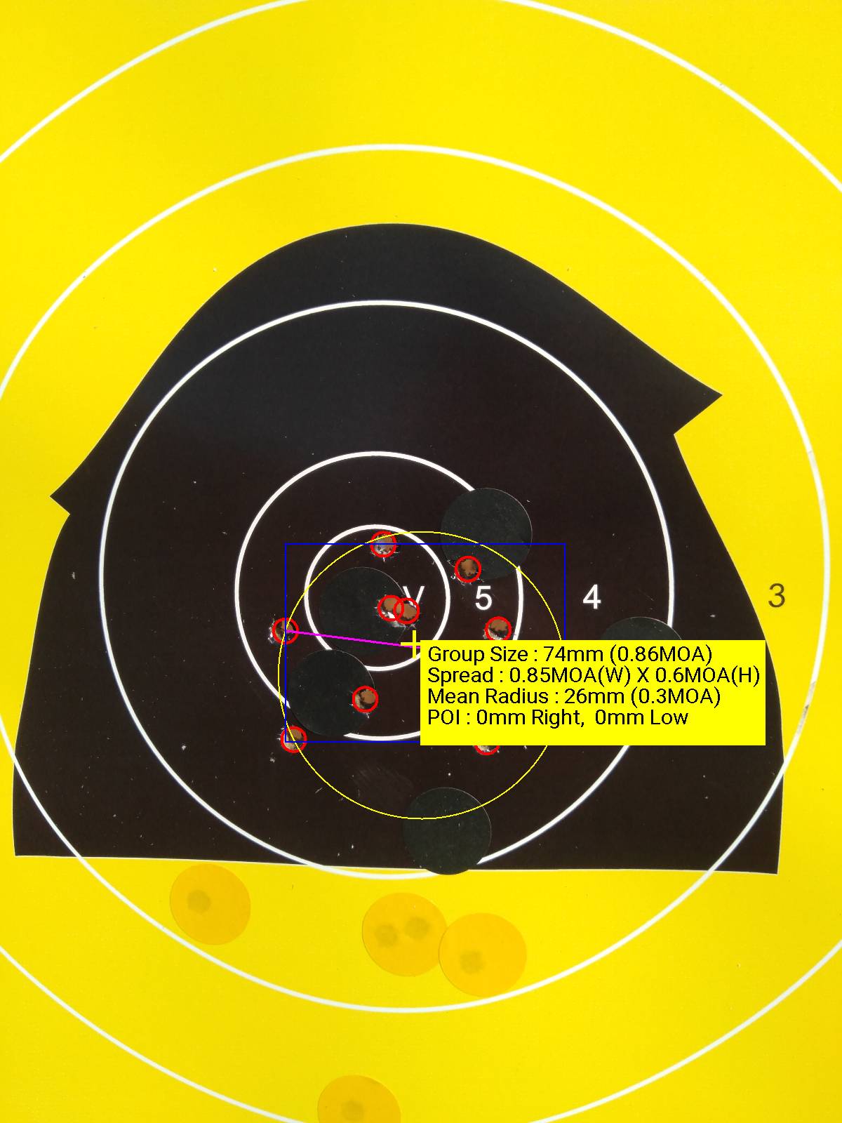

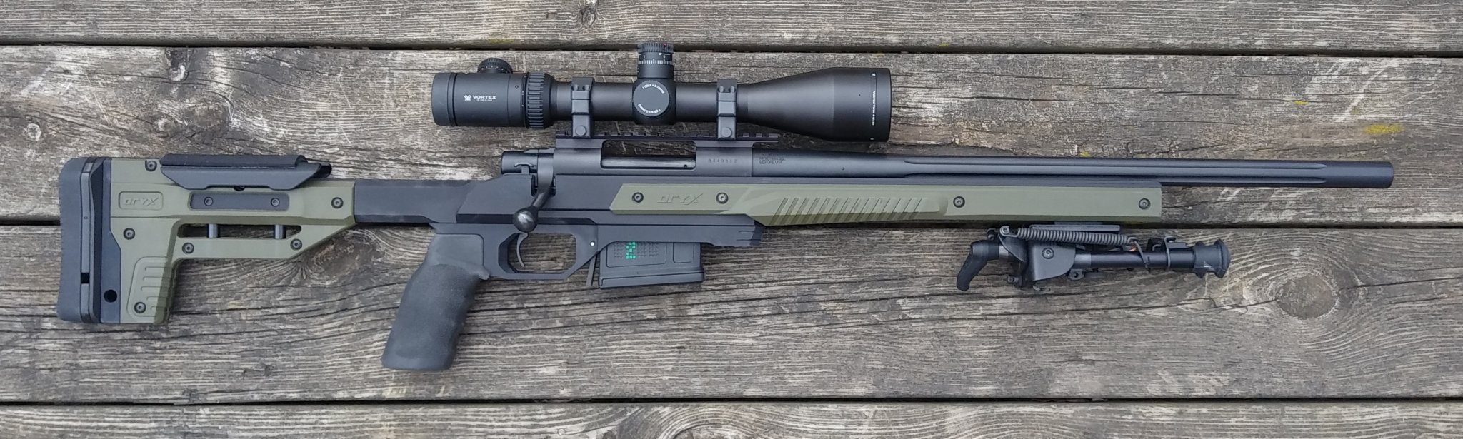

I have two Howa 1500 builds, a 223 and a 6.5 Creedmoor.
The 223 is a 24" varmint in a Bell & Carlson Target/Competition stock, Porter Machine Works (Australian ring maker) rings and did have a PST Gen 2 3-15x44 but now has a Diamondback Tactical 4-16 FFP. It was being used for everything from rabbits, roos and foxes to our local PRS style matches.
The Creedmoor is in an MDT ACC chassis with their vertical grip and interior weight kit. Magpul bipod with Area 419 clamp and barricade stop, Insite Arms Heathen muzzle brake and Shadow Tech sling. I have the the 3-15 PST also in Porter Machine Works rings fitted to this rifle now.
It is shooting the 147 ELD-M at 2700fps pretty well. This was a 10 round group at a recent match, 300m prone with no rear bag and 3 second exposures
View attachment 7099920View attachment 7099922

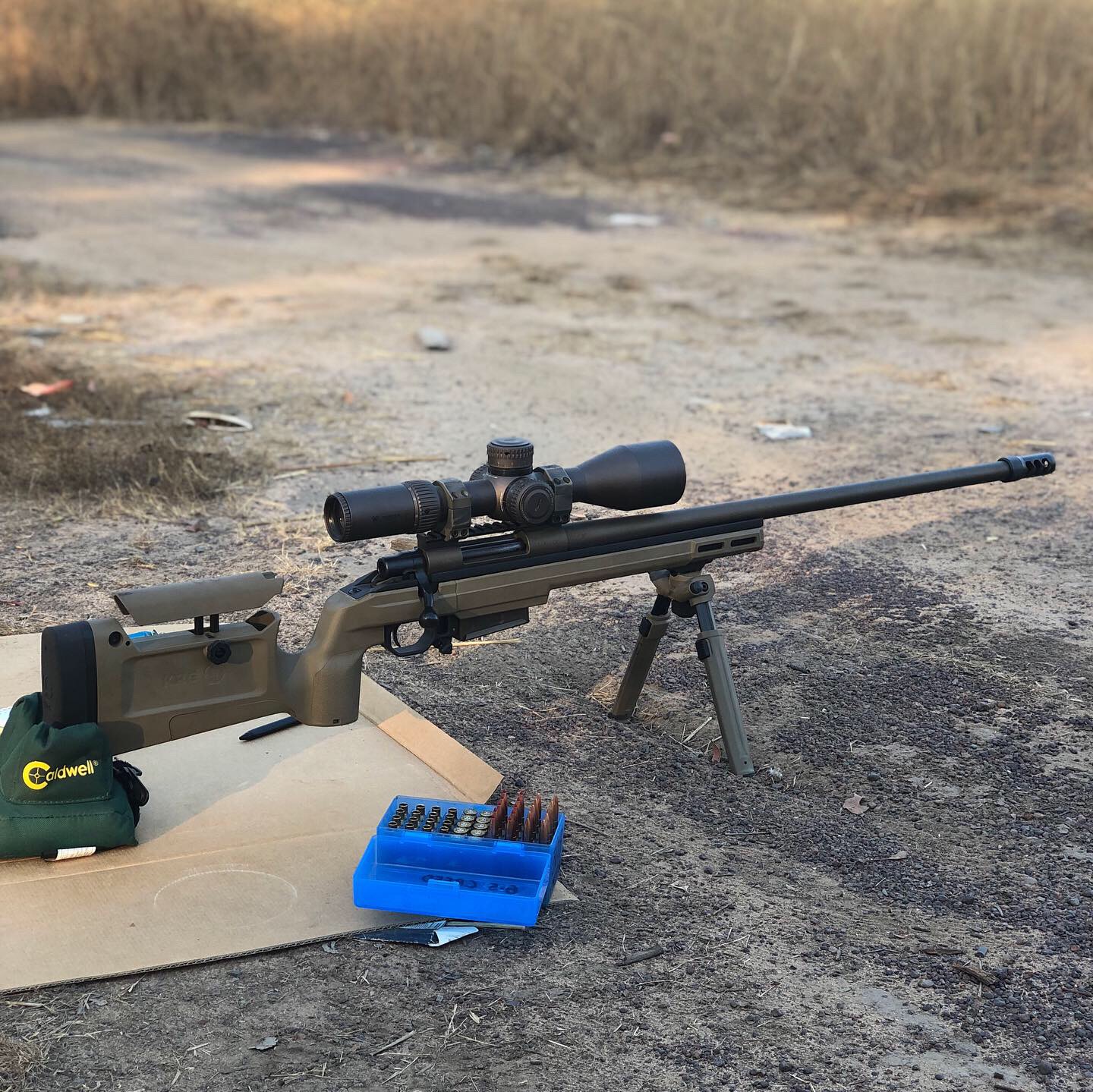

I've decided to build a Howa 1500/KRG bravo. I ordered the KRG bravo in FDE, warne 20moa scope base, AAC muzzle break is on backorder. 6.5CM barreled action will get ordered from brownells when my FFL gets back from vacation. Undecided on scopes. I can get a decent mil discount on Vortex, but I might wait until the 18th for their new product release to come out.
I have a larue/harris bipod that works on 1913 rail. Should I get a mlok 5 segment 1913 rail in metal for it? Or is there a better option for bipod mounting?
Update: barreled action arrived today. Stock tomorrow. A week for the mag well, thanks brownells super-slow-shipping.
