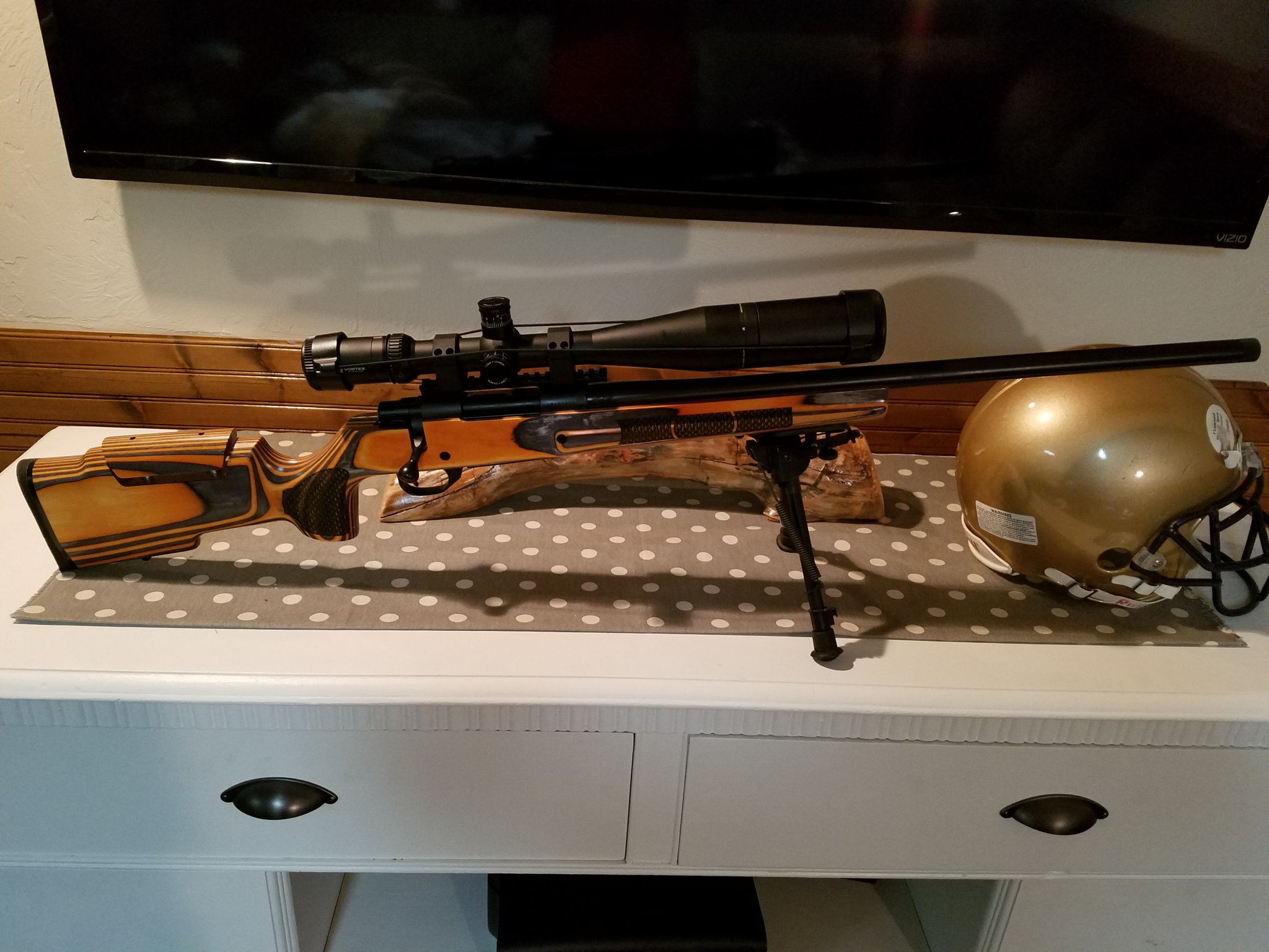

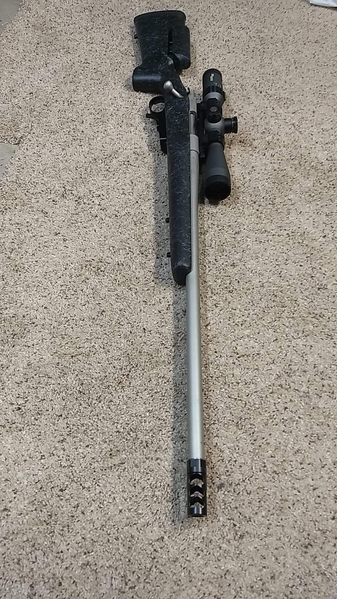

Here's mine. It's a 22-250 with a 20 inch barrel. Dropped it into a Bell and Carlson varmint stock, DNZ mount, and an Athlon Talos BTR. Still haven't had the chance to shoot it yet.

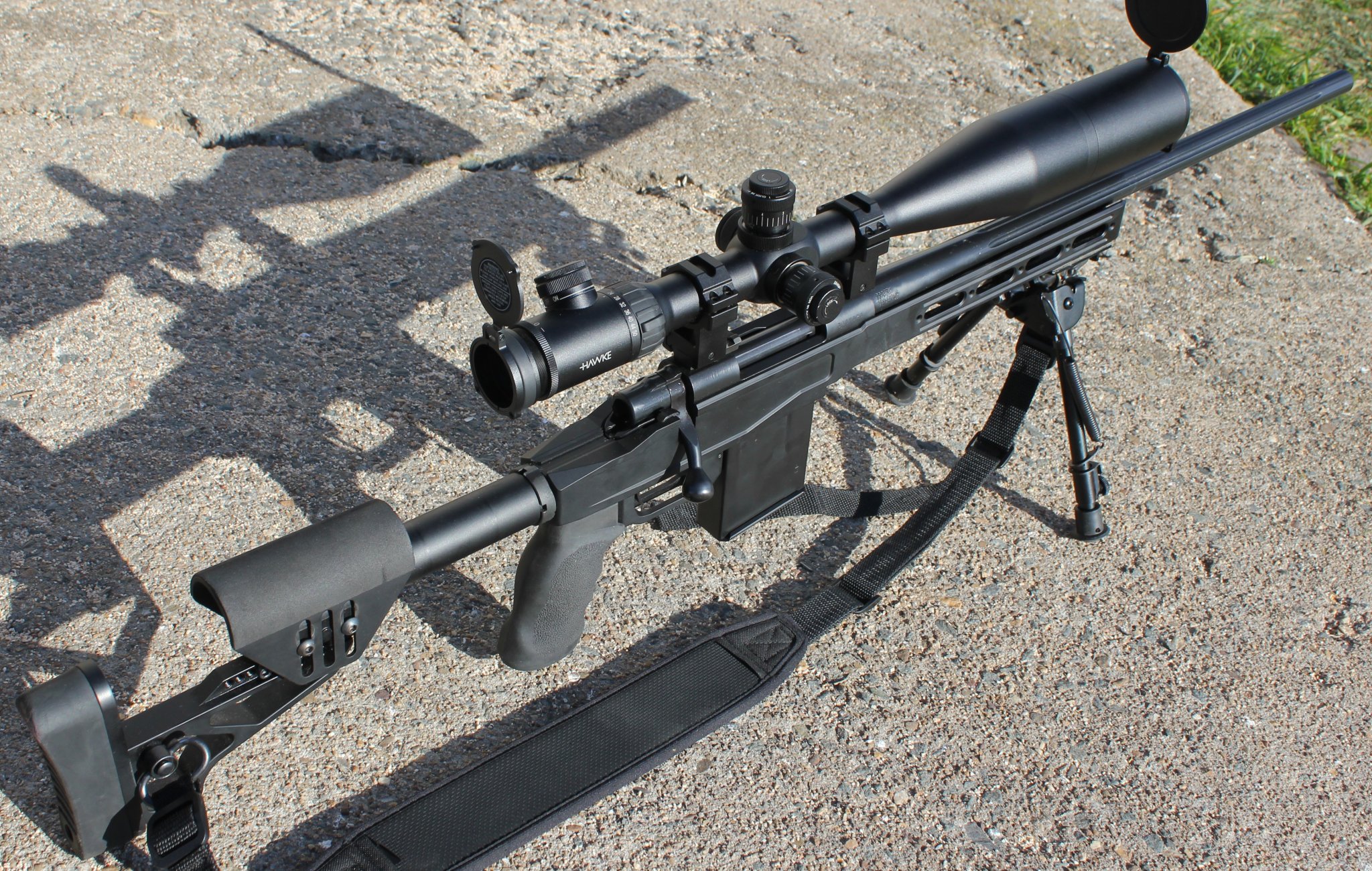

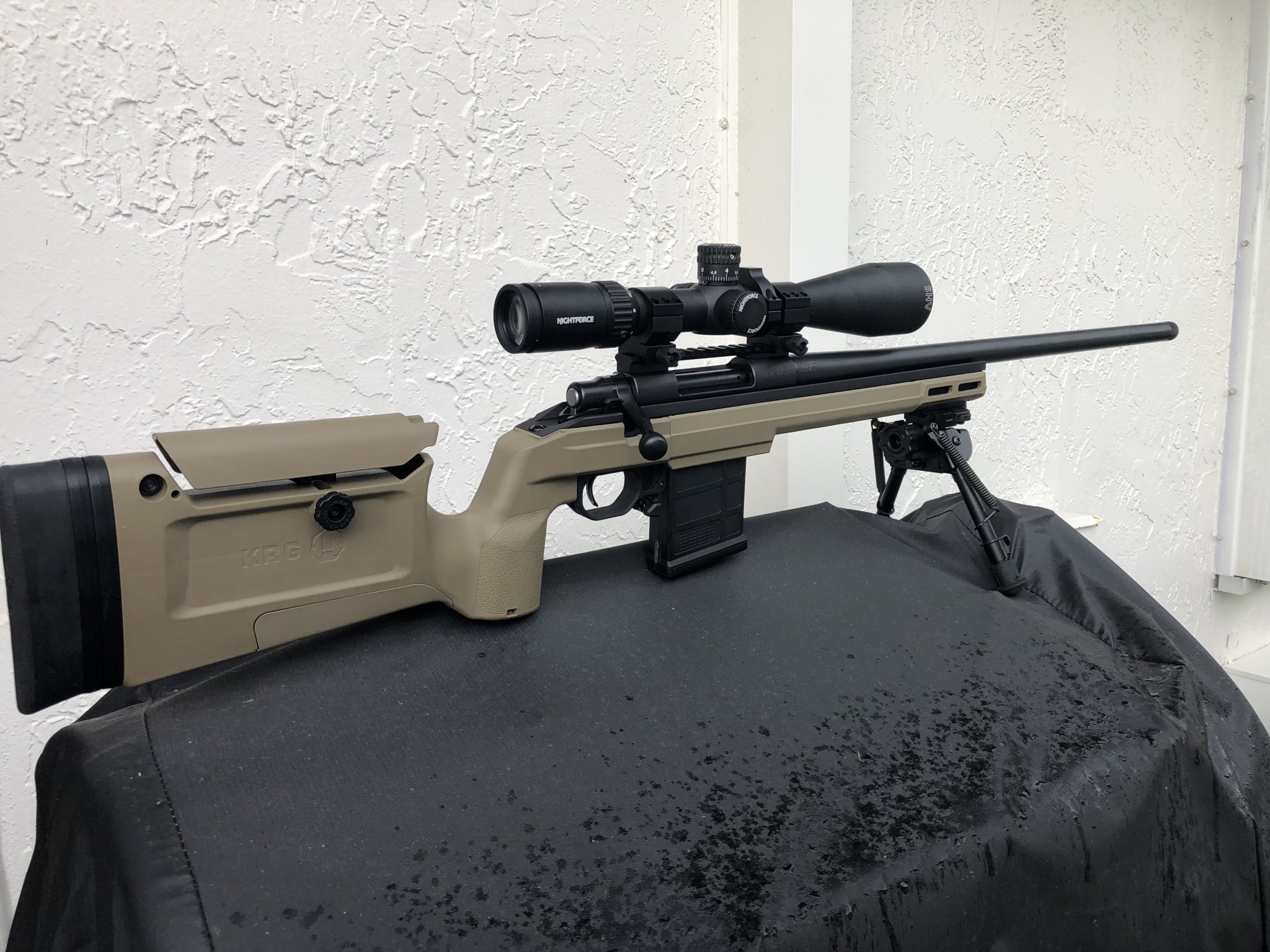

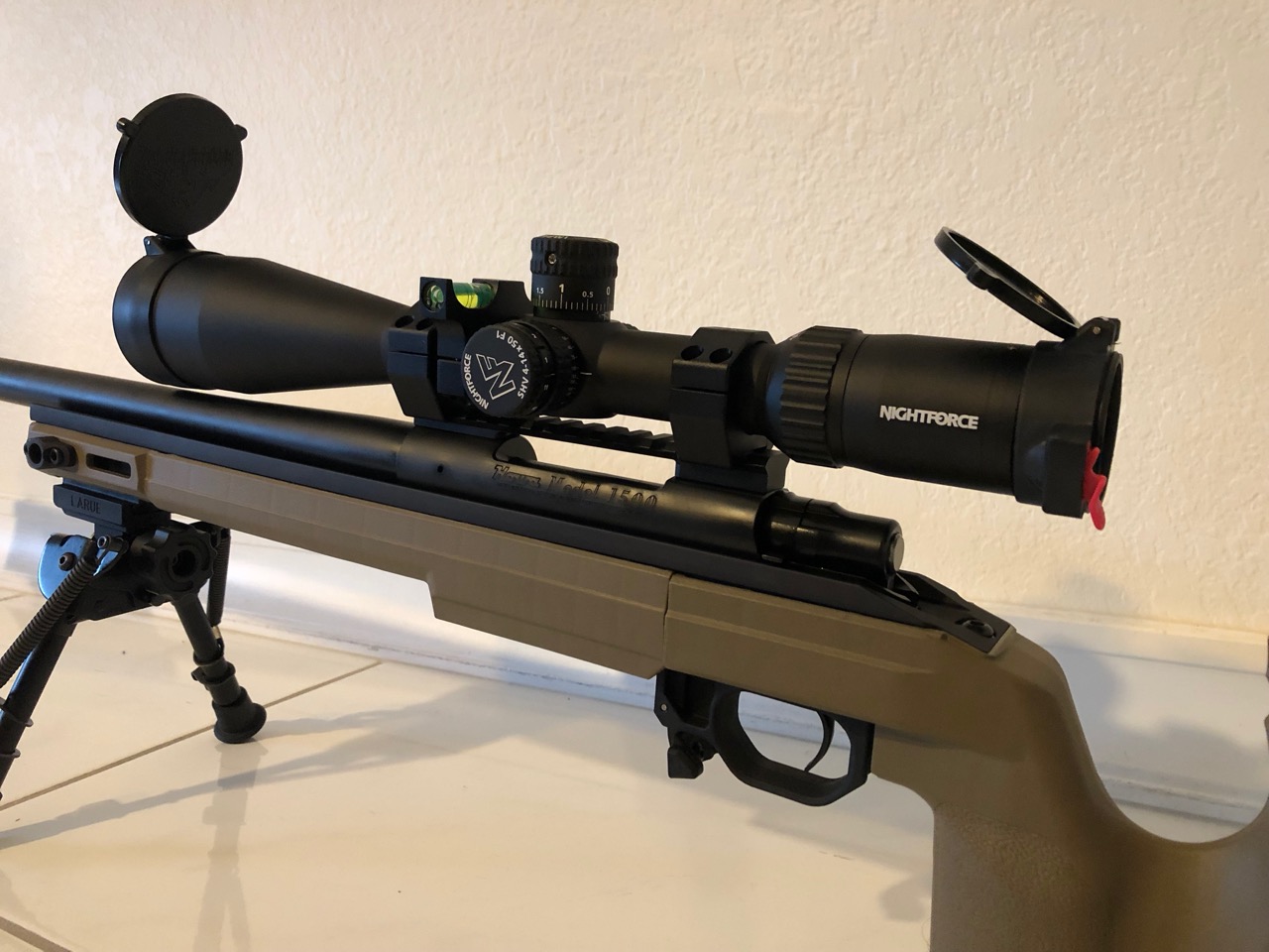

Got the SHV F1 scope installed today. KRG bravo stock. Clipped 1.25 coils on trigger spring results in 1lb, 11oz pull. AAC muzzle break on backorder.
I wonder if my medium rings are too tall? Also I just realized my ring bases are facing right- should the screws be on the left side?

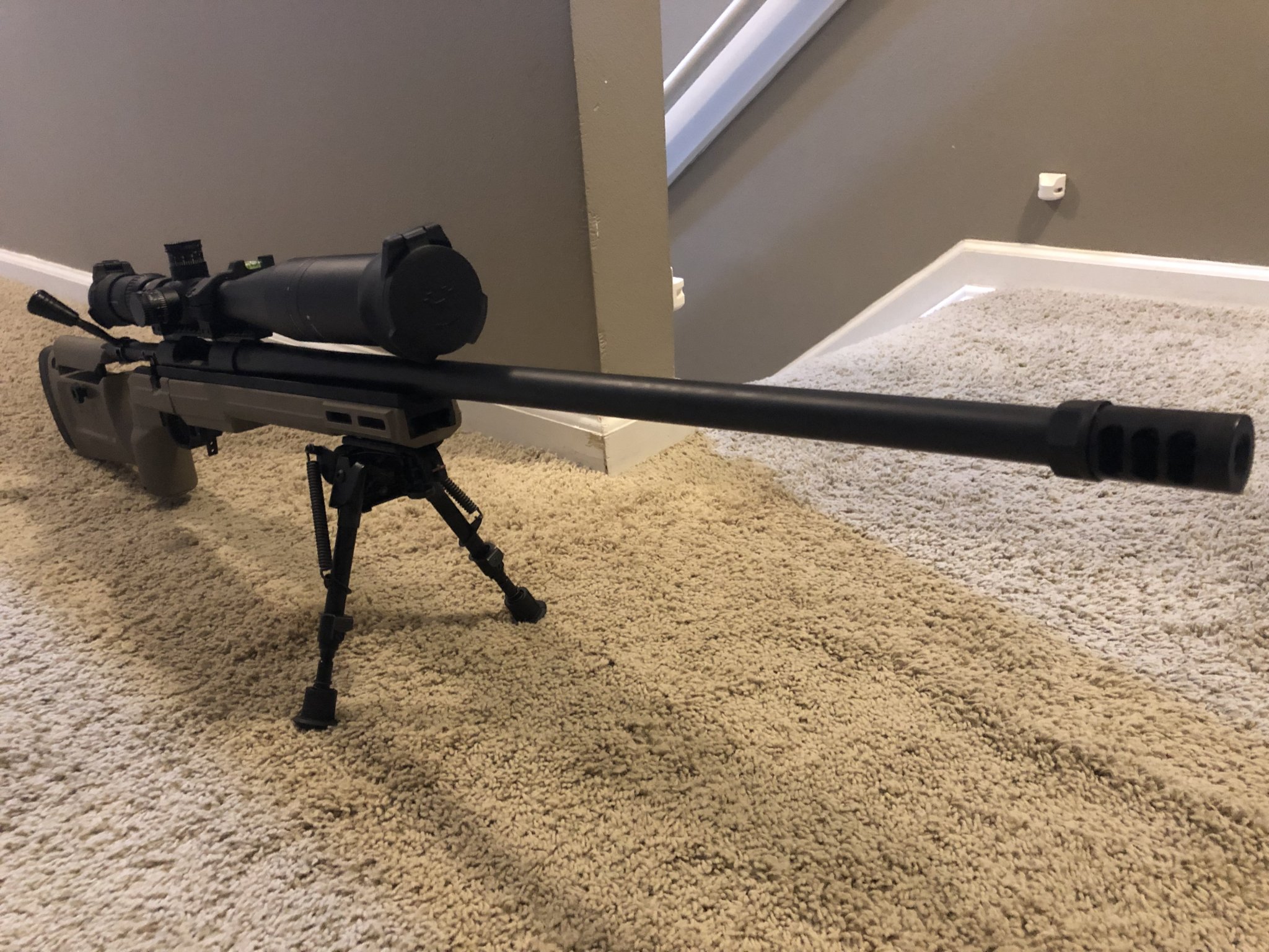

The Coyote Hammer

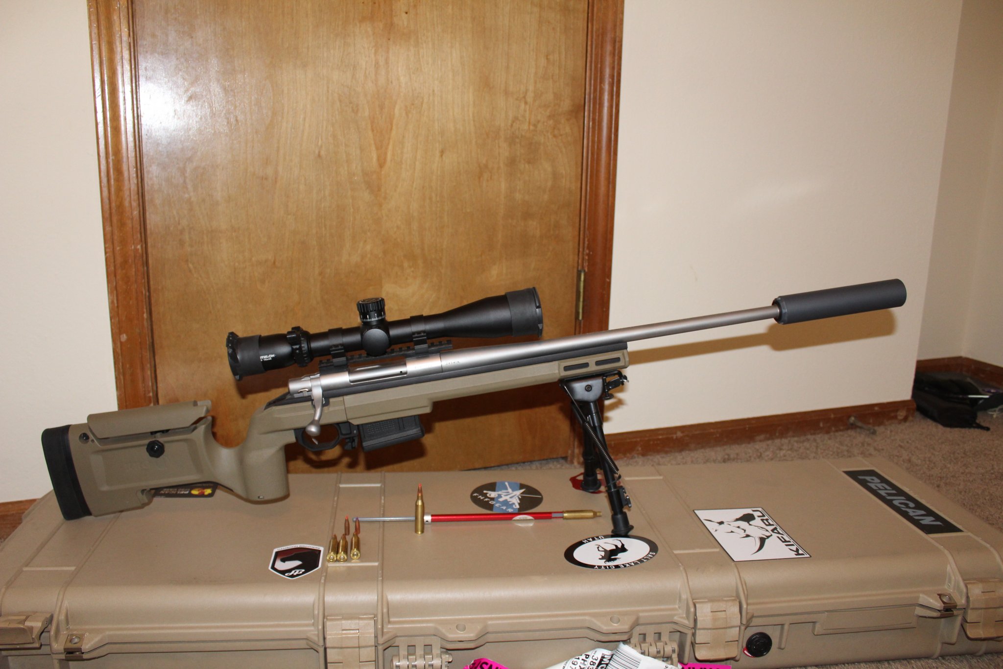

I can finally say its done. Used to be a black rubber stocked stainless 1500 in .243. Killed many coyotes with it. Hated the original stock and went with a chassis and it all went downhill from there.
Howa 1500 .243 stainless
22" 1-10 twist #2 Sporter barrel (cut down to 18.5" by GAP)
Athlon Midas Tac 4-16x44
KRG Bravo chassis in FDE
7" OAL Form1 Suppressor, 90% Ti 10% SS
Griffin Minimalist taper brake
This is my go to hunting gun as of the moment. I Just got the tube back from cerakote today so I am excited to shoot it in its shorter, quieter configuration. Also starting to reload as well, I'm gonna try and see how fast I can push 70gr Nosler purple tips and 87gr V-max out of this short barrel.

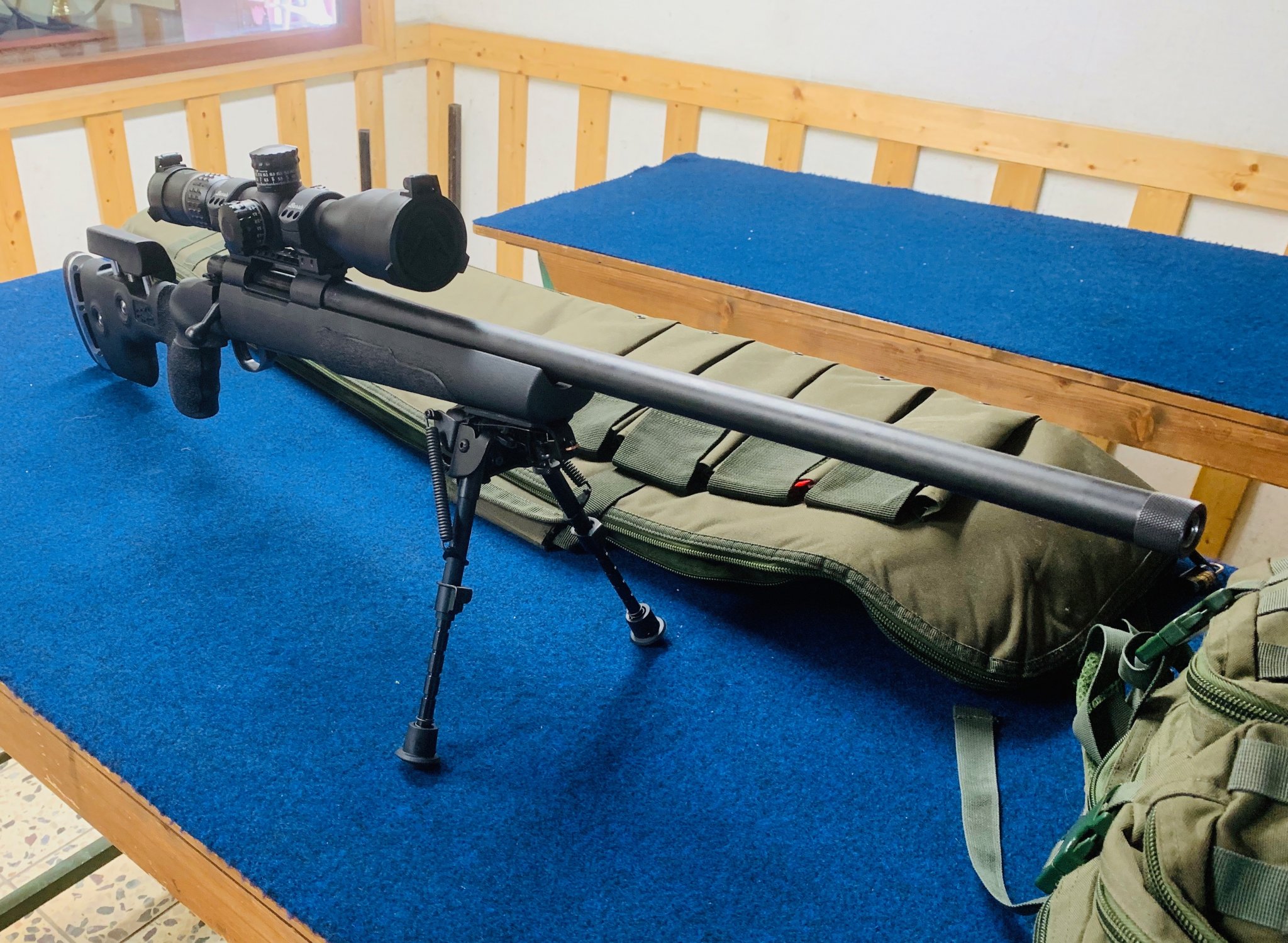

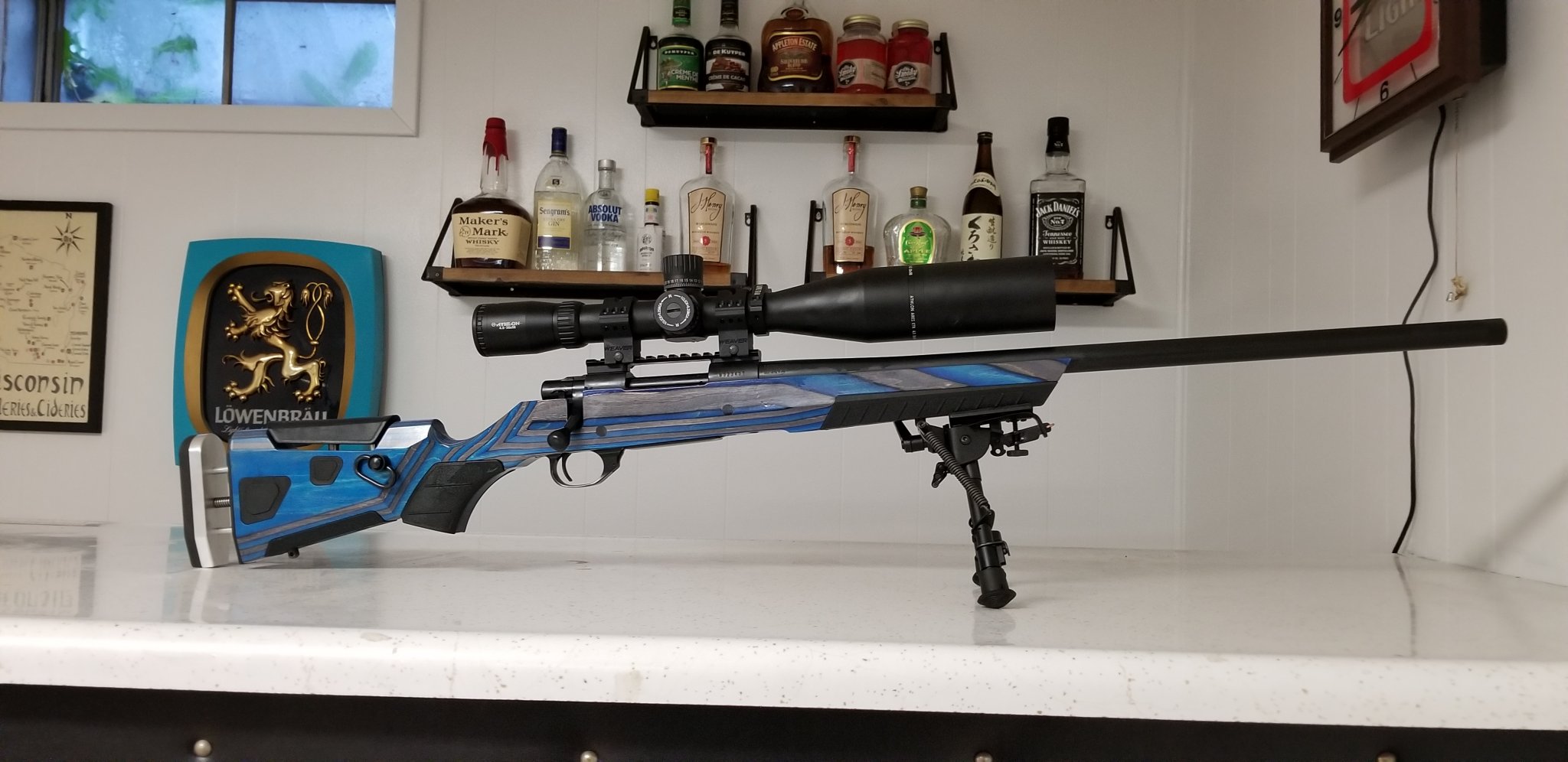

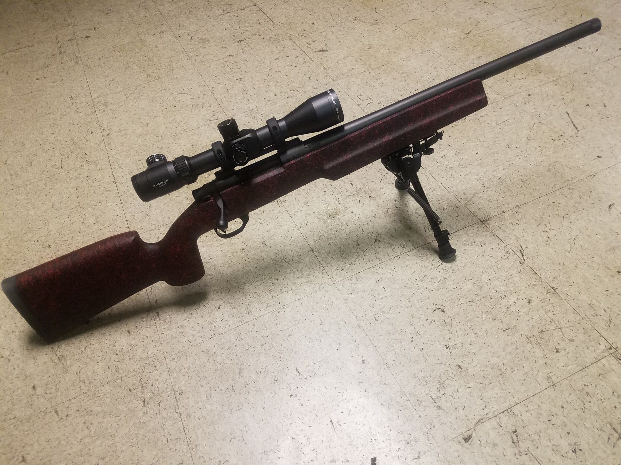

I'm a new shooter but i'll post up my build. Howa 1500 24" 6.5 Creedmoor Bull barrel. Boyds at One Sky stock. Athlon Ares ETR Scope.
In 1 range session I went from shooting 3 inch groups to .8 inch groups. 5 shots at 100 yards. Next range session I kept 11 out of 12 groups sub moa and even got a few half moa groups. Works for me considering it's my first bolt gun.

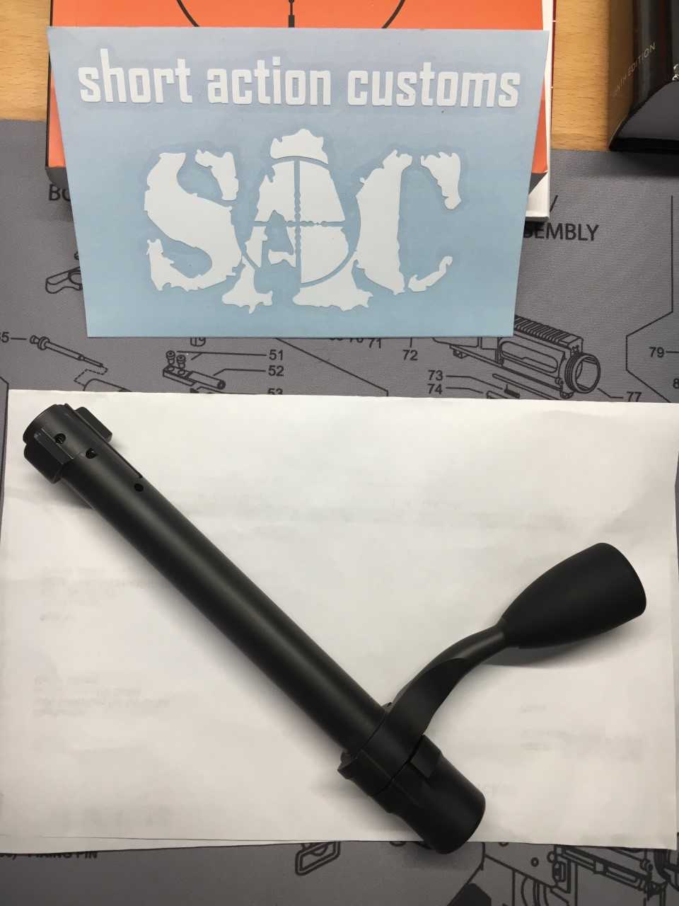

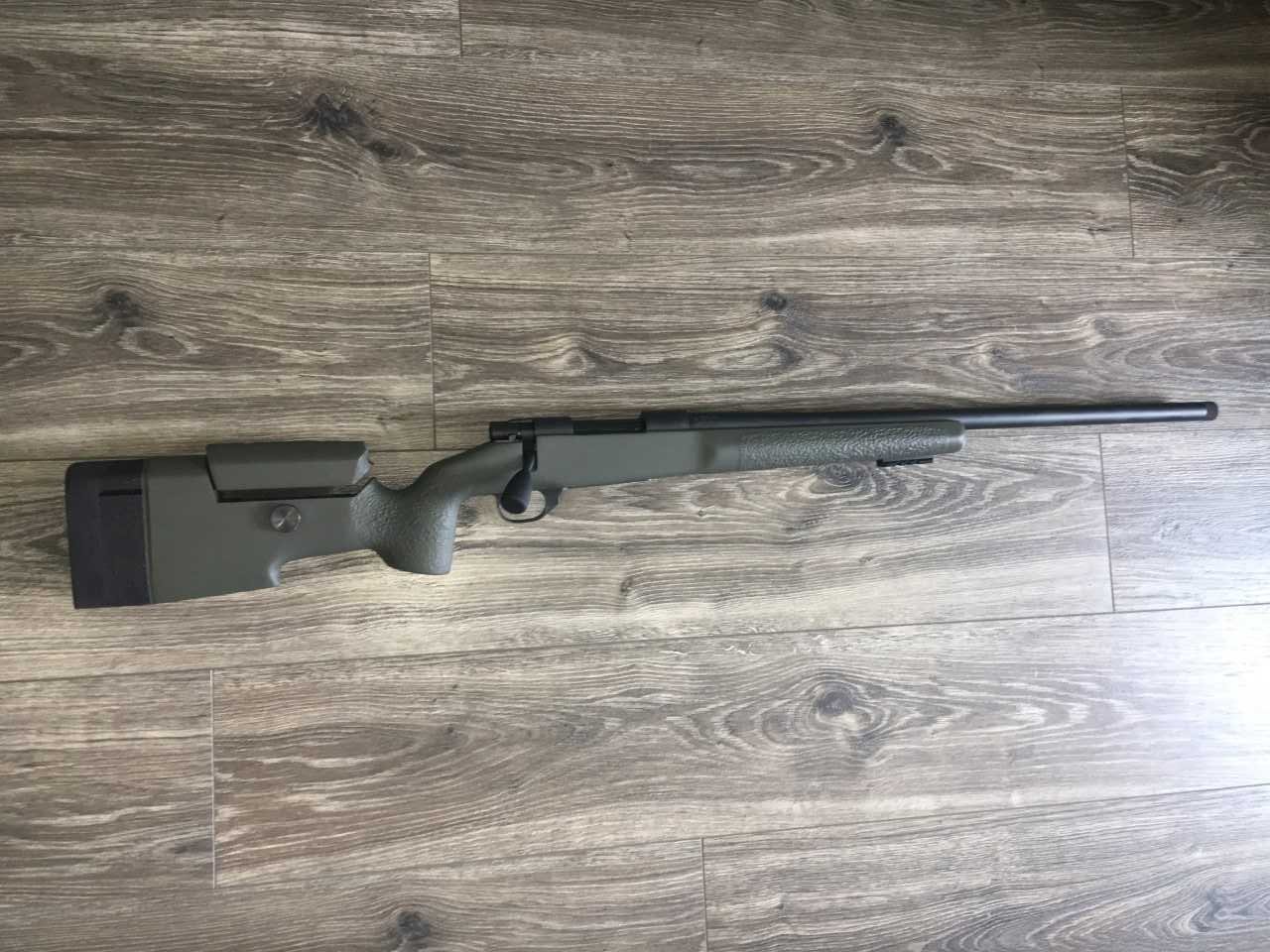

Factory 6 Creedmoor in a McMillan A5 OD Green Stock, with S.A.C. Bolt knob installation done:
I was originally quoted 4-4.5 months for a painted A5, but it came in after 3.5 months!
Also impressed by SAC's work, they matched a portion of the factory knob to the profile of the new one. It looks good IMO
@Harman117
How long was the turn around for the SAC bolt knob work?
8 days total, if I remember correctly. Essentially one week from shipping it to receiving it.
It’s not necessarily a needed upgrade, but after playing with it for a while it makes manipulation very easy and should add some more clearance between the knob and scope eyepiece.

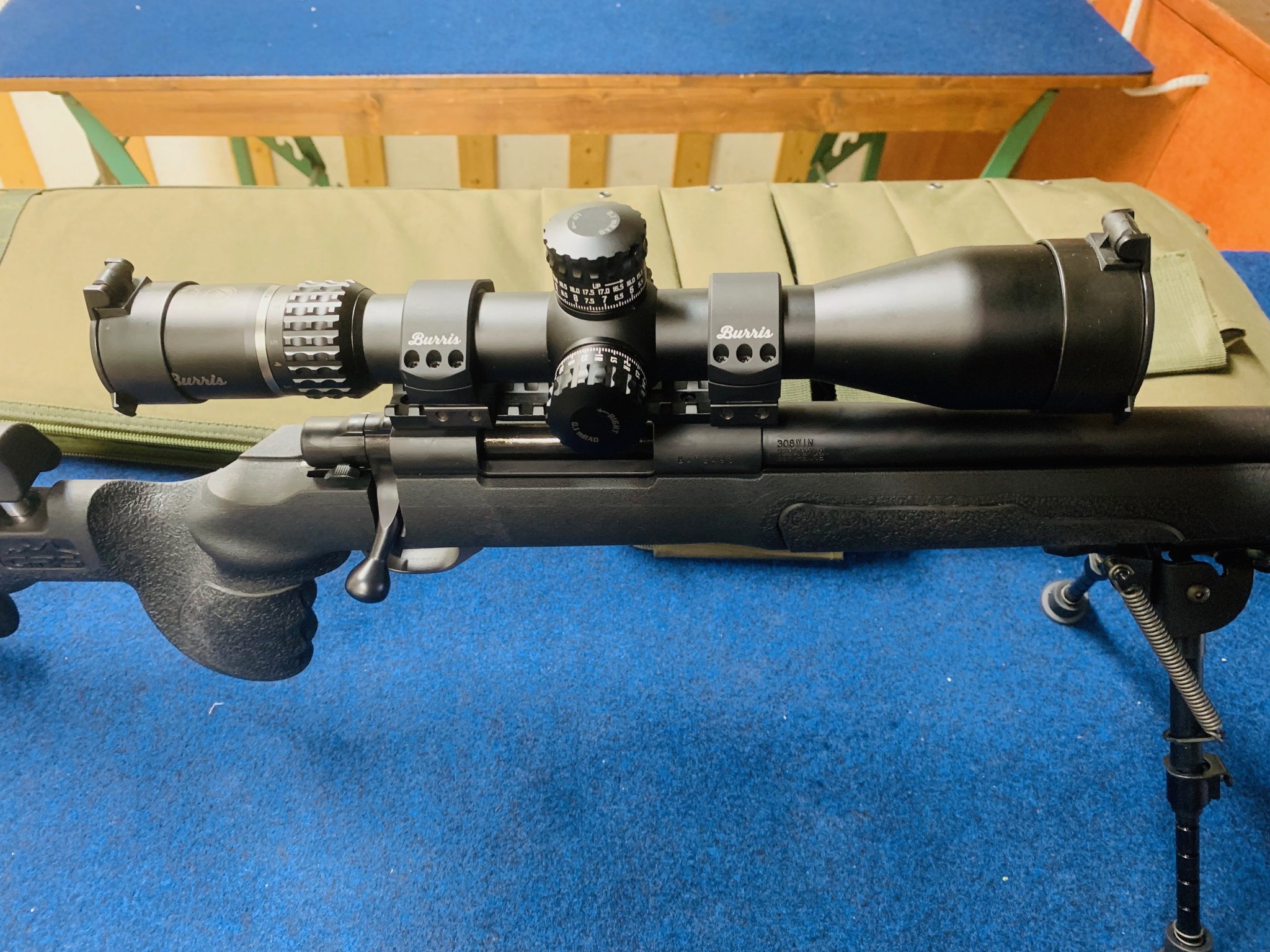

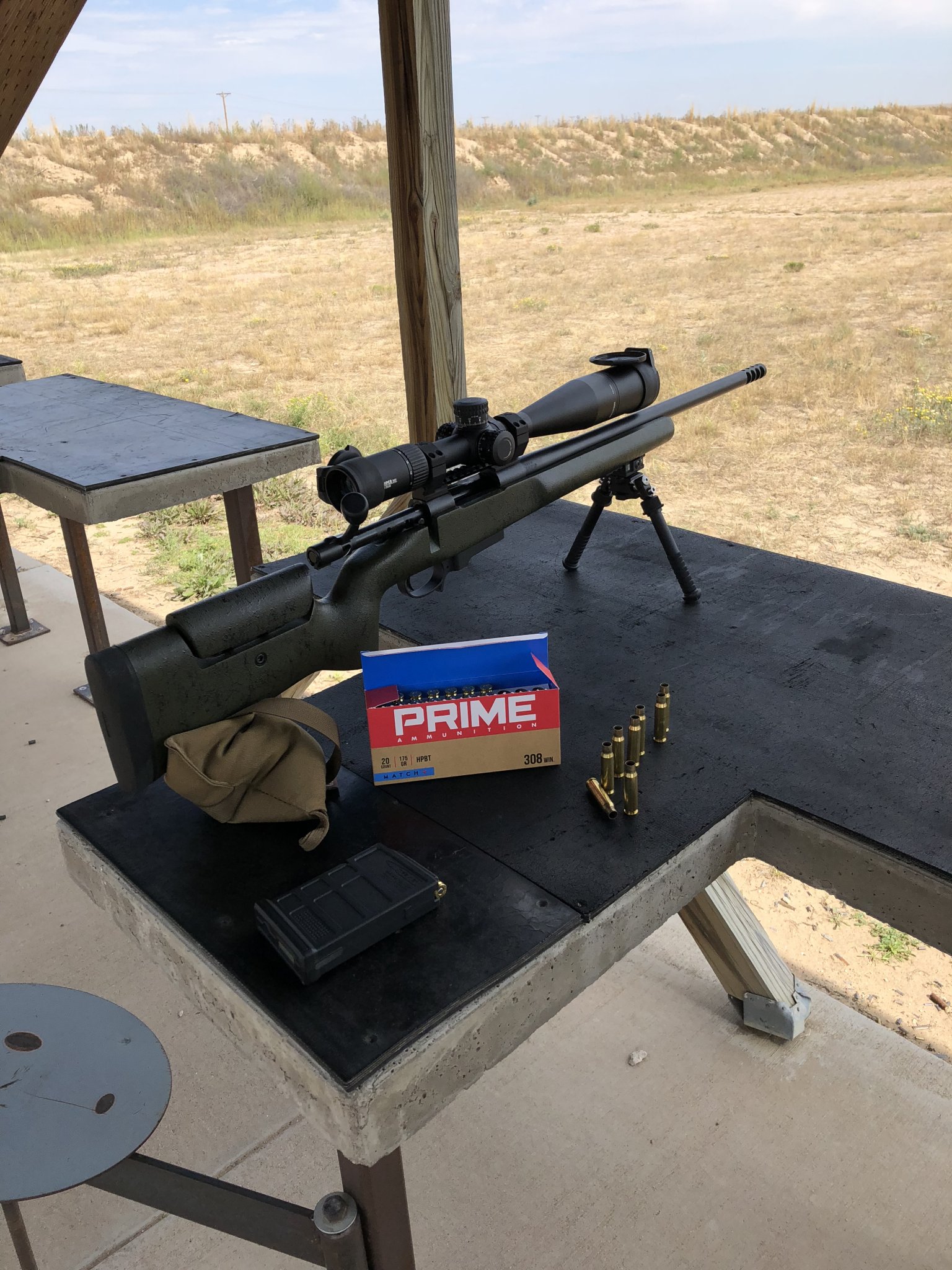

Purchased the Hogue version of the Howa 1500 in 308 with 24" barrel. Immediately removed the stock and swapped for KRG Bravo. The Hogue stock and bottom metal are available for cheap if anyone wants it.
- KRG Bravo
- Burris XTR 25 MOA Rail (bedded)
- HACT Trigger Job - 1.5 coils cut
- Vortex Razor G2 4.5-27x56mm
- Vortex PMR 34mm 1.26" Rings
I have Vortex Defender caps in the mail and will be sending the bolt to Short Action Customs for their bolt knob modification.
I shot it for the first time today and fired 10 rounds of Magtech 150 grain and 10 rounds of Federal GMM 168gr. Best group was 1.25" at 100 yards, so I'm not impressed. Then again the barrel is brand new and may need some more rounds through it before it gets into the groove.
The action feels great and is very smooth. I'll be doing some load testing next range day and am hoping the groups tighten up.

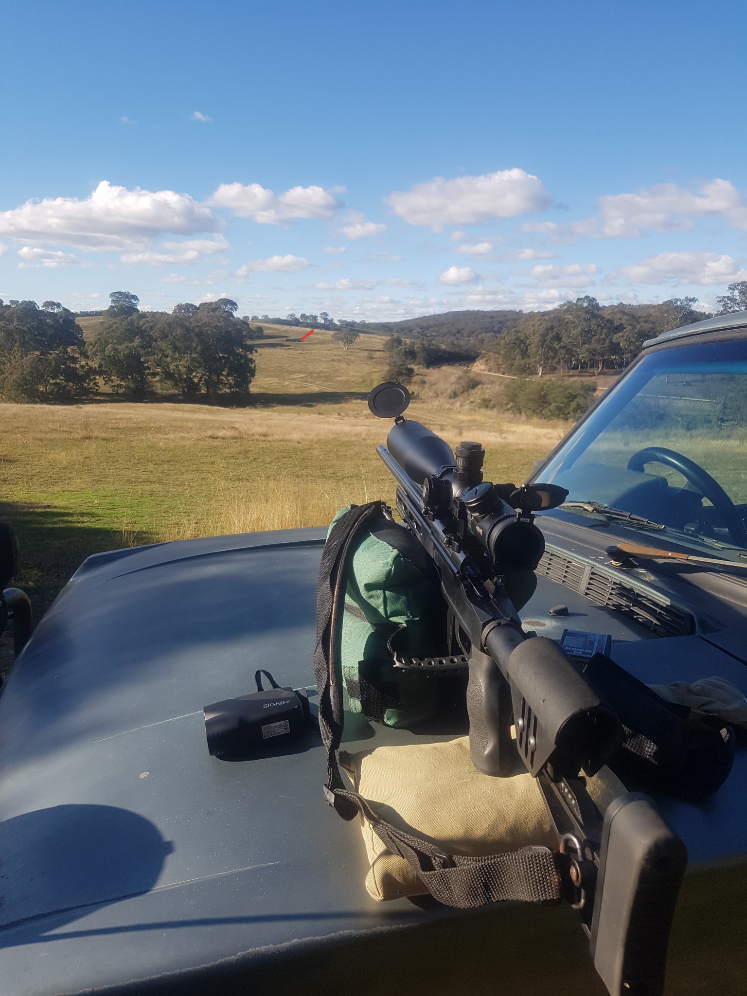

G'day all,
I always like a chance to show someone my current favourite, some nice rigs shown above, this is mine.
It's a Howa 1500 .223 9 twist 24" fluted varmint. I removed the very pretty piece of walnut that came standard and fitted an XLR Industries Element chassis, a Gunbloke 1.5lb 2 stage trigger, a Hawke 10-50x60 Sidewinder scope and for night time a Trustfire SST-50 with a quick release mount. With the torch mounted on that big scope this is not a walk around type rifle so I only ever use it when on or in a vehicle or lurking prone in an ambush position.
The benefit of letting your OCD take full control in the quest for the perfect hand load is visible above. After 18 months of experimentation I hit the sweet spot. Weight batching both projectiles and brass, and using Hornady 55gn Roo Max soft nose projectiles seated to the cannelure, ADI cases weighing 93.3gn and 25.6gn of ADI 2206H powder, the group above the bull is 5 rounds at 250m.
For a comparison I fired my last 2 Buffalo River factory rounds (the 2 flyers). Buffalo River is an Australian brand using Sierra 55gn soft nose and ADI brass, so serves as a good reference point.

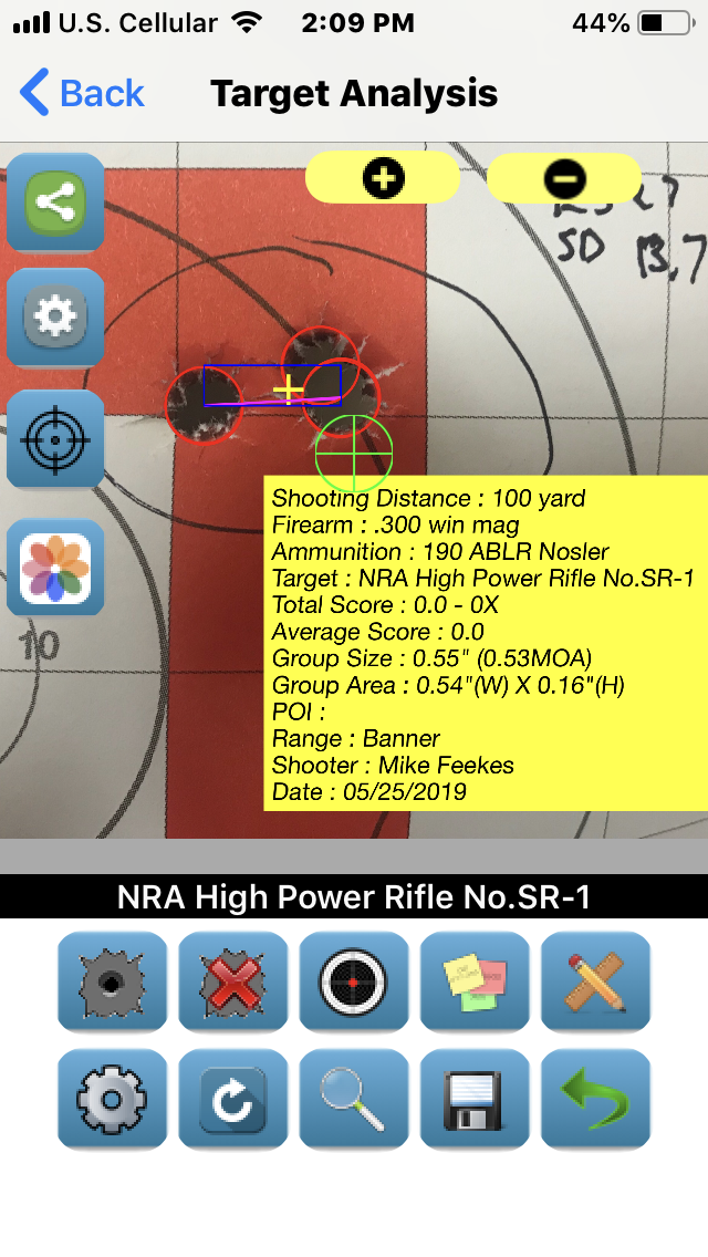

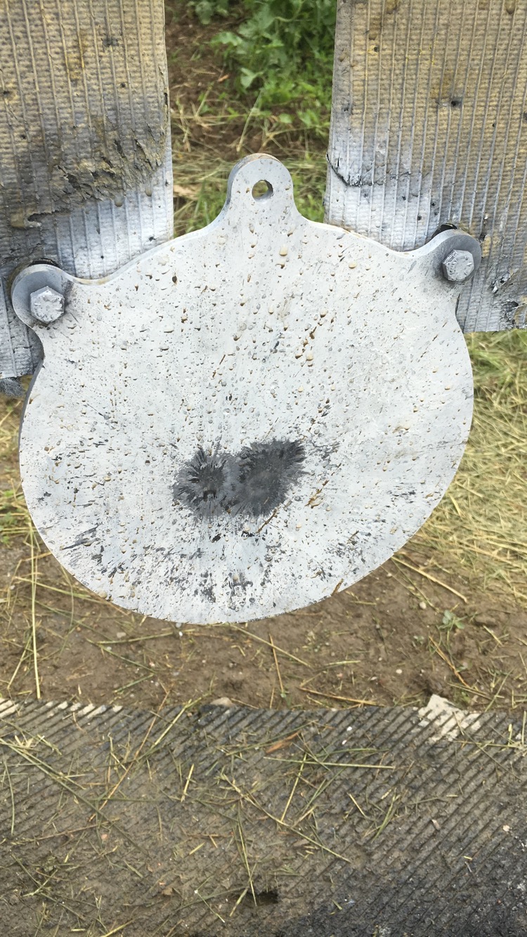

Here’s 3 shots @300 yards from my last range visit. 10” gong. (Using my 6.5 CM factory ammo in the KRG Bravo) it’s a little over 1.25”
.300 Win mag
26" Semi Heavy barrel
KDF Muzzle Brake
Timney trigger @ 3#
Manners Elite MCS-T (Bedded with Devcon #10110)
Nightforce 20moa rail (Bedded)
Weaver Tactical 3-15x50mm w/ illum. FFP enhanced Mil dot reticle.
A.R.M.S. #22 Low rings
Magpul Bipod w/ Larue LT271
Atlas Bipod rail with QD
Nosler 190gr ABLR, OAL 3.51", 2980fps

@Harman117
The 4 round group measured 1.25”.
The first 10 rounds were magtech 150gr and used to sight in.
The second 10 were Federal GMM 168gr. I fired two 3 round groups and one 4 round group.
I’m kind of at a loss because I can shoot my 6.5 into 1/2” - 3/4” groups consistently.
But then again the Howa only has 20 rounds down the barrel and it may need some more copper in the barrel to get things to settle down.
I’ll be shooting it again this week and doing some load testing with various match ammo. Hopefully I start getting the kind of results others are experiencing in this thread.

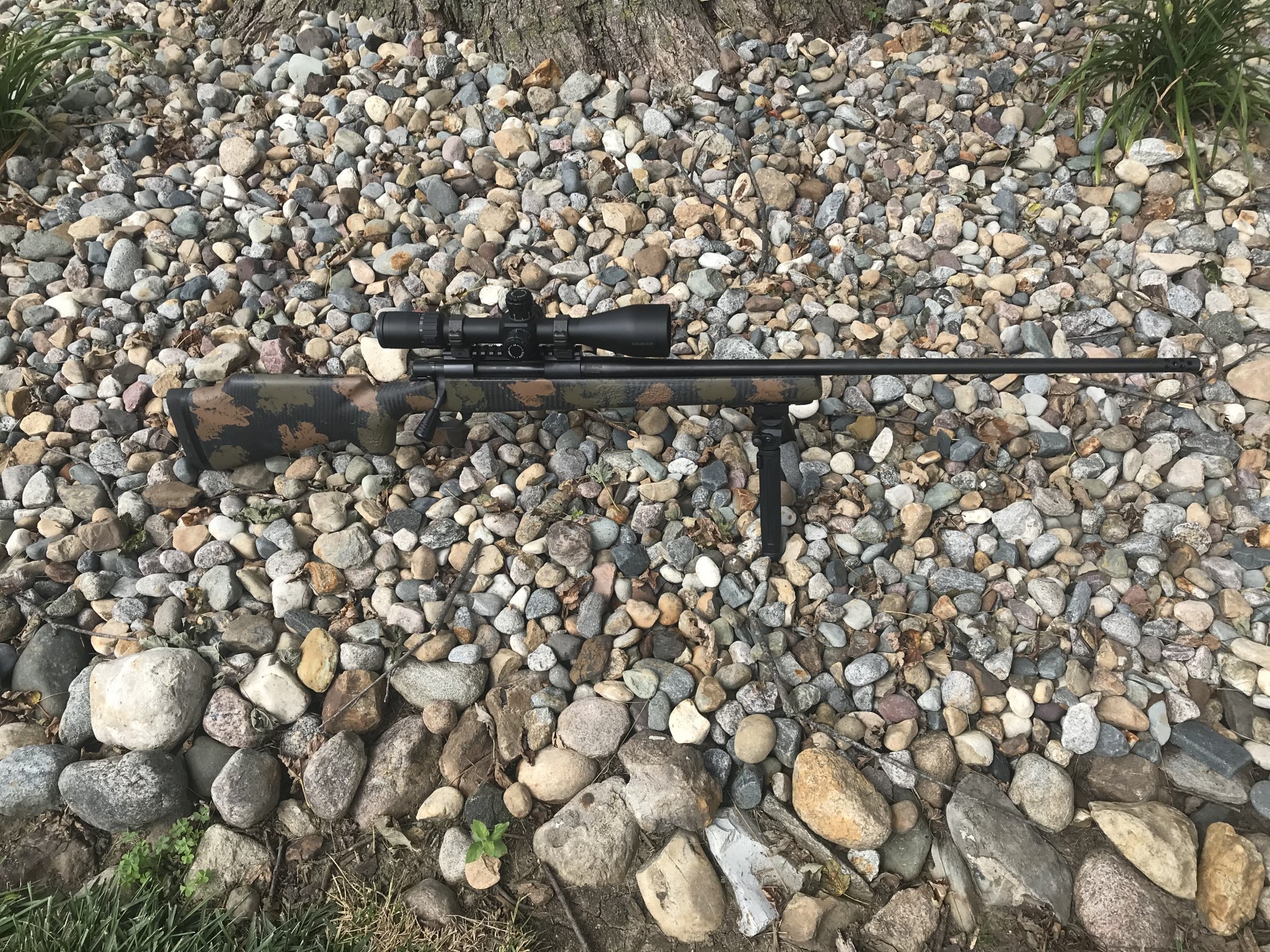

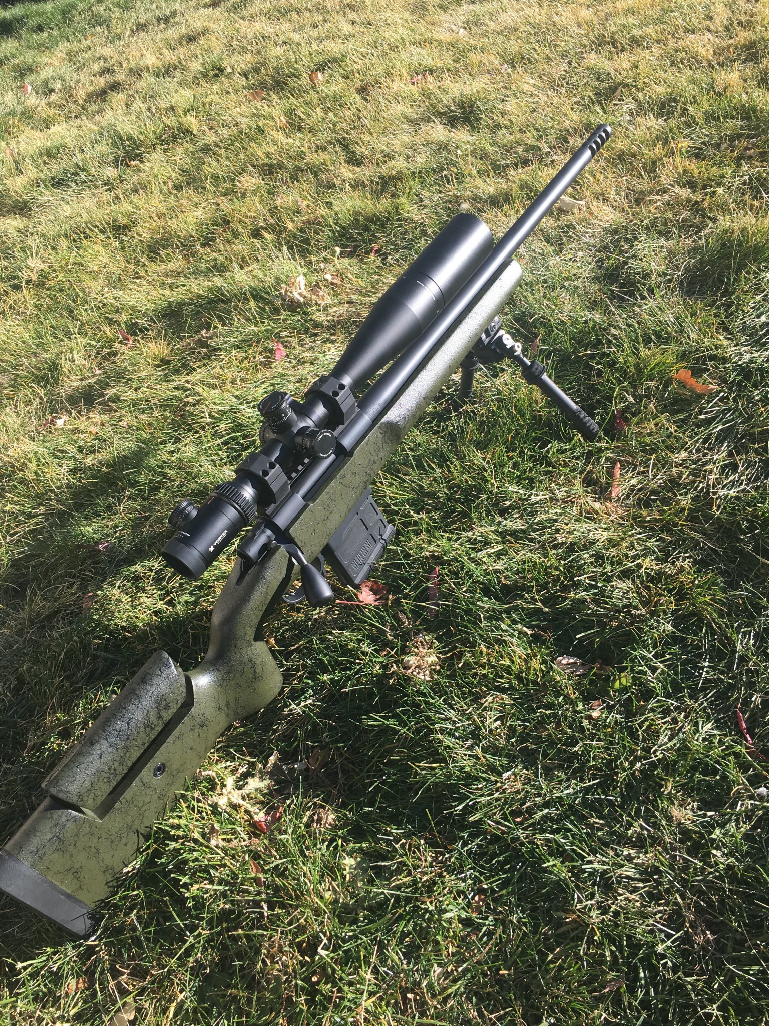

Here’s my Howa 1500 .308 20” factory bull barrel
Bell and Carlson stock (bedded myself)
PTG bottom metal
Nightforce 20 moa base
Threaded bolt handle (threaded myself)
Timney trigger (can’t remember the model off hand)
Vortex rings
Vortex pst gen 2 5-25x50
Cerakoted myself as I hate blued rifles.
Here’s a 4 round group at 100 yards with factory Hornady black 168gr. Bought a few cases a couple years back on sale and this rifle seemed to love that stuff.

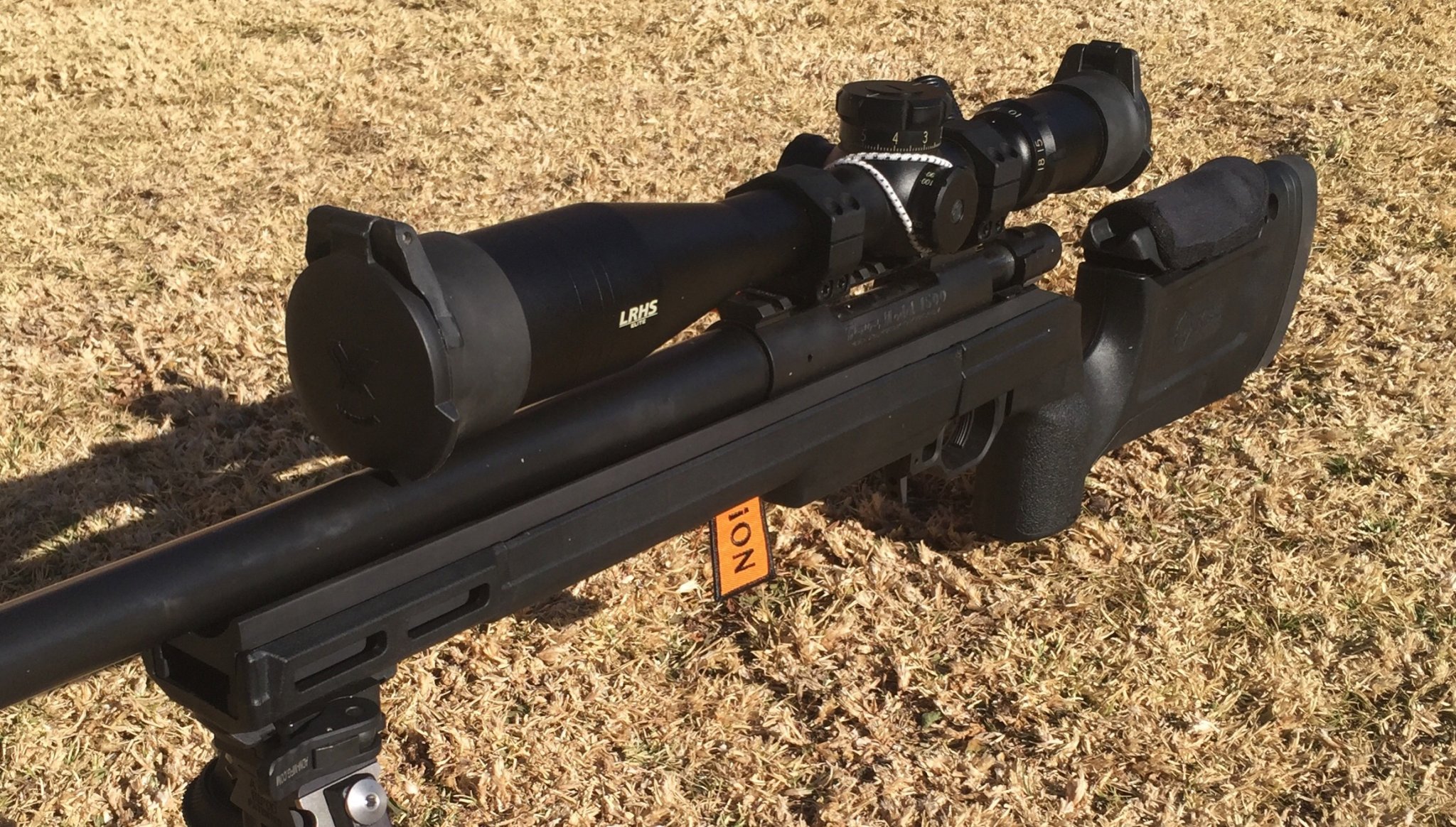

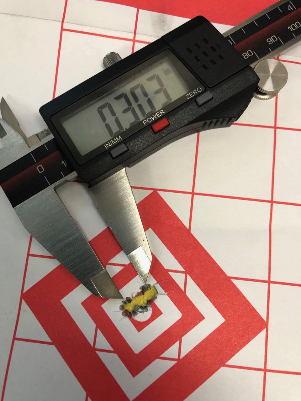

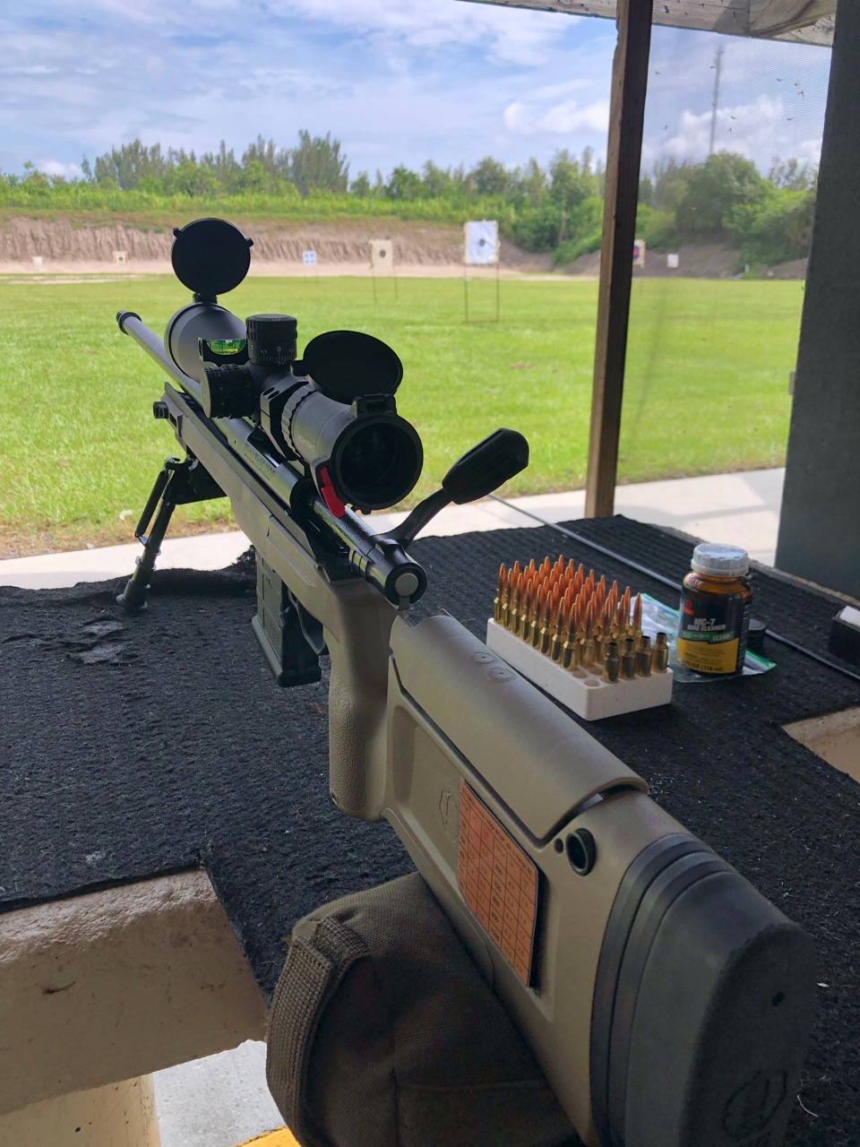

Finally got my build to the range today and followed Howas break in procedure. I spent more time running patches than shooting!
After 20 break in shots while sighting in, I got a pretty nice group at 100 yards. That's with a bipod directly on a concrete bench, a crappy midway mini rear bag and budget Hornady American ammo in a 50 ground box.
The build: 6.5CM barreled action, KRG bravo, clipped trigger spring for a 1lb 11oz pull, Nightforce SHV F1 scope, seekins low rings, 20moa mount, vortex bubble level, AAC muzzle break.
I have the Howa bolt on enlarged bolt handle. It's only okay. Doesn't fit with both o-rings. With 1 o-ring it still has a slight gap. I might send it off to get threaded. Maybe flute the bolt too?
Zeroed at 100 yards, I only have 4 clicks until the elevation turret is fully bottomed. I guess that's okay? I have lots of room to wind up.

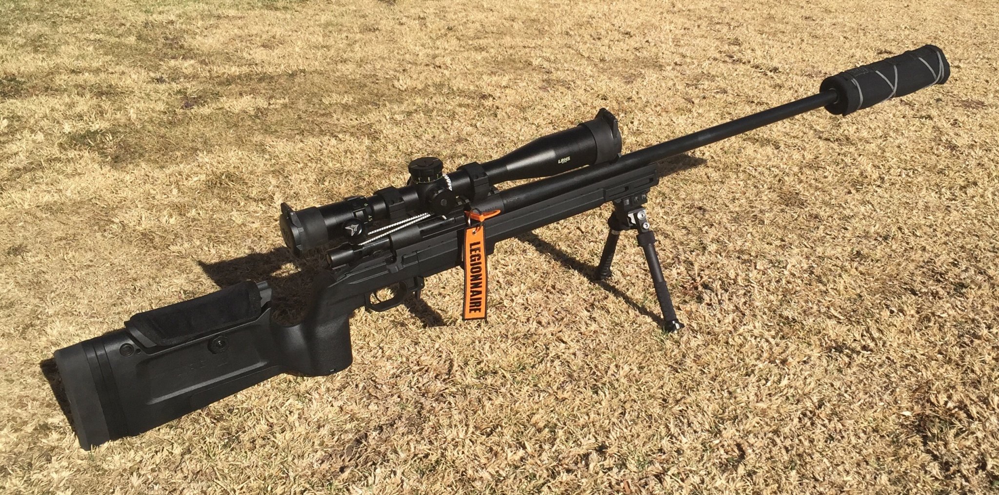

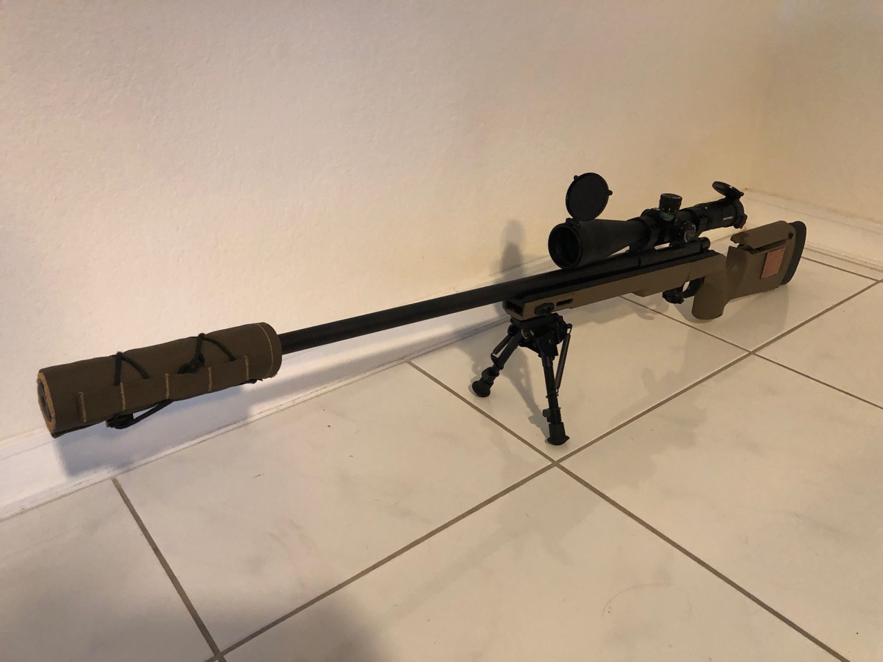

Here’s my 24” heavy barreled 6.5 Creedmoor, also posted in the KRG Bravo thread.
I’m still fire forming new Lapua brass and I’m consistently getting sub- 0.5 MOA groups out to 300m. Real load development to start soon.
Bushnell LRHS 4.5-18x44
Seekins rings
Warne 20MOA rail
G&G Varminting bolt knob (great addition)
Atlas bipod
DIY cheek pad
Gunwarrior supressor with Legionnaire cover (soon to be replaced with an MDT brake)
