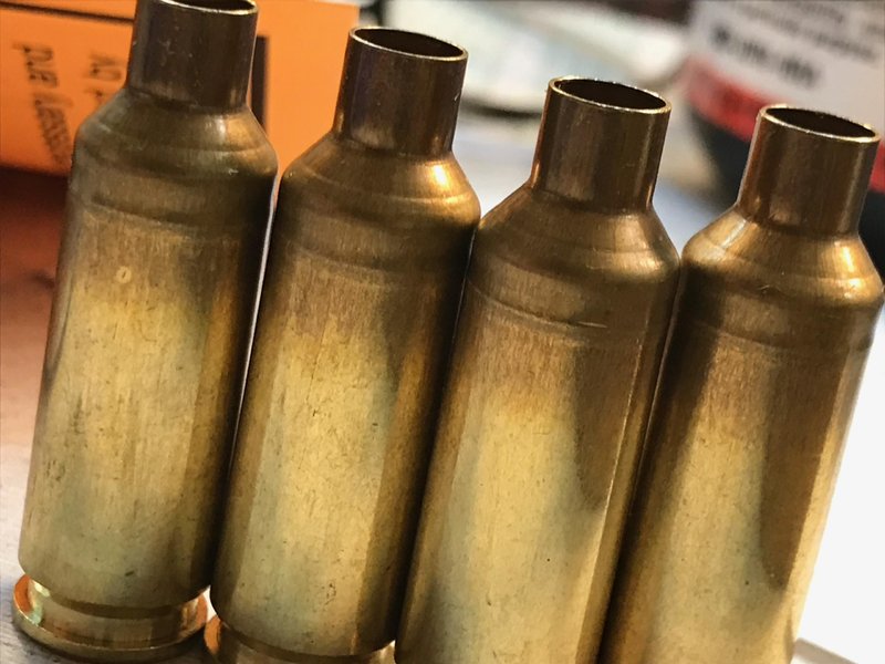

Is the 'ridge' you can see in the pic normal for fireformed brass? These are from a buddy who just got some. You can see the ridge below shoulder
