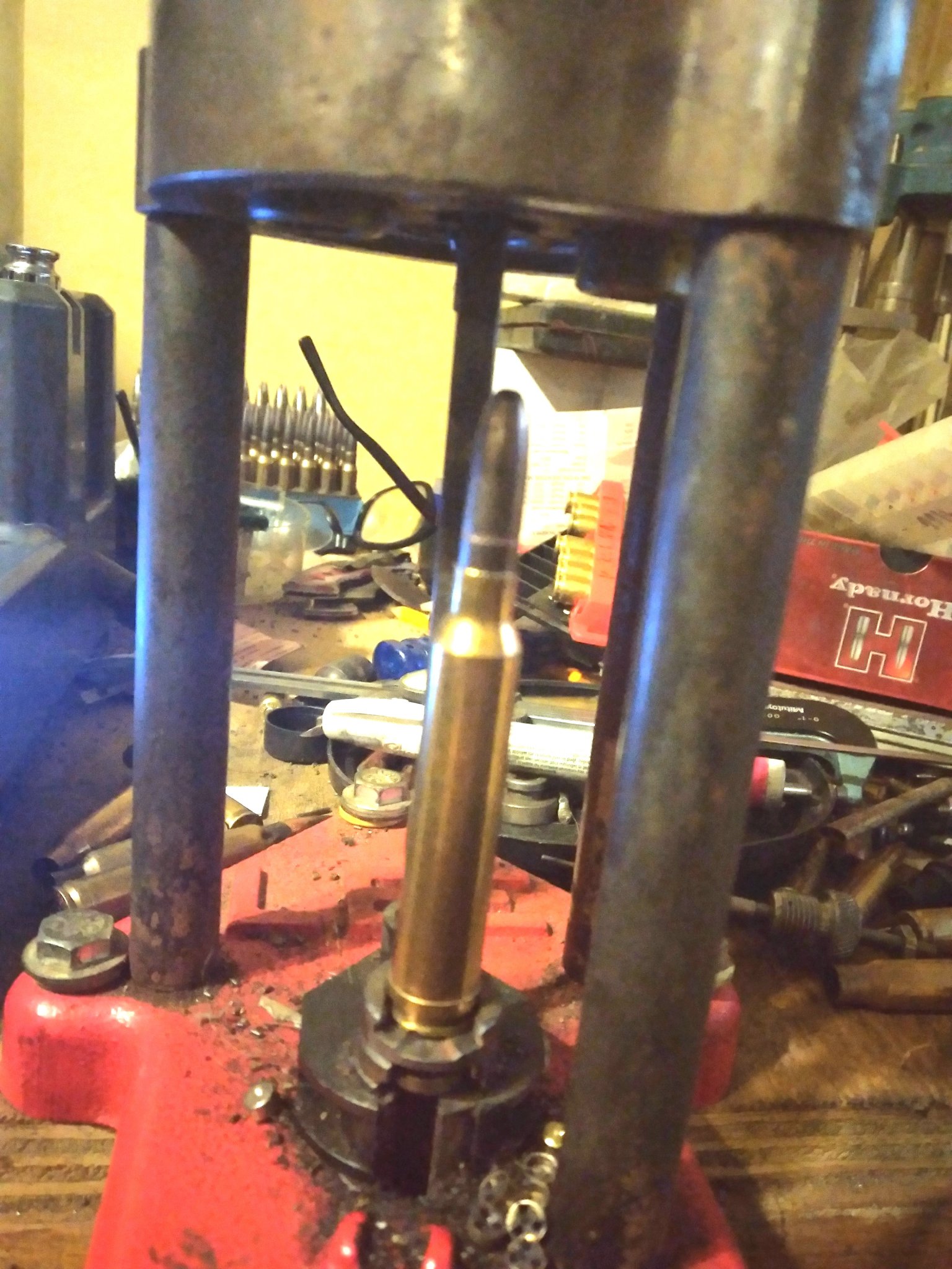

I don’t ever shoot in a square range, of course I wipe them down but hardly ever ultra sonic or tumble. Of course if I’m in sand it’s a different story
