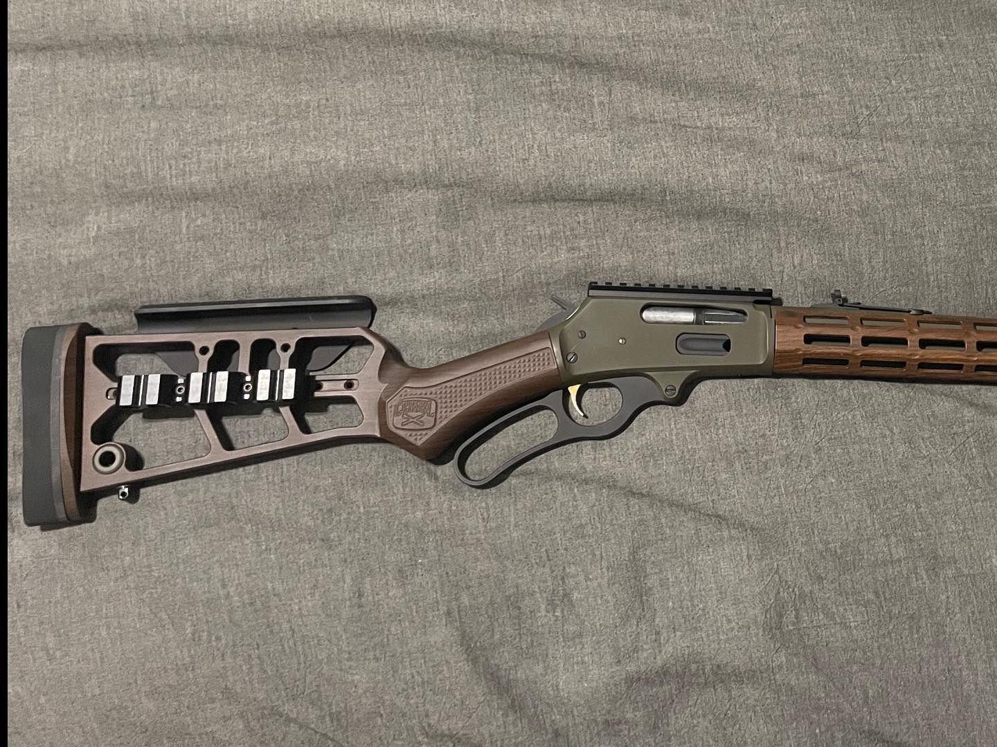

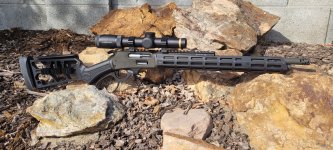

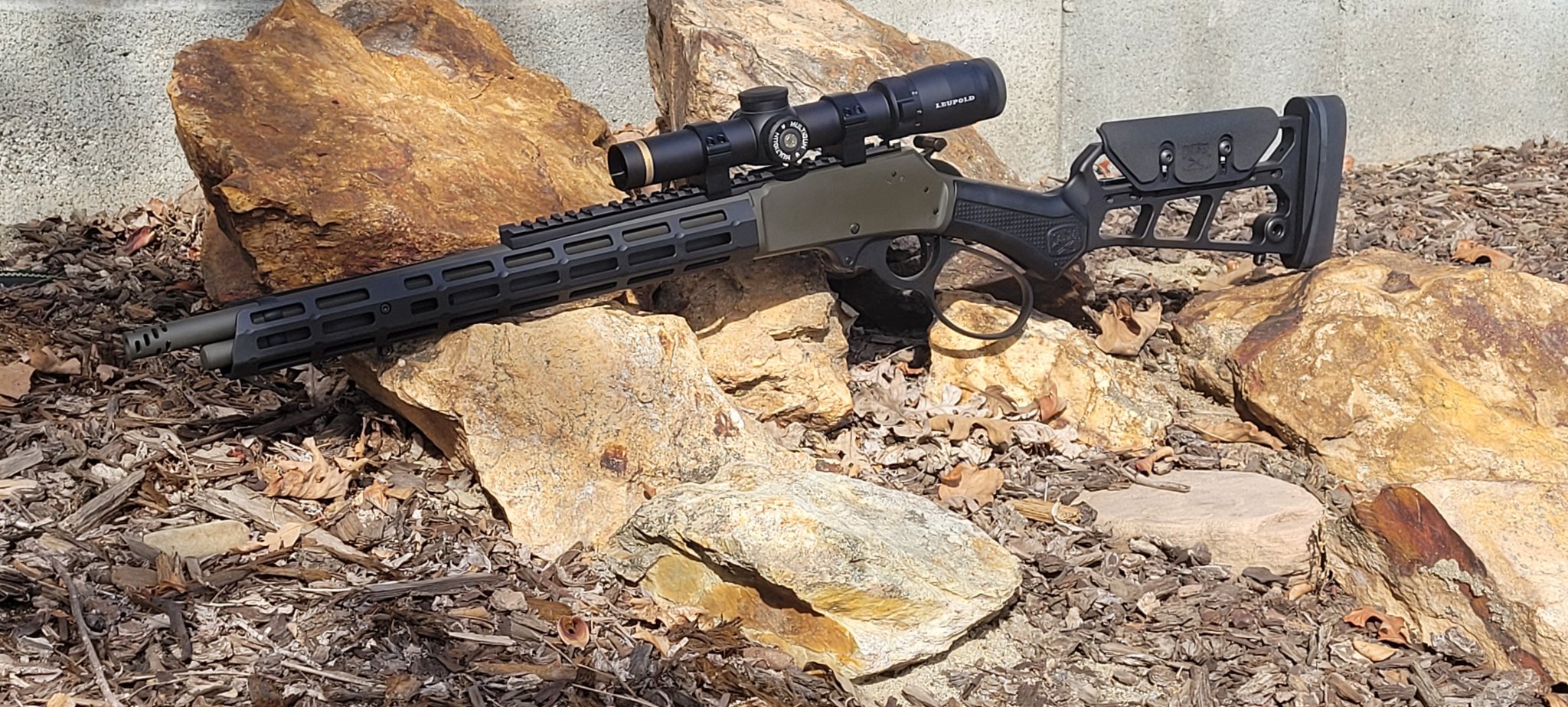

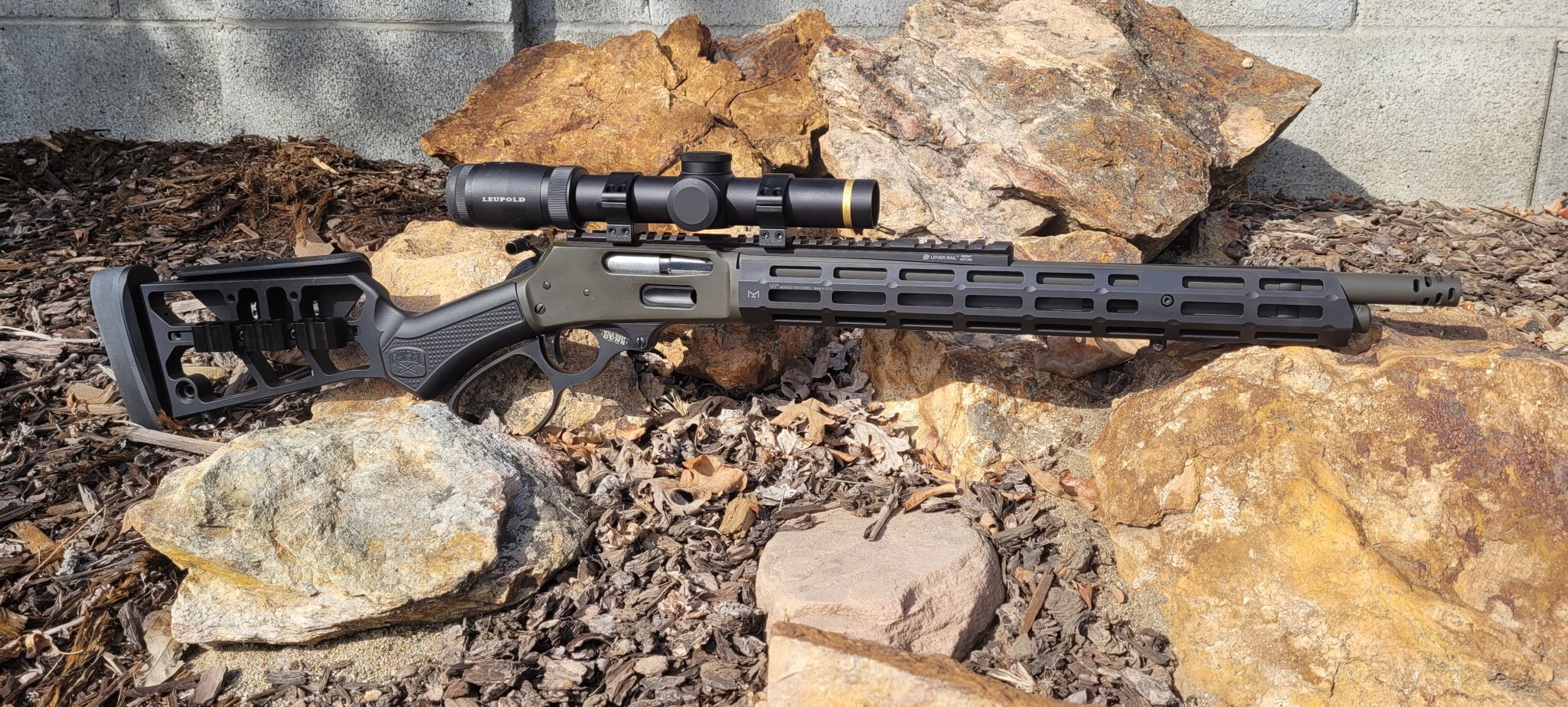

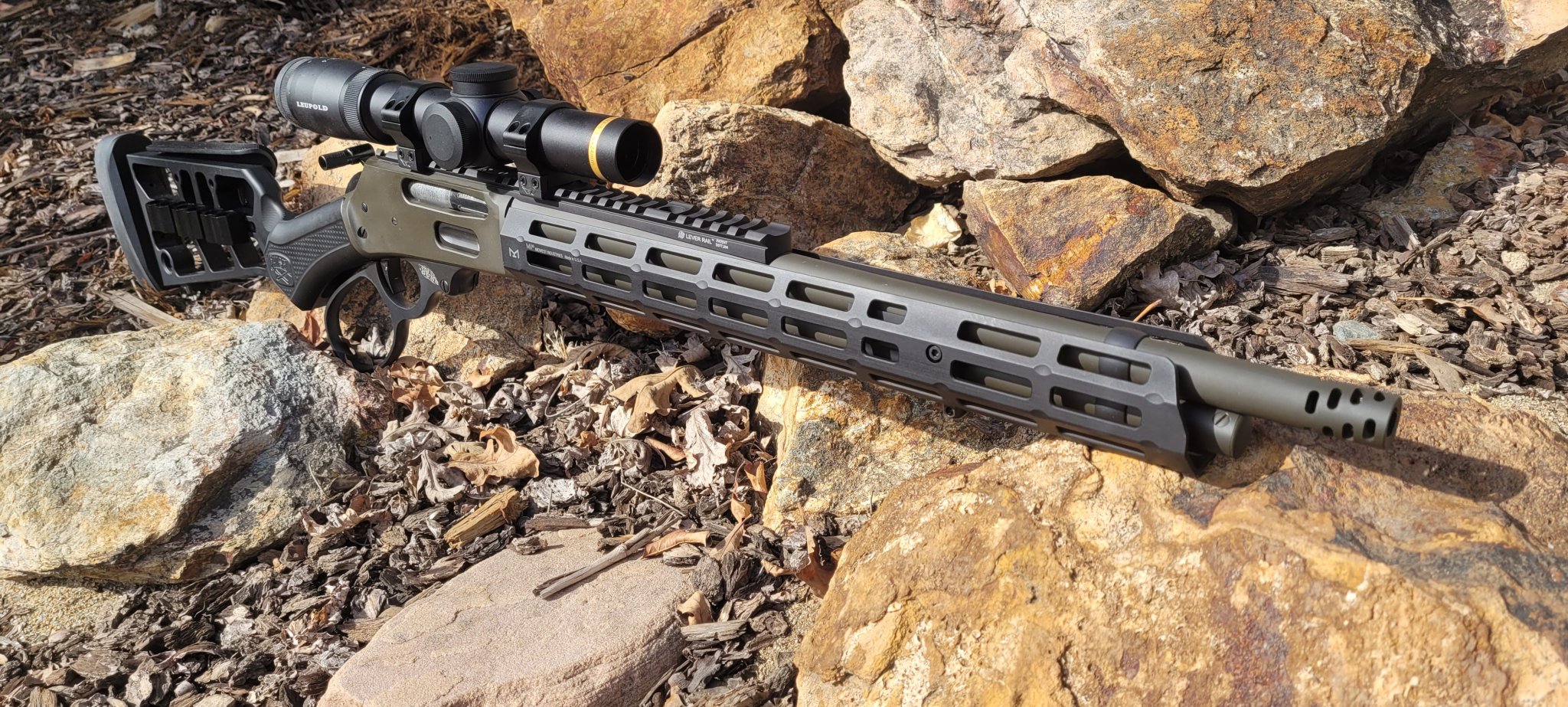

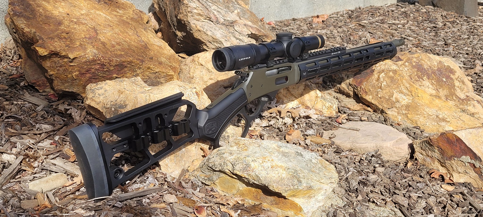

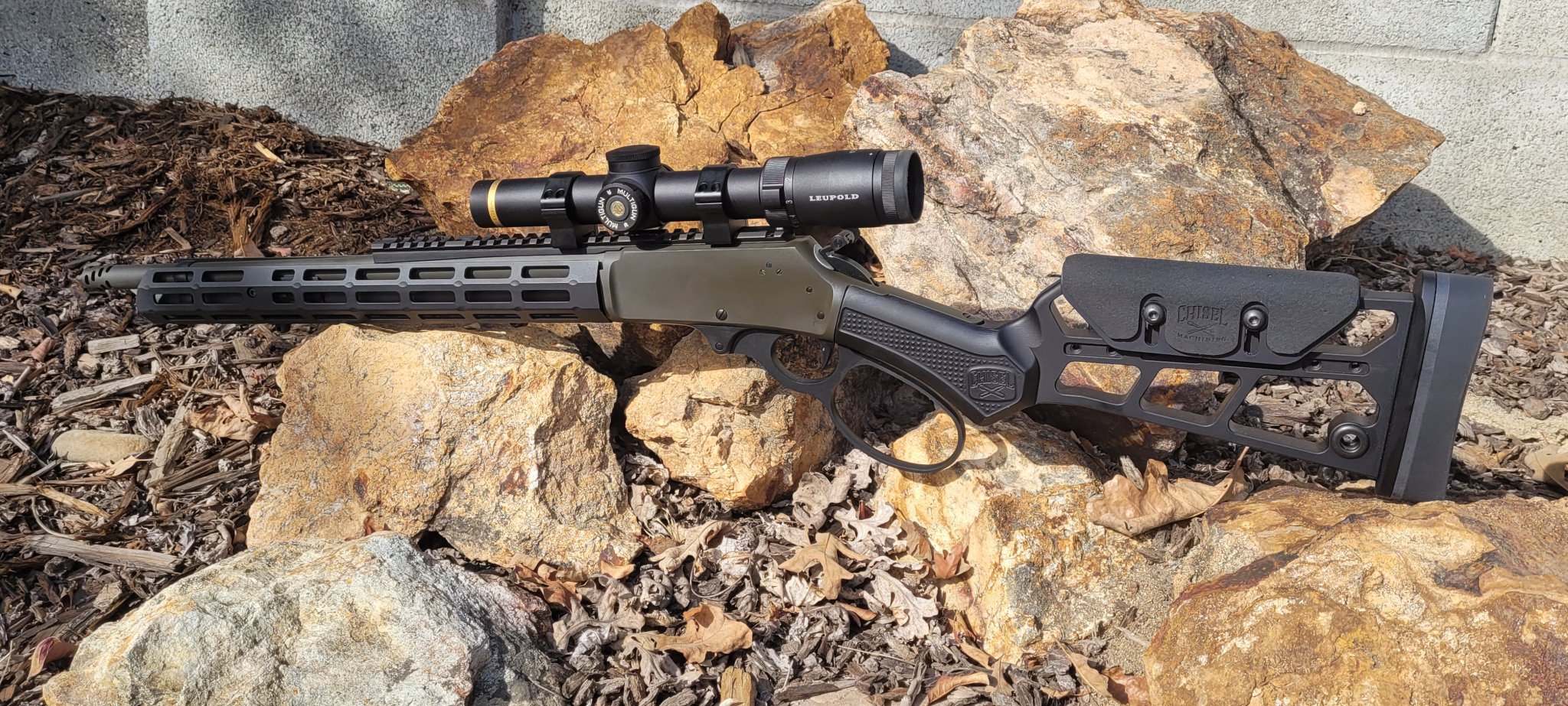

Ok...I admit...I think the new rage of making a lever gun "tacti-cool" is..well...cool.
I had an old Marlin 336 in 30-30 that was literally collecting rust. I have not shot it in over 30 years.
Then my friend Chad of Chisel Machining started making stocks for the Marlin and Henry rifles so that sealed the deal.
Now there are many shops turning out really nice lever builds.

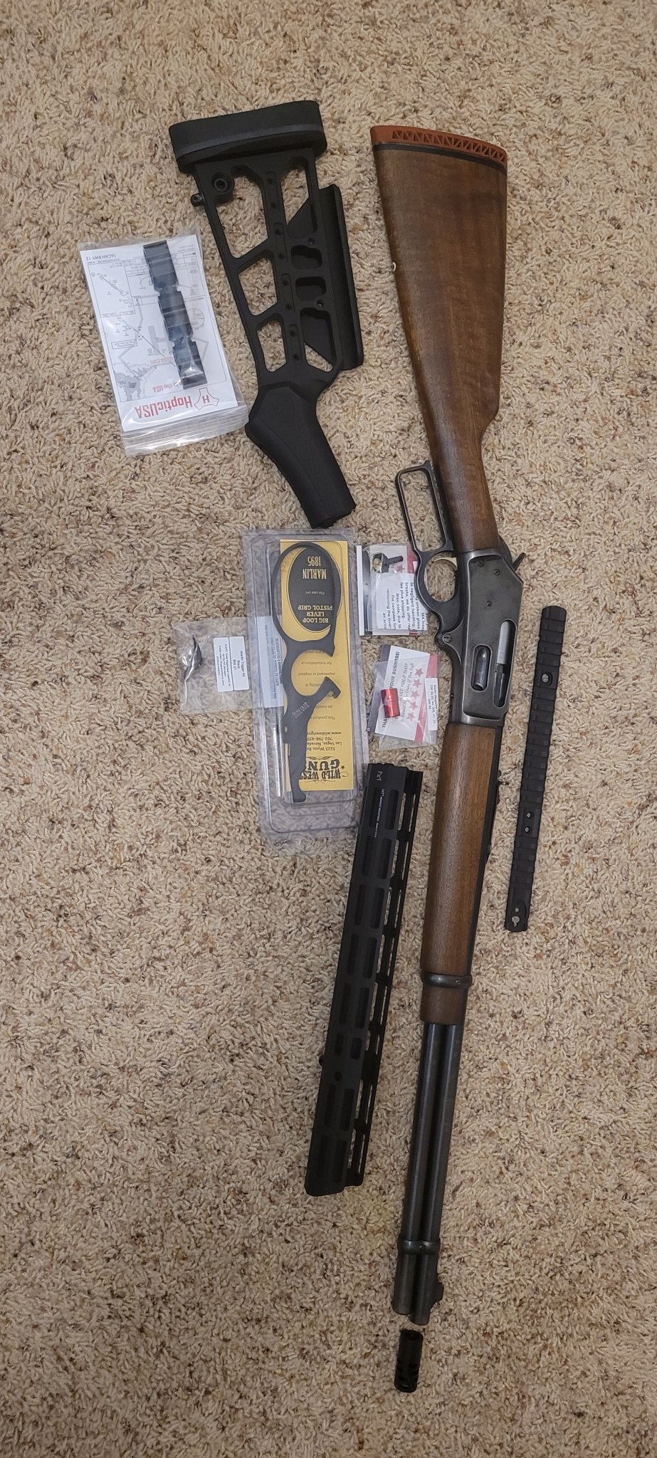

But I really did not want put $1500+ plus a 4-6 month wait into a rig that was just going to be for fun.
So I gathered parts and contacted my good friend Mike at The Cartridge Family to do the gunsmithing.
He shortened the barrel to 14 1/2" and then pined, welded, and blended the brake to make 16.2" barrel length.
Slicked up the action. Instalked a Ranger Point trigger and big loop lever.
The Cerakote was also done locally in Magpul OD green.
Topped it with a Leupold VX6 I had laying around.
Here is how it turned out.

Heck yeah, that turned out nice.
I’ve got a posse of Marlins , all pretty much stock except for WWG trigger/ejector upgrades. Now you got me thinkin’….

Are the stock and hg drop in? Or is fitting required?
What is the out of pocket to do this if you don’t mind me asking. I have a 94 in 444 marlin that would stomp shit even more then it already stomps shit in a configuration like that. Very cool!
Not sure of the total. Was given the friend discount.
If you go to the websites I mentioned in my original post, you can see the prices.
The Machining and finishing will probably be the largest cost depending on who you use.

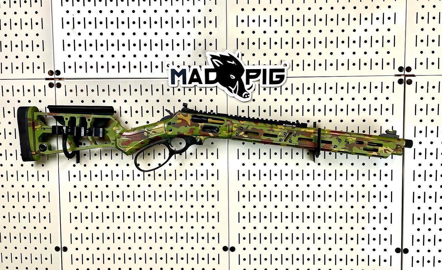

Check out MadPig customs. They build some really cool rigs.

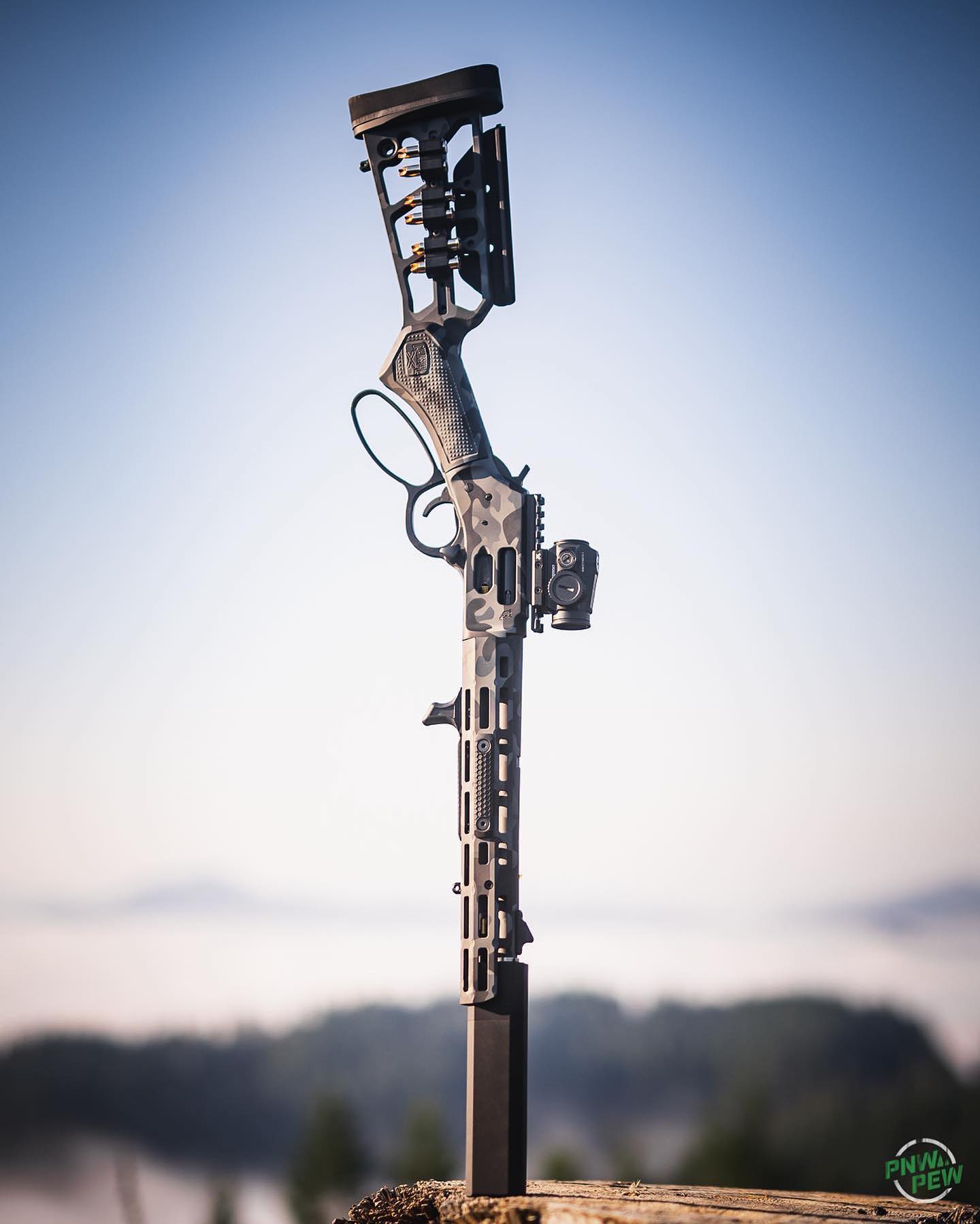

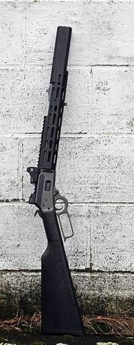

Nah. Rip the bandaid off and go SBR…
He’d have to start all over to do it right. Cut the barrel, cut the tube mag, have the mag dovetail or screw stud redid. Then off to refinish again. Oh and cut the HG to fit the custom length barrel. But yes, SBR at current length would be ok I guess
All that and no it illuminator or can ? Gtfo and gbpse
I haven't been a fan of modernized lever guns, but I really like this one.
Reactions: BgBmBoo
That’s really cool. Not a fan of the buttstock, but overall pretty damn cool. I think a lever gun chambered in 45 colt set up like this would be good.
Reactions: BgBmBoo

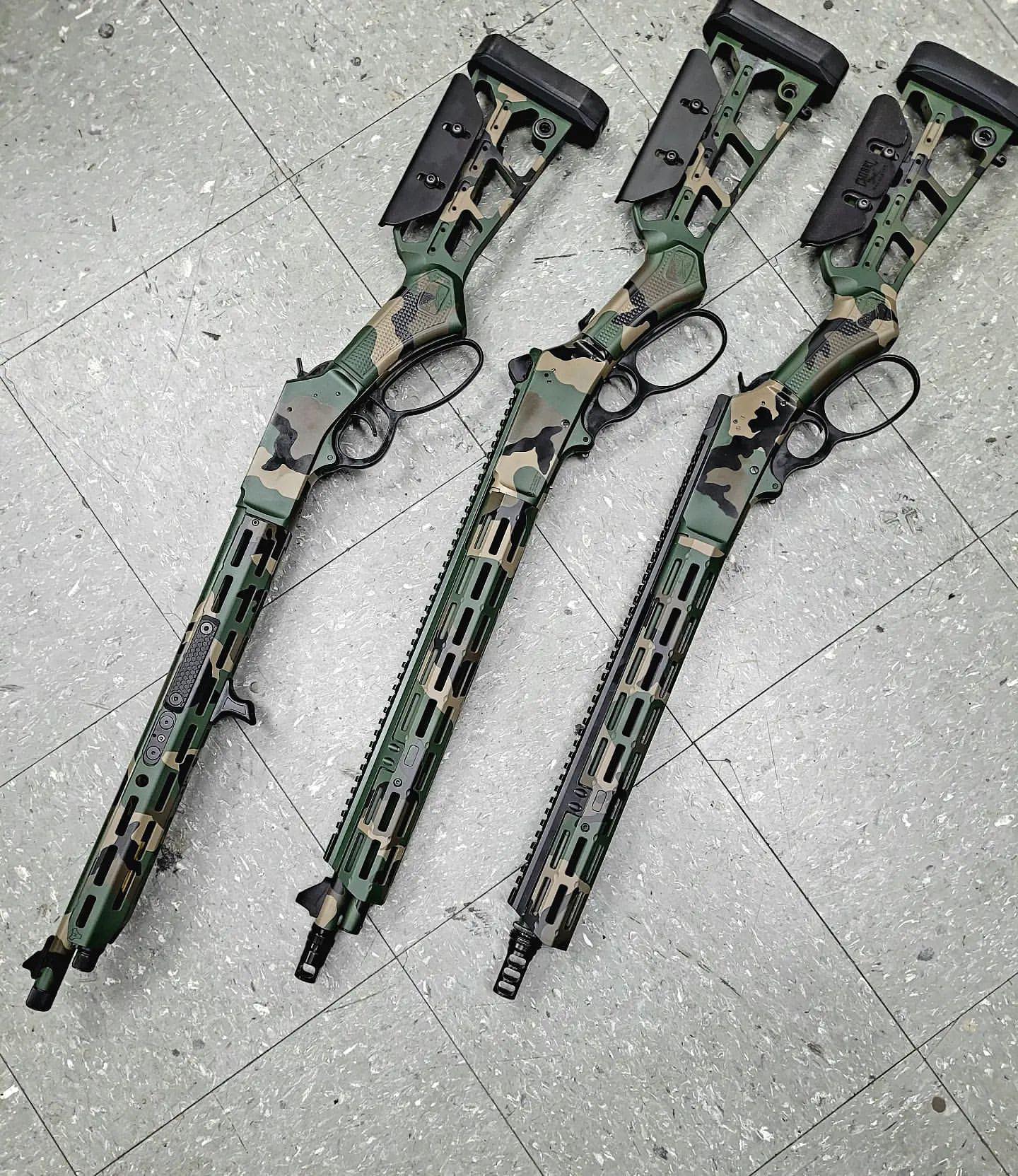

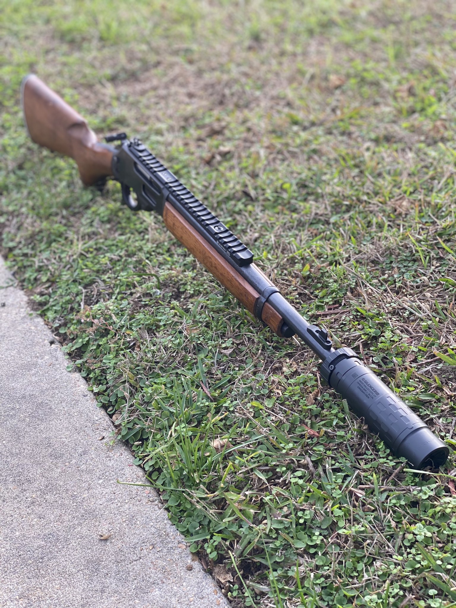

Its unique but I prefer wood and steel. I did however mount a light and rmr on my Winchester 92 😁
Maybe a wood butt stock and matching MLOK grip panels for the rail
Ok I can't hold out much longer, I have to have one of these beauties. I won't do a skeletonized buttstock, that ain't my thing but definitely modernize the rest. The only question is...what model and caliber? One of the new Ruger Marlins maybe? .357 mag to match my pistol?
As far as I know, Ruger is not making anything currently in any other chambering, only 45-70. But Henry makes them in pistol calibers.
They are a lot of fun. I get it….some folks on here think antique firearms are the thing for me. Me…not so much. I grew up on Louis L’Amour, Zane Gray, John Wayne, Etc., but those old guns do nothing for me.
But that is the cool thing about firearms. There is something for everyone.
A nice steel and wood gun aint for a bump in the night.
Thats for a suppressed shorty, red dot, IR laser, and nods.

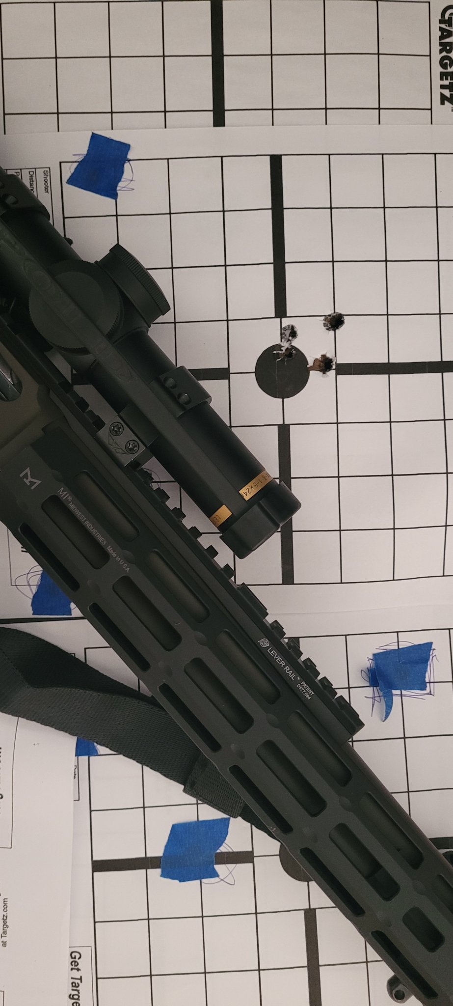

Was able to get to the range today and sight in the rig.
I was going to be happy with 1 1/2" - 2" groups.
So groups like this made my day...especially with my old eyes and only a 6X scope.
Off of a bench with bipod and rear bag at 100 yards with Hornady Leverevolution ammo. 5 shots.
The brake makes this thing recoil like a .223.
