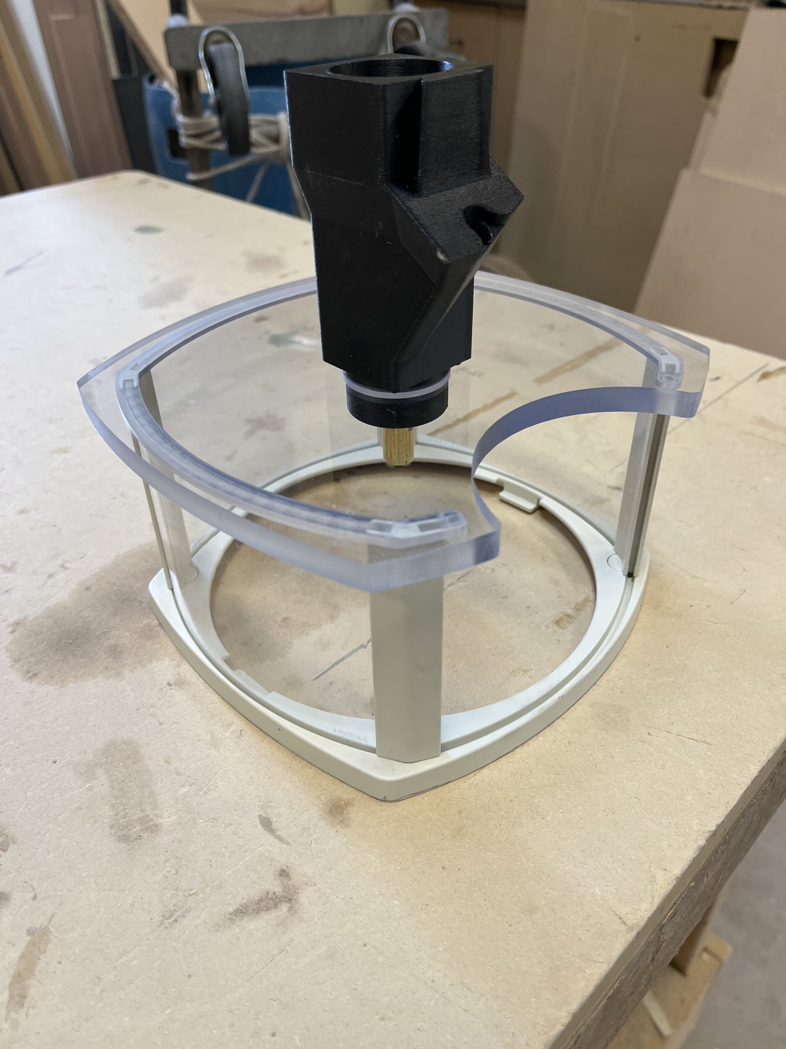

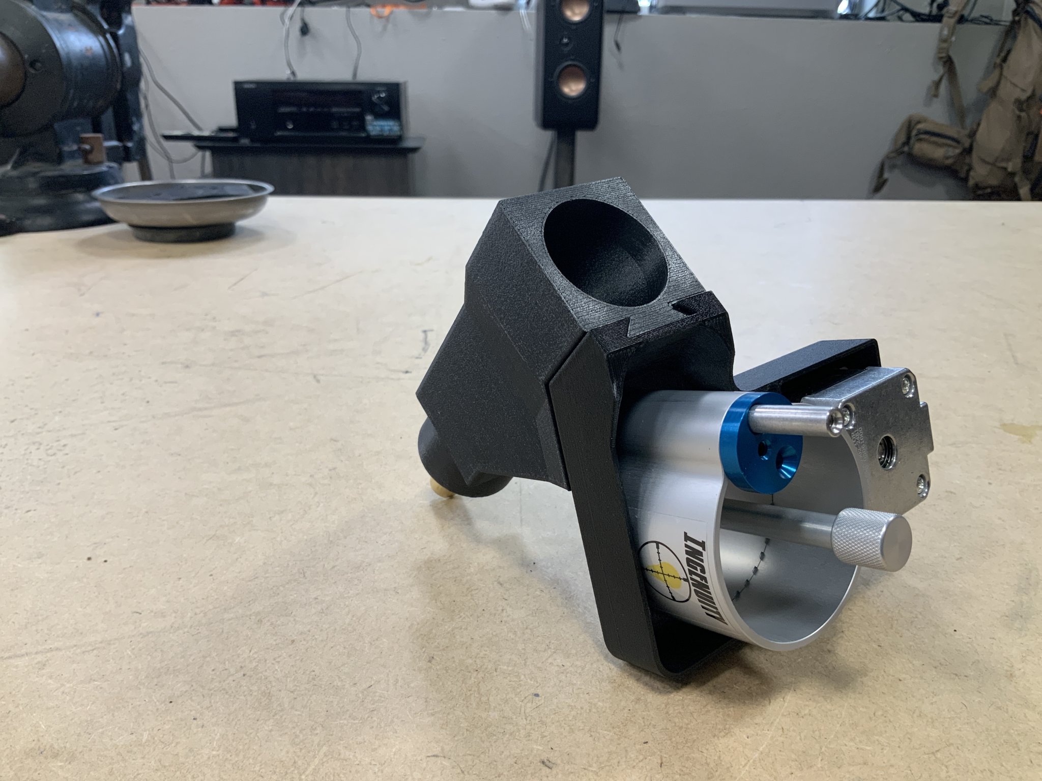

I received my draft shield, platten and carbon mount today. I don't have V3, so I made a bracket to hover my Lyman manual power measure slightly above the drop tube in the mount. I'm having an issue with the powder drop hitting the powder cup on the platten and causing an "over" error on the initial drop even though it's not over. I tried changing the scale mode and going all the way to slow stops the initial over error, but that caused the trickler to throw over on almost every throw. There is probably some combination of settings that will fix this, and I've messaged Paul. Worst case I can remove the powder cup from the platten and replace it which clears the error and then it trickles up as you would expect. Not ideal, but not the end of the world if I have to do that until the IP dropper ships.
If I figure out a better solution, I will post it here in case anyone else runs into the same issue. The new mount for the trickler is a nice upgrade on the original stand and the draft shield is awesome.
Did you remove the additional brass insert for the powder drop? That provided brass insert is only necessary if using the stock or aftermarket shield.

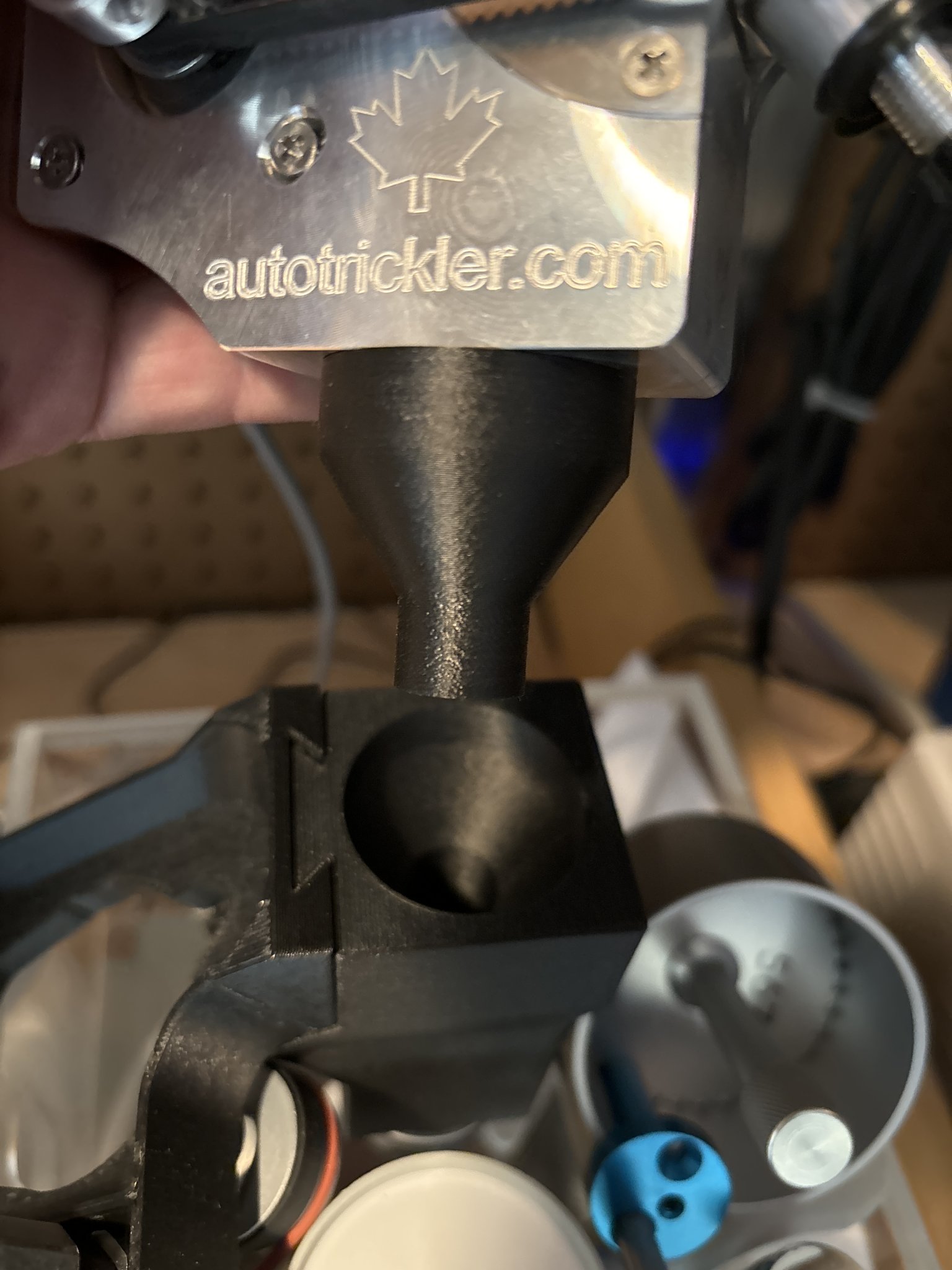

I was getting a few bounce outs out of the top of the mount when the Lyman would catch on the 4350 (as it often does). Applied a little Okie engineering and cut off the bottom of an old funnel so that it sits flush with the powder tube. Problem solved. Working like a champ now.

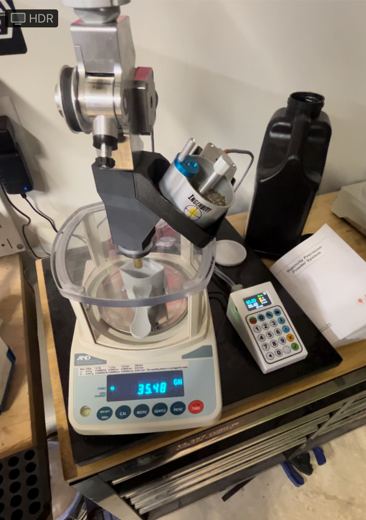

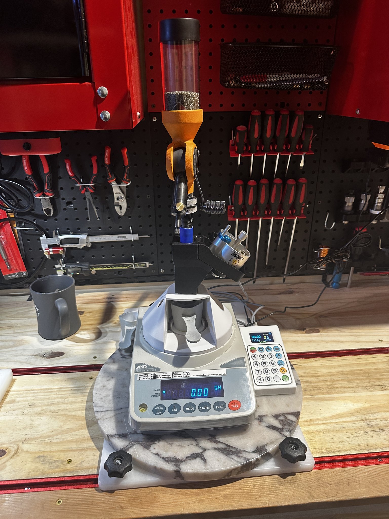

Was talking to Paul today and he clarified some things on the electronics. By default, when A&D scale is selected, it has a tolerance of 0.02 because that's the resolution of the A&D scale.
But, Paul explained you can go to Settings>Base and you will see "End Tol" is set to the default scale resolution of 0.02. You can change thst to 0.
Now, when dumping a charge, it will never stop 0.02 below your set charge weight. Example, if your dumping 32.0gr... if the scale on its final move stops at 31.8gr, it will kick one more notch to get you to 32.0.
This works really well with the smaller powders like varget, 8208, etc. He said its the bigger powders or less consistent kernel sizes that changing End Tolerance doesnt work well with..
I was dropping 8208 today and I set my End tolerance to zero and it was dead on and every once in awhile you would get a 0.02 over so that's better than a 0.04 swing from default setting...
Just thought I would share that for anyone looking to tweak their settings..

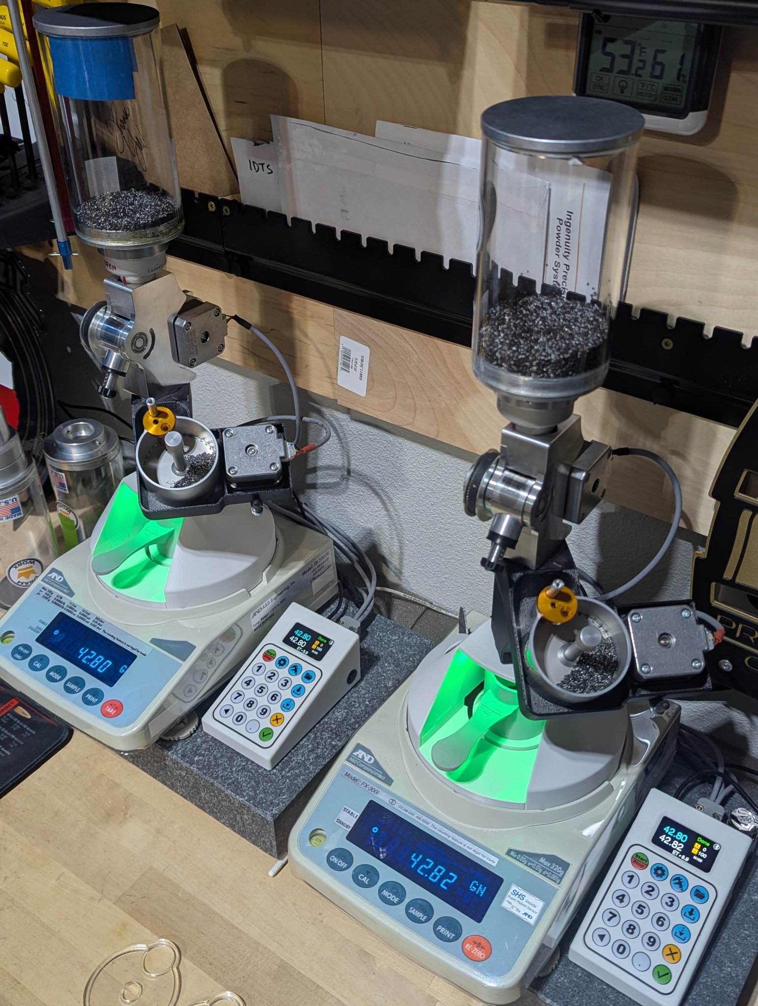

Got the new electronics along with some of the other new items and they are very impressive to say the least. Getting 5-6 second drops with no overthrows. Where do you get the app? I understand it’s still in beta on the TestFlight app and Paul said the invite to the app was sent, but I didn’t receive anything in my email. Somewhere else I should be looking?
