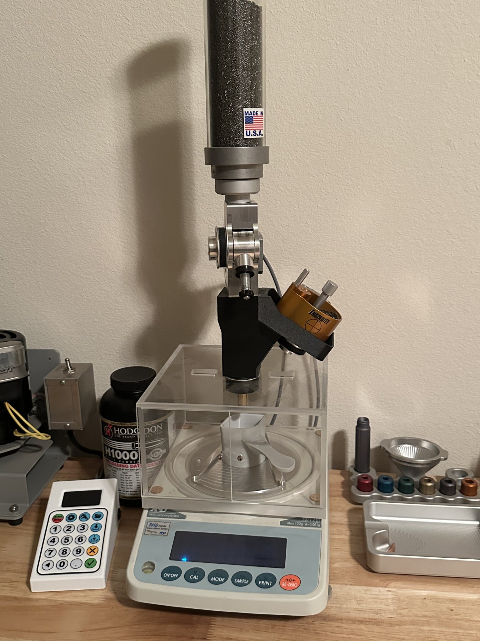

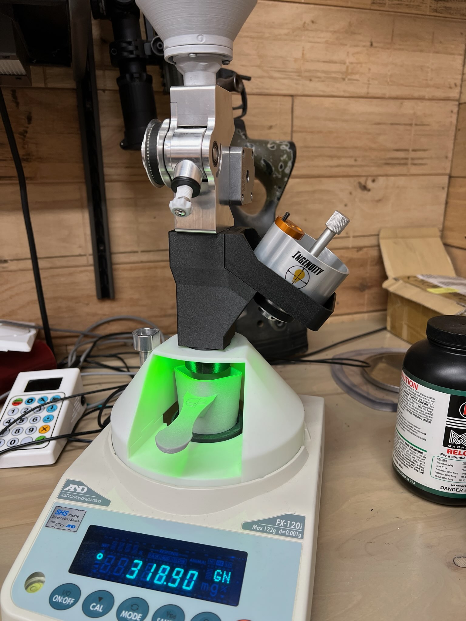

Paul texted me this pictures. He has a Adapter that v3 can go on top of it. makes it one piece unit.
I just got the IP Electronics for the V3 and it is pretty awesome so far. Having the controller is nice, I was surprised how quite the powder thrower motor is with the IP electronics/controller.

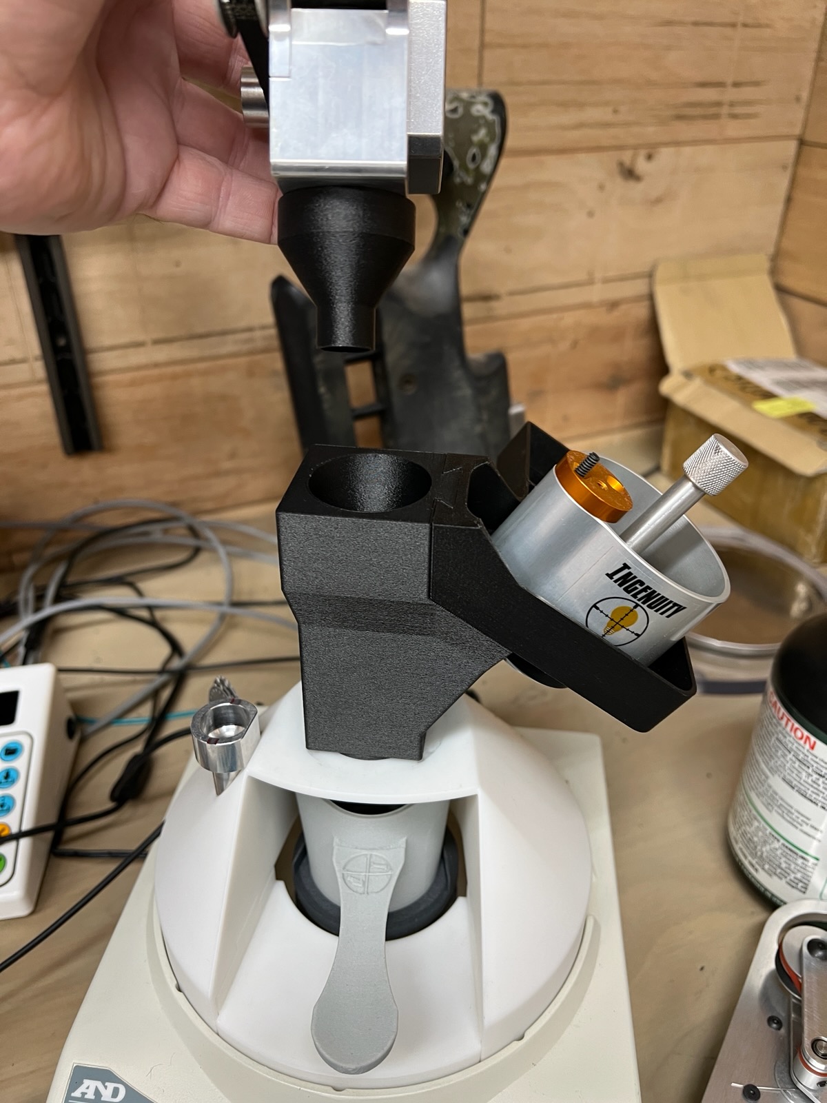

Based off of what Smokenaces posted about removing the baffle on the V3 funnel, I made and 3d printed a nozzle without the baffle. While I was testing the nozzle out, it seemed like the angle of the funnel can cause the occasional gun powder kernel to come out of the nozzle at an almost sideway trajectory and miss the powder cup.
I made another nozzle that is a very slight taper from bigger to smaller with the intent to make the gun powder drop straight down. I did around 100 throws last night with the IP Powder cup and the straight drop funnel and I didn't have a single kernel bounce out or not make it into the IP powder cup.
I definitely think a funnel with a straight drop workers better with the IP Powder Cup.

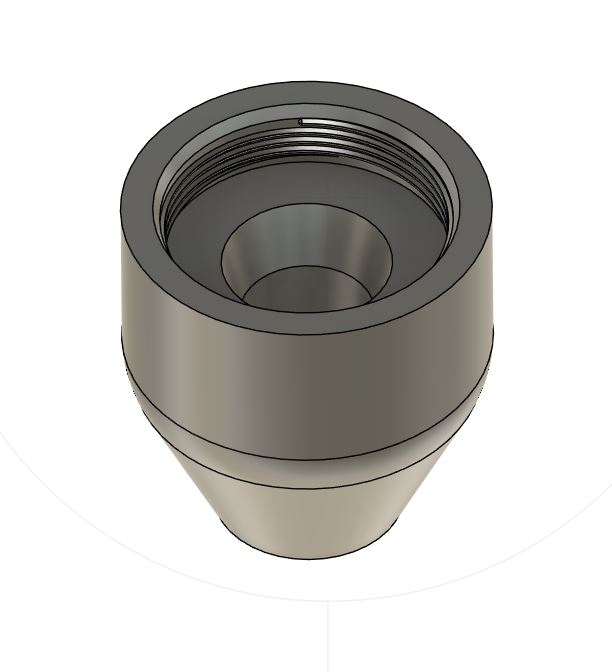

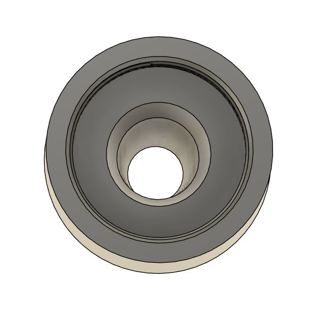

Here is what I made if anybody wants to replicate it or I could probably upload it so people with 3d printers can printer their own. I'm still new to CAD so I'm sure someone with more experience could make a better one than me.
It needs to have about a 1/2'' straight cylinder section at the bottom. This is what steers the kernels to fall directly down and not come out the bottom at weird angles

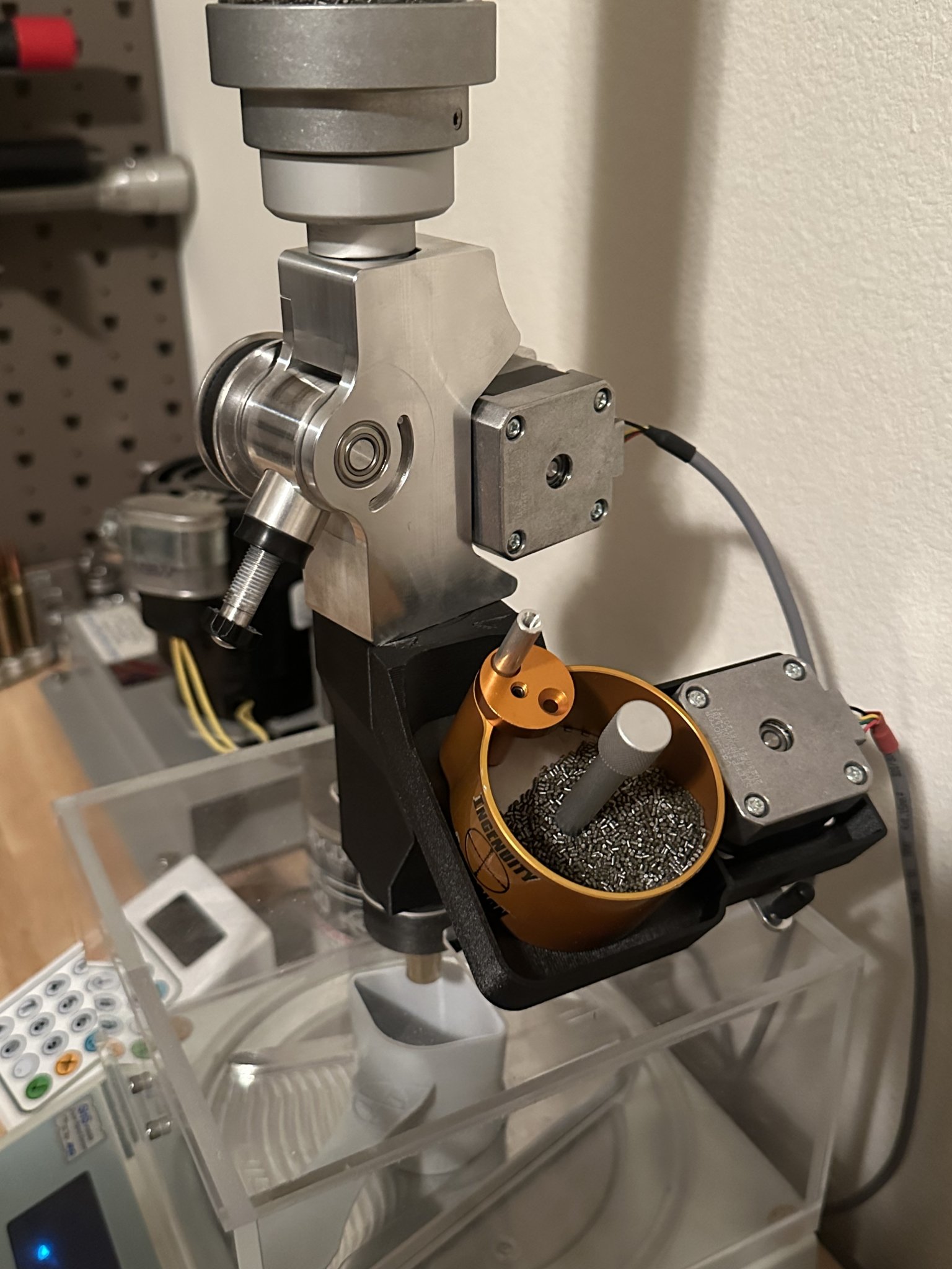

Looks great @Maurygold
So, you can either use Jim's enclosure OR the one provided by Paul? Or did you request that particular combo because you wanted to use the enclosure?
My understanding is the v3 base will work on either Paul’s new enclosure or Jim’s. I wanted to keep the plexiglass one because I like it more and it works perfect

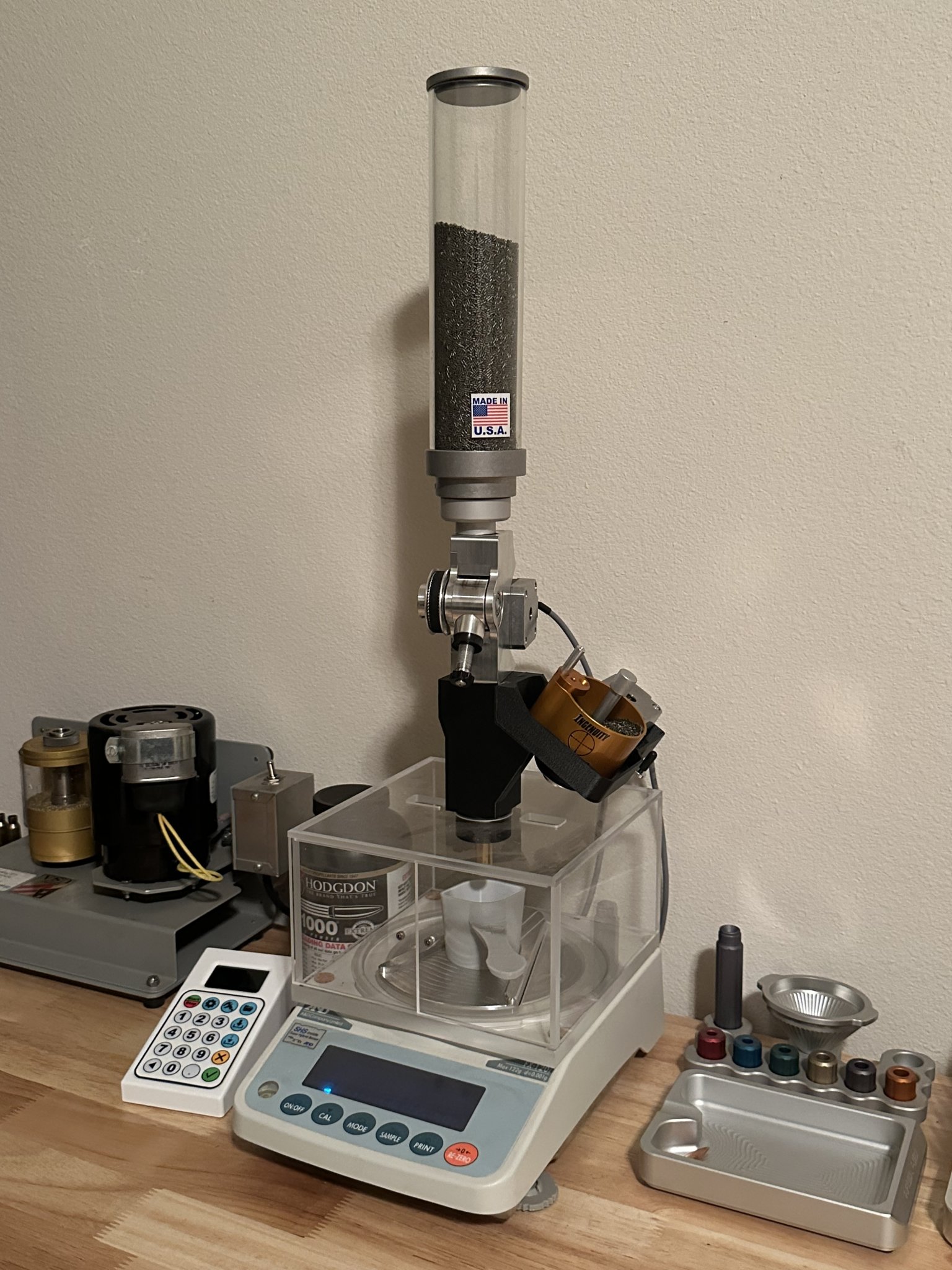

Got mine set up last nite , It works very well . Pulled a clear top off another scale and dropped it on the A&D . Loaded 4350 from 40.5 to 41.5 in incements of .10 and 10 loads fot a total of 100 had maybe 5 overthrows . Overall I am very happy ! Now come on with the bulk dropper.
I took the trickle throw down to 90% and saw very few overs with 5-7 second pour times.
