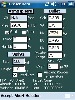

If the author is looking for a feature to add, a useful one would be to include entry of the change of muzzle velocity with temperature. That could be done either with a table, or simply a single number which is change of MV per degree.

This data would be best placed in each profile since it is particular to the load. I would think this would mean giving a velocity figure for a particular temp and then providing the speed differential for a give temp change....the more entries of the latter making the data more refined. Perhaps a table would be simpler, mathmatically.....trying to turn a few odd pieces of data into a function could be a challenge.

Yep - and you also need to specify the temperature at which the supplied muzzle velocity is correct. Below is the Preset screen from Field Firing Solutions, as an example.
To calculate that, you measure the muzzle velocity at two temperatures. Then the differential is just:
<div class="ubbcode-block"><div class="ubbcode-header">Code:</div><div class="ubbcode-body ubbcode-pre" ><pre>
MV at high temp - MV at low temp
Differential = ---------------------------------------
high temp - low temp

Honestly I have not spent enough time noting speed differentials to pretend to know how much it changes, just that it does change.
I would have guessed that is not a simple function of a given speed change per degree, would think it was a more complex curve based on temp, powder, primer, cartridge, barrel.....but then I don't have your experience. I take it your experience tells you that the simplistic entry method in that screenshot has proved precise enough for you?

Lindy's example above points out something else that has not been considered, though I meant to bring it up before......
The atmospheric condidtions and velocity at the time of zeroing.
That is important data with or without including speed variation based on temp.

There are many factors involved in the change of muzzle velocity with temperature, and there are limits to what we can do.
For example, see:
http://shootingsoftware.com/ftp/Pressure%20Factors.pdf
and
http://www.snipershide.com/UserFiles/Image/articles/powder_primer_temp_experiment_2.pdf
But there are enough uncertainties in any ballistic calculation - see Sources of Ballistic Program Inaccuracies - that we're never going to make a perfect prediction.
Good enough is what gets you close enough on the first shot to make the second one hit the target.

One could wind up entering a few dozen data points of different types to achieve a "more correct" solution....hence your last statement in that post.
Sean is the author of this program so it is up to him what he includes.
At this point it would be nice to see profile entries for temp and velocity at time of zeroing, along with the allowance for multiple temp/velocity combinations much like the variable BC entry system he has already included. This would allow each user to include as much data as they wish; with precision proportional to the number of data points one wishes to enter.
