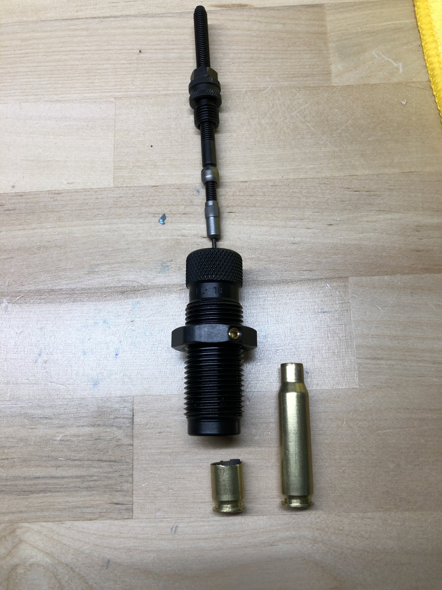

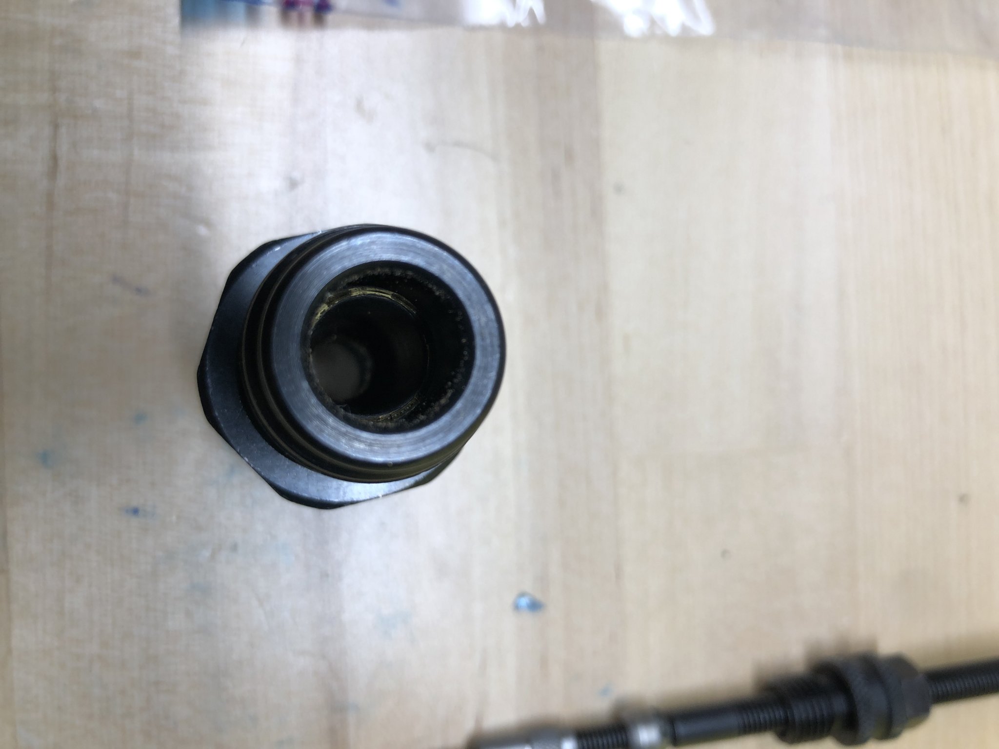

Well, I have what I think is unique, at least to me. I was using a 308 Winchester RCBS FL sizing die w/ expanding ball. On the down stroke all went well but on the upstroke as the expanding ball was being pulled back through the next the 308 Winchester case split almost in half leaving the brass stuck in the die and I can not get it out. I tried a punch and tried freeze the brass but not the steel die. I cannot get it out. Is there any ideas or is there a chemical I can but that'll eat the brass away without hurting the steel die. Or, am I just SOL and now have to but a news FL sizing die. Please advise.

Contact RCBS, tell them what happened, e mail the photos and send the die to them. The more you mess with it the more you could damage the die.
Okay, thankyou. We will call them tomorrow and hopefully they can get the brass out. OPPS, I forgot to ask. What makes the
RCBS 308 WINCHESTER SMALL BASE FL SIZER X-DIE any different than a regular 308 Winchester FL sizing die​
