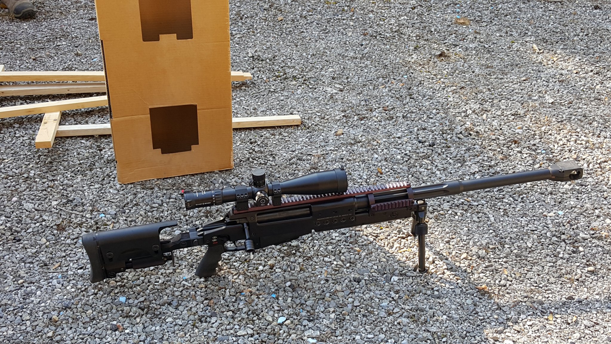

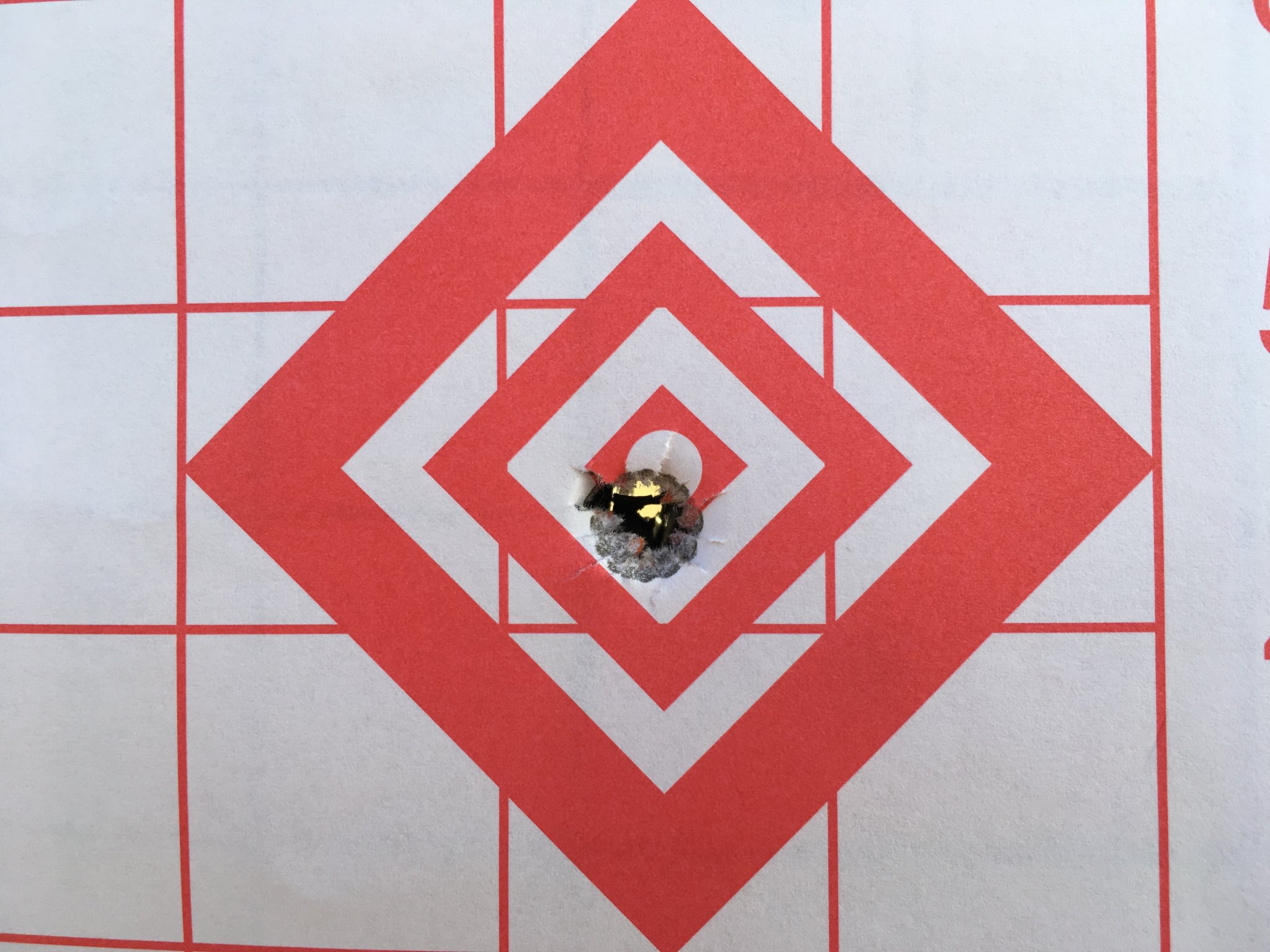

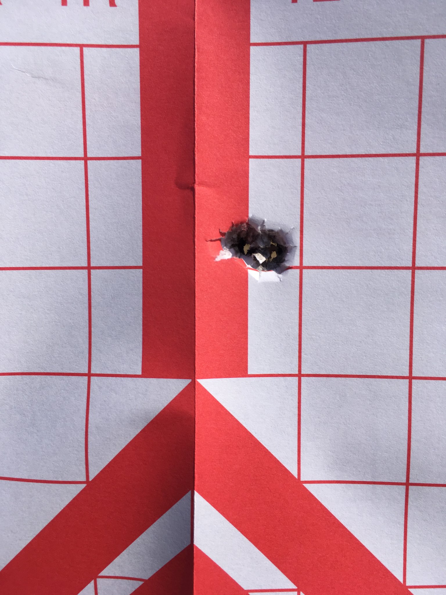

The JJ Rock Co. Rifle I ran at Ko2M, with no sign of give up at around 600ish...so I’d say a .375CT is at least good for 600 rounds, Lol!

The JJ Rock Co. Rifle I ran at Ko2M, with no sign of give up at around 600ish...so I’d say a .375CT is at least good for 600 rounds, Lol!View attachment 6970260View attachment 6970261
You got that kind of group at two miles? You’re a monster!
