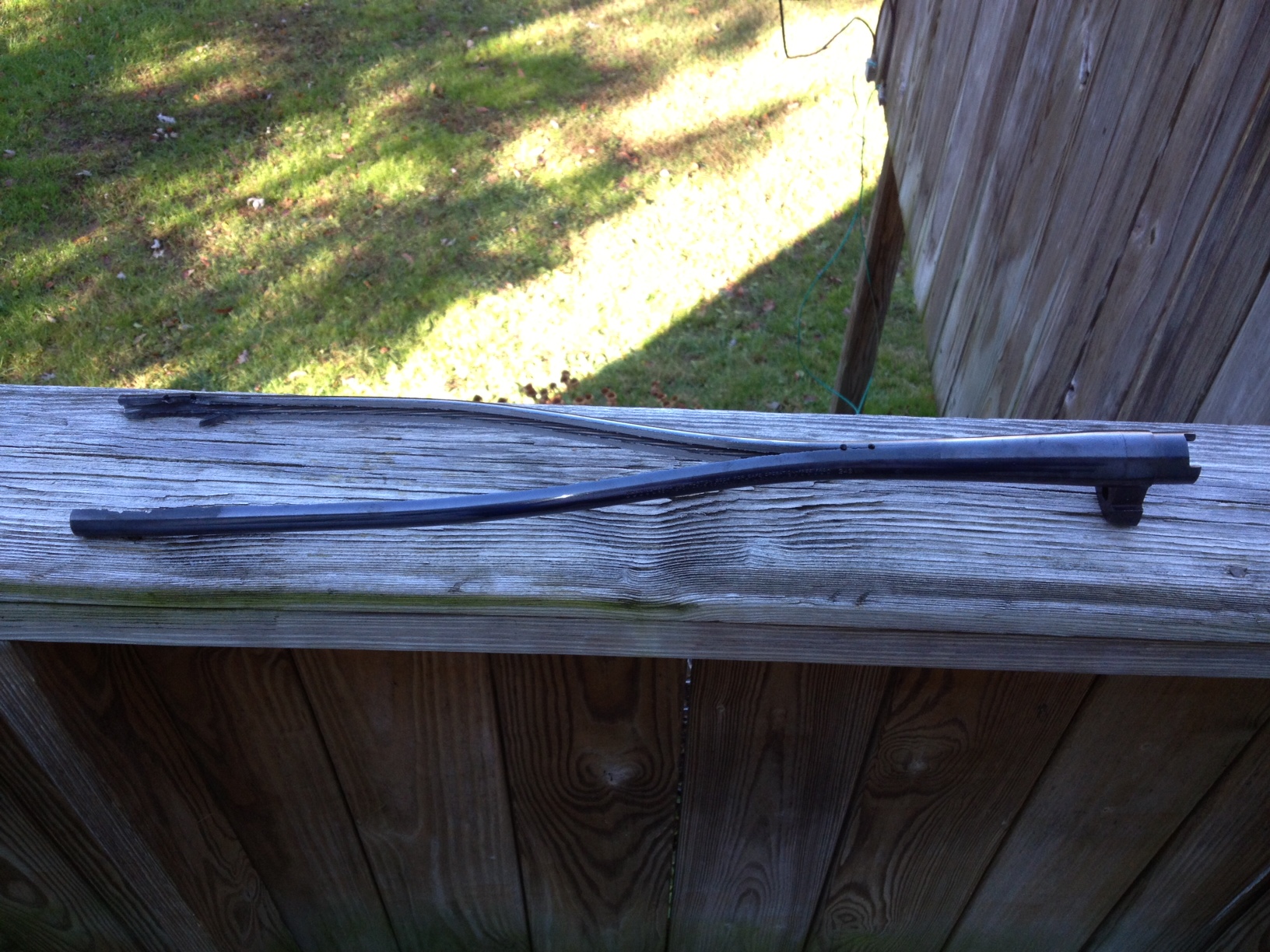

Kaboom at Manatee today!
rapid field striping of the savage

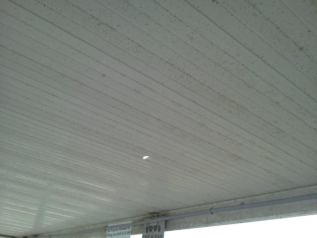

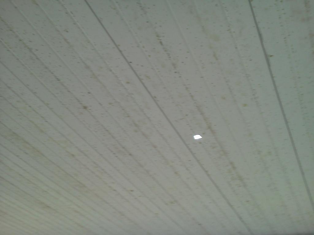

Photos of ceiling taters!
The ceiling was cleanly penetrated by something that went vertical very swiftly!

338 Lapua with the custom "brass stuck in chamber" load + cleaning rod.
P.S. I guarantee, with any other action the shooter would have ended up with firing pin through the face.

You do know that the rods normally go from breach to muzzle don't you? :)

He was probably knocking out a stuck round, which is the more common use for a cleaning rod at the range. It's also more dangerous, because it's usually done in a moment of mild frustration.
A simple cure, something that will make sure one doesn't leave the cleaning rod in, is to make a 6" circle of cardboard and poke the cleaning rod through the center of it. Only remove stuck rounds when using the cardboard "circle". This will obscure any sight picture and give the shooter a warning that the rod's still in the bore. The cardboard will also keep the handle and it's parts from dinging the crown when the case is knocked out.
how many "stuck cases" before you ask yourself what is wrong and FIX THE PROBLEM instead of playing with fire

The fellow 2 benches west of me, right next to Ren, had a very bad day! Damn sure could have killed him and quite likely Ren as well.
Something blew clean through the roof in two locations!
