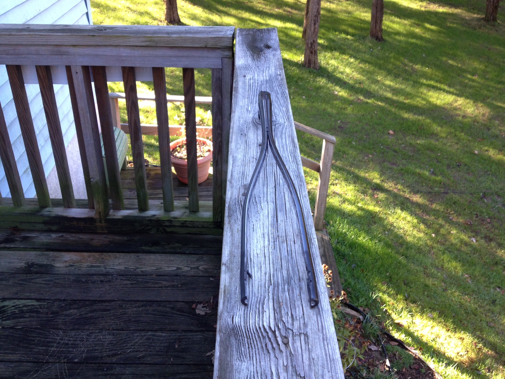

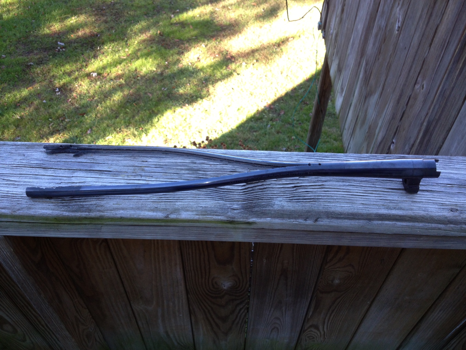

Another example of carelessness, the owner was using a laser bore sighter after installing a new scope on his Remington 7600 game master chambered in 243 Win. He did seek medical services as the wood blew in several pieces.
